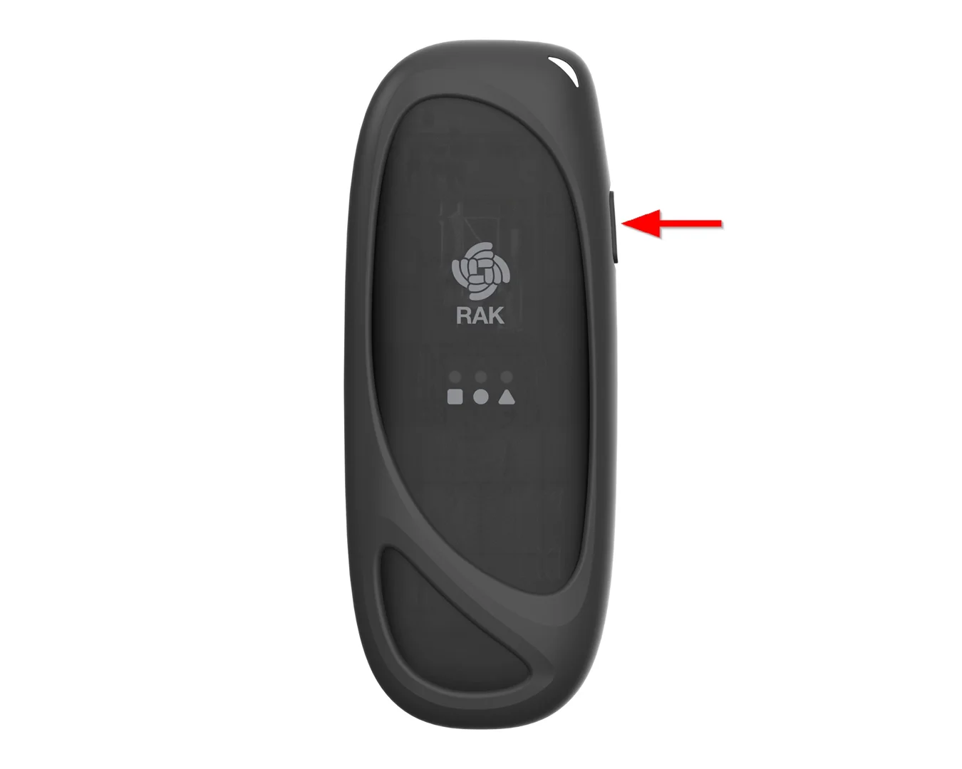

Button
The side button on the device is multifunctional:
- Long press (> 3 seconds): Powers the device on or off The green heartbeat LED indicates power status.
- Short press to reset the device.
- Double short press to switch into bootloader/DFU mode to enable firmware updates over the USB connector.
This button is not a user button. It is only for the above mentioned functions.
Figure 1: WisMesh Pod On/Off buttonUSB port

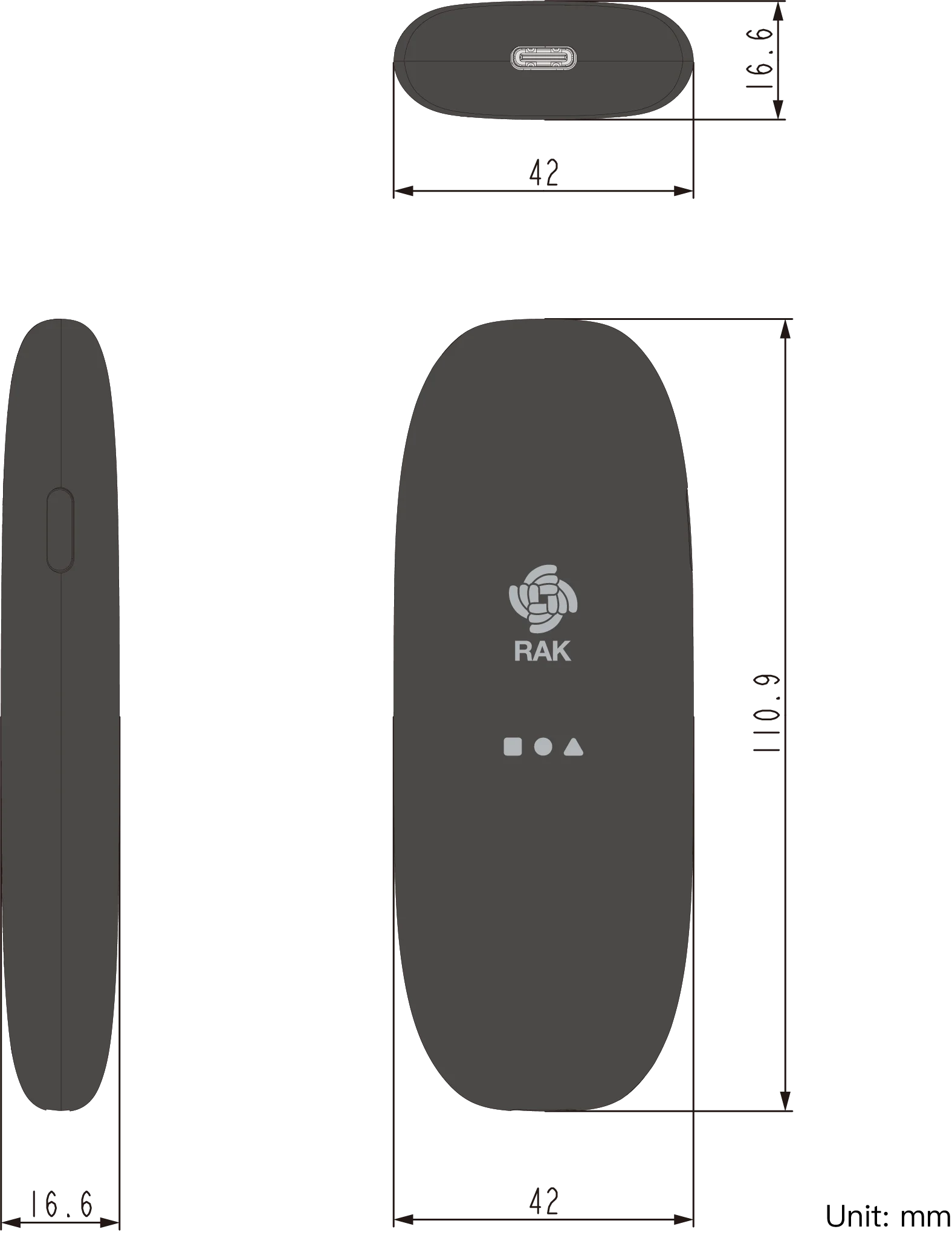

Dimensions
The device is built with a hard shell that cannot be opened and an additional rubber casing for protection.

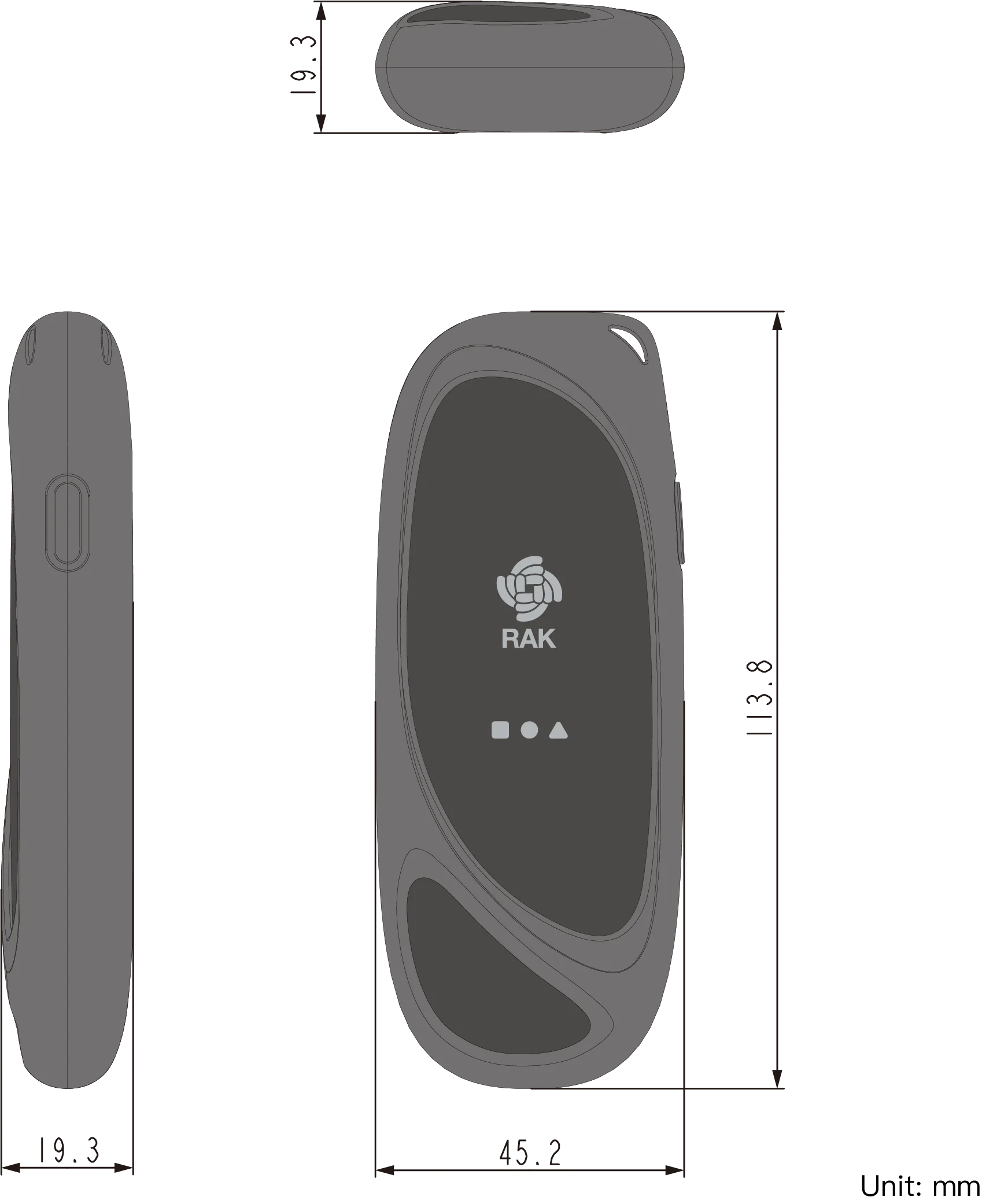

Enclosure dimensions without rubber casing:
Figure 1: WisMesh Pod dimensions of hard shellEnclosure dimensions with rubber casing:
Figure 1: WisMesh Pod dimensions with rubber enclosureSoftware Setup
