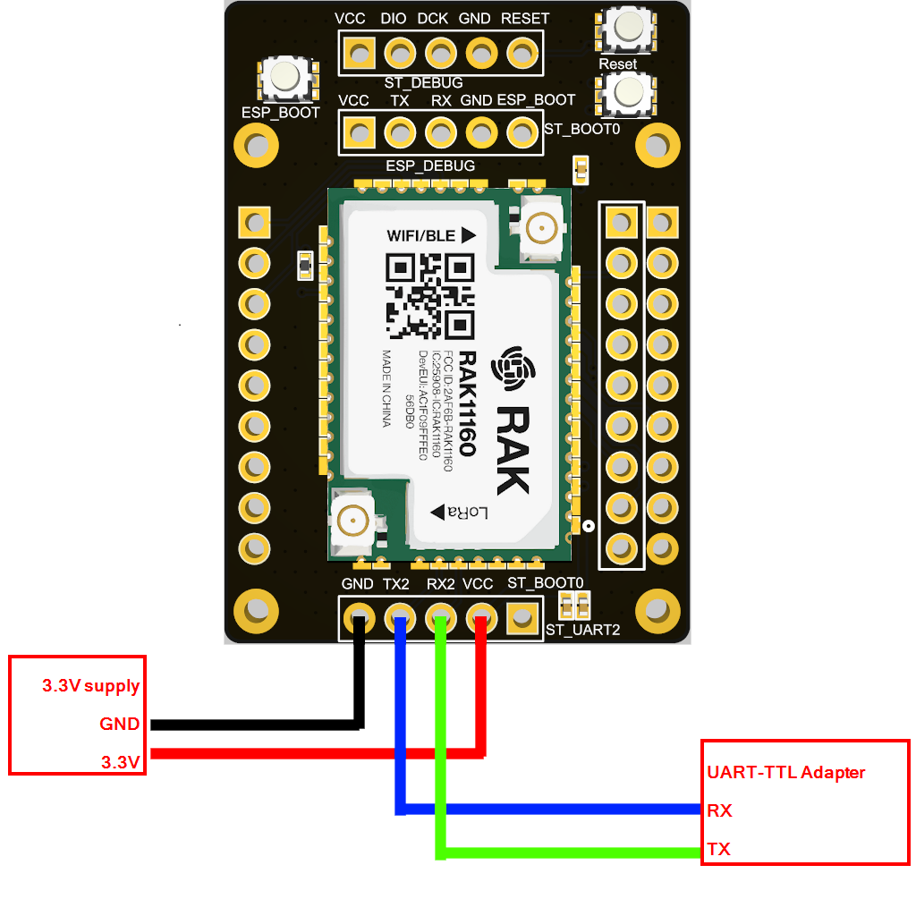

Hardware Setup
The RAK11161 requires a few hardware connections to function properly. The bare minimum requirement is to have the power section properly configured, along with antennas and a UART connection for AT commands and firmware updates.
Figure 1: RAK11161 schematicEnsure the antennas are properly connected for a strong LoRa and BLE signal. Powering the module without an antenna connected to the IPEX MHF4 connectors can damage the RF section of the chip.

Connect the RAK11161 Breakout Board with a computer through a USB to TTL.
Open the RAK Device Firmware Upgrade Tool. Select the serial port and baud rate (115200) of the module and click the Select Port button.
