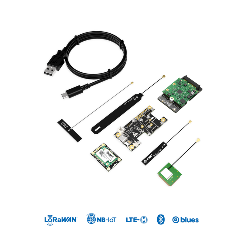

Hardware
- RAK10714 LTE-M, NB-IoT, GSM cellular and LoRaWAN Development Board
- USB-C Cable
- Li-Ion 3.7 V rechargeable battery
- 5 V Solar Panel (optional)
- Nano SIM card if you are using the Blues.IO Notecard in a region that is not supported by the eSIM of the Notecard. You can check the coverage on the Blues.IO Coverage Overview
Software
- Download and install the ArduinoIDE.
- To add the RAKwireless Core boards on your Arduino Boards Manager, install the RAKwireless Arduino BSP.
- Blues WisBlock Tracker- the default firmware that is pre-flashed on the RAK10714 Solution.

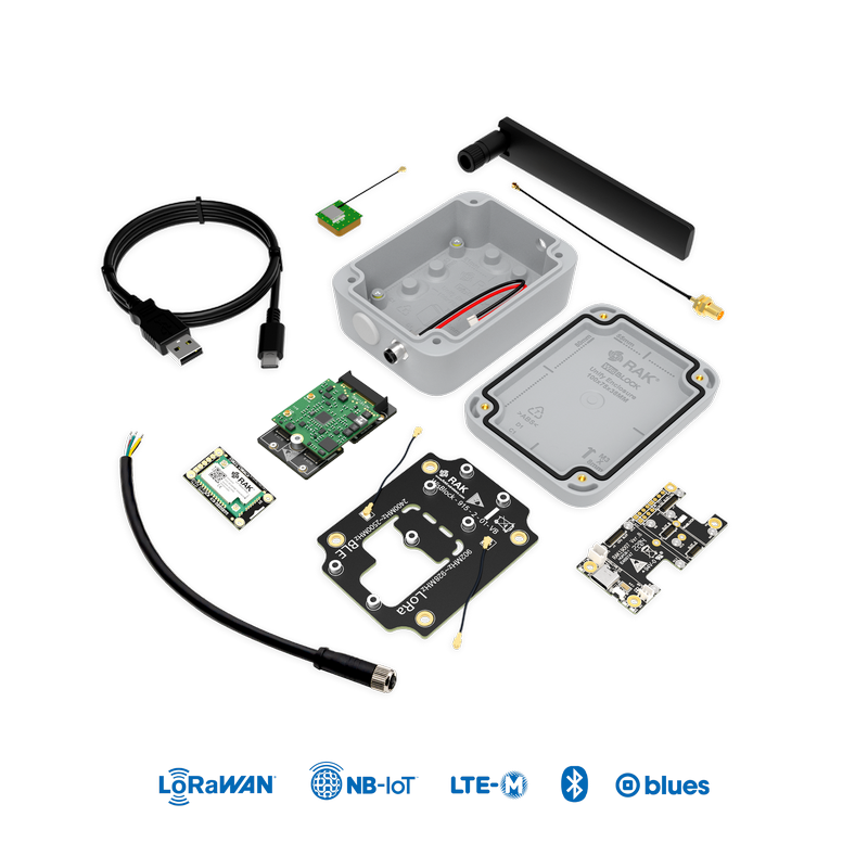

When you buy RAK10714, you can choose between two variants: one with bare modules and antennas and one with an enclosure and more optimized antennas.
Figure 1: RAK10714 modules without Enclosure
Figure 1: RAK10714 with EnclosureProduct Configuration

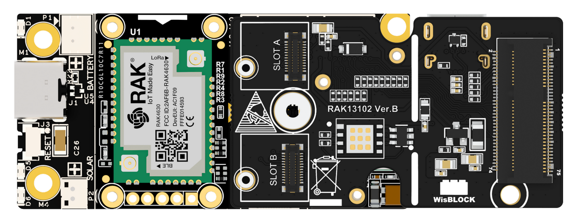

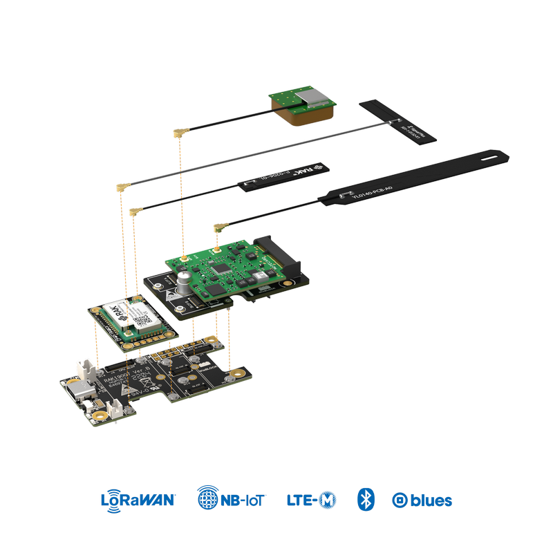

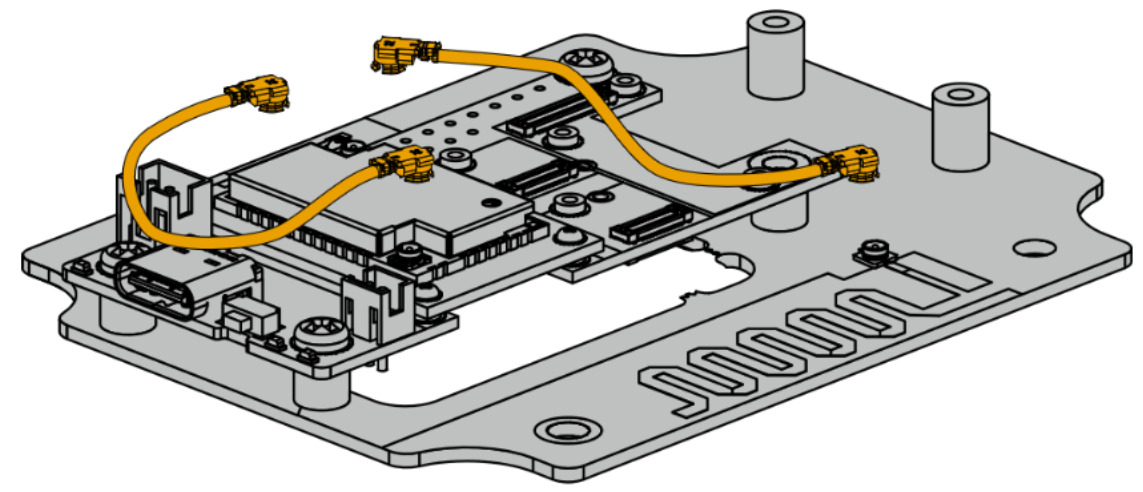

- Assemble each module, including the respective antenna. Refer to Figure 3 for the connections.
Figure 1: RAK10714 Modules and Antenna Connection- When the modules are plugged in together, they should look the same as in Figures 4 and Figure 5:

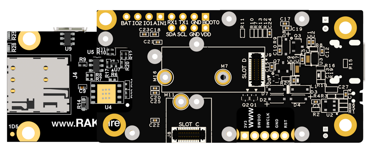

Figure 1: RAK10714 Modules top view
Figure 1: RAK10714 Modules bottom viewRAK10714 With Enclosure

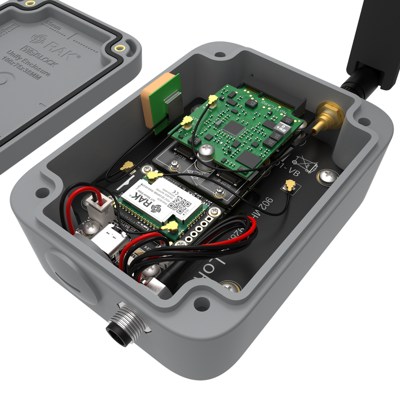

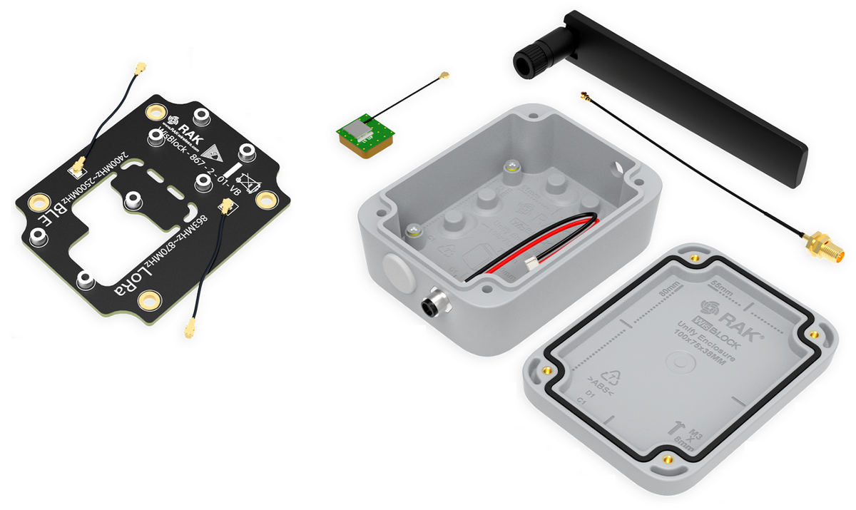

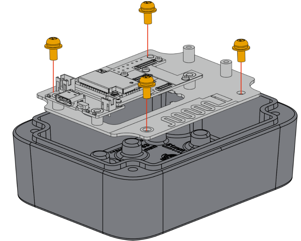

- If you have the RAK10714 with enclosure, you have to prepare the WisBlock Modules together with the WisBlock Baseplate with antenna, circular connector, IPEX-SMA cellular antenna connector, and GPS antenna.

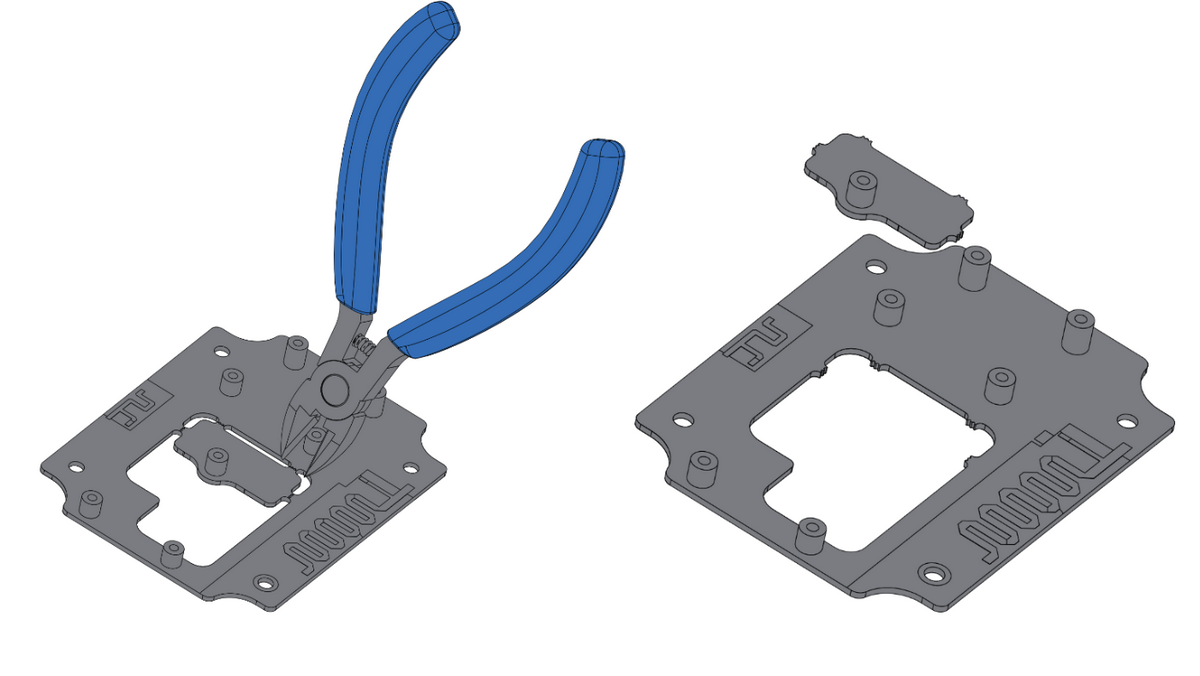

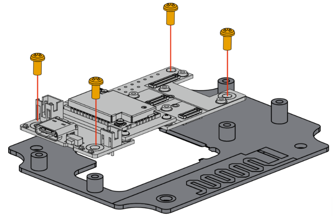

Figure 1: RAK10714 with Enclosure- On the WisBlock Baseplate, you have to remove the cutout that is designed to be used for the mini-base board. This cutout part must be removed for RAK10714.
Figure 1: Removing the cutout section of the WisBlock Baseplate- After removing the cutout, you can now attach the WisBlock Base Board to the WisBlock Baseplate using screws.
Figure 1: Attaching the WisBlock Base board to WisBlock Baseplate with PCB Antenna- The next step is to connect the IPEX-IPEX from the WisBlock Core to the WisBlock Baseplate with an antenna.
Figure 1: IPEX-to-IPEX connector- Then, you can now attach it to the enclosure and complete it with the rest of the parts.
Figure 1: Mounting the modules to RAK10714 enclosure
Figure 1: Assembled RAK10714 with all the partsAfter assembling all the parts, connect the battery to the WisBlock Base. Without the battery connected, the Blues.IO Notecard will not be able to function correctly due to a lack of power source. The USB connection will not be able to provide enough power to achieve enough performance stability.

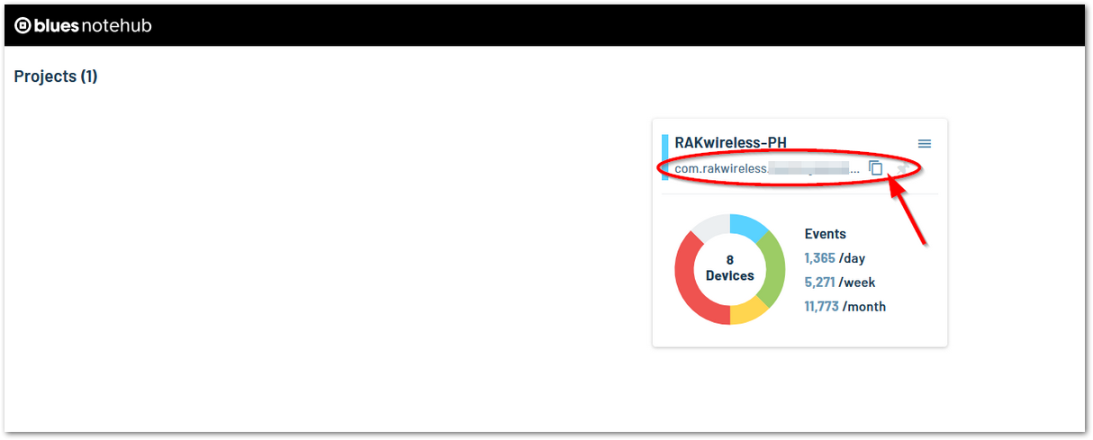

To connect the Blues Notecard to the NoteHub, a Product UID is required. This product UID is created when you create your project in NoteHub as shown in Set up Notehub.
Get the Product UID from your NoteHub project:
Figure 1: Notecard PUIDThen use the ATC+BEUI command to save the Product UID in the WisBlock:

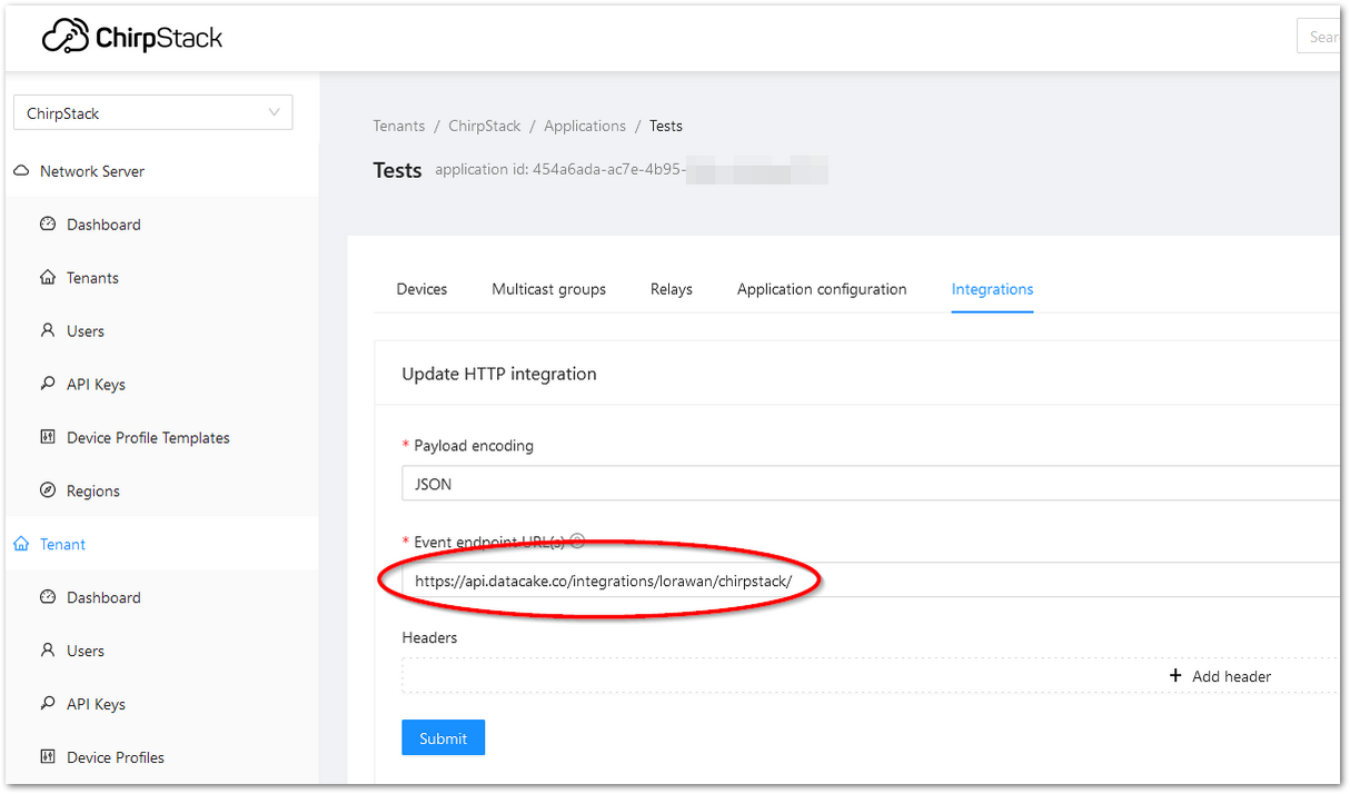

For testing, I used Chirpstack V4 as a LoRaWAN server. The tracker has to be set up with its DevEUI and AppEUI in an application on the Chirpstack LNS. Optional you can add a payload decoder in the Device Profile. Then you can see the decoded payload in the events list of the device. Here is an example log output with the result of the CayenneLPP data parson the LNS before it is sent to the Blues NoteHub:
Figure 1: LoRaWAN GatewayWithin the Chirpstack LNS application, integration is needed to forward the data to Datacake, for the visualization. The integration is a simple webhook to Datacake:

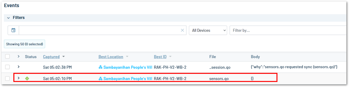

The notes sent to the Blues Notehub can be seen in the Events listing of the Nothub
Figure 1: Notehub Event LogThe location and sensor data are sent as binary payloads, so there is nothing to see here in the body field.

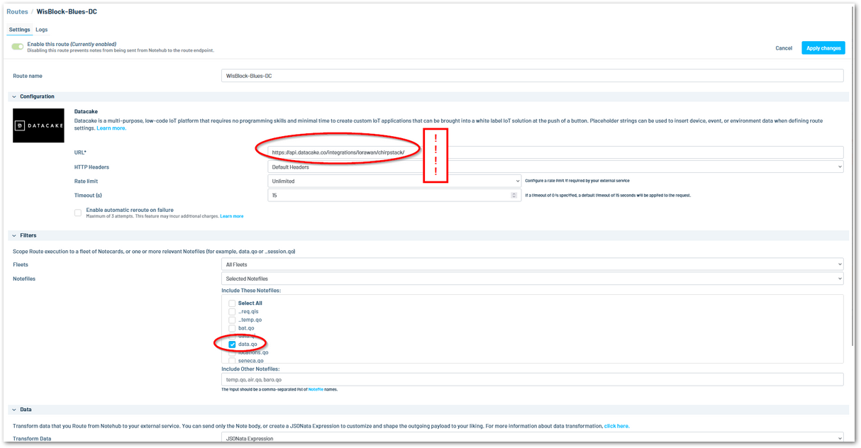

The next step is to create the Route in NoteHub that forwards the data to Datacake. Instead of the default URL for the Datacake route, use the URL for LoRaWAN devices. Also, the note you want to forward is the data.qo note.
Figure 1: Notehub Route SetupAt this point, it is getting a little bit complicated because the location data sent to Datacake can come EITHER from the LoRaWAN server OR from NoteHub.IO. The JSON object sent by the two looks of course very different.

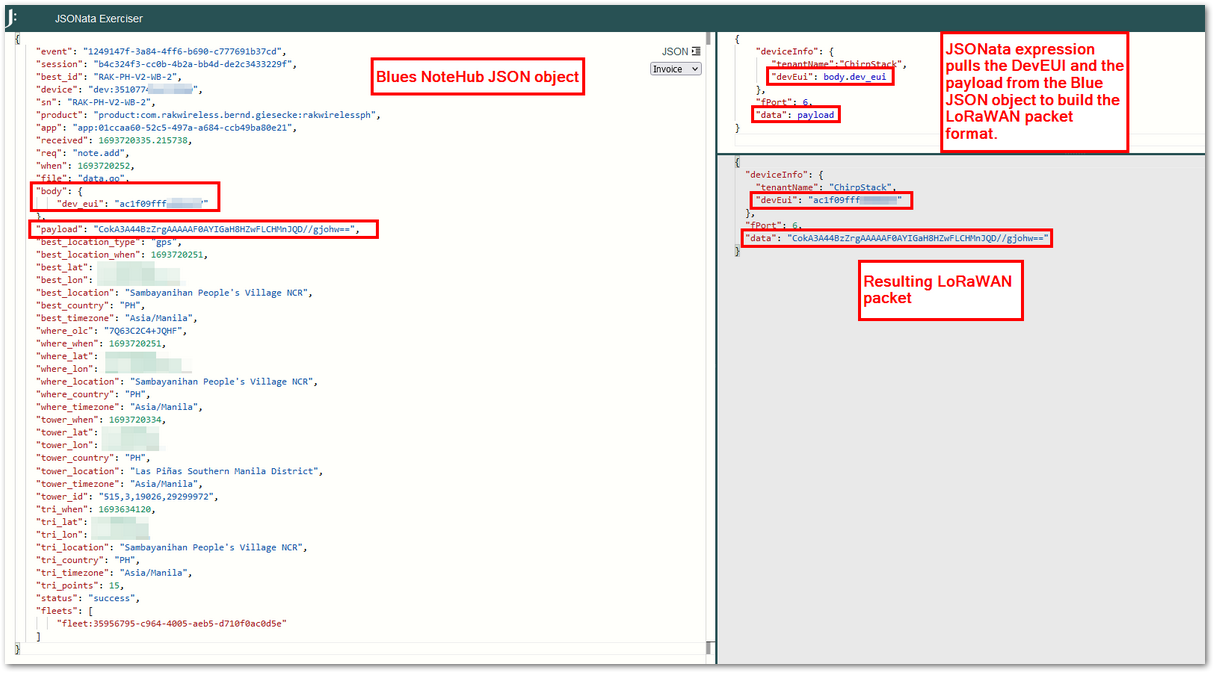

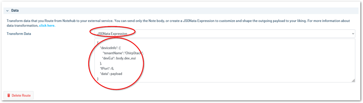

Because of the different formats, you can use a very appreciated feature available in the NoteHub Routes, the JSONata Expression. With this data transformation option, make the JSON packet coming from the NoteHub look like a packet coming from a LoRaWAN server. I suggest reading the Blues documentation about JSONata to understand how it works.
The JSONata expression needed is very simple. You can simulate a LoRaWAN packet format with just a few JSON fields:
"deviceInfo": {
"tenantName":"ChirpStack",
"devEui": body.dev_eui
"fPort": 6,
"data": payload
In the Route setup, scroll down to the Data section. Select JSONata Expression to transform the data, then copy the JSONata expression into the entry field.
Figure 1: Notehub Routes TransformThe JSONata is pulling the required info from the Blues JSON data packet to build the "fake" LoRaWAN packet. You can check the functionality with the JSONata Exerciser:
Figure 1: JSONata ExerciserThe resulting JSON object is then sent to Datacake, which handles it as if it comes from a LoRaWAN server.

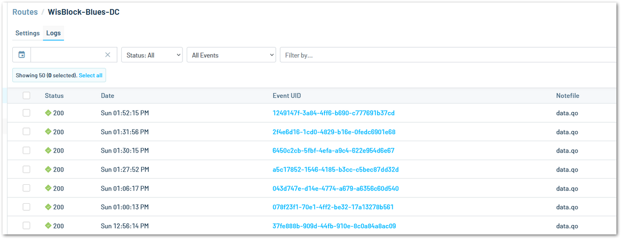

The routing events are shown in the Routes log view:

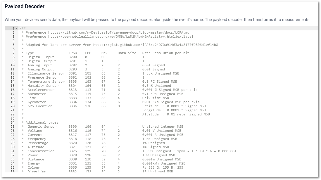

The payload decoder I used can be found in the file Decoder.js in the Github repository. The content of this file has to be copied into the Payload Decoder of the device configuration in Datacake:

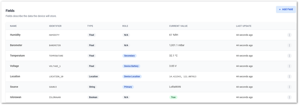

Figure 1: Payload DecoderThen the matching fields for the sensor data have to be created. The easiest way to do this is to wait for incoming data from the sensors. If no matching field is existing, the data will be shown in the Suggested Fields list in the configuration.
Figure 1: Suggested FieldsThe sensor data can be easily assigned to fields using the Create Field button.
It will take some time before the suggested fields are listed as complete. Instead of using the suggested fields, you can just create the following fields manually:
| Name | Identifier | Type | Role |
| Voltage | VOLTAGE_1 | Float | Device Battery |
| Source | SOURCE | String | Primary |
| Islorawan | ISLORAWAN | Boolean | N/A |
| Location | LOCATION_10 | Location | Device Location |
| Temperature (only if RAK1906 is present) | TEMPERATURE | Float | Secondary |
| Humidity (only if RAK1906 is present) | HUMIDITY | Float | N/A |
| Barometer (only if RAK1906 is present) | BAROMETER | Float | N/A |

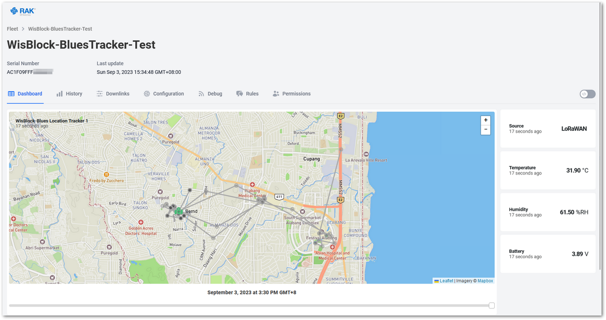

Figure 1: Create FieldsOnce all the sensor data is assigned to fields, you can start with the visualization of the data.
Figure 1: Created FieldsIn Datacake, each device has its own Device Dashboard which is used to display the location data. Details on how to create visualization widgets in Datacake is in the other tutorials already.
The final result for the WisBlock Blues Tracker:
You can see life data on the public dashboard.
In the top part of the dashboard are the locations of the device (history enabled) on the map and device sensor values on the side (temperature and humidity are only available if a RAK1906 is present).

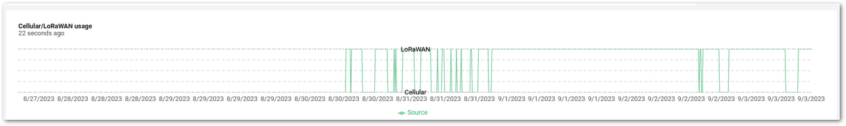

Figure 1: LocationsIn the lower part, a chart shows at what times the sensor used LoRaWAN to transmit data and when it used the cellular connection.

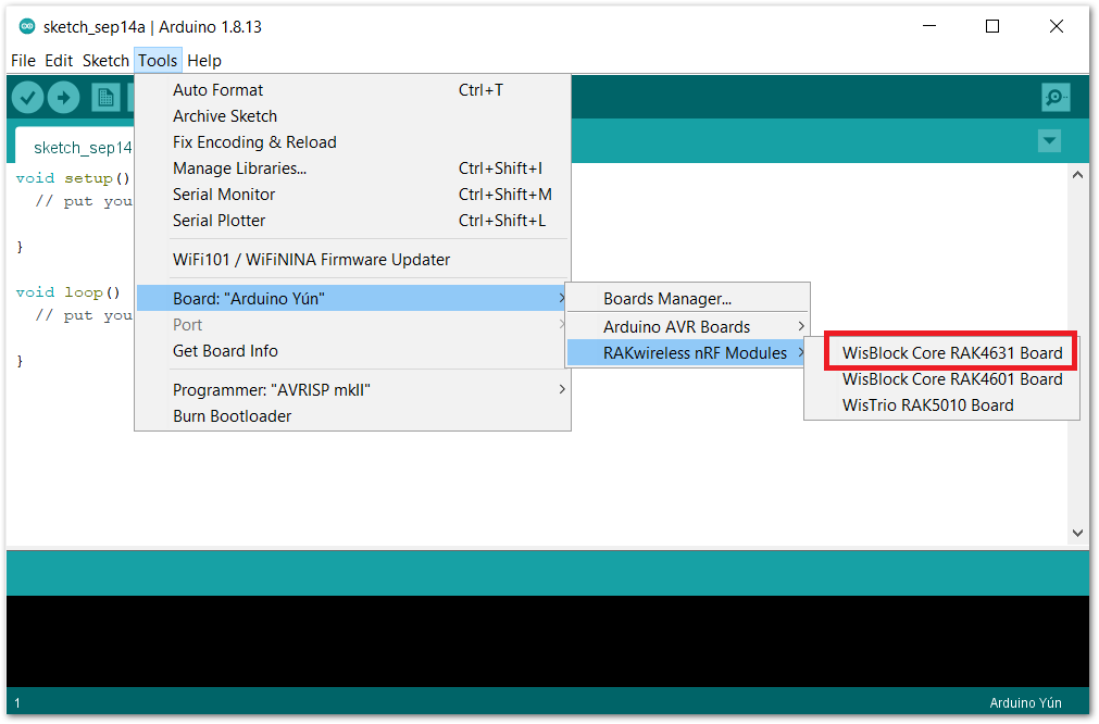

- Install the RAKwireless Arduino BSP for WisBlock by using the
https://raw.githubusercontent.com/RAKwireless/RAKwireless-Arduino-BSP-Index/main/package_rakwireless_index.jsonboard installation package, the WisBlock Core RAK4631 should now be available on the Arduino IDE. - RAK10714 uses RAK4631 WisBlock Core as the main processor.
Figure 1: Selecting RAK4631 WisBlock Core of RAK10714- Once you are ready with the Arduino IDE software and the RAK4631 board has already been added, you can now check the Cellular examples available for the Blues.IO Notecard.
