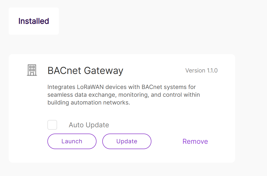

Method 1: Online Upgrade from Web UI
Use this method when a newer BACnet Gateway extension version is available through the Web UI.
Go to Extensions > Installed.
Find BACnet Gateway.
Click Update.
Figure 1: A newer version availableNOTEIf a newer version of the extension is available, the Update button is highlighted, indicating that the extension can be updated.
Wait until the upgrade process is completed.
During the upgrade, the button may show Updating. The process usually takes about 5 minutes.

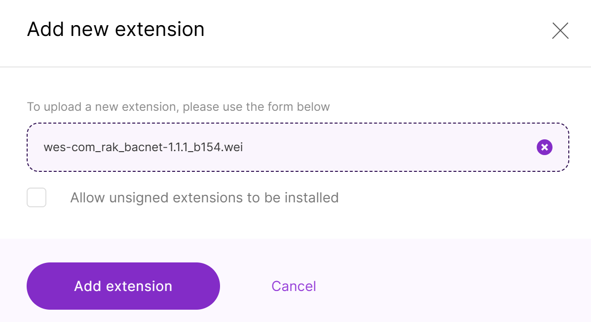

Method 2: Manual Package Upload from Web UI
Use this method when you have the BACnet Gateway .wei package and need to manually upgrade the extension.
Click Add new extension.
Drag and drop the downloaded BACnet Gateway
.weipackage into the upload area, or click choose file to select it manually.
Figure 1: Upload the extension file -
Click Add extension to start the installation.
Wait until the installation is completed.

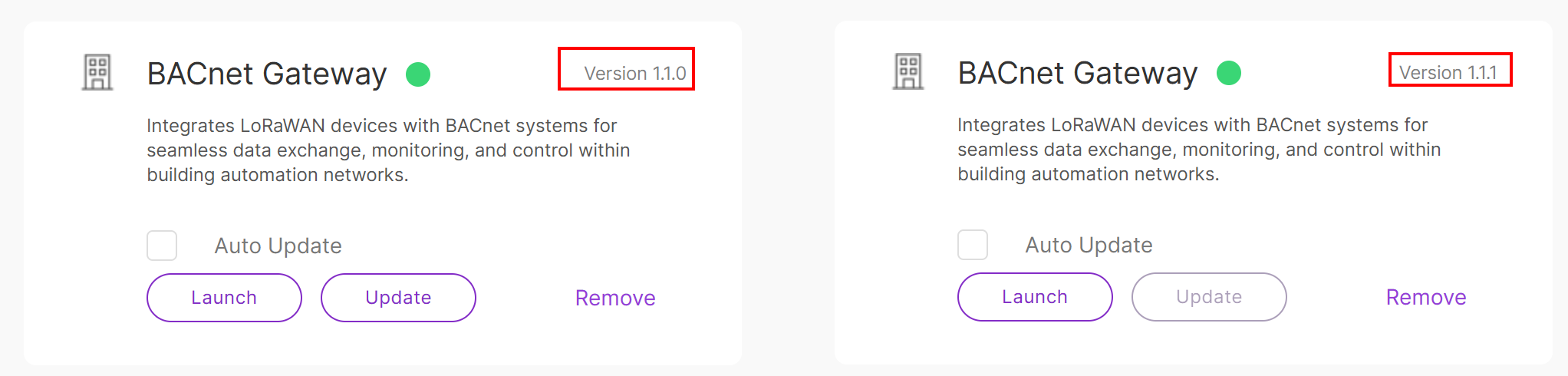

Verify the Result
After the update or installation is complete, go to Extensions > Installed and find BACnet Gateway.
Confirm the following:
- The BACnet Gateway extension is displayed in the installed extension list.
- The displayed version matches the expected target version.
- If the installed version is already the latest version, the Update button is unavailable or grayed out.
- If Auto Update is enabled, the Auto Update checkbox remains selected.
Figure 1: Verify the extension version in Web UI
