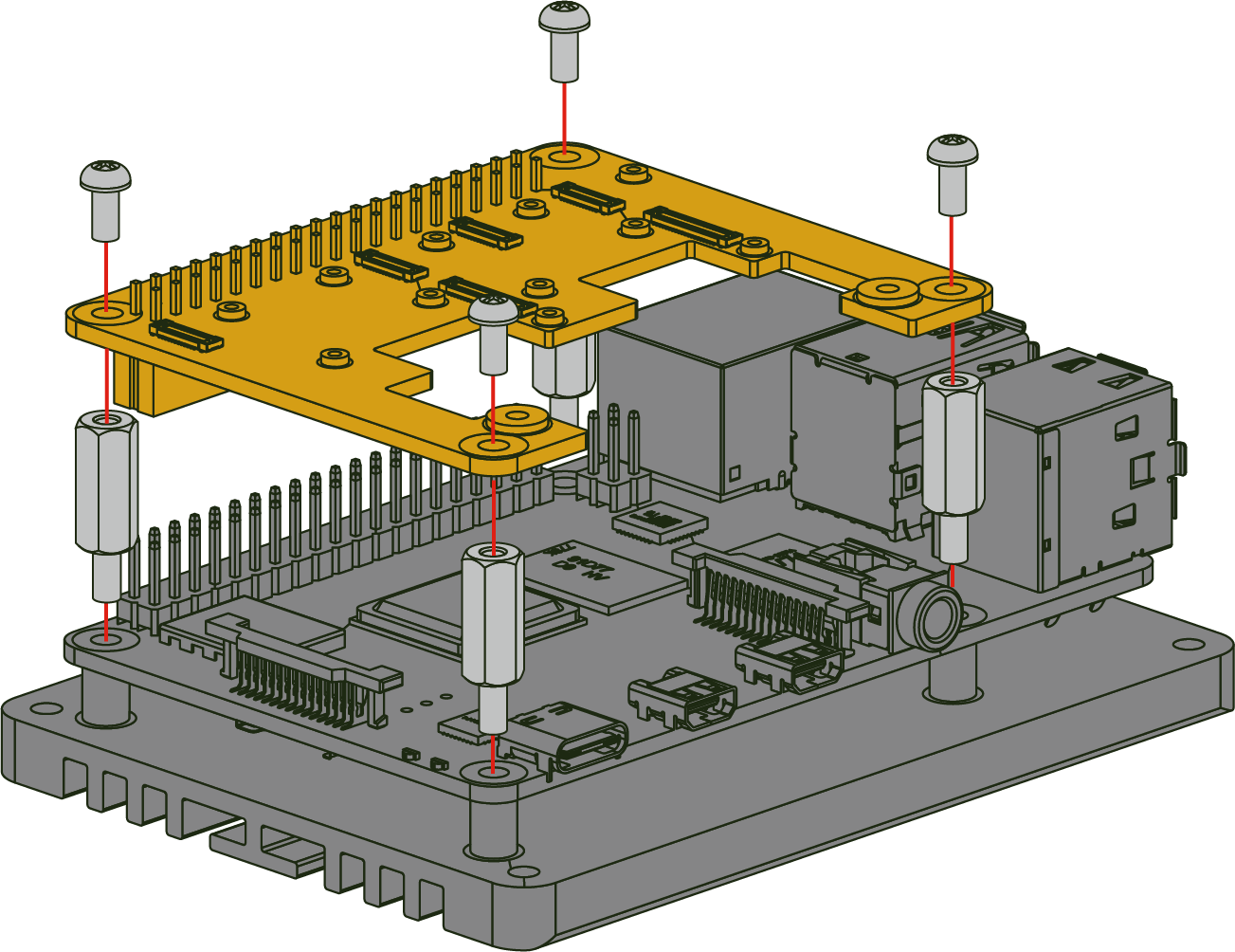

Assembling
To assemble the board on top of Raspberry Pi:
- Mount modules/sensors to the HAT first and secure with screws
- Keep host powered off and unplugged during assembly
- Use spacers to keep proper distance/alignment between boards
Figure 1: WisMesh RAK6421 Pi HAT assemblyLoRa and BLE Antenna

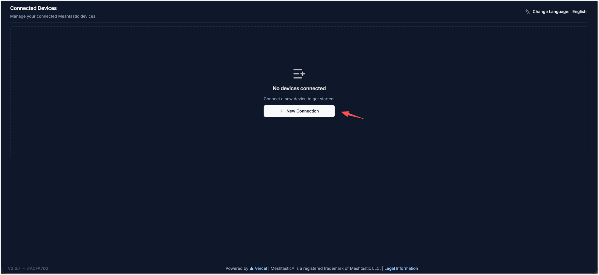

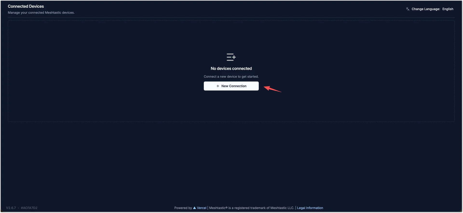

Step 3: Connect to Your Node

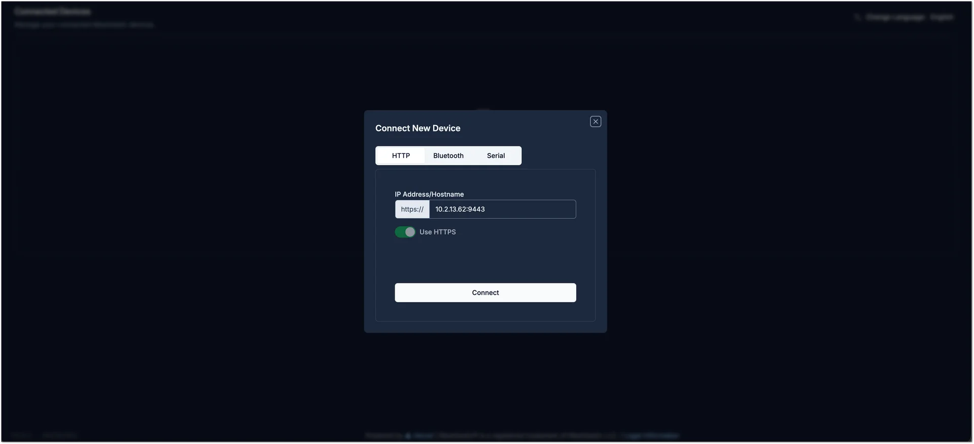

- Select "+ New Connection".

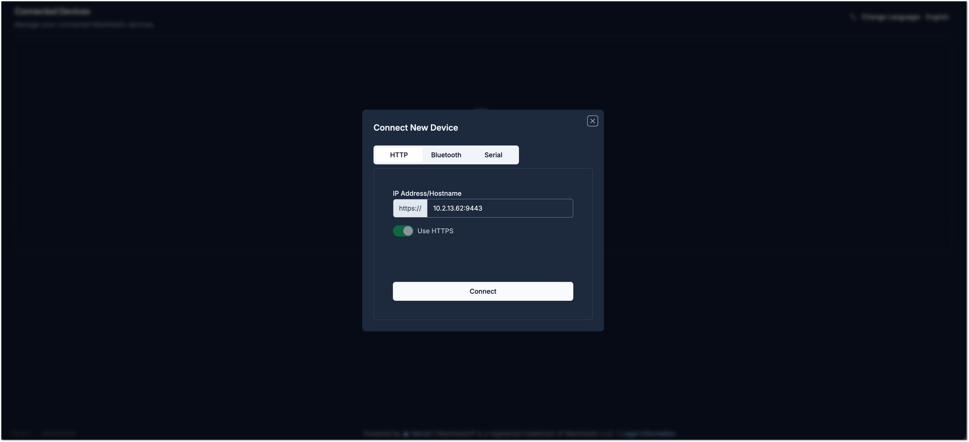

Figure 1: Meshtastic Web Client - Add Device- Choose HTTP, enter
<Pi-IP>:9443, then click Connect.
Figure 1: Meshtastic Web Client - ConnectStep 4: Verify Configuration

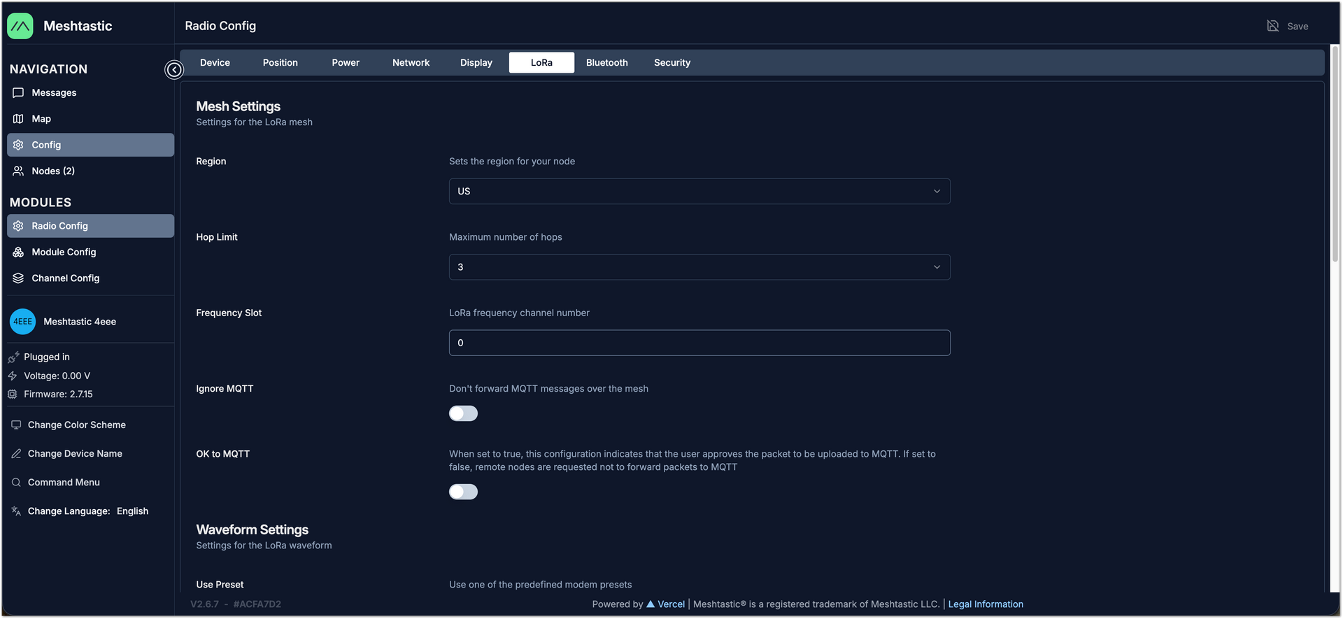

Go to Config > Radio Config > LoRa. Verify settings and adjust if required.
Figure 1: Meshtastic Web Client - Radio ConfigOnce verified, you can start using Meshtastic:

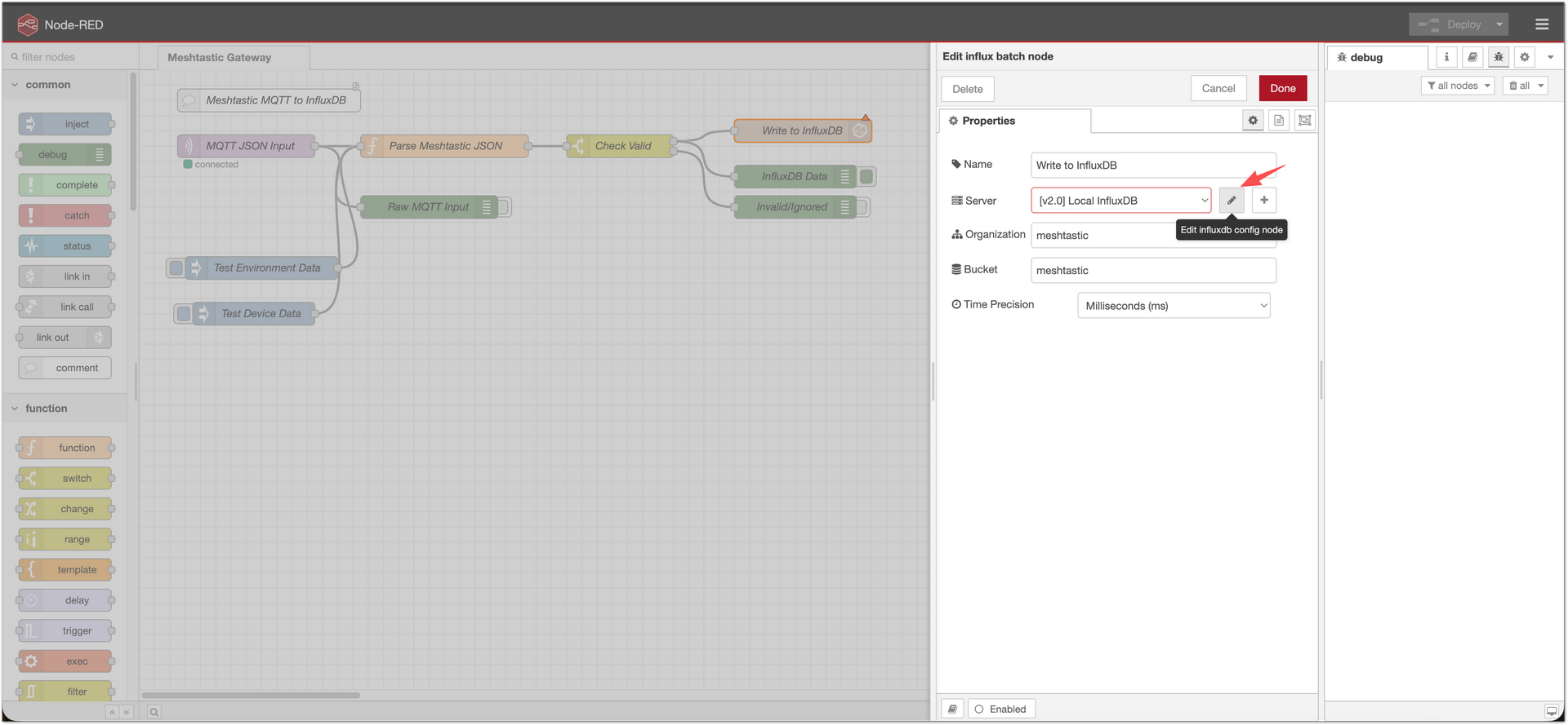

Configure Node-RED InfluxDB Token
After installation, you need to configure the InfluxDB token in Node-RED:
1. Get the token:
./show-token.sh

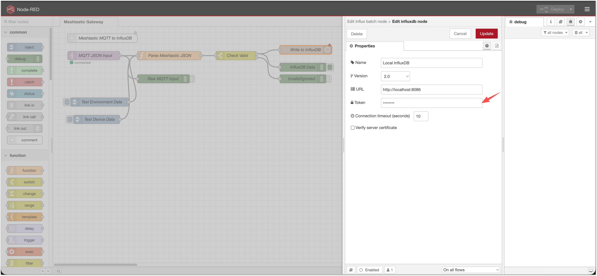

2. Open Node-RED at http://<Pi-IP>:1880 (from any device on your LAN)
3. Double-click the "Write to InfluxDB" node:
Figure 1: Edit InfluxDB Node4. Click the pencil icon next to "Local InfluxDB" and paste the token:

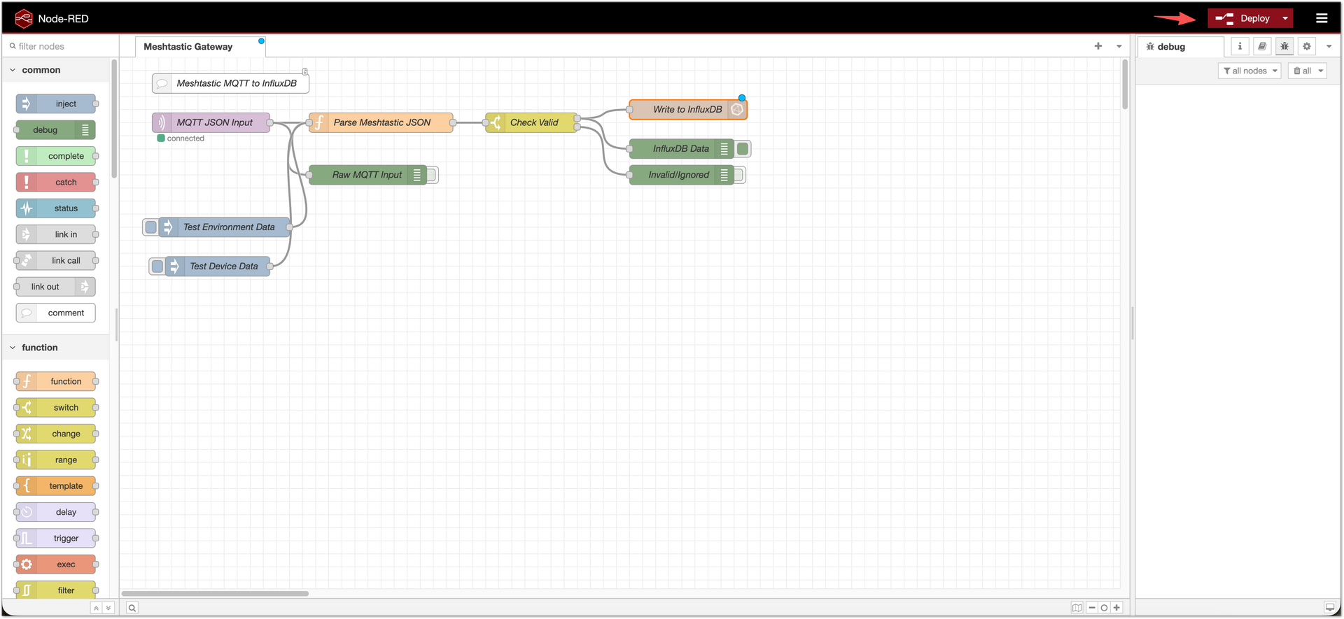

Figure 1: Enter Token5. Click "Update", then "Done", then click "Deploy":

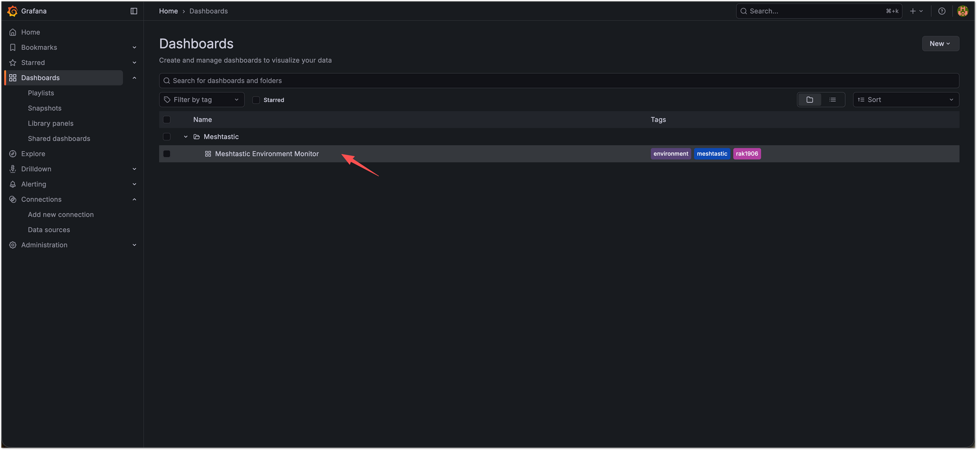

- Open Grafana at
http://<Pi-IP>:3000. - Login with admin / admin.
- Navigate to Dashboards → Meshtastic folder.

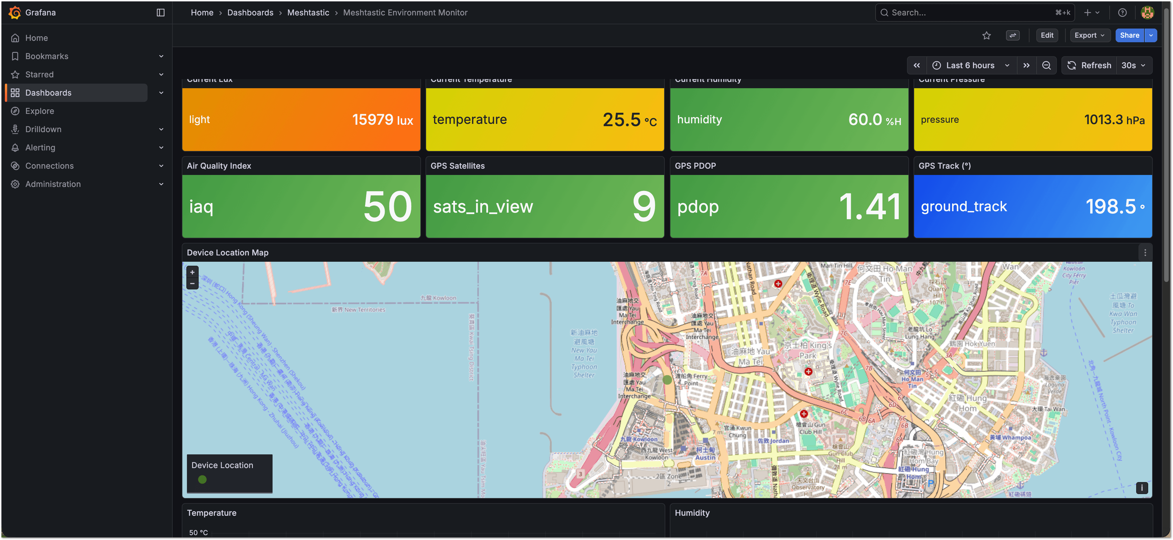

Figure 1: Grafana Dashboard- Click Meshtastic Environment Monitor.
Figure 1: Meshtastic environment monitoring dashboard in GrafanaTroubleshooting

Node-RED Can't Connect to InfluxDB
- Verify InfluxDB is running:
systemctl status influxdb - Check the token is correct in Node-RED.
- Verify organization name matches (default: "meshtastic").

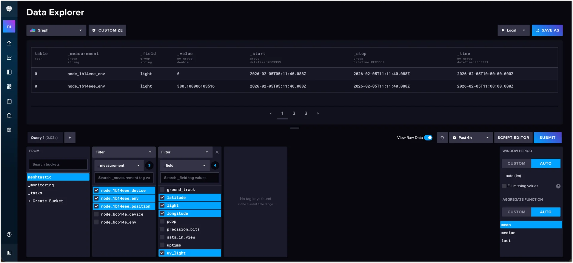

Grafana Shows No Data
- Check data source configuration:
- Go to Connections → Data Sources → InfluxDB
- Click Save & Test
- Verify data is being written:
- Open InfluxDB UI at
http://<Pi-IP>:8086 - Go to Data Explorer
- Query the "meshtastic" bucket
Figure 1: InfluxDB data explorer- Check Node-RED debug output for errors
