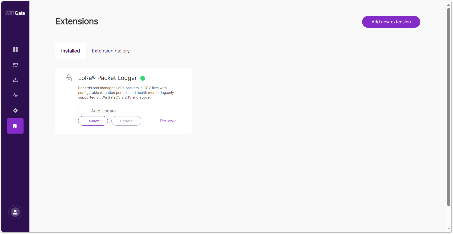

- Once installed, go to the Installed tab where the newly installed extension should now be visible.

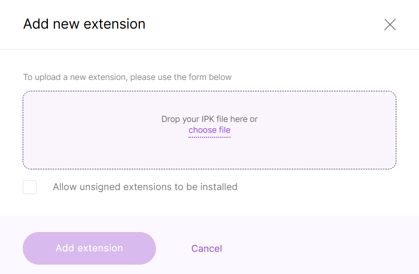

In addition to the Extension Gallery, users can manually upload a custom extension package in .ipk format.
- In the Extensions tab, click Add new extension.
- Drag and drop your
.ipkfile into the upload area, or click choose file to select it manually.
Figure 1: Add an extension file- Check Allow unsigned extensions to be installed if you want to install an unsigned package.
- Click Add extension to complete the installation.

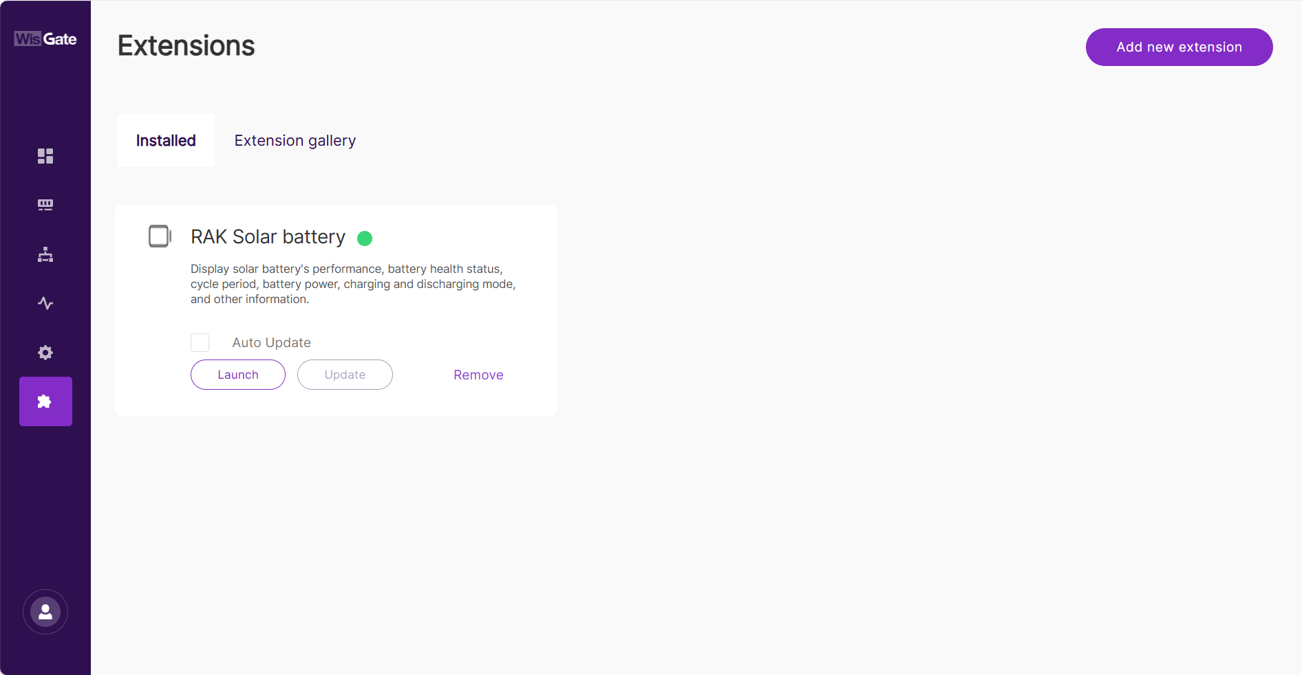

RAK Solar Battery
The RAK Solar Battery extension is used to display the operational status information of the solar battery used by the gateway. This includes information on the performance of the solar battery, battery health status, cycle period, battery capacity, charging and discharging modes, and more.
This extension is compatible with the following gateways:
- RAK7240V2
- RAK7267
- RAK7289V2
- RAK7285
You can learn the status of the solar battery in real-time through the UI interface.
Install the RAK Solar Battery Extension
To install the extension, follow the steps in How to Add an Extension section.

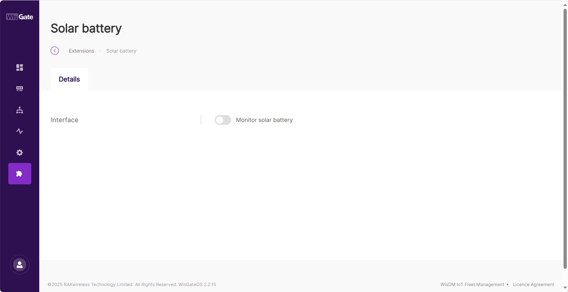

- To access the RAK Solar Battery extension, click Launch.
Figure 1: Launch the RAK Solar Battery Extension- Enable the switch to activate Monitor solar battery.
Figure 1: Overview page- When the confirmation window pops up, click Enable monitoring to activate the feature.

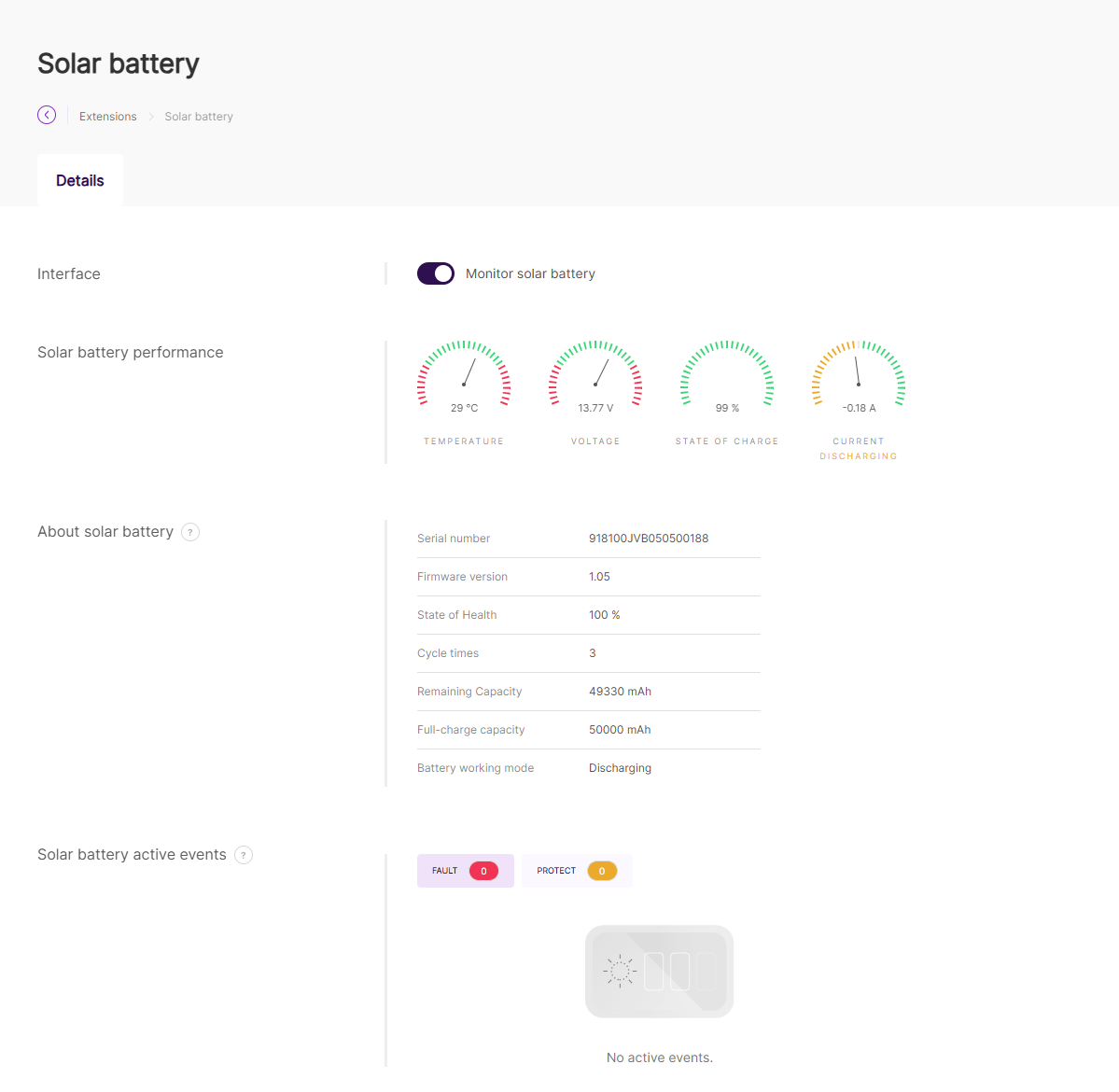

- In the Details page, you can view information about the Solar Battery.
Figure 1: Details page-
Solar battery performance: Shows the real-time performance of the battery.
- Temperature: The temperature of the battery. Used to prevent overheating or freezing.
- Voltage: The voltage level of the battery.
- State of charge: The current battery level.
- Current: Indicates whether the battery is charging or discharging.
About solar battery: Contains additional information about the battery.
- Serial number: A unique identifier for the battery.
- Firmware version: The software version of the battery management system.
- State of Health: Represents the battery's overall condition.
- Cycle times: The number of charge/recharge cycles.
- Remaining Capacity: The current available capacity of the battery.
- Full-charge capacity: The maximum capacity when the battery is fully charged.
- Battery working mode: Indicates whether the battery is charging or discharging.
Solar battery active events: Notifies users about battery-related issues.
- FAULT: The system detects a potentially damaged battery and recommends immediate replacement.
- PROTECT: The system detects a serious issue and shuts down the battery as a protective measure. Once conditions are safe, the battery resumes operation automatically.
- No active events: Indicates that the battery is operating normally without issues.

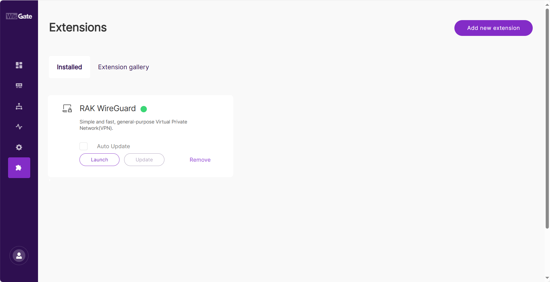

RAK WireGuard
WireGuard is a simple but fast VPN. It aims to be faster, simpler, and leaner than the IPsec protocol. It intends to be more performant than the well-known RAKwireless - OpenVPN. Before, it was not possible to use the WireGuard protocol on the RAKwireless gateways, but that is not the case now.
The new WisGateOS 2 now offers Extension features, where you can install and set up the WireGuard extension. In this tutorial, you will learn how to set the WireGuard client on the gateway.
This guide assumes that you have some knowledge in setting up a WireGuard server and have a WireGuard server set up.
Install the RAK WireGuard Extension
Configure the RAK WireGuard Extension
- To access the RAK WireGuard extension, click Launch.
Figure 1: Launch the RAK WireGuard Extension- In the Configuration page, enable the Enable WireGuard switch and configure the following information:

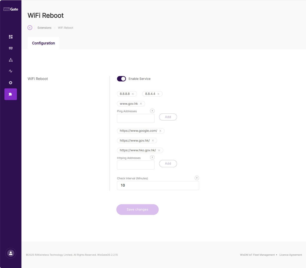

Configure the Wi-Fi Reboot Extension
- To access the Wi-Fi Reboot extension, click Launch.
- On the configuration page, configure the following parameters.
Figure 1: Configuration page| Field | Description |
| Enable Service | Toggle to enable or disable the WiFi Reboot extension. Enabled by default. |
| Ping Addresses | Define one or more IP addresses or domain names to be used for ICMP ping tests. These addresses help determine whether the gateway can reach the outside network. Examples: 8.8.8.8 (Google DNS)8.8.4.4 (Google DNS Backup)www.gov.hk (HK Government)Can be public or private IPs. ⚠️ WARNING Avoid incorrect or unreachable entries to prevent false positives and unnecessary reboots. |
| Httping Addresses | Define one or more full URLs (must include http:// or https://) for HTTP-based service availability testing.Examples: https://www.google.com/https://www.gov.hk/https://www.hko.gov.hk/URLs can point to internal status pages or public web services. ⚠️ WARNING Only HTTP/HTTPS is supported (no FTP, RTSP). Pages must return status code 200 to be considered successful. |
| Check Interval (Minutes) | Determines how often the extension checks Wi-Fi connectivity. Recommended value: 10 minutes by default. |
- To save the changes, click Save changes.

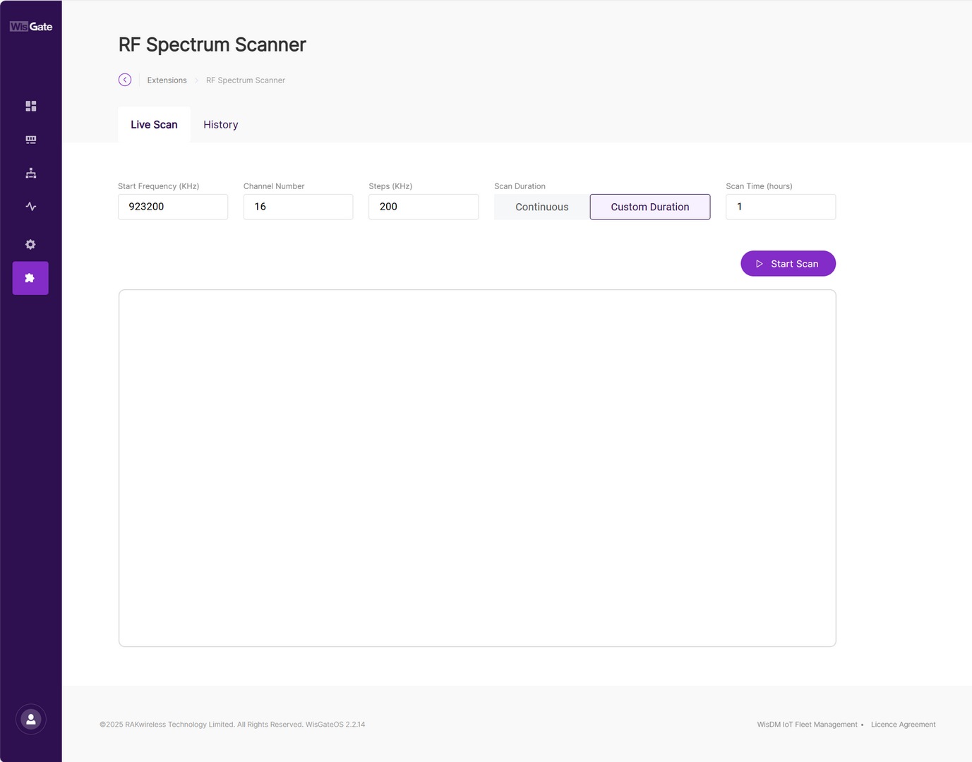

- To access the RF Spectrum Scanner extension, click Launch.
- In the Live Scan tab, configure the following scan parameters:
Figure 1: Configuration parameters| Field | Description | Valid Range / Notes |
| Start Frequency (KHz) | Starting frequency of the scan range | 863000~925000 kHz (must be within gateway RF band) |
| Channel Number | Total number of frequency points (channels) to scan | Must be an integer ≥1 and ≤32 |
| Steps (KHz) | Frequency increment between each channel | 10~500 kHz |
| Scan Duration | Determines how long the scan runs |
| Scan Time (hours) | Duration of scan if Custom Duration is selected | Integer from 1 to 168 |
- Click Start Scan to initiate the scan.
- A confirmation dialog will appear. Click Confirm to proceed.
- Once scanning begins, a real-time chart appears showing signal strength across the scanned frequency range:
- X-Axis (MHz): Shows the frequency range being scanned.
- Y-Axis (RSSI in dBm): Displays signal strength levels for each frequency point.
- Current Value (Blue Line): Live RSSI readings captured during the current scan cycle.
- Average Value (Green Line): Running average of RSSI values since the scan started.
- Download Icon: Click to save the current chart as a PNG image.
- Stop Scan: Click to end the ongoing scan.

Install the LoRa® Packet Logger Extension
Configure the LoRa® Packet Logger Extension

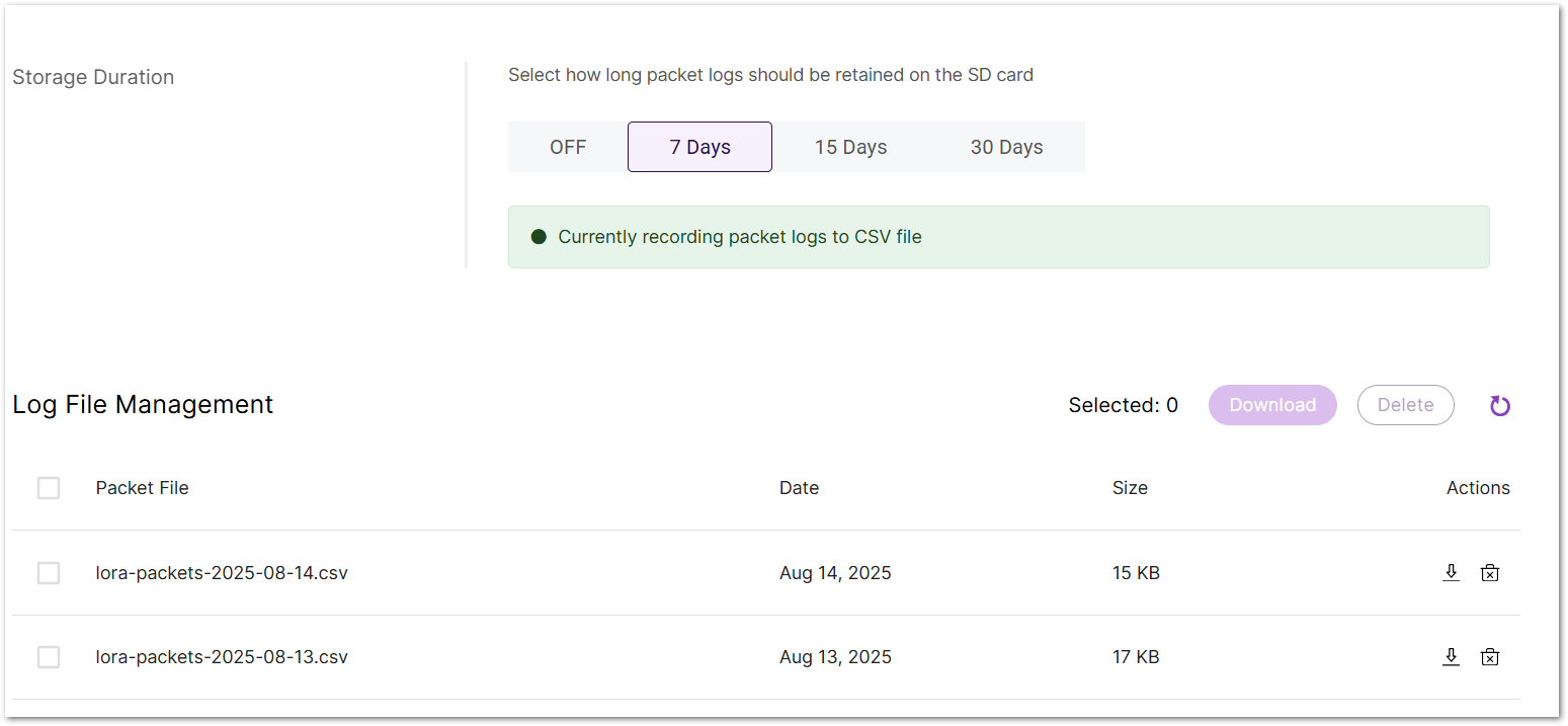

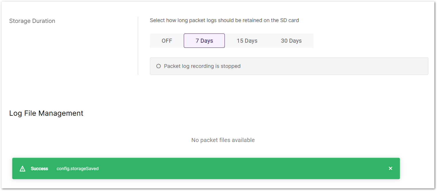

- To access the LoRa® Packet Logger extension, click Launch.
Figure 1: Extensions tab- In Storage Duration, select how long to keep the LoRa logs. The configuration saves automatically after selection.
Figure 1: Set storage duration- OFF
- 7 Days
- 15 Days
- 30 Days
- When the status shows Currently recording packet logs to CSV file, the logger is active. Log files will appear under Log File Management, named as
lora-packets-YYYY-MM-DD.csv.
Figure 1: Recoding Packet LogsManage Packet Logs
- In Log File Management, check the box log files to select them.
Figure 1: Manage Packet Logs- Click Download to save the selected files to your local device, or Delete to remove them from the gateway.
To download or delete a single file, click the corresponding
or
icon under the Actions column.

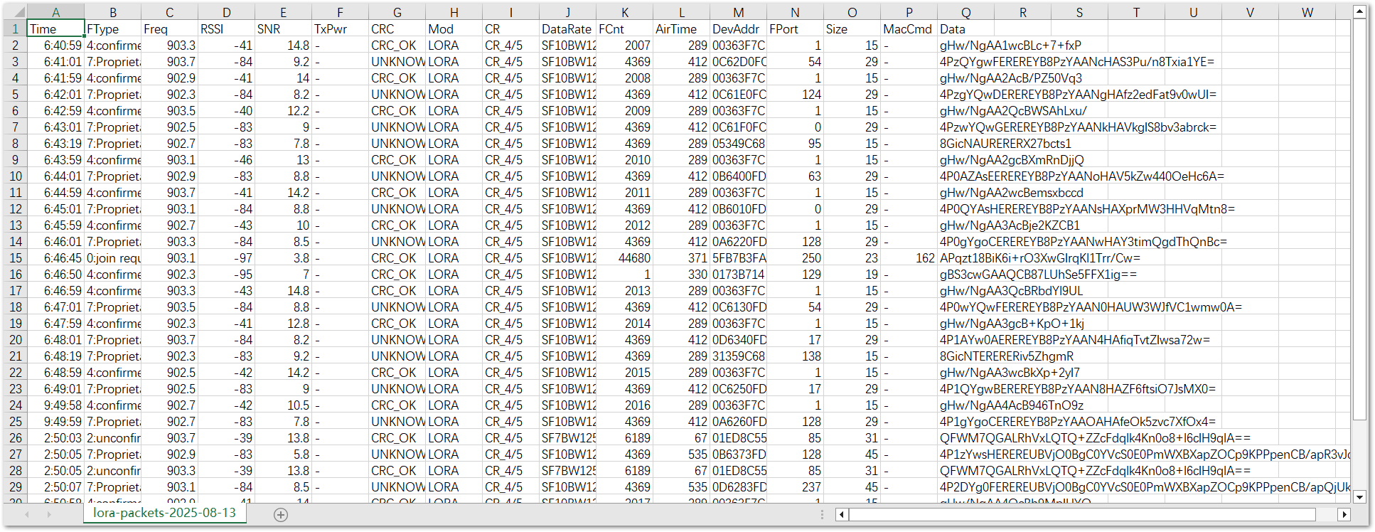

Viewing CSV Files
Open the downloaded CSV file to view the recorded packet logs.
Figure 1: Check LogsThe downloaded CSV file contains the following columns:
| Field Name | Description |
| Time | Local time when the packet was received or transmitted by the gateway. |
| FType | Frame type and direction. |
| Freq | Center frequency (MHz) at which the packet was transmitted or received. |
| RSSI | Received Signal Strength Indicator (dBm); values closer to 0 indicate stronger signals. |
| SNR | Signal-to-Noise Ratio (dB), reflecting signal quality. |
| TxPwr | Transmit power (dBm); - means not recorded for uplink packets. |
| CRC | CRC check result (CRC_OK means passed, UNKNOWN means no CRC or undetectable). |
| Mod | Modulation type, e.g., LORA for LoRa modulation. |
| CR | Coding rate, e.g., CR_4/5. |
| DataRate | Data rate, e.g., SF10BW125 means spreading factor SF10 and bandwidth 125 kHz. |
| FCnt | Frame counter. |
| AirTime | Airtime (ms), the duration the packet occupies the radio channel. |
| DevAddr | LoRaWAN device address (hexadecimal). |
| FPort | LoRaWAN port number. |
| Size | Payload size in bytes. |
| MacCmd | MAC command(s), if present. |
| Data | Payload in Base64 encoding. |
