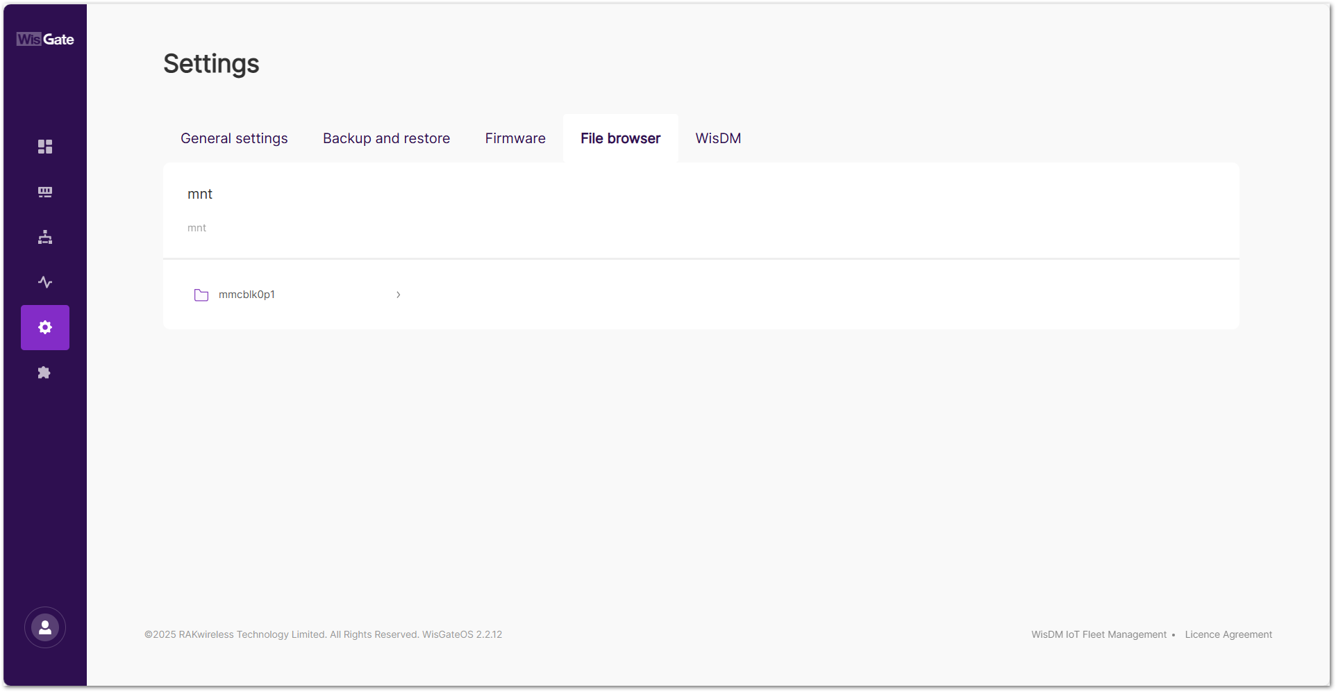

To download system logs, follow these steps:
- Navigate to Settings > File browser.

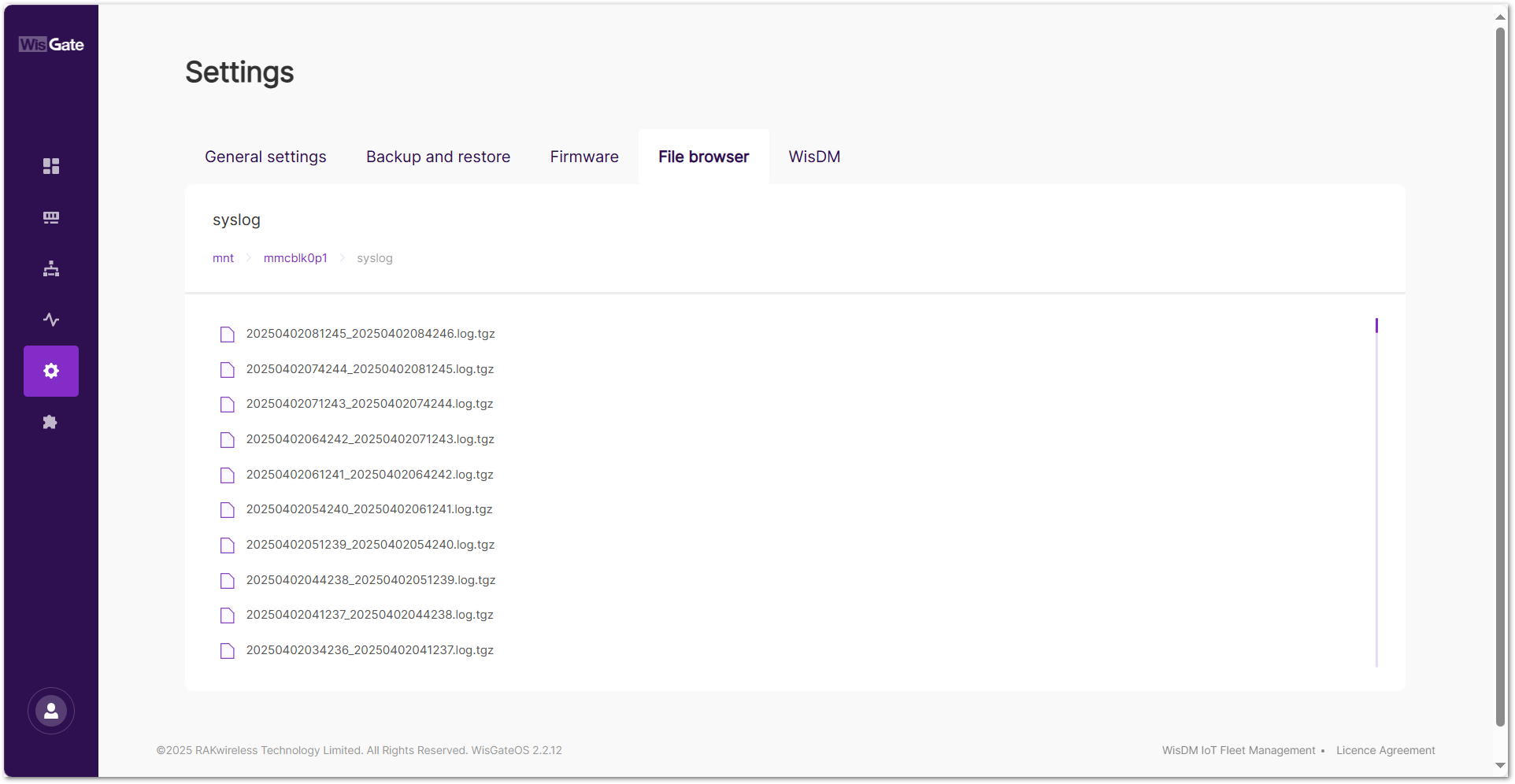

Figure 1: File browser- Go to mmcblk0p1 > syslog.
Figure 1: syslog- Select the log file based on the timestamp and click to download.

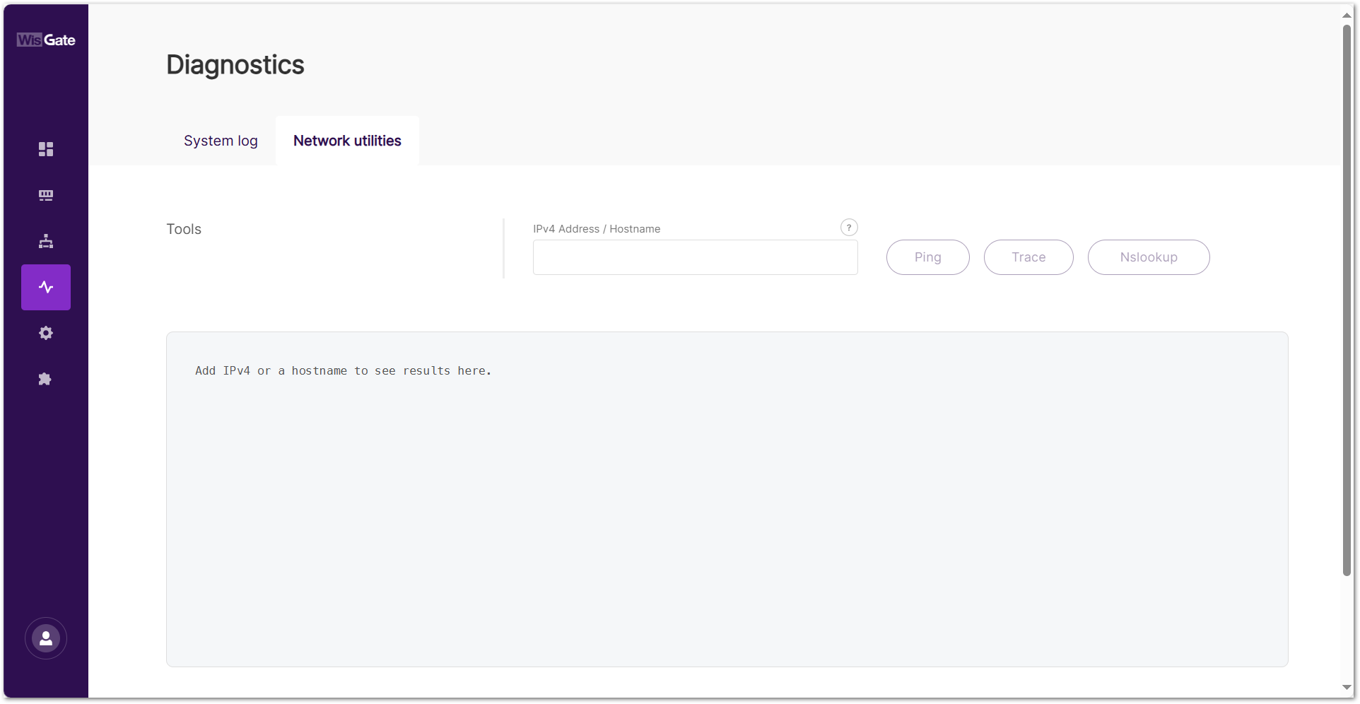

Network Utilities
The Network utilities page provides built-in diagnostic tools for network troubleshooting. These tools allow you to check connectivity, trace network routes, and perform DNS lookups directly from the gateway.
Figure 1: Network utilities tabAvailable Tools
- Ping: Tests the reachability of a host by sending ICMP echo request packets and measuring response times. This helps determine if a device or server is online.
- Trace: Displays the route packets take to reach a destination, showing the intermediate hops. Useful for identifying network latency or connection issues.
- Nslookup: Queries the Domain Name System (DNS) to obtain the IP address corresponding to a domain name or vice versa.
How to Use
Enter an IPv4 Address or Hostname in the input field.
NOTEFor Nslookup, only a domain name is allowed.
Pick your desired tool:
- Ping to check connectivity.
- Trace to view the routing path.
- Nslookup to resolve domain names.
The results will be displayed in the console output area below.
