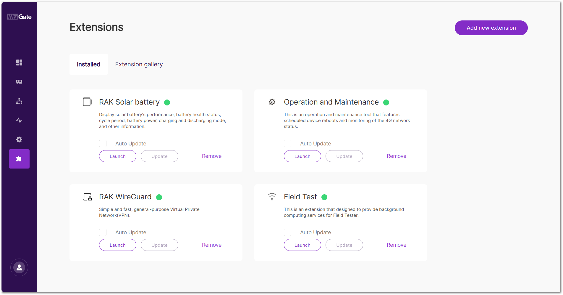

Extensions
WisGateOS 2 supports extensions, which provides additional features and functions that can be added, removed, or updated based on your needs.
Figure 1: ExtensionsSupported Extensions
