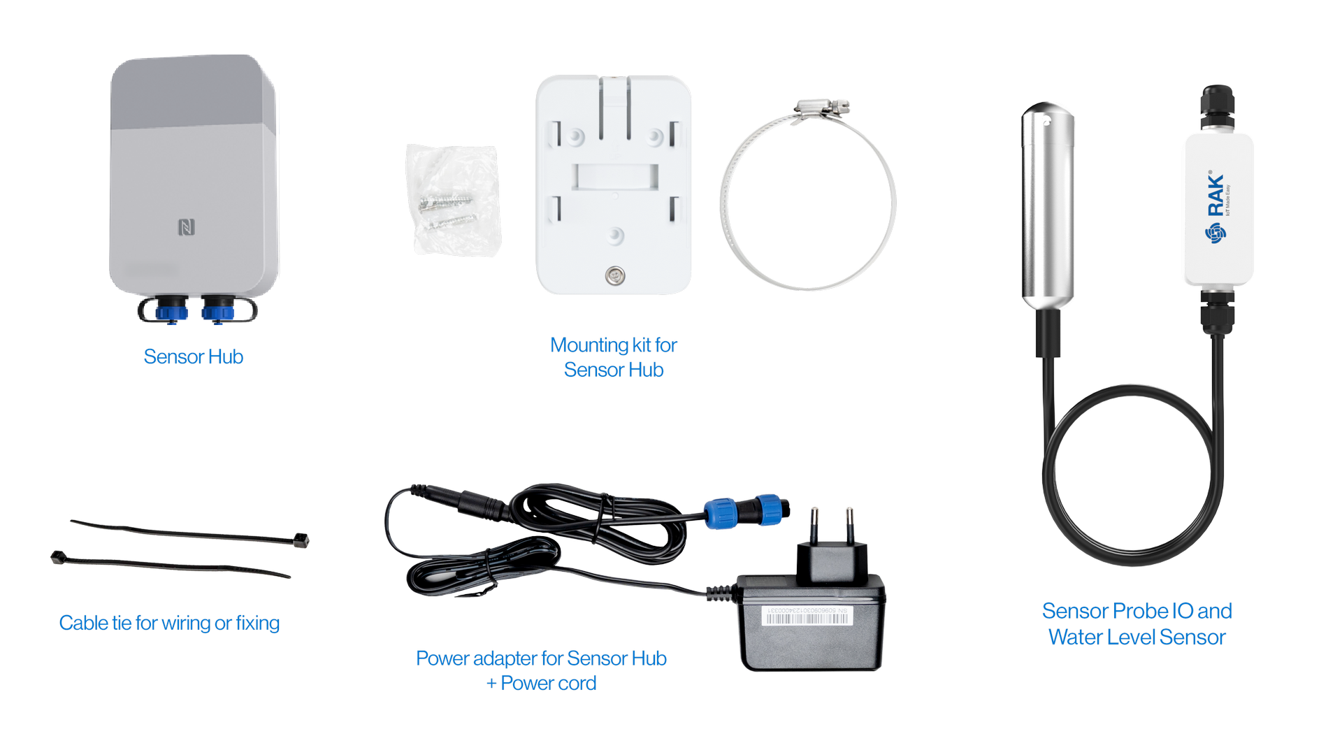

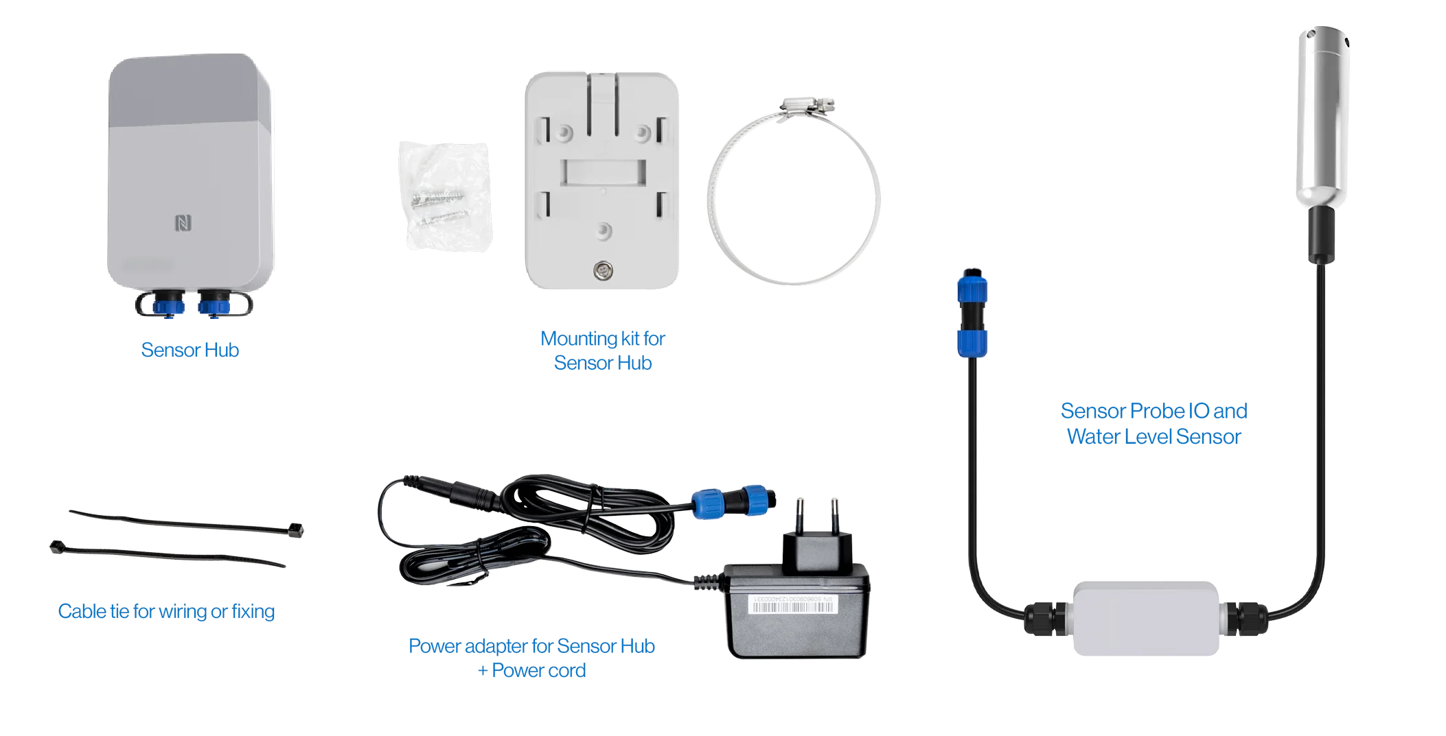

Before proceeding with each step of using the Water Level Monitoring Solutions, ensure that you have the necessary items.
Figure 1: Solutions package inclusionHardware Tools
- Sensor Hub Water Level Monitoring Solution
- Solar Battery Lite for Sensor Hub (Optional)
- Additional accessories: Probe Cable, Probe Splitter, Power Supply, and others (numbers and variations depending on the use case)

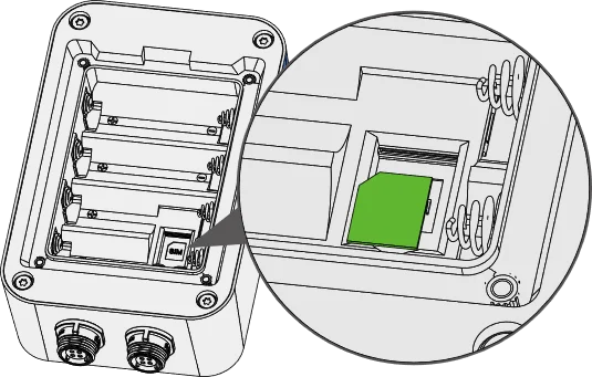

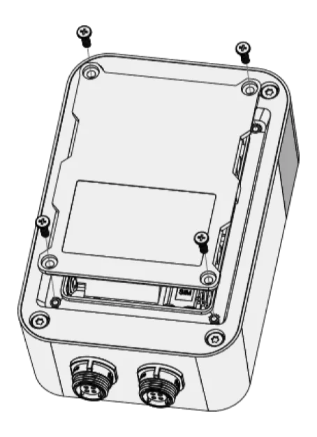

SIM Card Installation

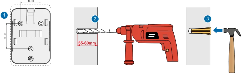

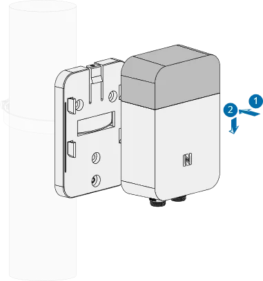

Wall Mounting

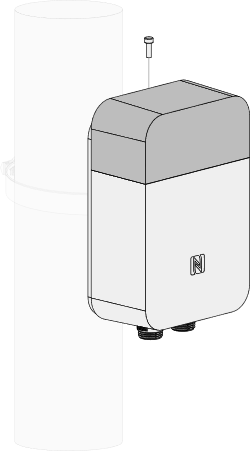

Figure 1: Installation preparation- Secure the mounting bracket to the wall by using self-tapping screws.

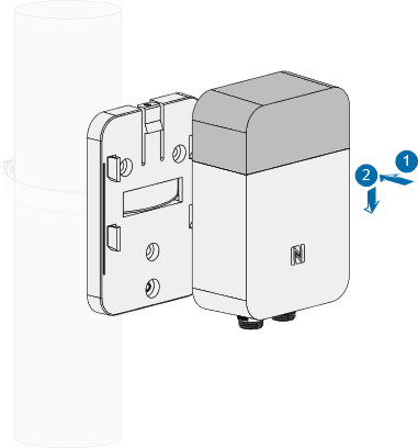

- Fix the mounting bracket to the pole using a steel strap.
Figure 1: Fix the mounting bracketMount the bracket on a pole with a 50-80 mm diameter. For larger poles, use a bigger steel strap. The standard kit does not include a larger steel strap. Purchase separately if needed.

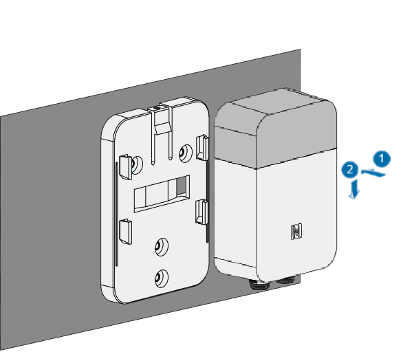

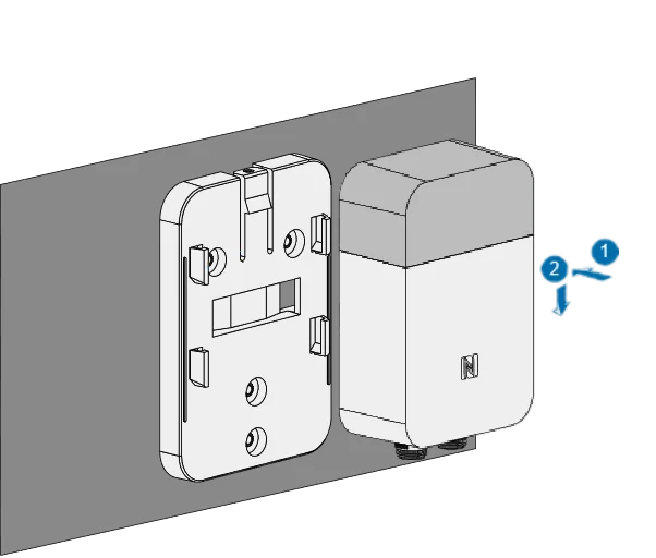

- Align the hanging tabs of the device with the slots on the bracket, then insert the tabs into the slots. Gently pull the device downwards until it securely snaps into place.
Figure 1: Fasten the device and the bracketRAK2560 WisNode Sensor Hub + Water Level Sensor Setup

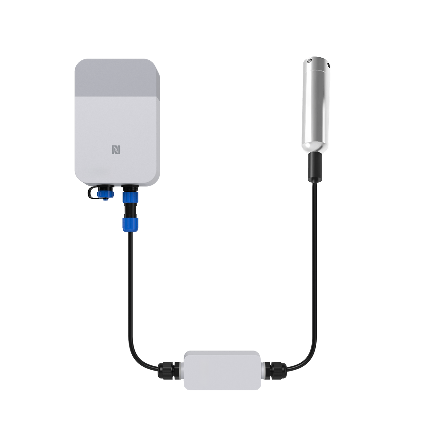

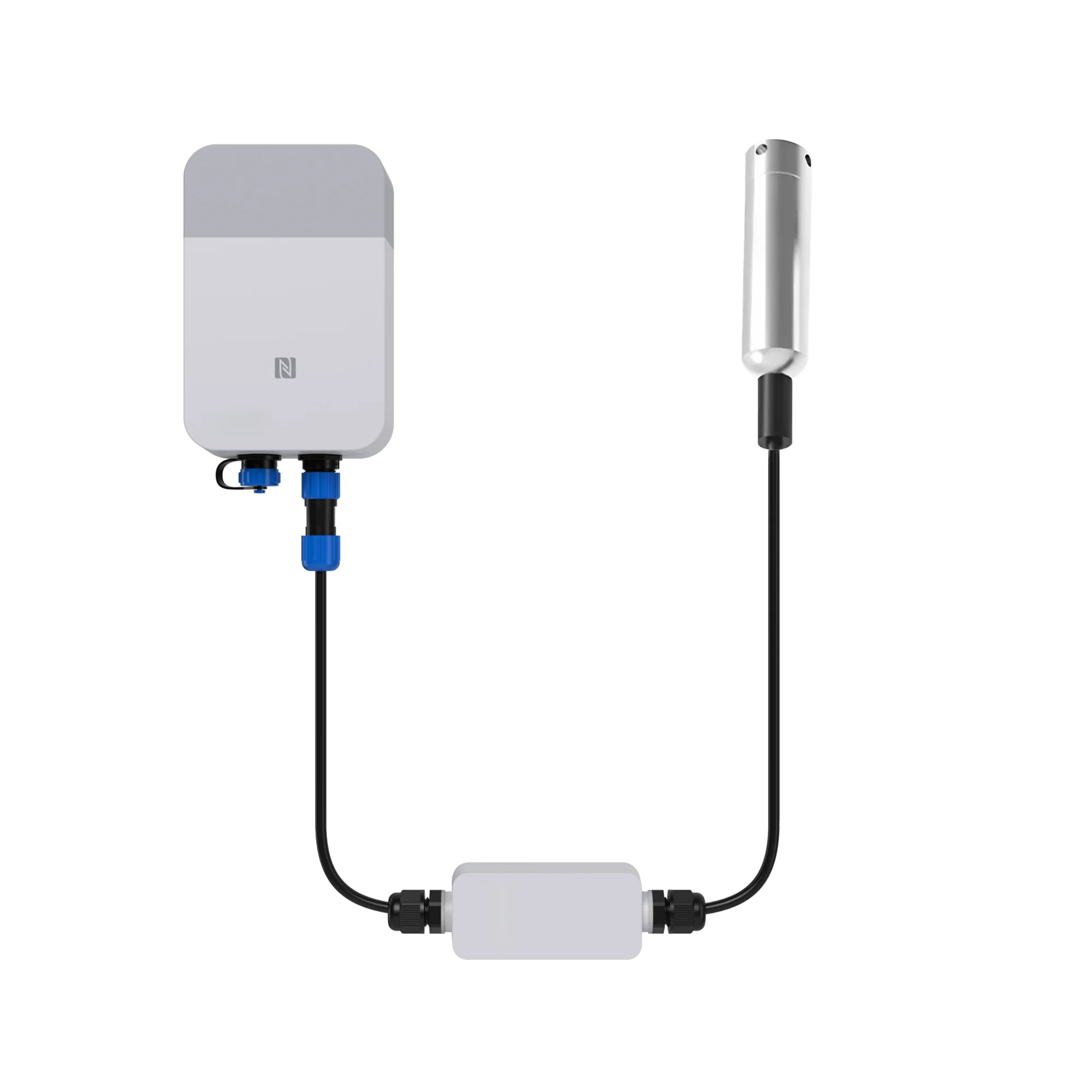

Sensor Probe IO + Water Level Sensor Installation
The Water Level Sensor comes pre-assembled with the Sensor Probe IO by default at the factory, so no additional assembly is required.
Figure 1: Sensor Probe IO and Water Level SensorSensor Hub + Sensor Probe IO + Water Level Sensor Installation

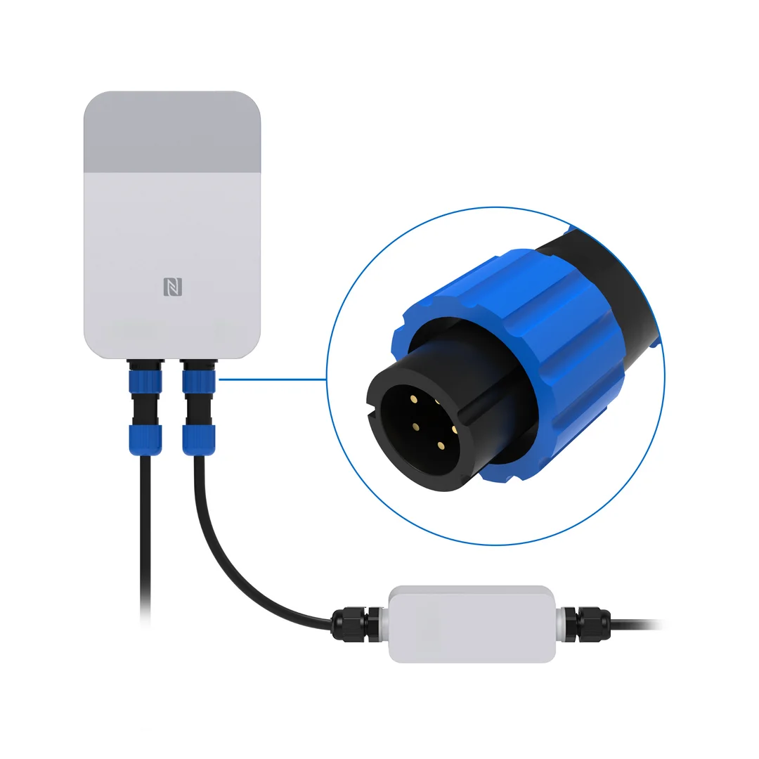

- Connect the Sensor Probe IO to the SensorHub using the SP11 connector.
- Align the white dot mark on the Sensor Probe IO SP11 connector plug with the white dot mark on the SensorHub SP11 connector socket, and push the plug firmly into the socket.
- Once connected, tighten the locking nut to secure the SP11 connector. The Sensor Probe IO can be linked to any Sensor Hub SP11 connector port. Refer to the actual use and connect to the appropriate port as illustrated in Figure 11.
Figure 1: Connect the Sensor Probe IO

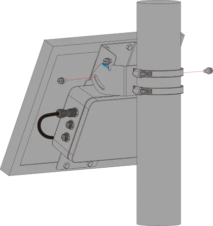

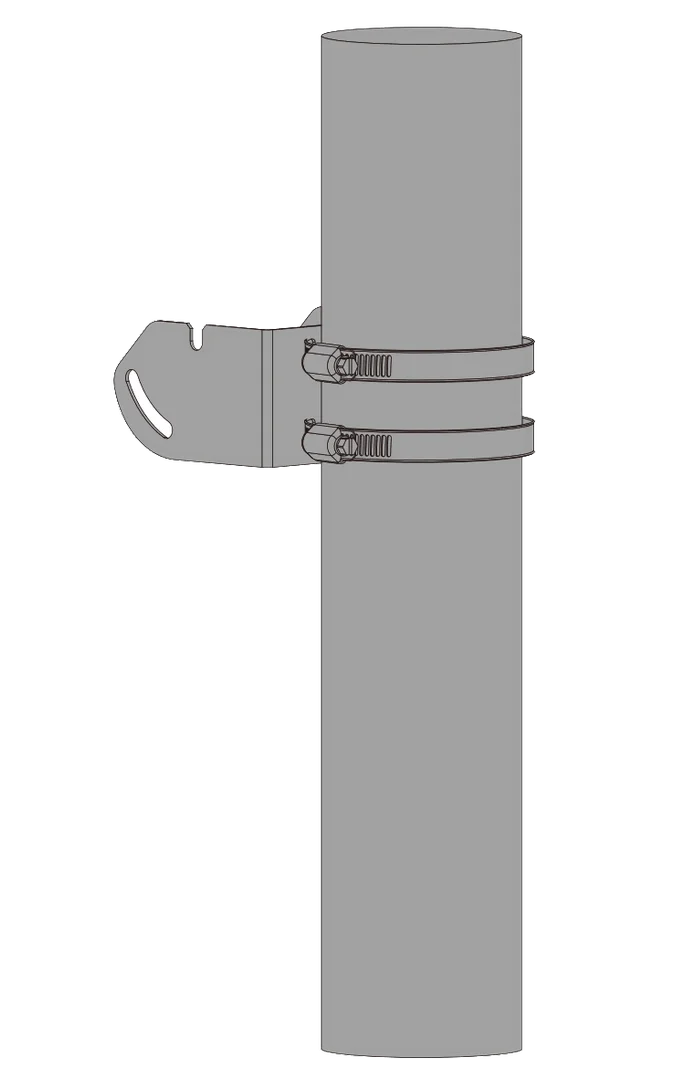

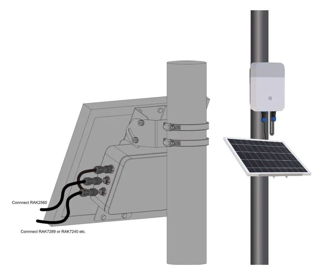

- Secure the mounting bracket to the pole using two steel straps.

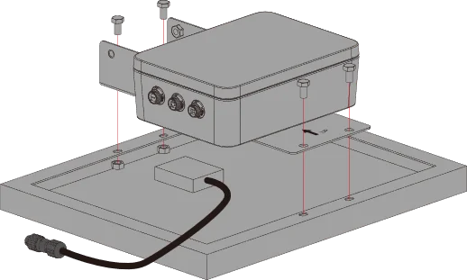

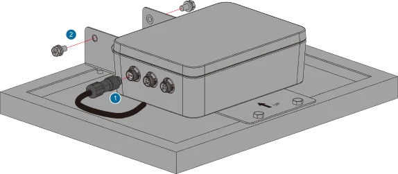

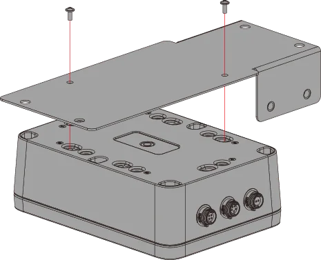

Figure 1: Secure the mounting bracket- Attach the mounting plate to RAK9154 using two (2) M3 screws.
Figure 1: Attach the mounting plate- Install the RAK9154 to the back of the solar panel using four (4) screws and nuts.
Figure 1: Attach the RAK9154 to solar panel- Connect the cable from the solar panel to the PV Input connector of RAK9154. Install two (2) M6 screws on the mounting plate with a clearance of about 3 mm.
Figure 1: RAK9154 and Solar Panel Connection- Suspend the solar panel on the mounting bracket, adjust its angle and direction, and then secure it by tightening the two (2) M6 screws along with the remaining two screws.
Figure 1: Install the solar panel combination- Connect the Sensor Hub to the RAK9154. Use a cable to link the remaining connection ports of the Sensor Hub to the Output 1 SP11 connection port of the RAK9154.
Figure 1: Connect Sensor Hub and RAK9154- Once the connection is complete, the Sensor Hub is ready to be powered up.

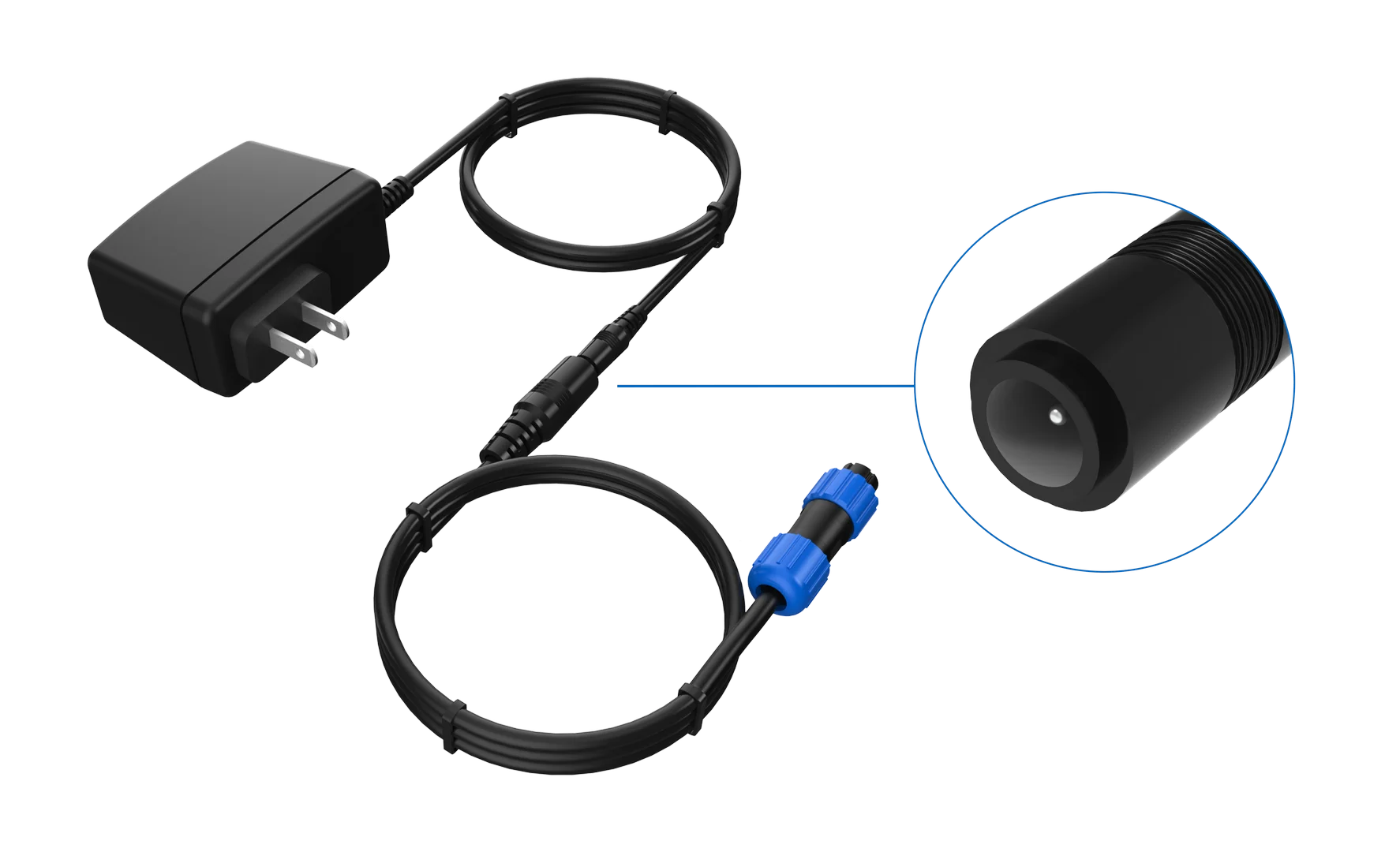

- Connect the power adapter and the external power cable of the Sensor Hub through the circular DC interface.
Figure 1: Power adapter connection-

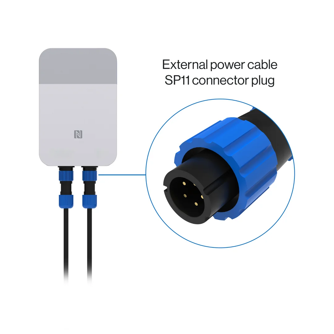

Connect the external power cable to the Sensor Hub through the SP11 connector.
Align the white dot mark on the SP11 connector plug of the external power cable with the white dot mark on the Sensor Hub SP11 connector socket, and push the plug in firmly into the socket.
After the plug and socket are connected, tighten the locking nut to secure the SP11 connector. The external power cable can connect to any Sensor Hub connection port.

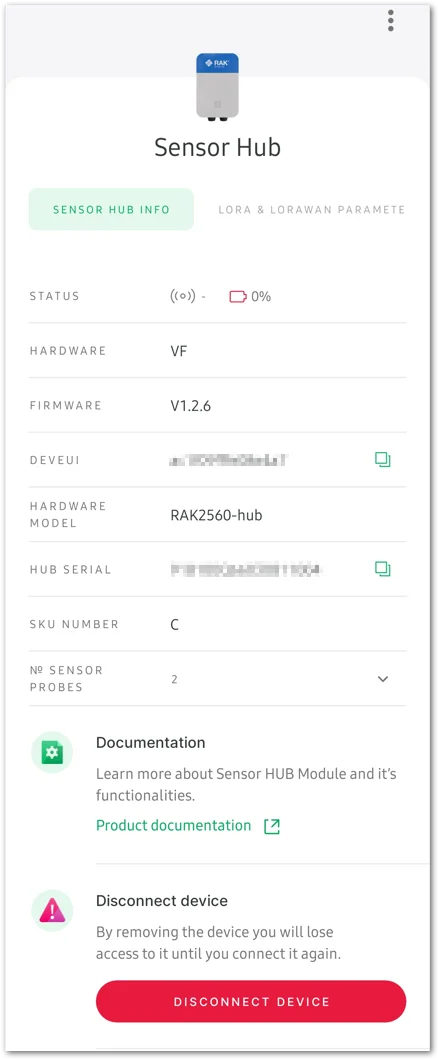

Power Up Sensor Hub

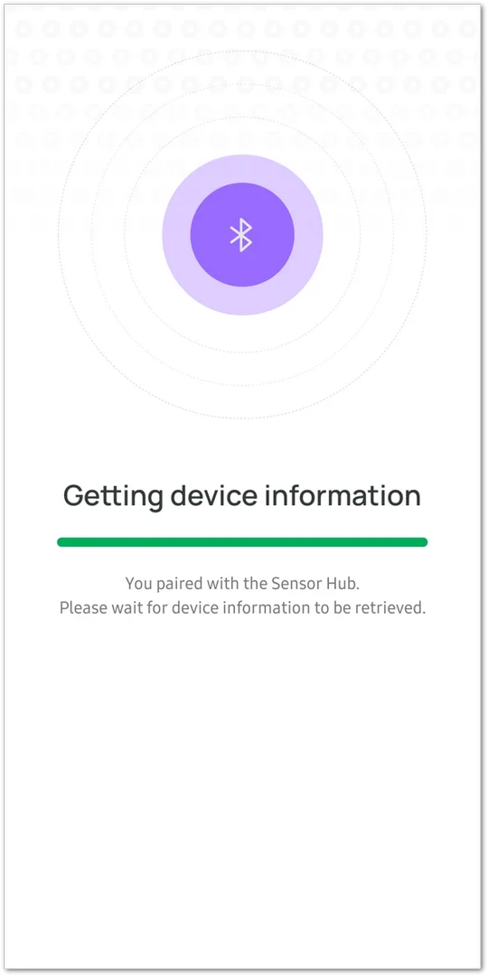

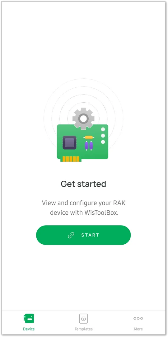

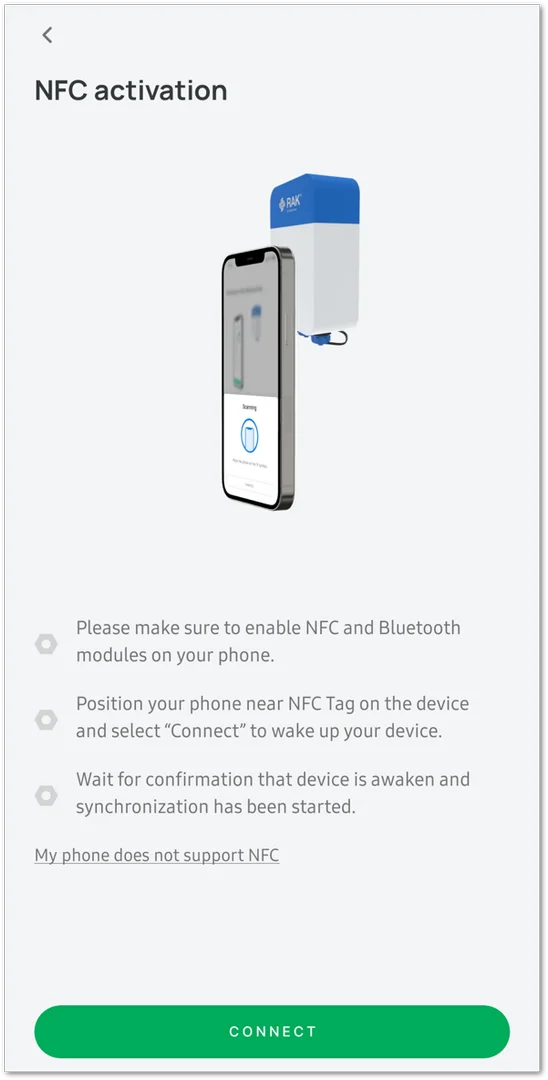

- Download and install the WisToolBox app on your smart mobile device. The WisToolBox app is available for download from the Apple App Store and the Android Google Play Store.

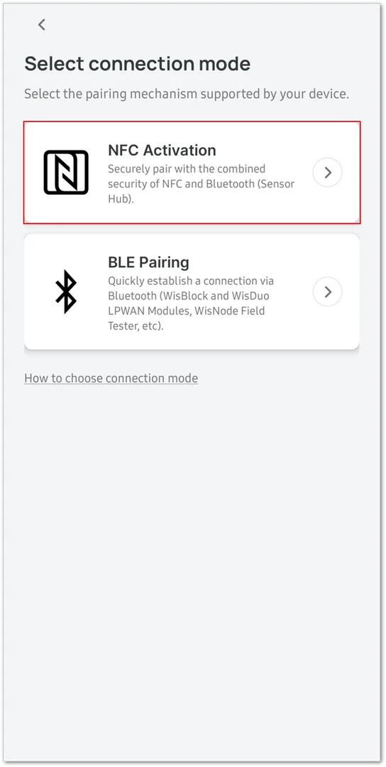

- Initiate the app and confirm that NFC and Bluetooth are enabled on your mobile device. Click on START.
Figure 1: Start the App- On the Select connection mode menu, choose NFC Activation.
Figure 1: Click on the CONNECT button- Hold your mobile device close to the N symbol on the SensorHub device.
Figure 1: Uplink Settings option- Once configured, click SAVE SELECTION and then the APPLY button to implement the configuration options.

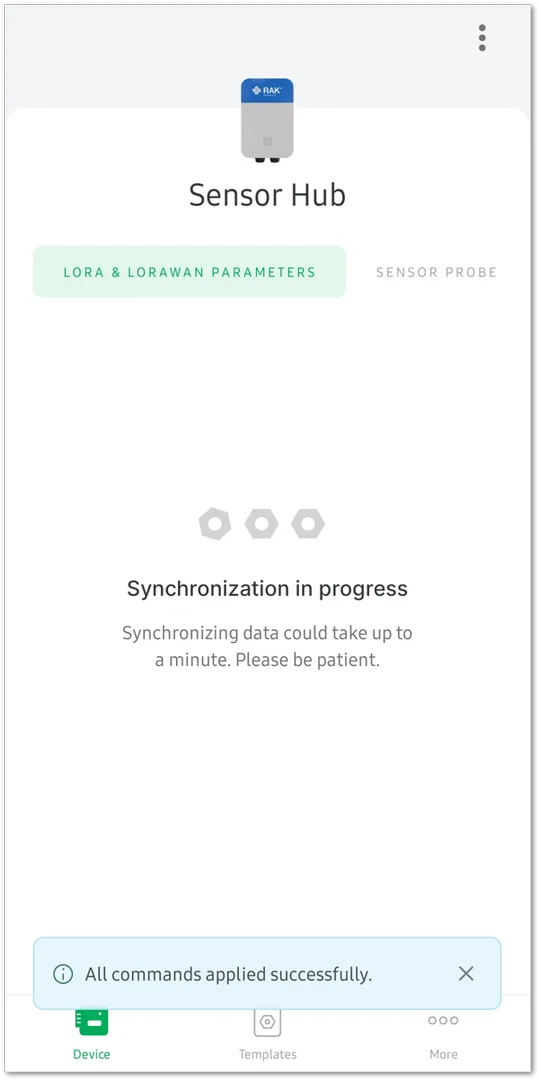

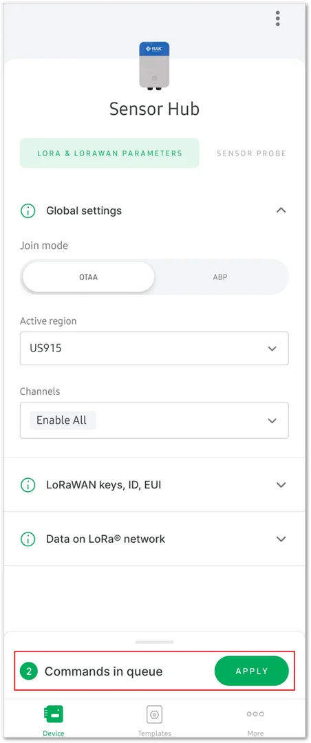

- Click on the LORA & LORAWAN PARAMETERS tab. Configure the following parameters:
Figure 1: Global Settings- Join Mode: Configure the Join mode based on the device's network access mode: Over-The-Air Activation (OTAA) or Activation By Personalization (ABP). Make sure it matches the join mode registered on the network server.
- Active Region: Set the Active region to the device's frequency plan. Ensure that it is consistent with the gateway and device frequency plan registered on the network server. Supported frequency bands include CN470, RU864, IN865, EU868, US915, AU915, KR920, AS923-1/2/3/4.
- For the OTAA join mode, configure the following parameters: Application EUI, Application key, and Device EUI.
Figure 1: LoRaWAN parameters-
Application EUI: Confirm that it matches the device's Application EUI as registered in the network server.
Application key: Verify its alignment with the device's Application key registered in the network server. Click GENERATE KEY to create a new key if needed.
Device EUI: Confirm that it matches the device's EUI as registered in the network server.

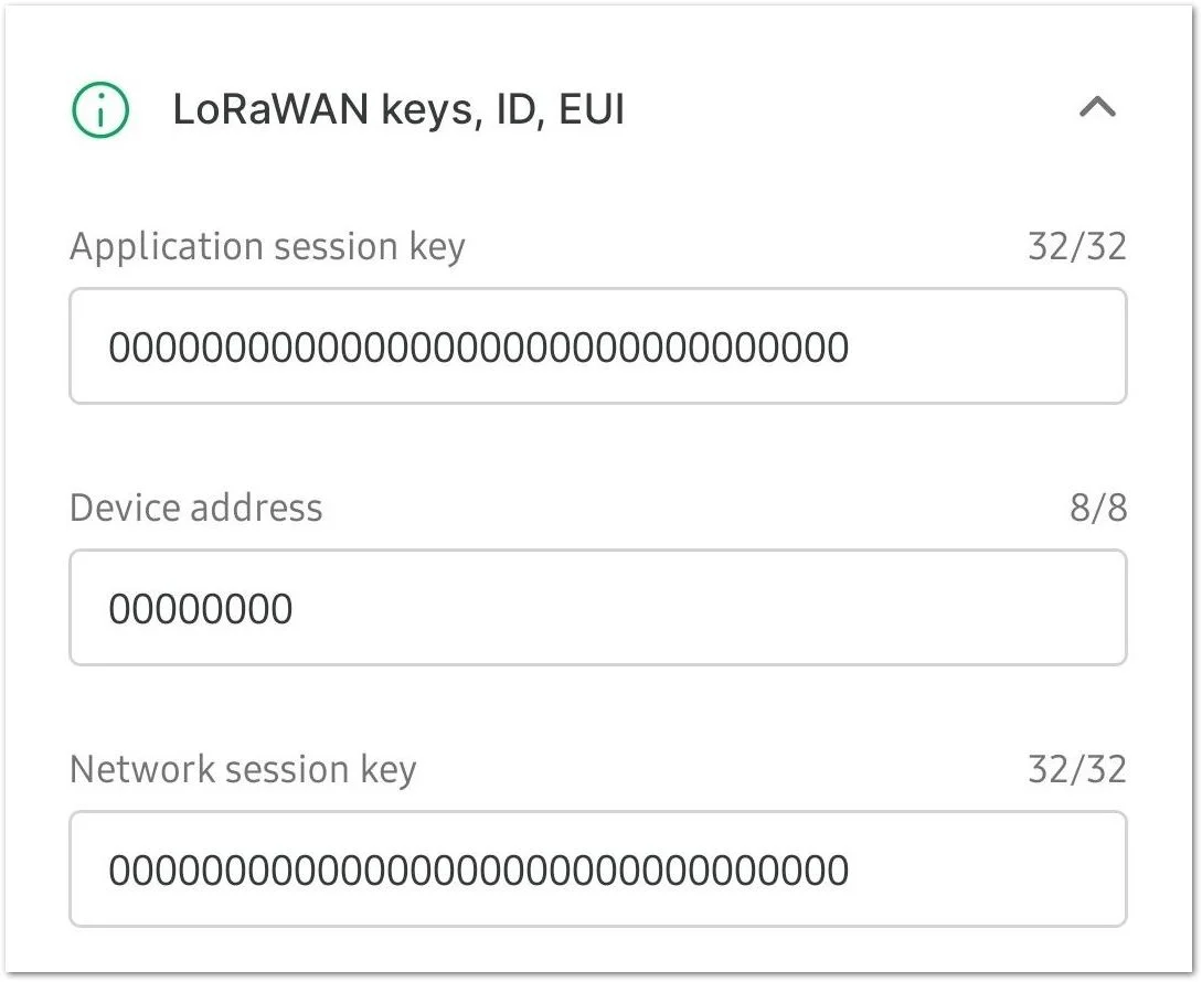

For the ABP join mode, configure the following parameters: Application session key, Device address, and Network session key.
Figure 1: Data on LoRa® network- Confirm mode: Message confirmation mode.
- JOIN NETWORK: Once the network parameter configuration is finished, click the JOIN NETWORK button to instruct the device to execute the join network command.
- After clicking JOIN NETWORK, a message Message sent will appear, indicating that the join network command has been sent.

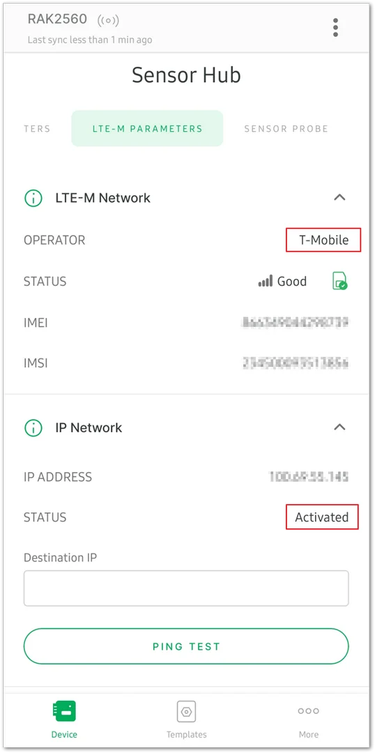

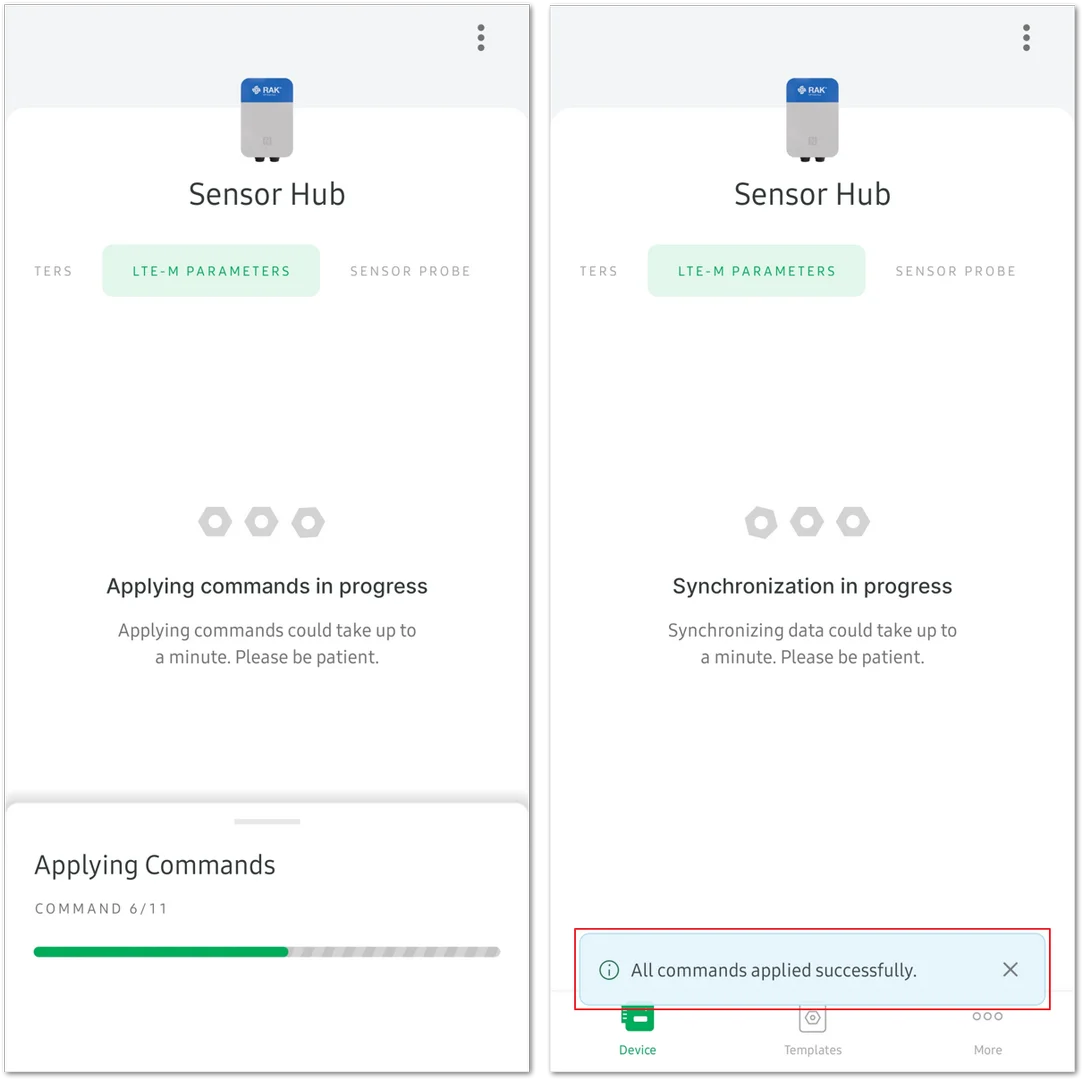

- Click the LTE-M PARAMETERS tab. Check the following parameters to ensure the normal use of the network.
Figure 1: View the NB-IOT PARAMETERS tab parameters- OPERATOR: Shows the Network operator. If the operator's name is displayed, it indicates that the device has recognized the SIM card. For example, T-Mobile.

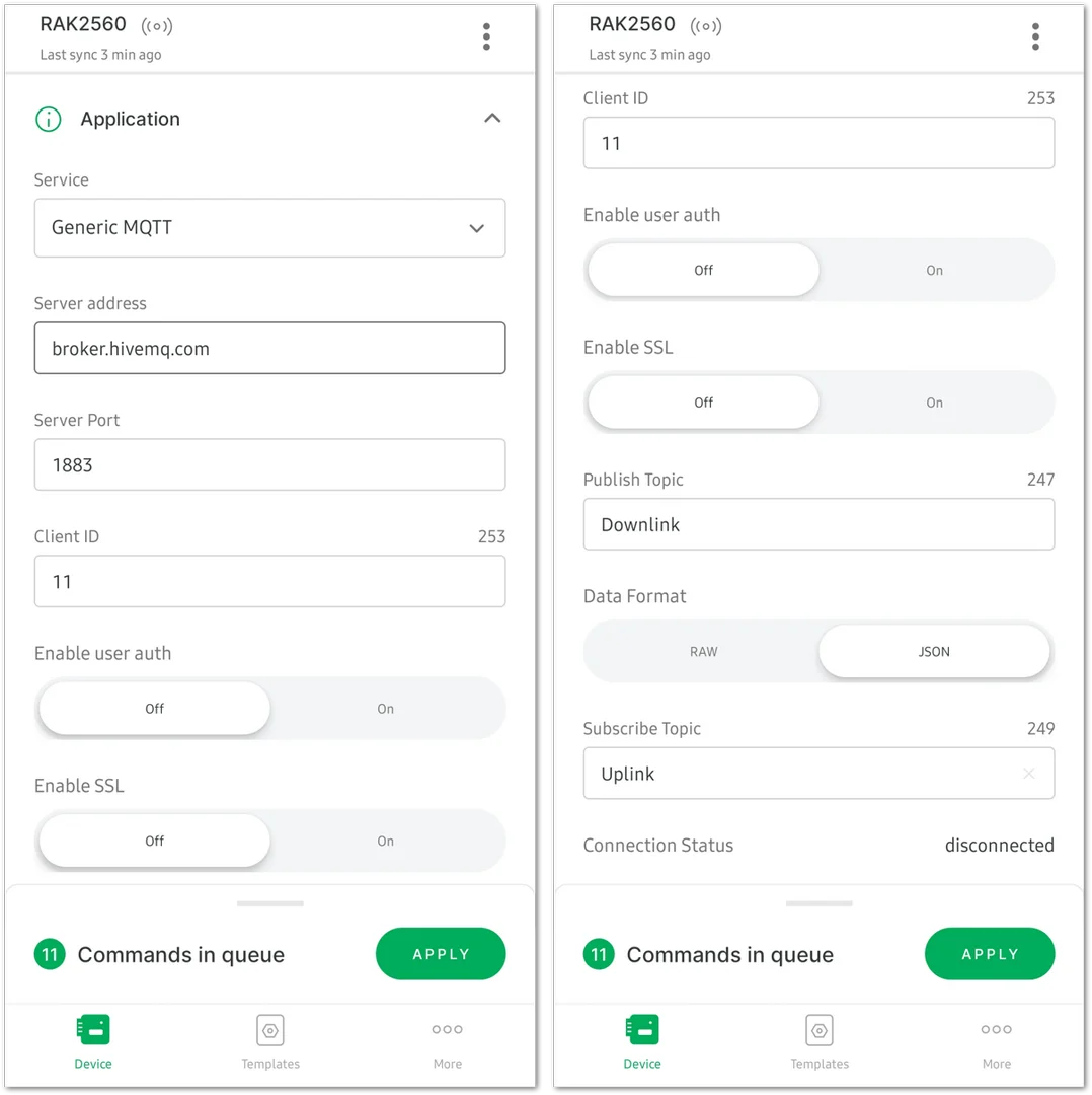

- Select the Application option to set up the cellular network parameters.
Figure 1: Configure the cellular network parameters- Service: choose a service, either AWS IoT Core or Generic MQTT. Let's take Generic MQTT as an example.
- Server address: input the server address. Using the external MQTT broker as an example, enter
broker.hivemq.com. Enter the address based on your specific use case. - Server Port: specify the server port according to your configuration.
- Client ID: set the client ID for your device.
- Enable user auth: decide whether to activate user authentication for your device.
- Enable SSL: decide whether to activate SSL (Secure Sockets Layer) for secure communication.
- Publish Topic: specify the topic for publishing messages.
- Data Format: select JSON as the preferred format for data transmission.
- Subscribe Topic: subscribe to the topic for receiving incoming messages, as illustrated in this example.
Figure 1: Apply the modified configuration- When the configuration is accurate and the connection to the server is successful, the Connection Status will display as connected.

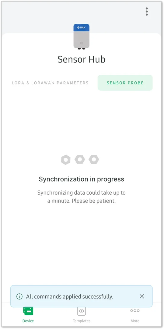

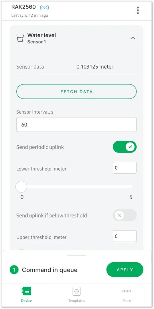

This section details the configuration process of the Water Level sensor. It shows how to access the monitoring data and device details of the Water Level sensor. Additionally, there’s an option to configure other information for each monitoring parameter, such as the uplink data sending period and threshold.

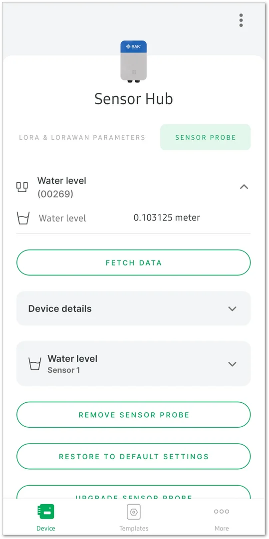

- To start with, click the SENSOR PROBE tab to display the connected water level sensor.
Figure 1: Water Level sensor- Click the dropdown arrow to expand the details of the water level sensor.

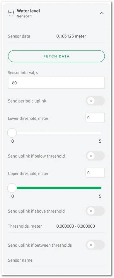

Figure 1: Sensor Information- Water level
- Device details: Device details of the Water Level sensor.
Figure 1: Sensor details- Configure the periodic uplink data sending, threshold, and other pertinent information of the sensor.
Figure 1: Set the sensor parameters- Sensor data: Information provided by the sensor.
- FETCH DATA: Retrieve the latest sensor data.
- Send uplink if value changes: Send uplink data if the sensor data changes.
- Sensor interval(s): The payload sending interval in seconds. It determines how often the sensor sends uplink data to the server, with a range interval from 60~86,400 seconds. Set this parameter when the Send periodic uplink is enabled.
- Send periodic uplink: Send uplink data periodically based on the sensor interval.
- Lower threshold, meter: Specifies the minimum acceptable water level.
- Send uplink if below threshold: Send uplink data if the value falls below the lower threshold.
- Upper threshold, meter: Maximum acceptable value.
- Send uplink if above threshold: Send uplink data if the value exceeds the upper threshold.
- Threshold, meter: Range of acceptable values.
- Send uplink if within threshold: Send uplink data if the value exceeds the upper threshold.
- After completing the modifications, a message Commands in queue will appear at the bottom of the interface. Click APPLY to send the parameter update commands.
Figure 1: Apply commands- When the message All commands applied successfully appears on the interface, it indicates that the parameter update commands have been successfully sent.
