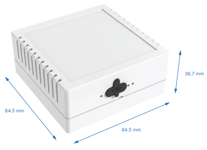

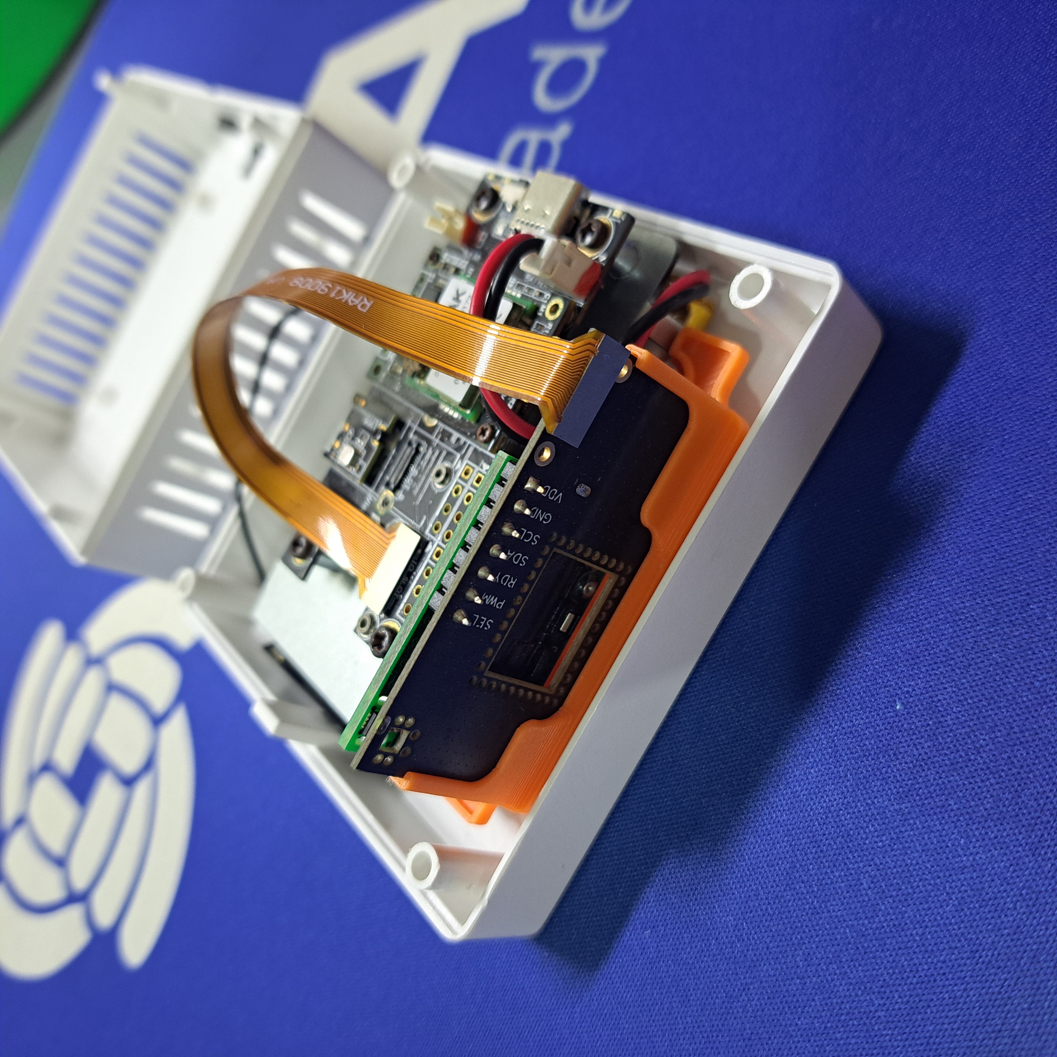

RAKwireless RAKBox-B6 - CO2 Sensor Extension
Figure 1: RAKBox-B6 | Figure 1: CO2 sensor assembly |
The RAKBox-B6 is a compact indoor enclosure designed for WisBlock-based sensors. However, it does not accommodate larger environment modules such as the RAK12037 CO2 sensor.
This extension adds support for mounting the RAK12037 to the existing B6 internal plate and allows easy connection using the RAK19008 IO Extension Cable.

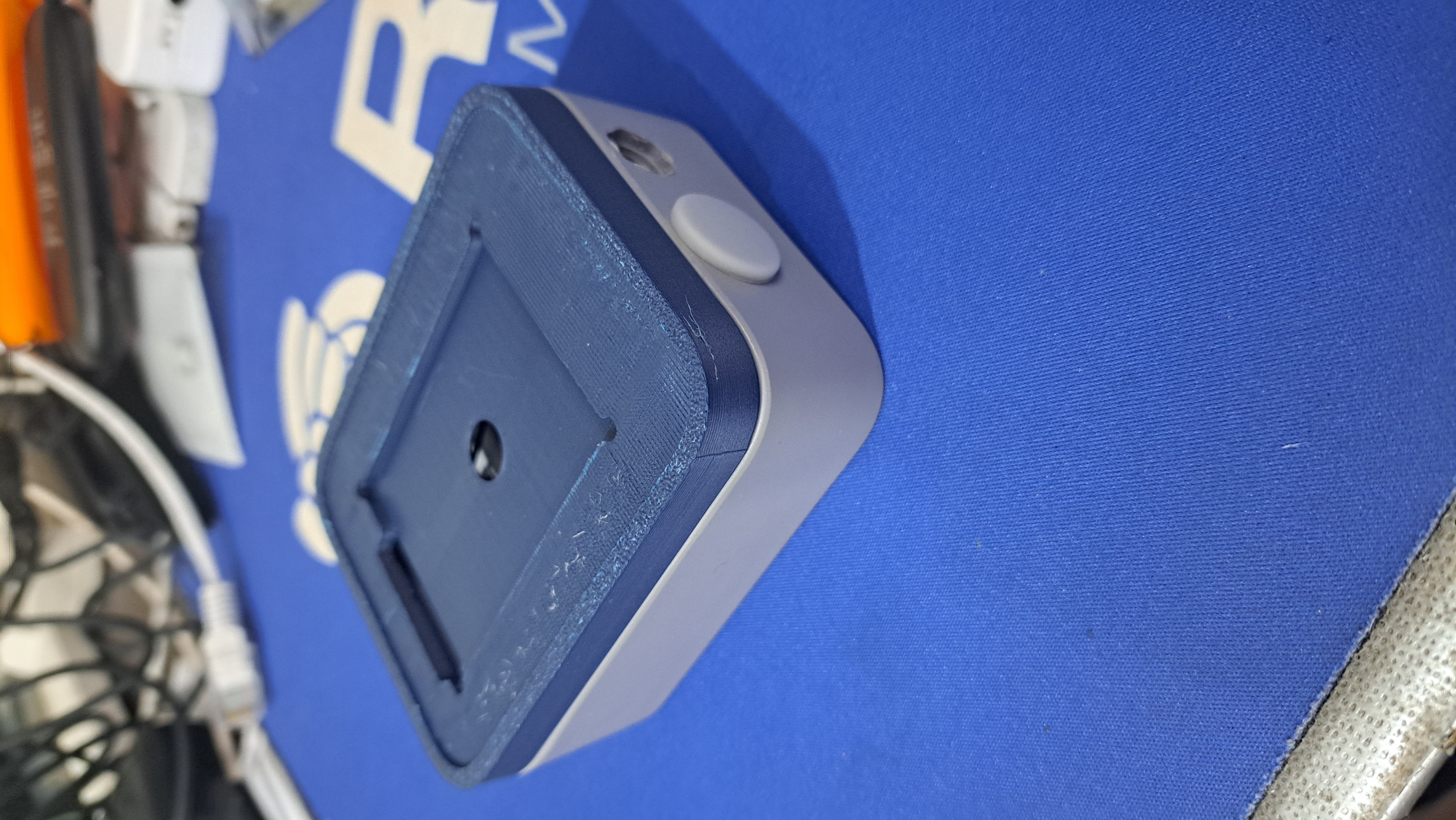

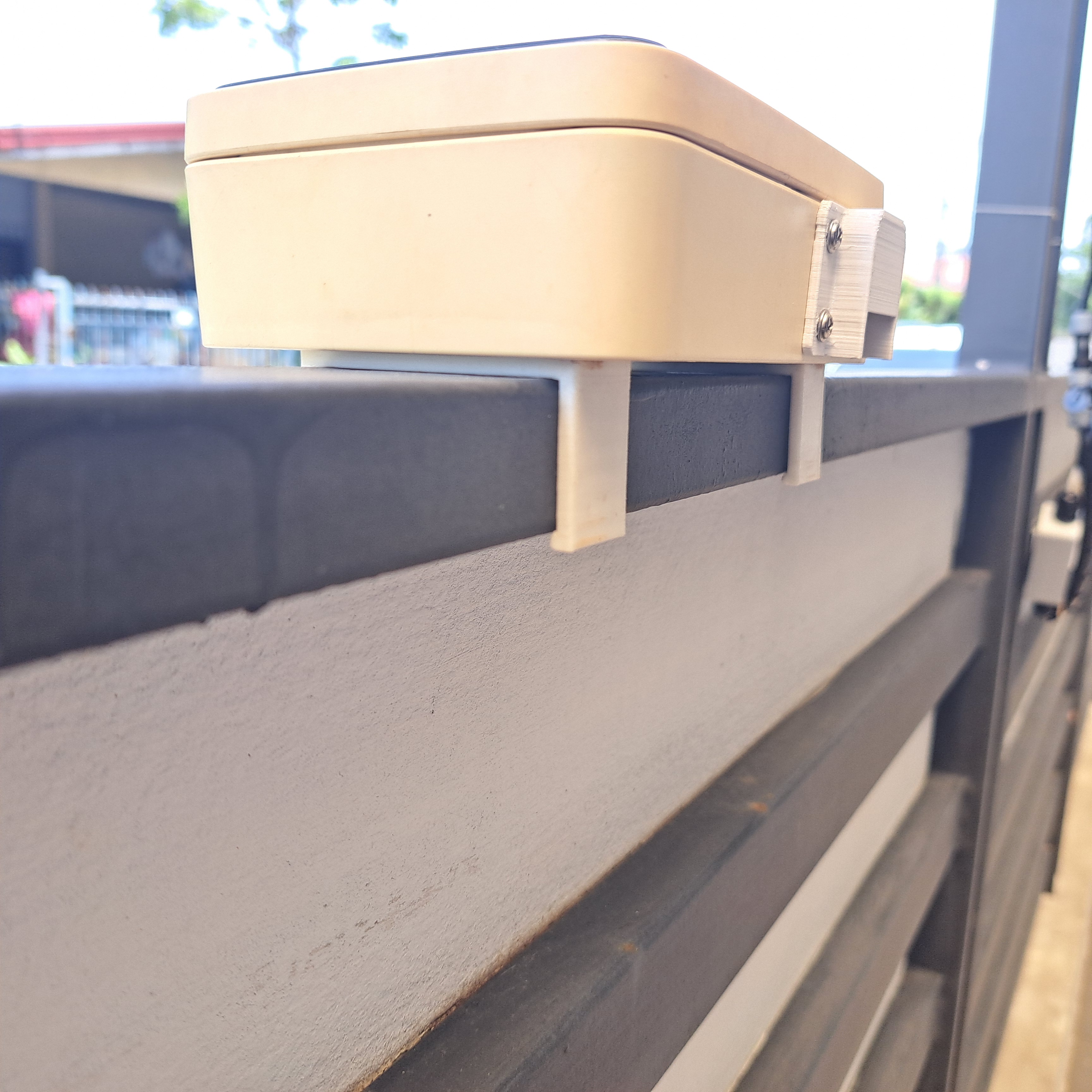

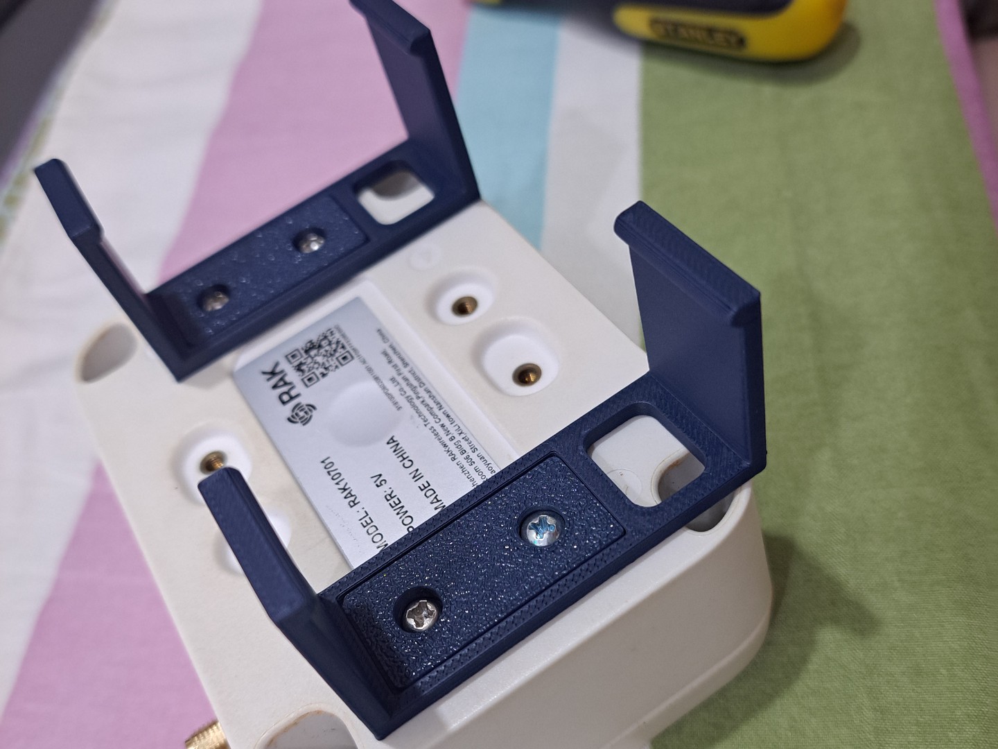

RAK Unify Enclosure Mounting Accessory 1x2" Rail
Figure 1: Unify Enclosure Rail Mount | Figure 1: Unify enclosure rail mounted |
This accessory adds a simple and sturdy way to mount any size of RAK Unify Enclosure onto a 1×2" rectangular pipe, useful for outdoor or solar-oriented installations.
Two mounting options are supported:
- Offset mount - the enclosure is positioned to one side of the pipe to increase sun exposure
- Centered mount - the enclosure is aligned directly over the center of the pipe

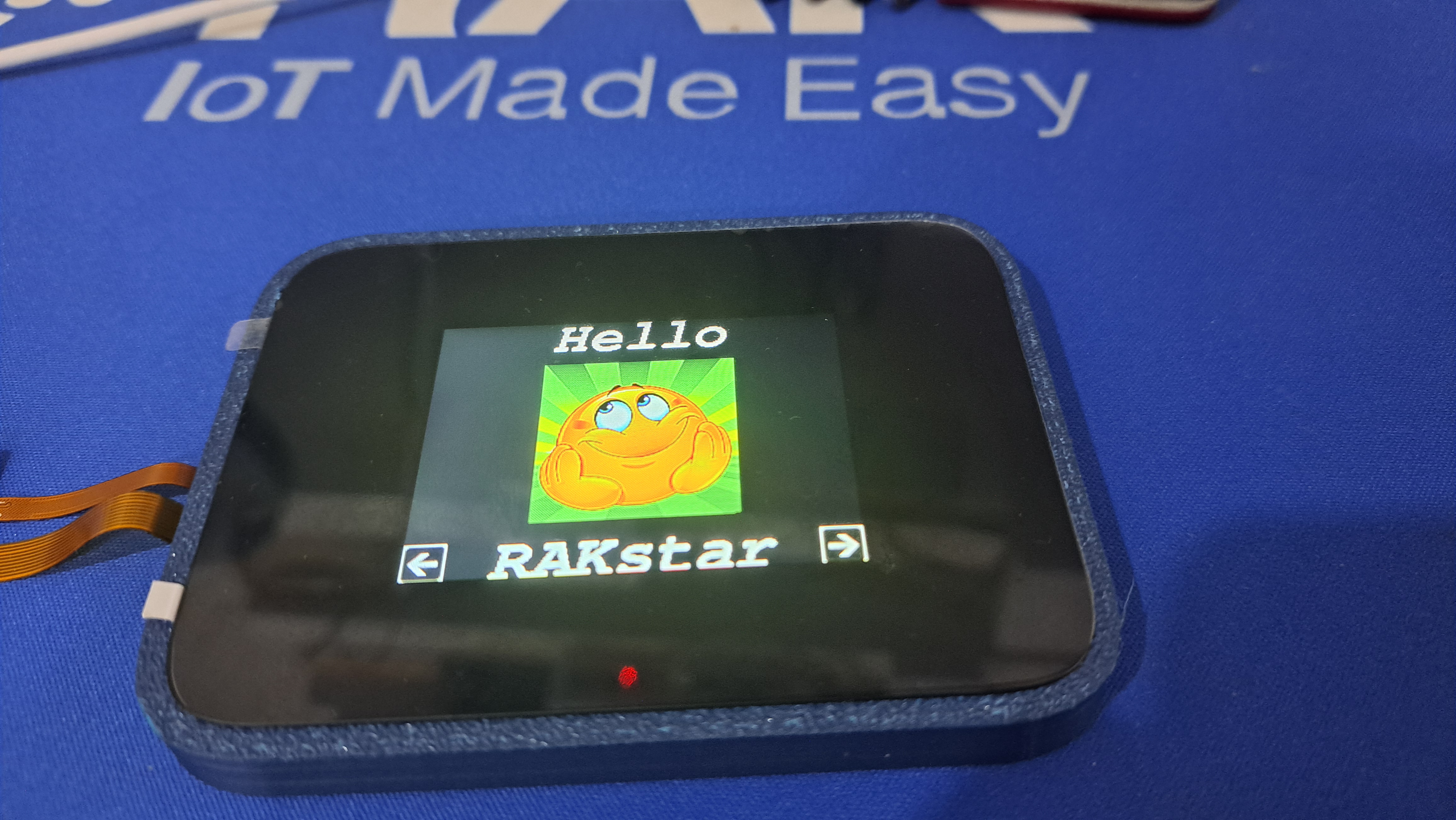

RAK Unify Enclosure TFT Lid
Figure 1: Unify Lid for TFT display | Figure 1: Unify Lid for TFT display mounted |
| This lid is designed for the RAK Unify Enclosure (100×75×34 mm) and supports the RAK14014 TFT touchscreen module. For correct assembly and printing: |
- Print supports are required
- Four M3x4 mm thread threaded inserts (5x6 mm outer dimension) are used to fasten the lid

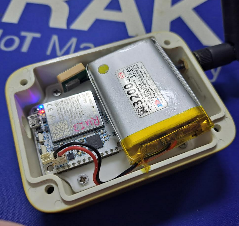

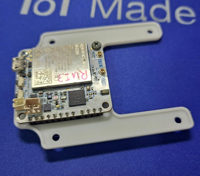

RAK5010 Mounting Plate for Unify Enclosure
Figure 1: RAK5010 mounted in Unify enclosure | Figure 1: RAK5010 mounting plate |
Sometimes there are inquiries for an outdoor enclosure for the RAKwireless WisTrio RAK5010 cellular location tracker.
A RAKwireless Unify Enclosure 100 x 75 x 38 mm with or without solar panel is sufficient to carry the RAK5010 and a battery, but there is no matching mounting plate.
This mounting plate helps to mount a RAK5010 cellular tracker inside the Unify Enclosure 100 x 75 x 38 mm. It still gives space for a 3200 mAh battery.
