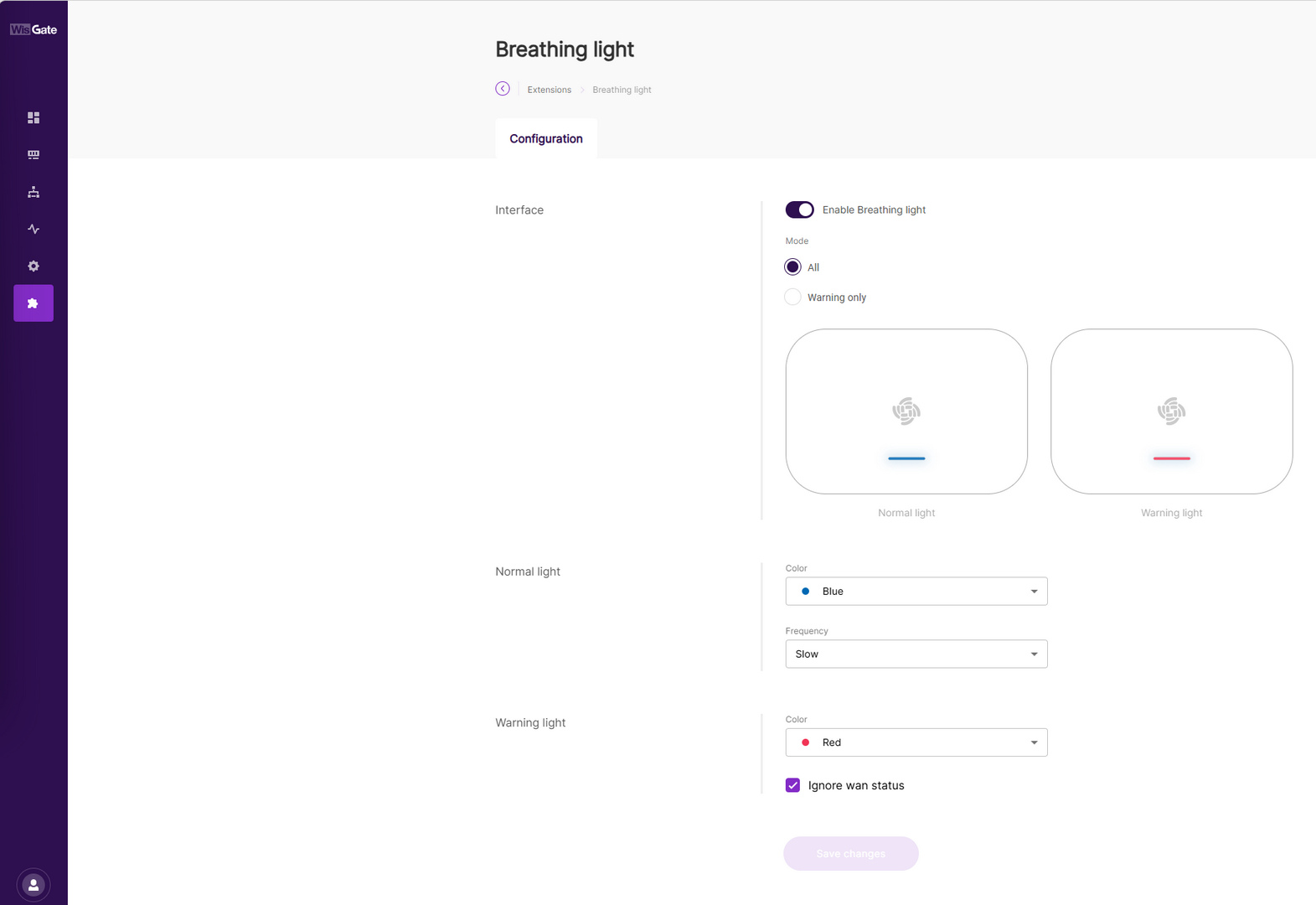

Configure the Breathing Light Extension
- To access the Breathing Light extension, click Launch.
- In the Configuration page, configure the mode, color, and blinking frequency of the LED.
Figure 1: Configuration Page-
Interface
- Enable Breathing Light: Enables or disables the breathing light extension.
- Mode: Sets the mode of the extension.
- All: The Normal light is enabled.
- Warning only: Disables the Normal light settings and only Warning light will glow.
Normal light: The settings for the normal light.
- Color: The color of the light (red, green, blue).
- Frequency: Blink frequency of the led (slow, fast, steady).
NOTE
The Normal light settings are disabled if Warning only mode is selected.
Warning Light: The color of the warning light.
Ignore wan status: When this option is enabled, the breathing light no longer monitors the WAN interface status.
In this mode, WAN connectivity changes (such as Ethernet hot-plug events or Cellular/Wi-Fi disconnections and reconnections) do not trigger a breathing light color change. The breathing light only reflects system states unrelated to the WAN interface.
If the WAN status changes while the breathing light remains unchanged, this behavior is expected and does not indicate a malfunction.
- Once done with the configuration, click Save changes. You can check the status of the LED on the gateway itself.
