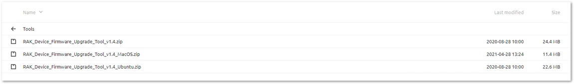

- Download the RAK DFU Tool for your Operating System.
Figure 1: RAK DFU Tool download- Download the latest Firmware.

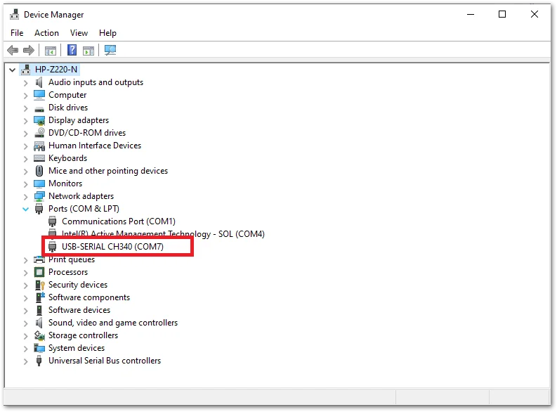

- Connect RAK7431 to your computer via a micro-USB cable. Check what COM port is the device connected to.
- Under Windows you should see it like this:
Figure 1: COM port check- Under MacOS and Linux you can check by running the
lsusbcommand in the terminal.

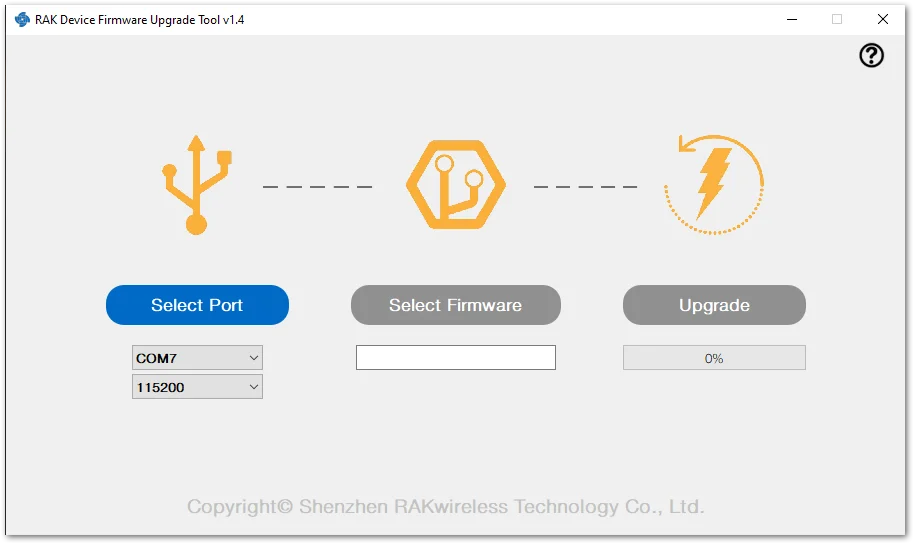

- Start the RAK DFU Tool.
- Select the correct COM port and Firmware version (HB, MB, or LB).
- Click the Upgrade button to start the process. Wait until the flash is complete. Do not interrupt the process.
