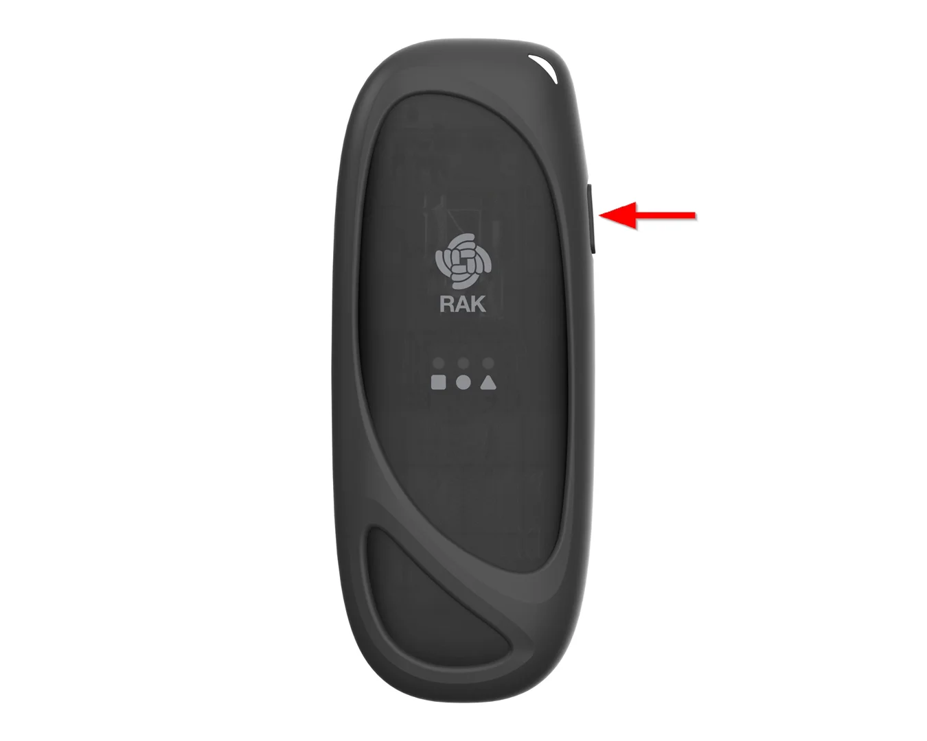

Button
The WisMesh Pod features a multifunction button for power control, reset, and DFU mode for firmware updates.
| Action | Function |
| Long press (5 seconds) | Powers the device on or off. The green LED stays solid when the device is powered on. |
| Single press | Resets the device. |
| Double press | Enters DFU mode for firmware updates via USB Type-C. |
The multifunction button is dedicated to power on/off, device reset, and DFU mode. It cannot be used for other user-defined functions.

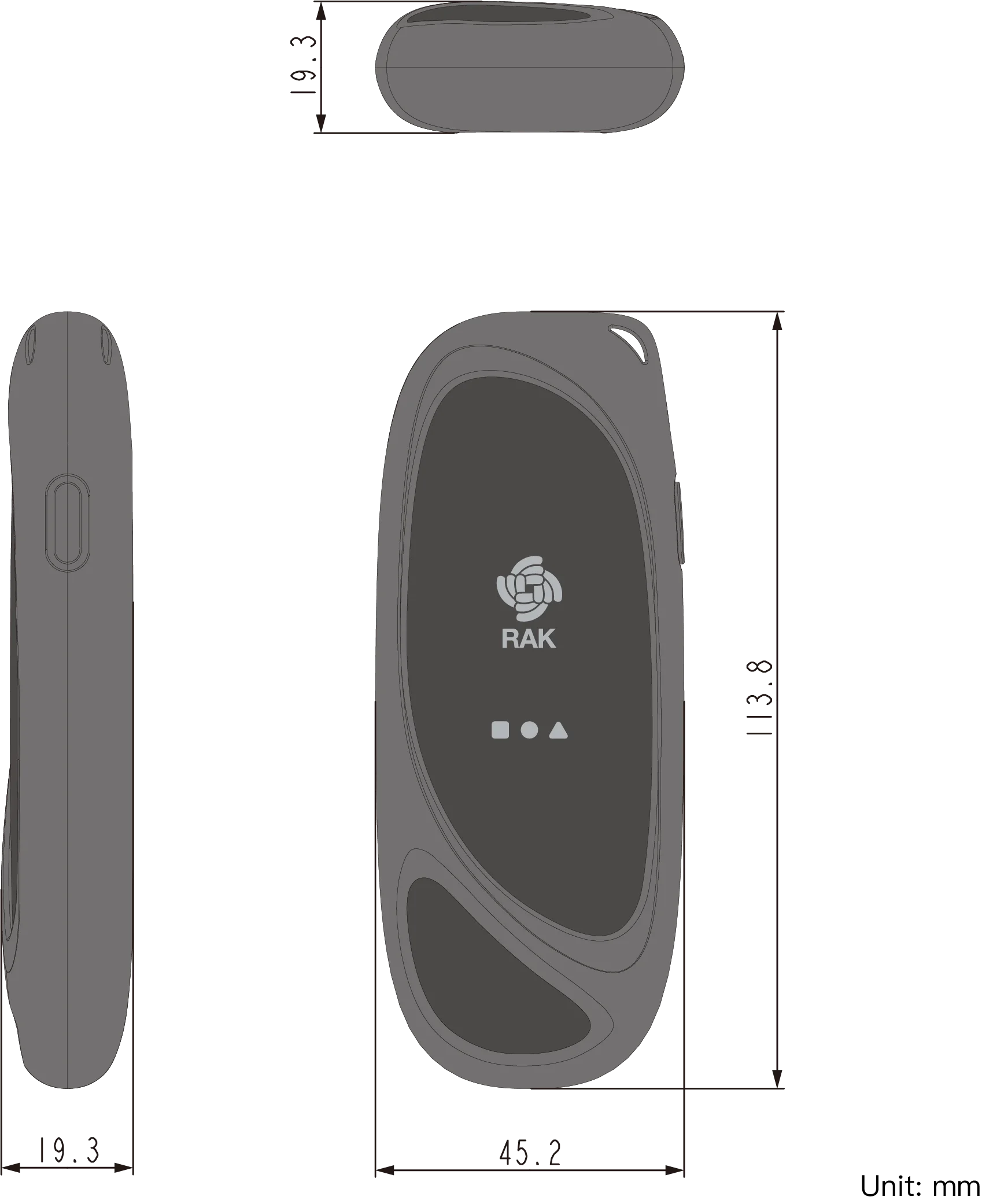

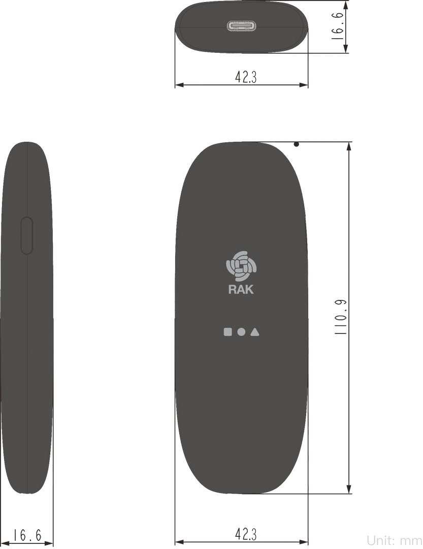

Dimensions
The WisMesh Pod features an injection-molded enclosure with an included silicone case for additional protection.
Dimensions without silicone case:
Figure 1: WisMesh Pod dimensions of hard shellDimensions with silicone case:
Figure 1: WisMesh Pod dimensions with silicone case| Parameter | Specification |
| Dimensions without silicone case (L × W × H) | 110.9 × 42.3 × 16.6 mm |
| Dimensions with silicone case (L × W × H) | 113.8 × 45.2 × 19.3 mm |
| Device weight | 108.7 g |
