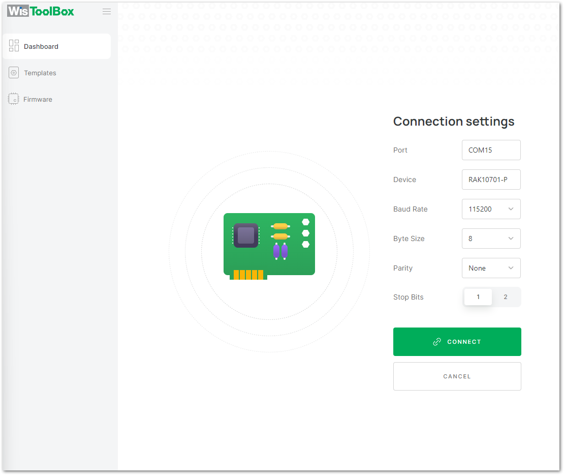

- Once detected, the Connection settings page will appear, showing the correct device name (RAK10701-L or RAK10701-P). Click CONNECT to proceed.
Figure 1: WisToolBox Connection Settings Tab- Once connected, the device will be shown as WisNode Field Tester. Click on FIRMWARE to open the firmware update section.
