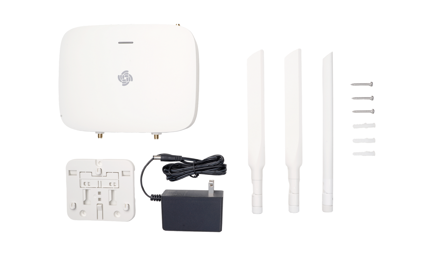

Package Inclusions
Figure 1: RAK7268CV2-V package contents- 1 × Gateway
- 1 × LoRa Antenna
- 2 × LTE Antenna
- 1 × Power Supply Adapter
- 1 × Mounting Bracket
- 1× Screw Kit for Mounting
- 1× User Manual
Additional Hardware Required
- Ethernet cable (RJ-45 Port) for Ethernet connection
- A Windows, macOS, or Linux computer for configuration through the web UI
- Nano SIM card (12 x 9 x 0.67 mm) for cellular connectivity

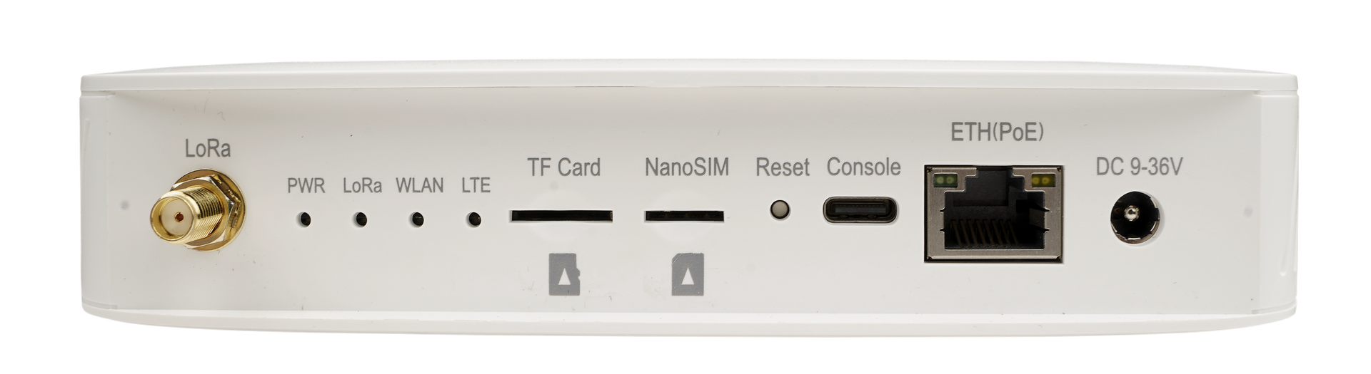

Insert SIM Card
- If the gateway is running WisGateOS 2.3.1 or later, the SIM card slot supports hot-swapping.
- For versions earlier than WisGateOS 2.3.1, the SIM card slot is not hot-swappable. Always power off the gateway before inserting or removing the SIM card.
- On the back of the gateway, locate the Nano SIM card slot.
Figure 1: Nano SIM card slot- Insert the Nano SIM card into the slot, ensuring it is securely seated.

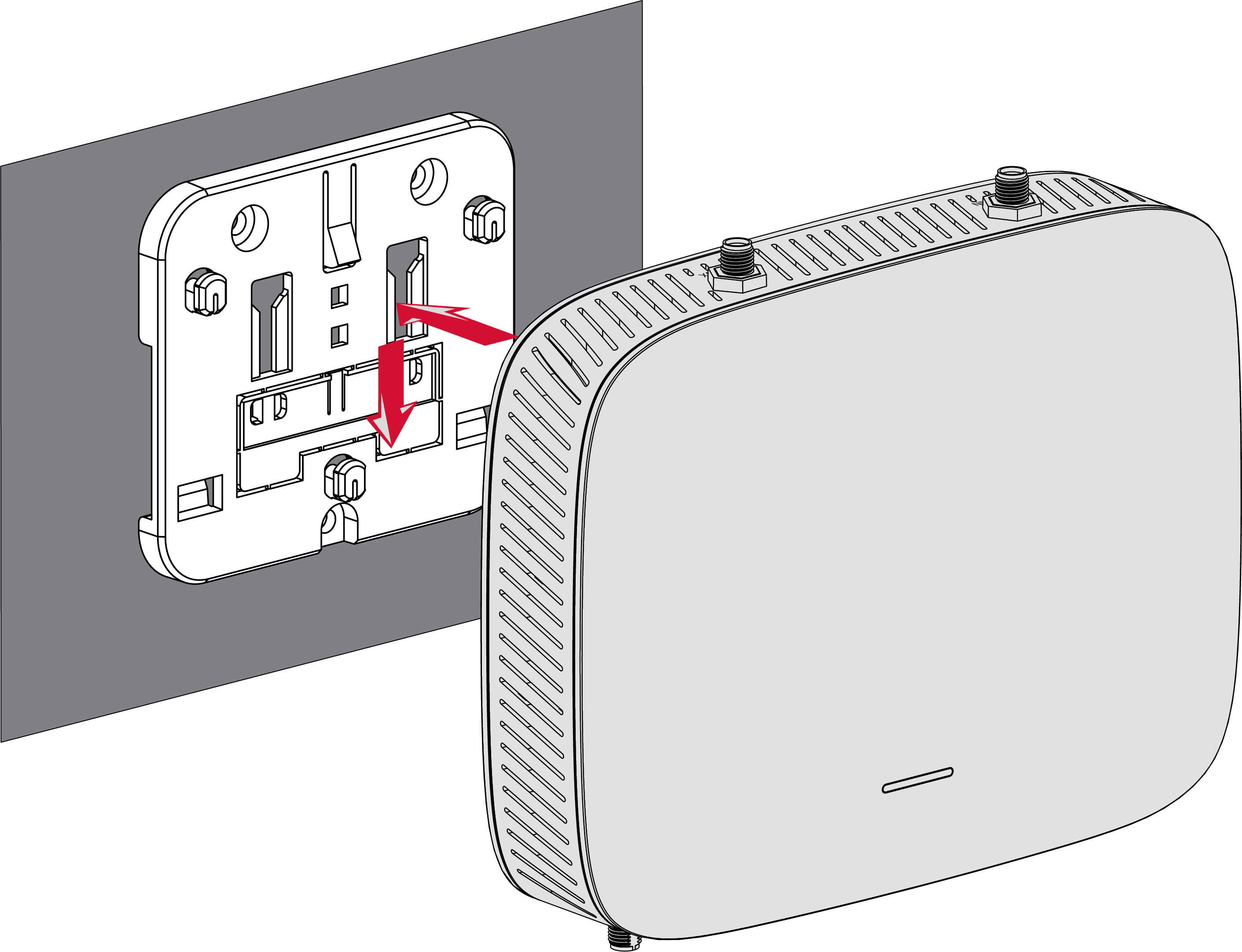

Figure 1: Bracket mounted on T-shaped keel structureInstall the Gateway
- Align the lower edge of the gateway's hanging hole with the bracket's locking plate.
- Move the gateway closer to the bracket so that the bracket's locking plate enters the gateway's hanging hole.
- Pull the gateway to ensure that it is securely locked in place.
