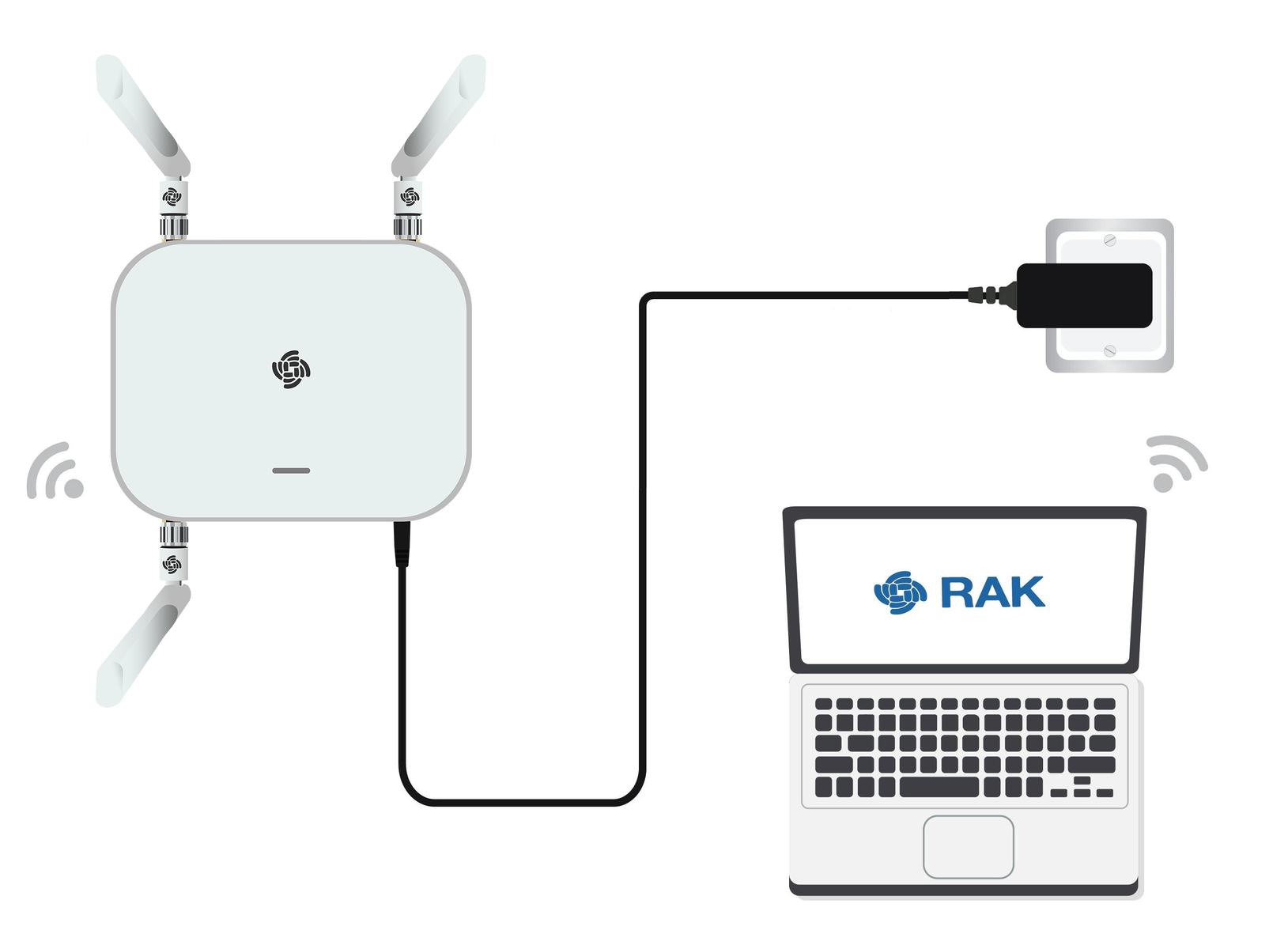

Wi-Fi AP Mode
By default, the gateway operates in Wi-Fi AP mode. You can find an SSID similar to RAK7268CV2-V_XXXX in your PC's Wi-Fi network list, where XXXX represents the last two bytes of the gateway MAC address.
Figure 1: Accessing the gateway via Wi-Fi AP Mode-
Connect to the gateway's Wi-Fi.
NOTENo password is required to connect via Wi-Fi AP mode.
Open a web browser and enter the IP address:
192.168.230.1
By default, the Wi-Fi Access Point (AP) is enabled and operates as an open network (without password protection) on all WisGate Edge and WisGate Soho gateways.
For security reasons, disabling the Wi-Fi AP or securing it with a strong password is strongly recommended after completing the initial gateway configuration to prevent unauthorized access.

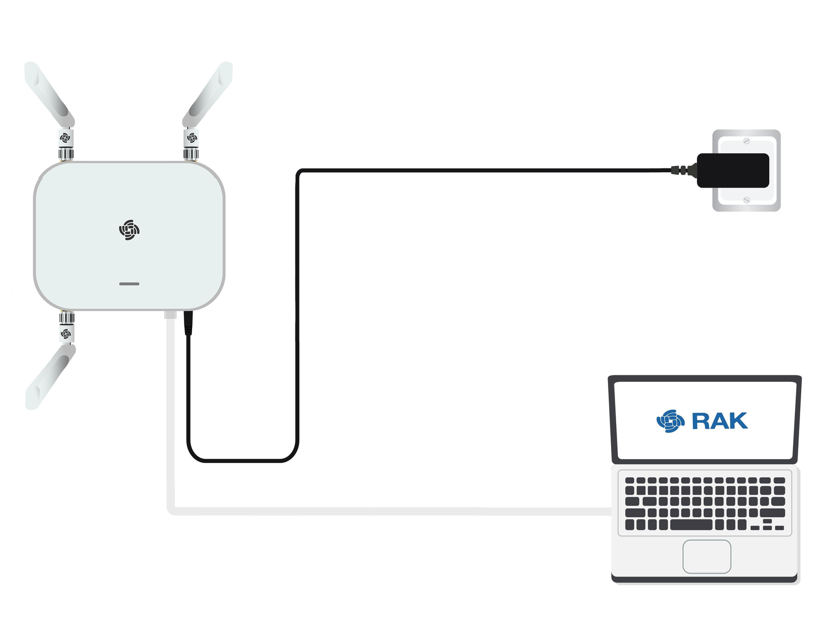

WAN Port (Ethernet)
Figure 1: Access the gateway via WAN Port (Ethernet)- Connect an Ethernet cable from the gateway's ETH(PoE) port to your PC's Ethernet port.
- Set a static IP address on your PC in the same subnet as the gateway:
NOTE
The default IP of the gateway is
169.254.X.X, derived from the last 4 bits of the MAC address. For example, if the last 4 bits are0F:01, the gateway IP is169.254.15.1. Set your PC's IP address accordingly, e.g.,169.254.15.100. - Open the Internet Properties of your PC, and select Internet Protocol Version 4 (TCP/IPv4).
Figure 1: Internet properties- Select Use the following IP address, and set the PC's IP address (e.g.,
169.254.15.100). Ensure the PC's IP address is in the same subnet as the gateway (e.g., if the gateway IP is169.254.15.1, set the PC to169.254.15.100).
Figure 1: Set IP address of the PC- Open a web browser and enter the gateway's IP address (e.g.,
169.254.15.1) to access the Web UI. You will be redirected to the gateway login page.

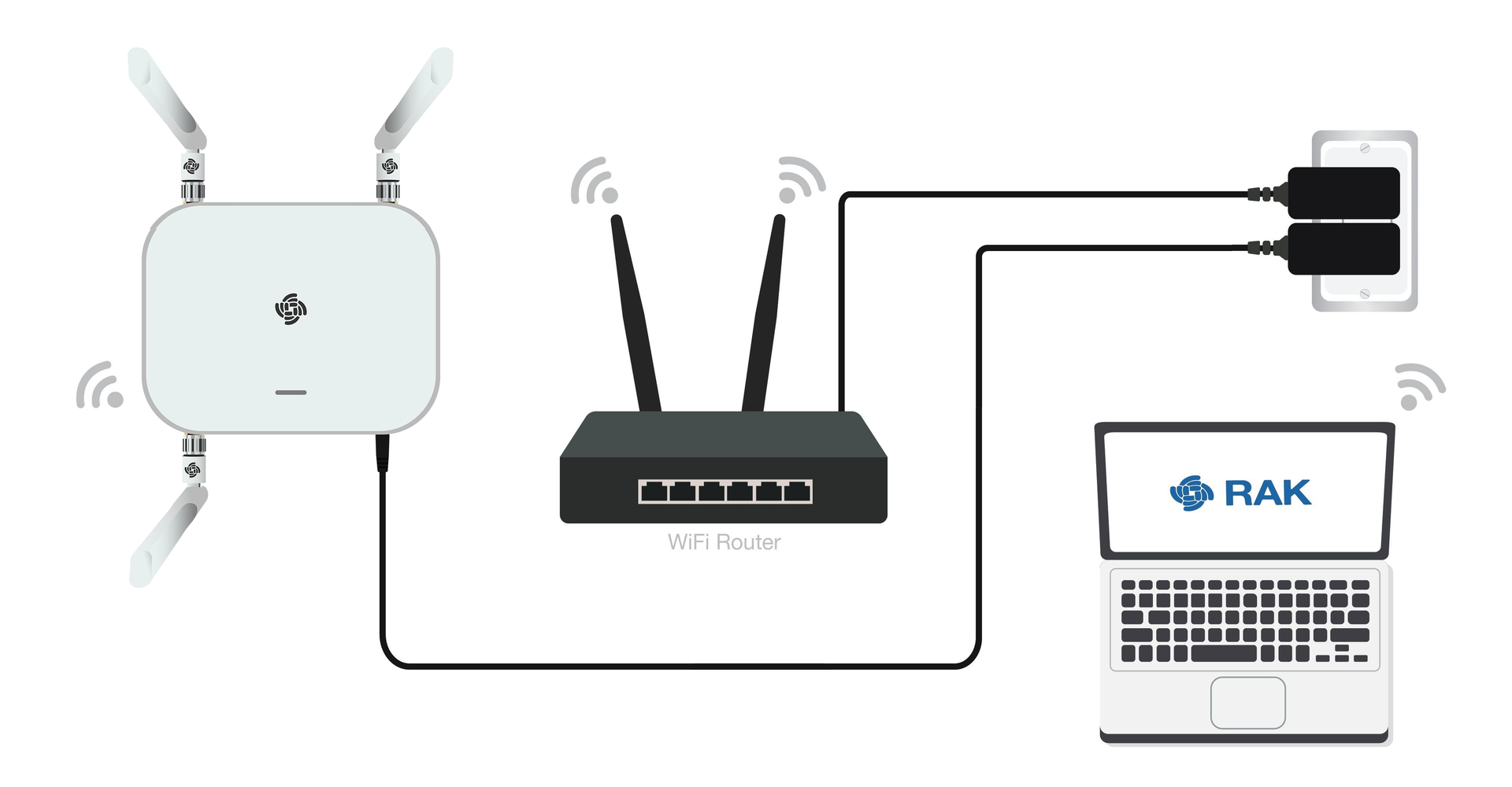

You can connect the gateway to the Internet via Wi-Fi, Ethernet, or Cellular. Multiple connection types can be configured at the same time.
Wi-Fi
Figure 1: Connect the internet via Wi-Fi- Log in to the Web UI, go to Network > WAN > Wi-Fi.
- Expand the Wi-Fi section and click on Settings. Ensure the Interface is enabled.
- Click the Scan button to select your ESSID, or manually enter the network ESSID by clicking Enter network (E)SSID manually.
- Choose the correct Encryption method and enter the appropriate Key.
NOTE
Assuming you have entered the correct parameter values, you should receive an IP address assigned by your Wi-Fi router's (AP) built-in DHCP server. You can use this new IP address to log in via a web browser.
Figure 1: Wi-Fi settings
For details, refer to the WisGateOS 2 User Manual > WAN > Wi-Fi.

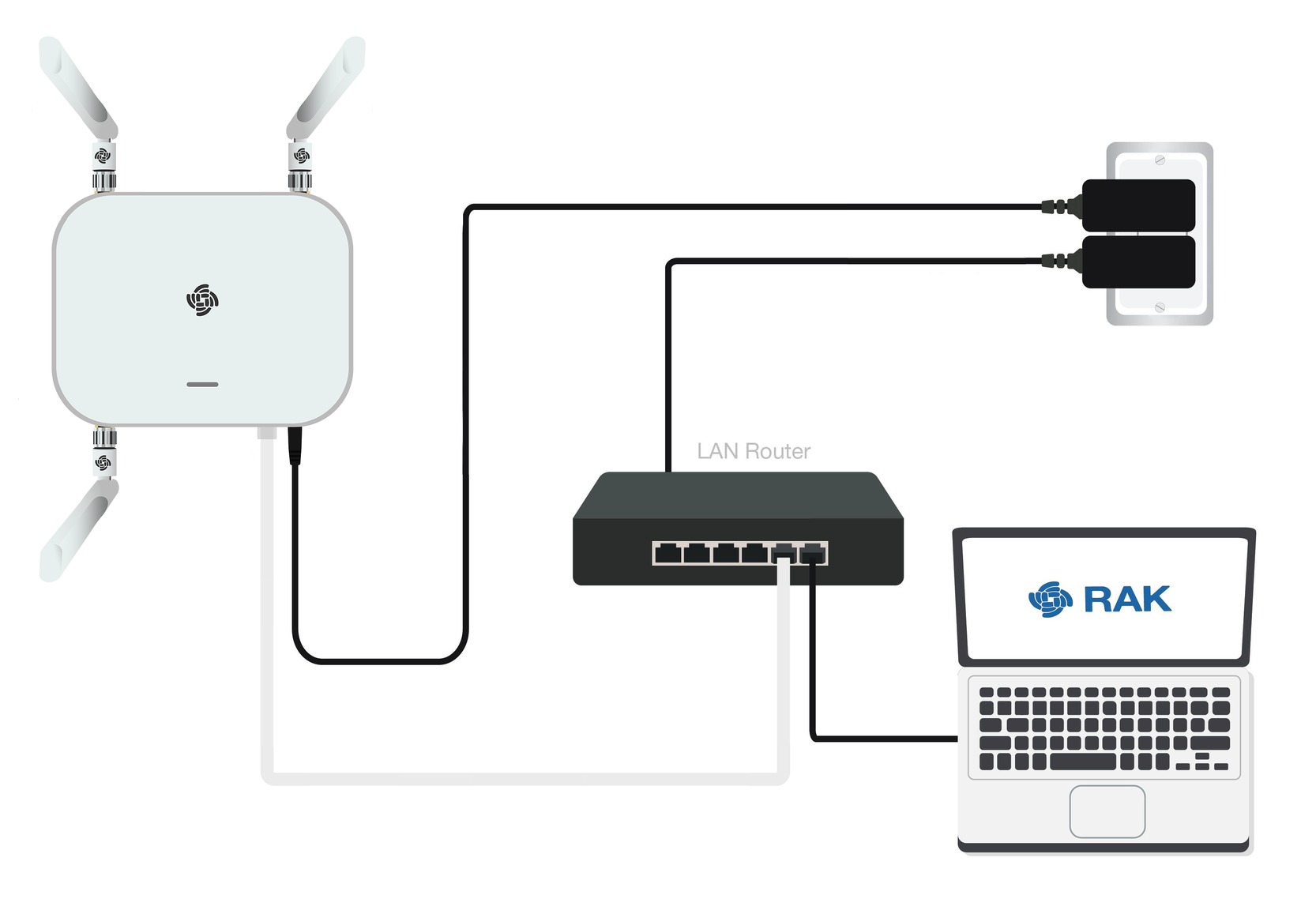

Ethernet
Figure 1: Access the Internet through Ethernet- Connect one end of an Ethernet cable to the gateway's ETH(PoE) port, and the other end to your router.
The router's DHCP server will automatically assign an IP address to the gateway. You can use this assigned IP to access the gateway via a web browser.
Figure 1: Connect through Ethernet settingsIf additional configuration is required, refer to the WisGateOS 2 User Manual > WAN > Ethernet.

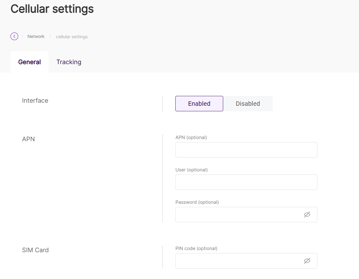

Cellular
Insert a valid SIM card. The gateway will typically connect to the cellular network automatically. However, manual APN configuration may be required depending on your mobile operator.
To manually configure APN and other LTE settings:
- Log in to the Web UI and navigate to Network > WAN > Cellular.
- Expand the Cellular section and click on Settings.
- Enter the required APN, username, password, and PIN code if provided by your mobile operator.
Figure 1: Connect through cellular settingsFor details on each parameter, refer to the WisGateOS 2 User Manual > WAN > Cellular.
Make sure that your SIM card is activated and supports data services.
