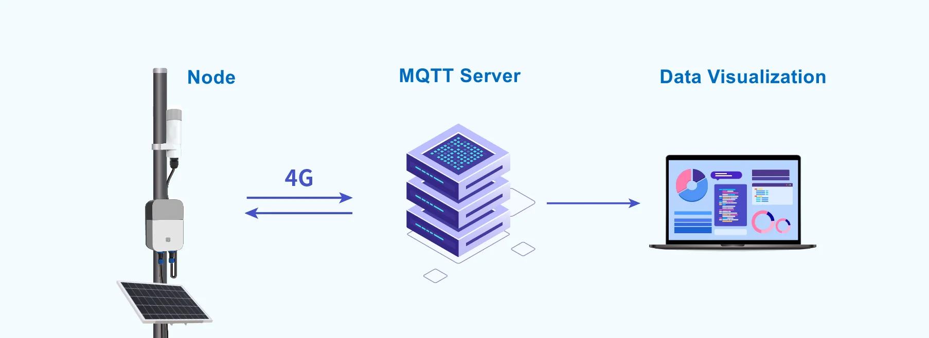

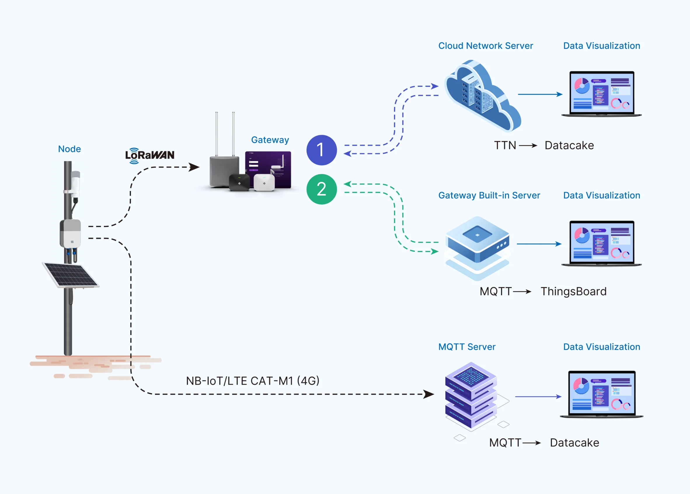

Figure 1: LoRaWAN application scenarioLoRaWAN Application
Cloud Network Server Setup

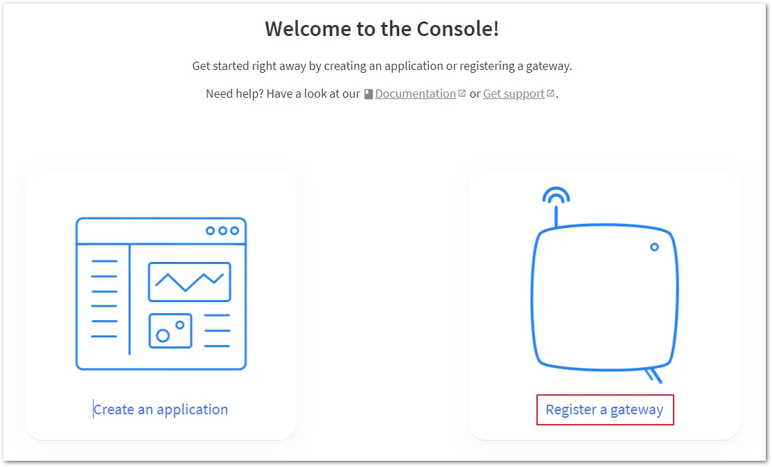

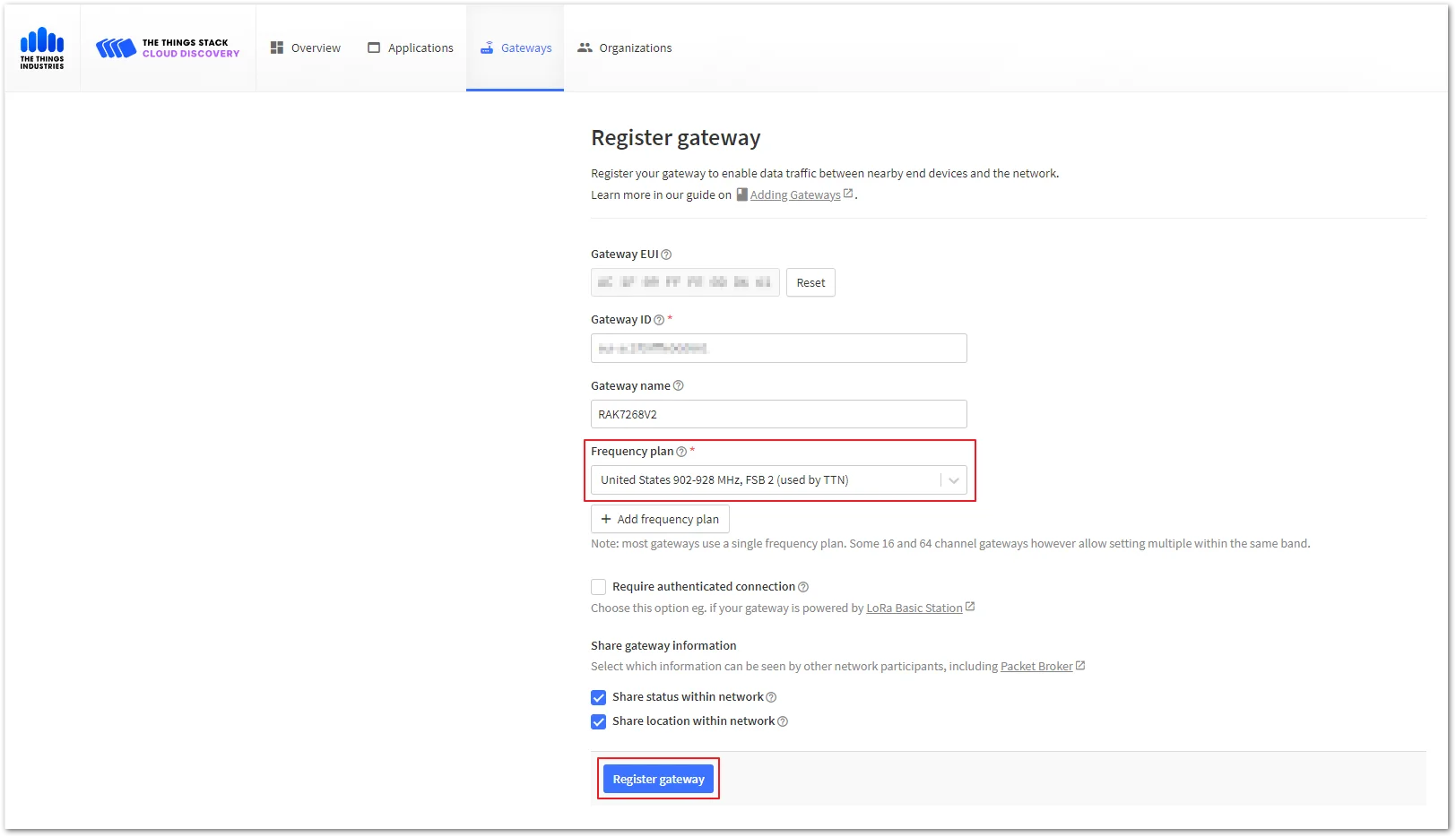

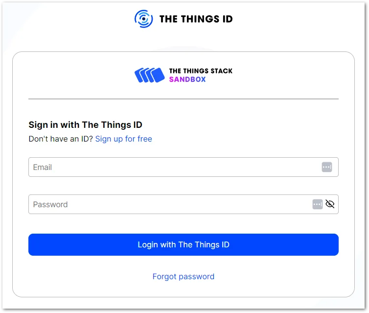

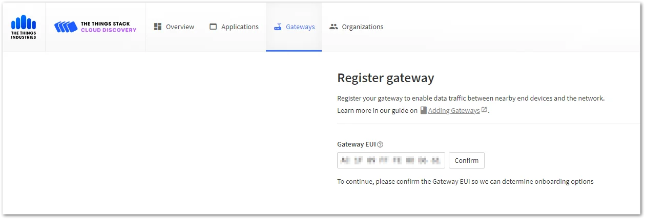

Register the Gateway- Register an account and log in to the TTN v3 website. If you already have a TTN account, you can log in using your The Things ID credentials.

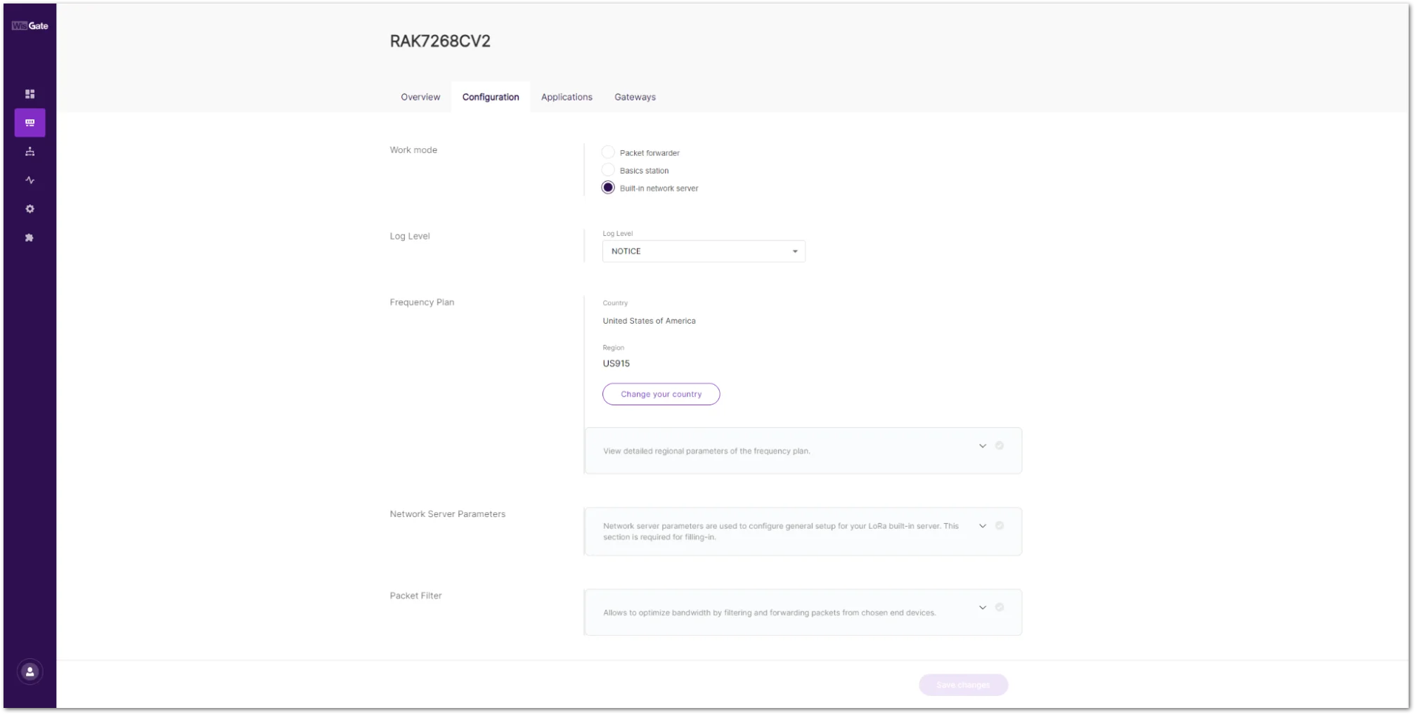

Figure 1: Configure the gateway frequencyYour gateway dashboard should look the same with Figure 7.

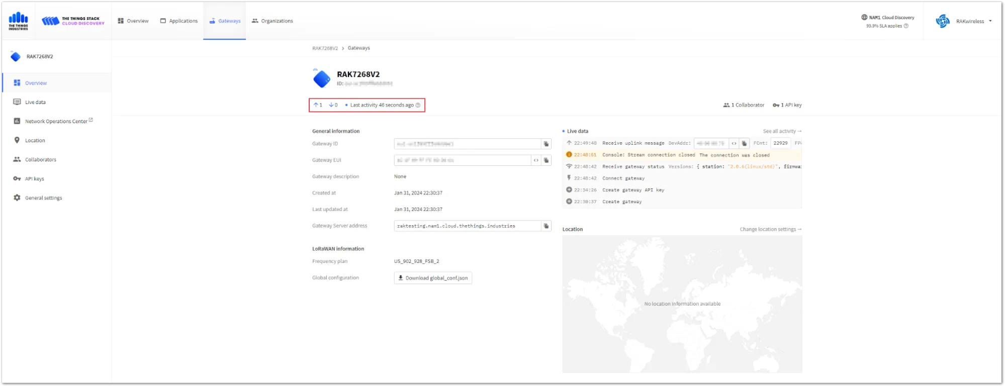

Figure 1: Successfully registered the gatewayTTNv3 supports TLS server authentication and client tokens, which require trust files and keys to configure the gateway and successfully connect to the network.

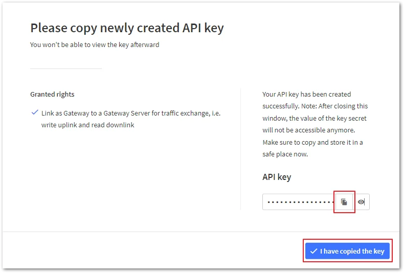

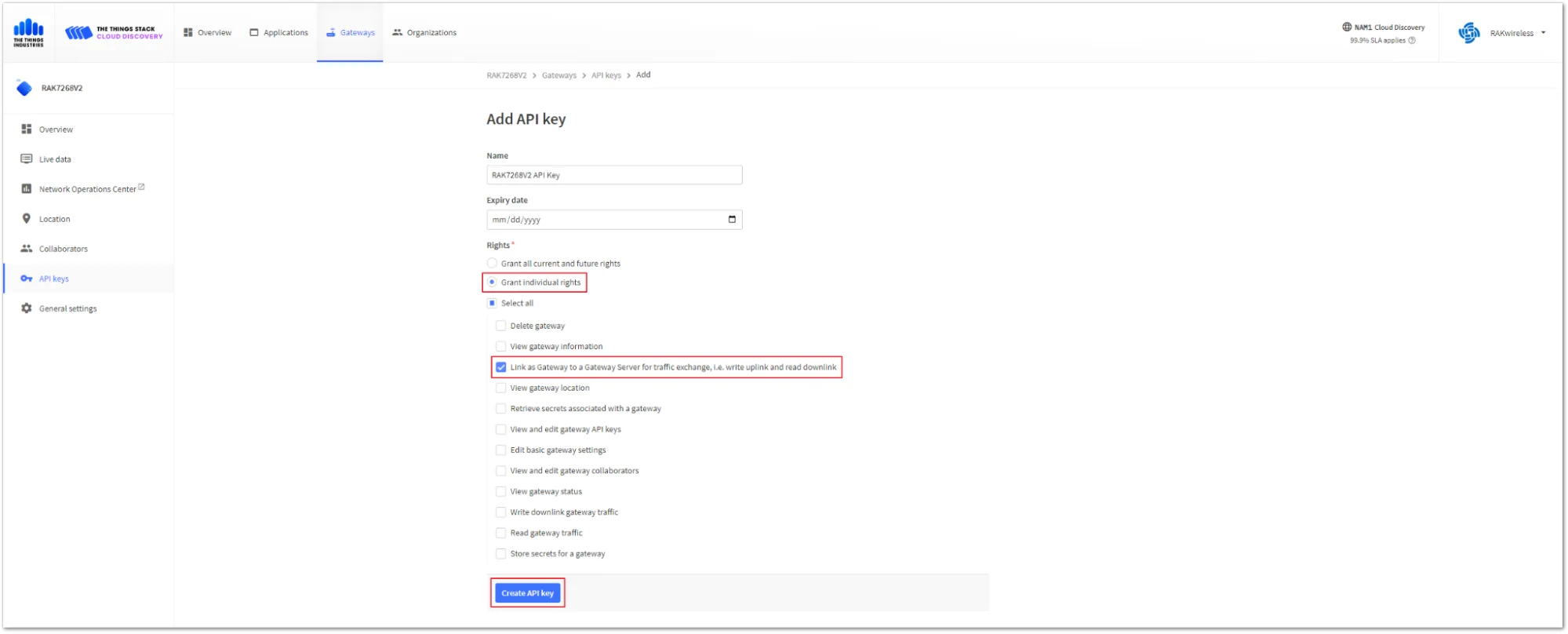

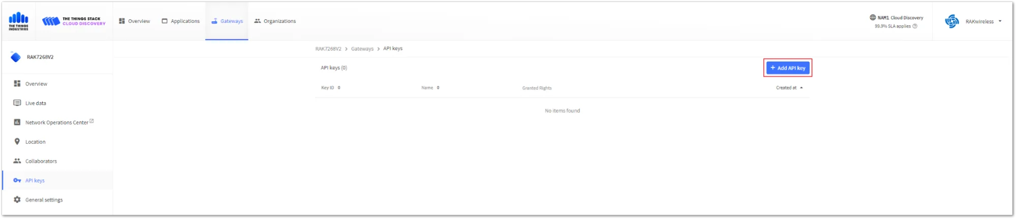

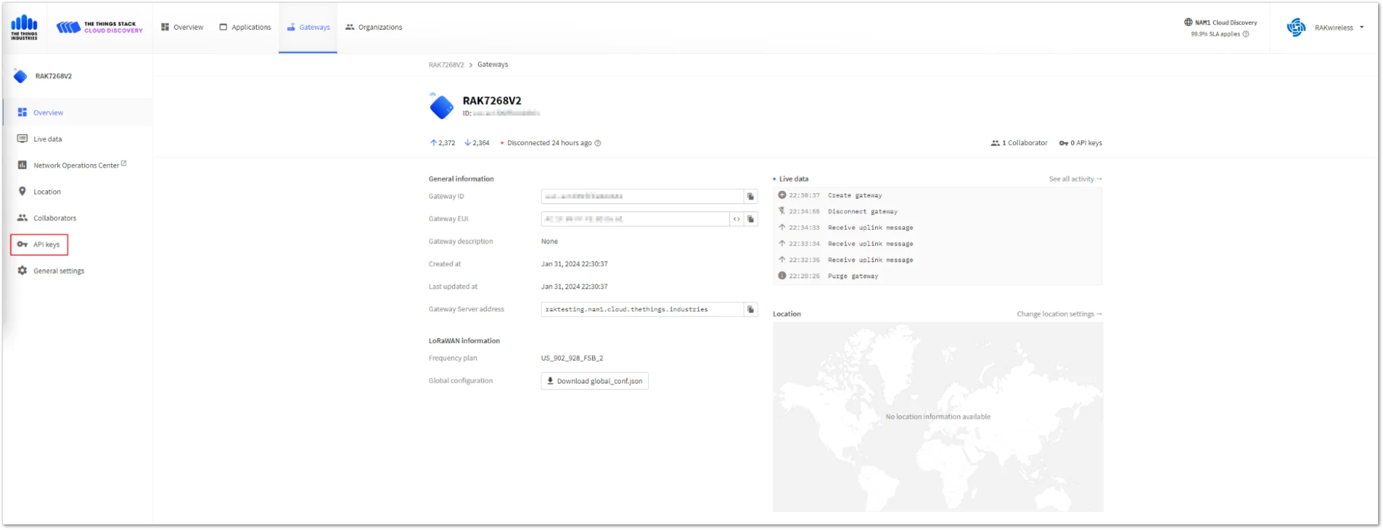

- To generate a key file, navigate to API keys from the Overview page of the registered gateway, then click Add API key.
Figure 1: Configure the API key- A new window pops up with the generated key. Copy the new API key by clicking the icon and then the I have copied the key button.

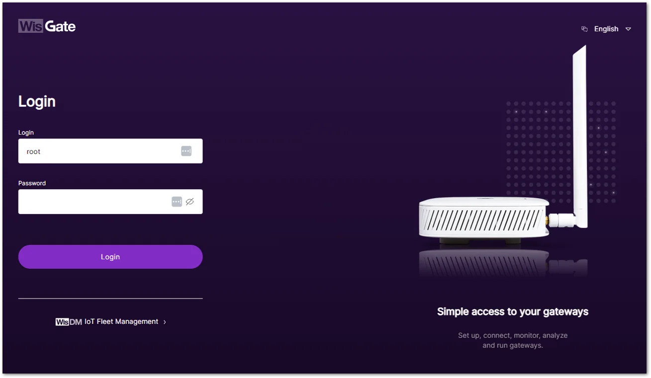

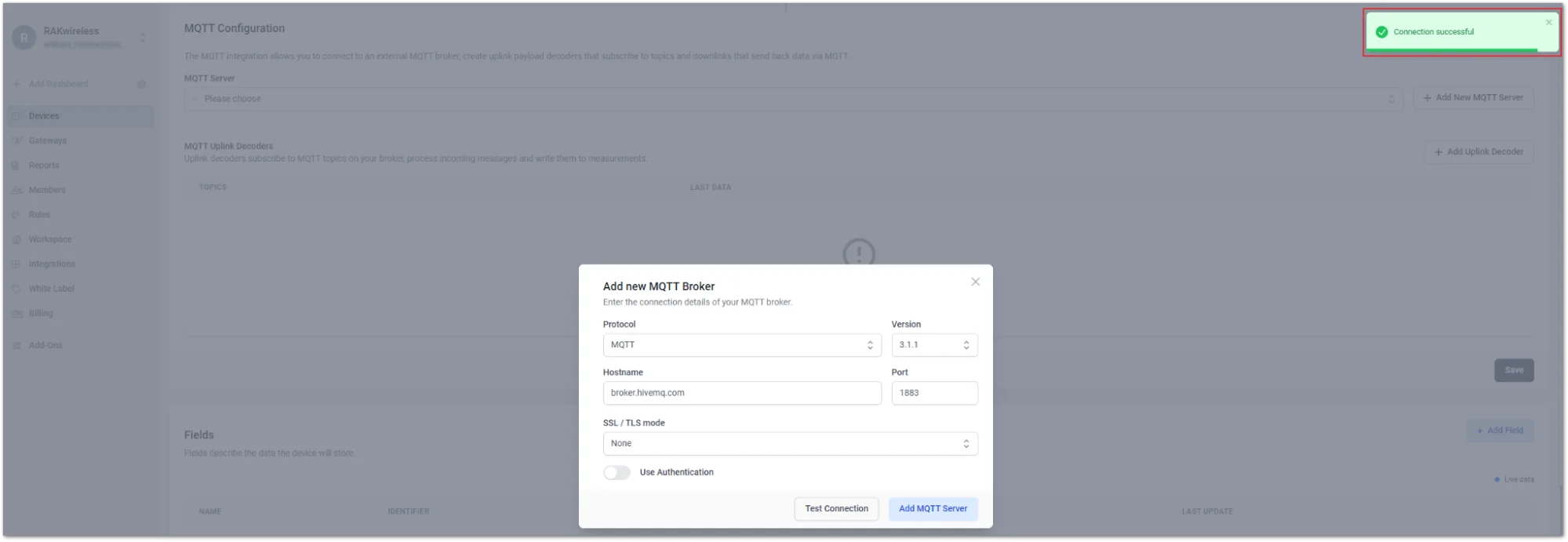

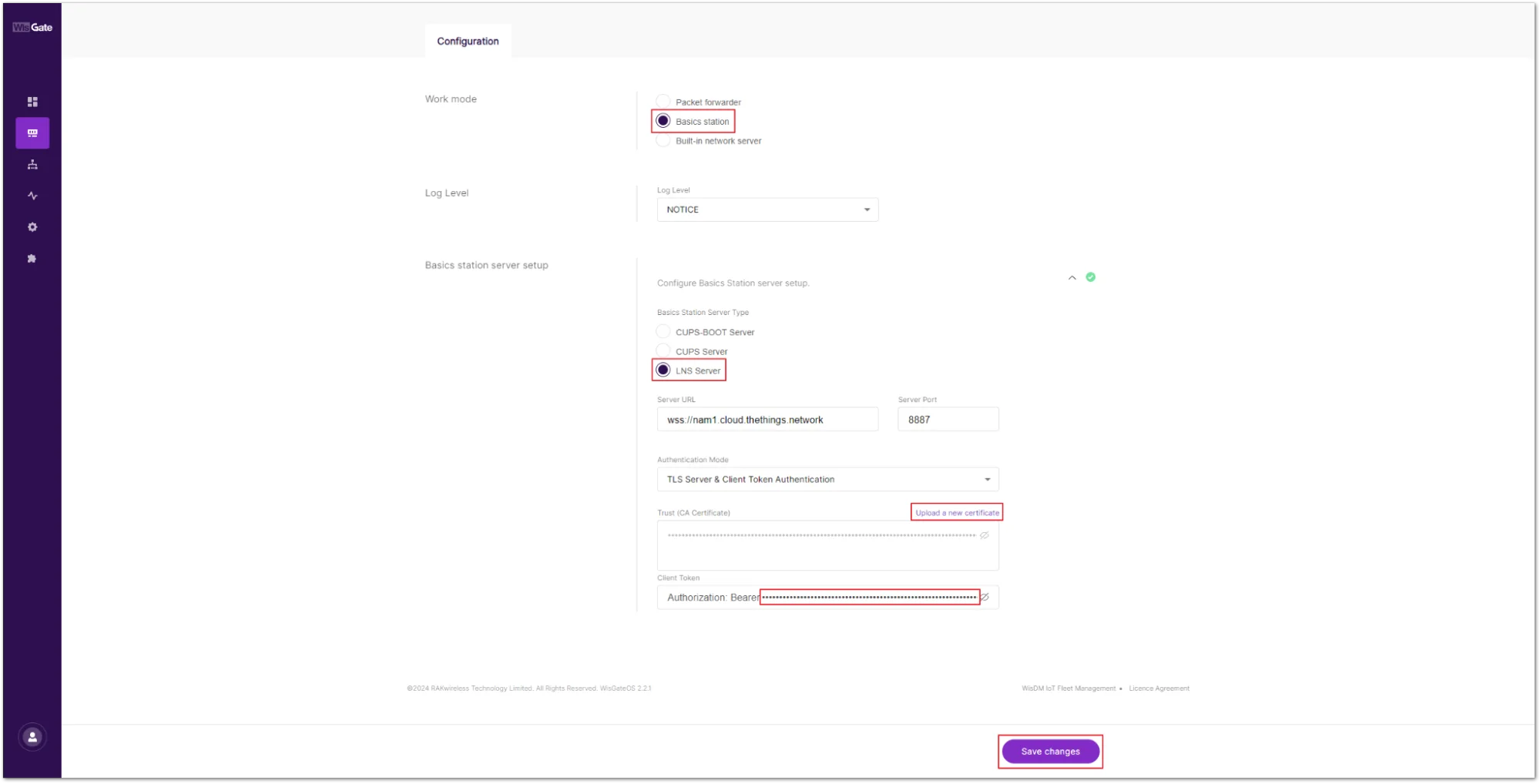

Figure 1: Copy and save the API key- Navigate back to the gateway management platform Web UI. Click on the left navigation bar to access the LoRa > Configuration tab. Complete the following settings and save them.
- Server URL:
8887 - Authentication Mode: TLS server & Client Token Authentication
- Trust (CA Certificate): Download the certificate.

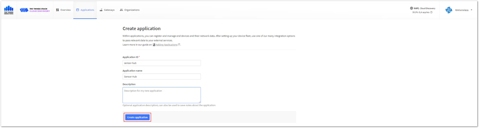

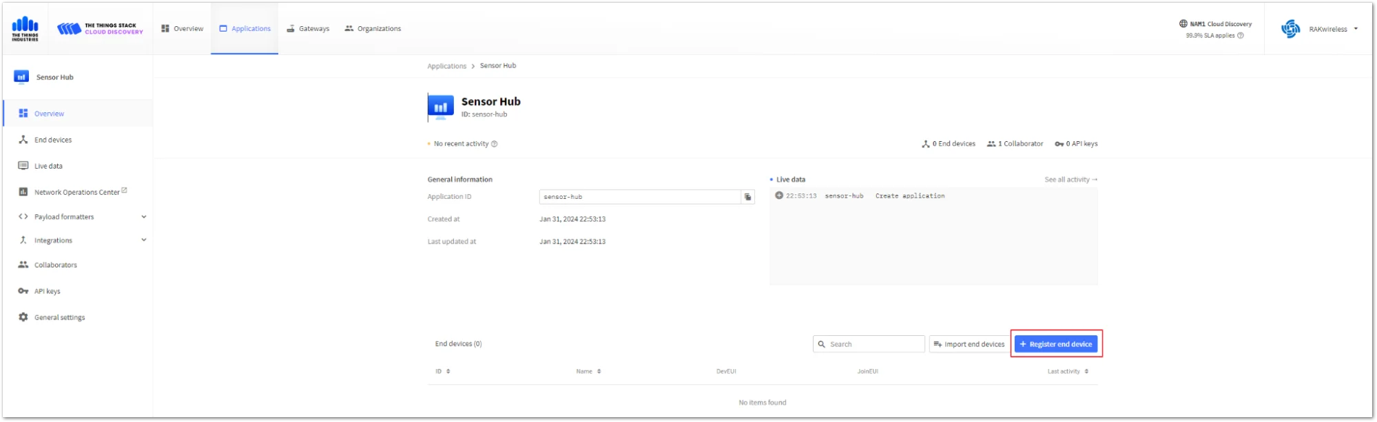

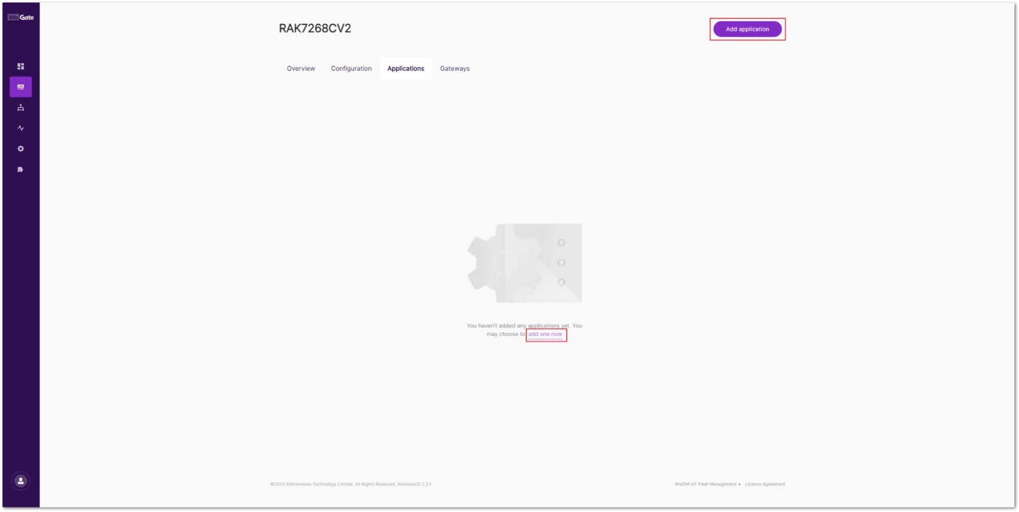

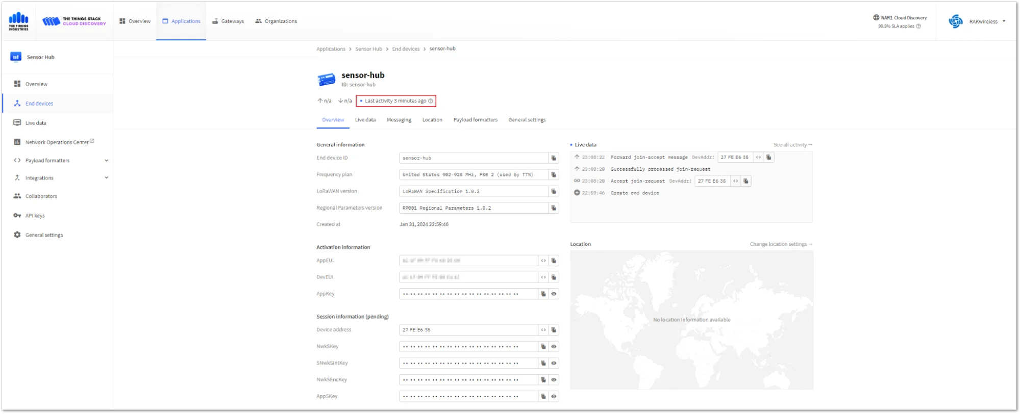

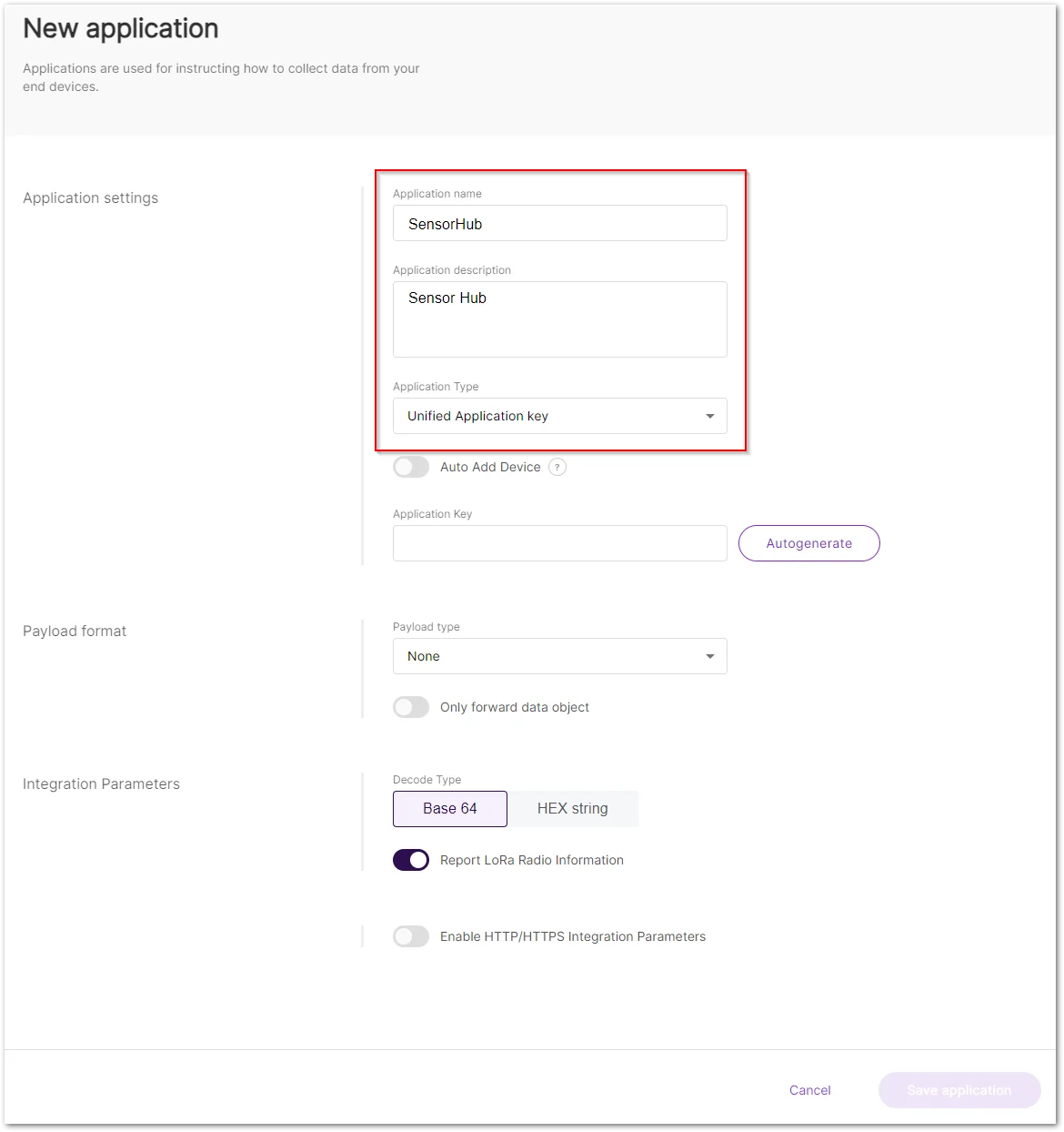

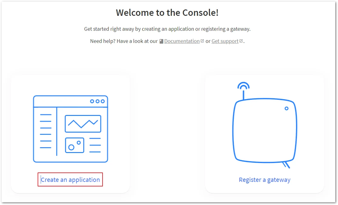

Figure 1: Select Create an application- Click +Create application to initiate the creation of a node.

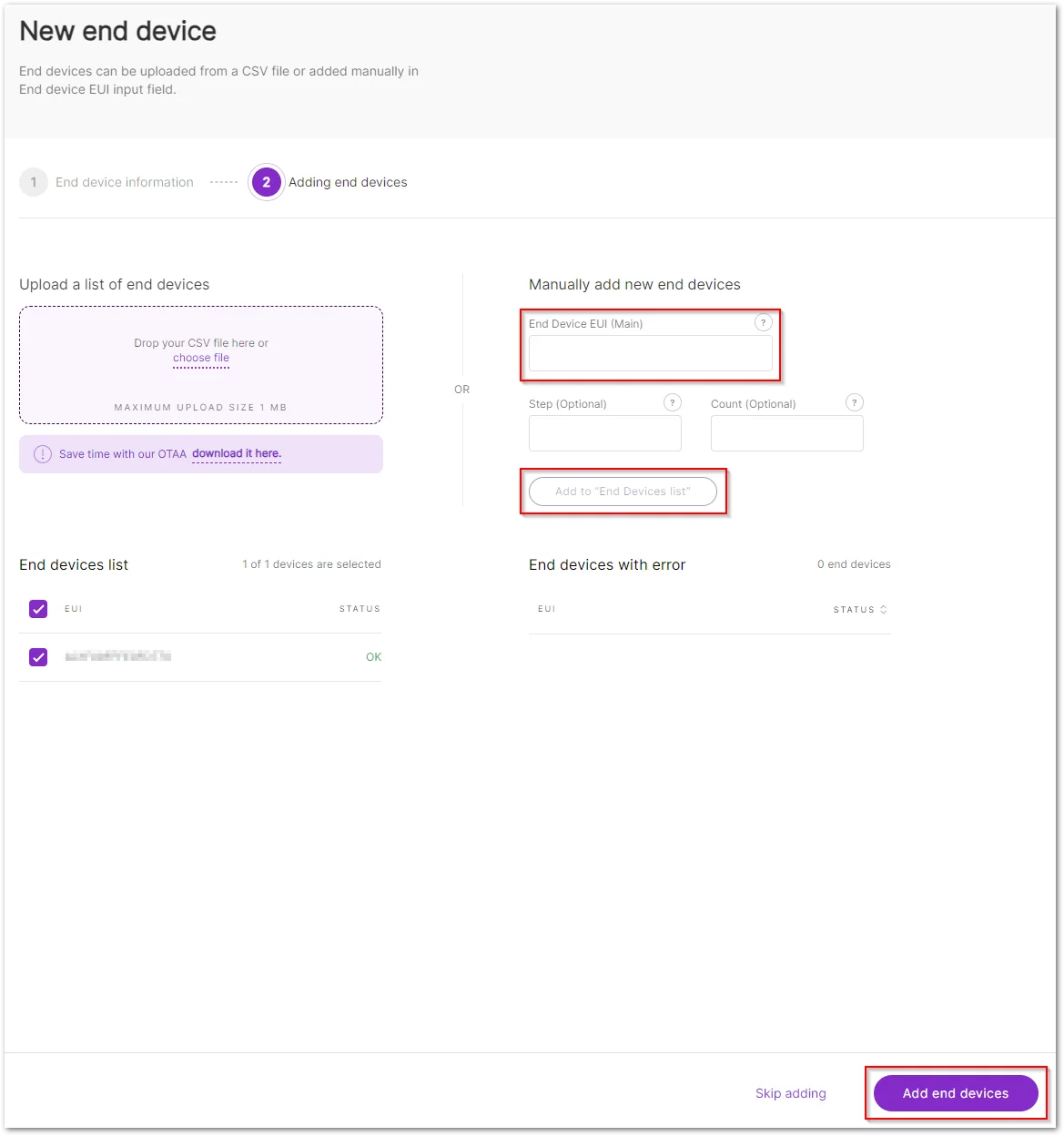

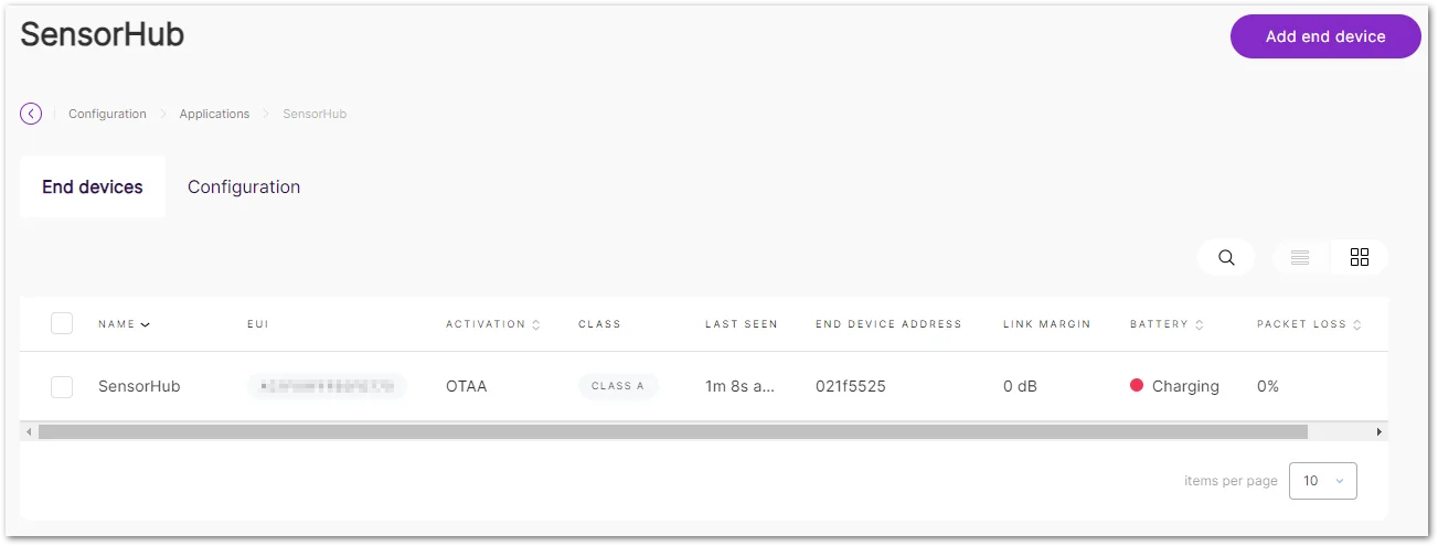

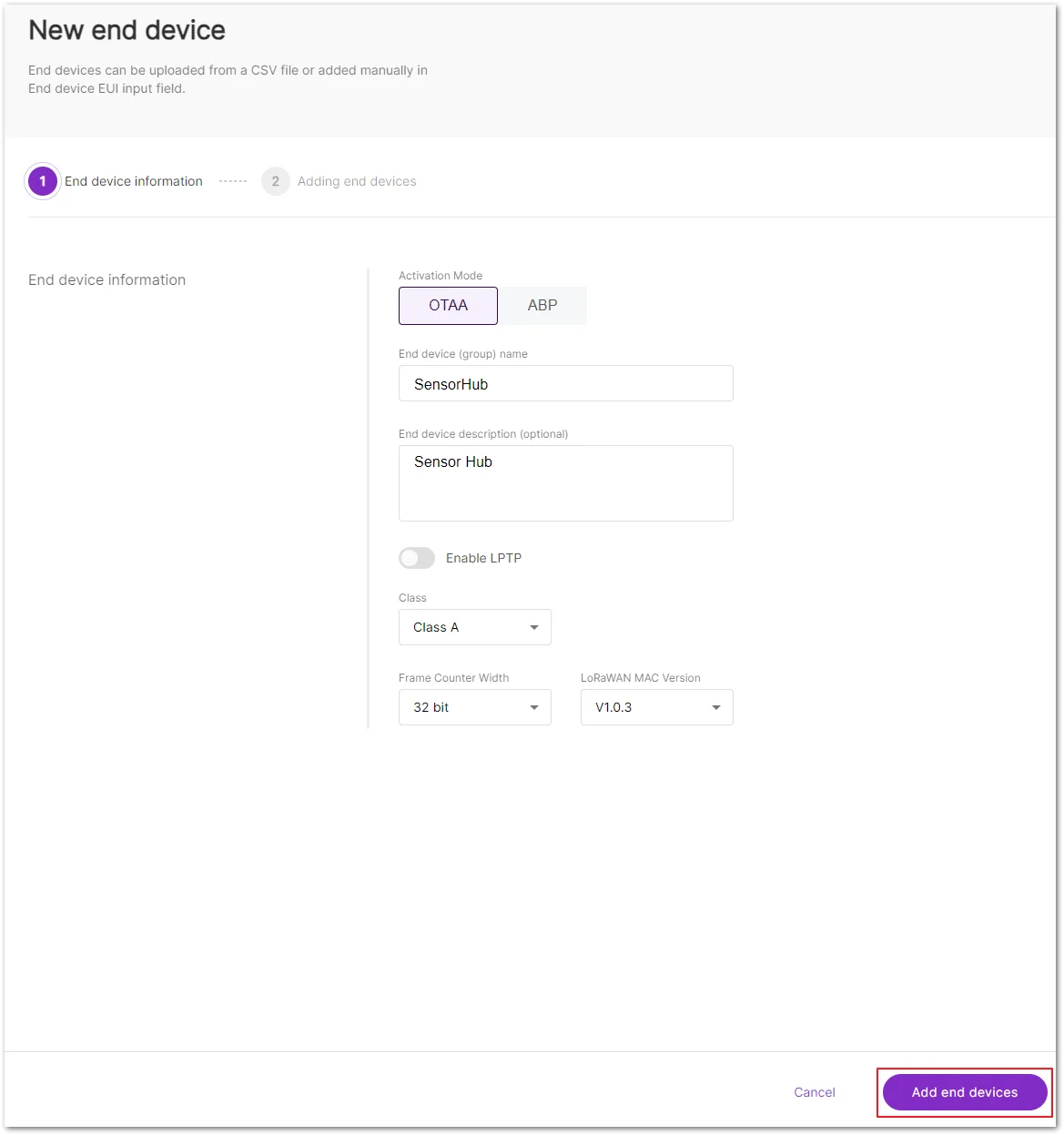

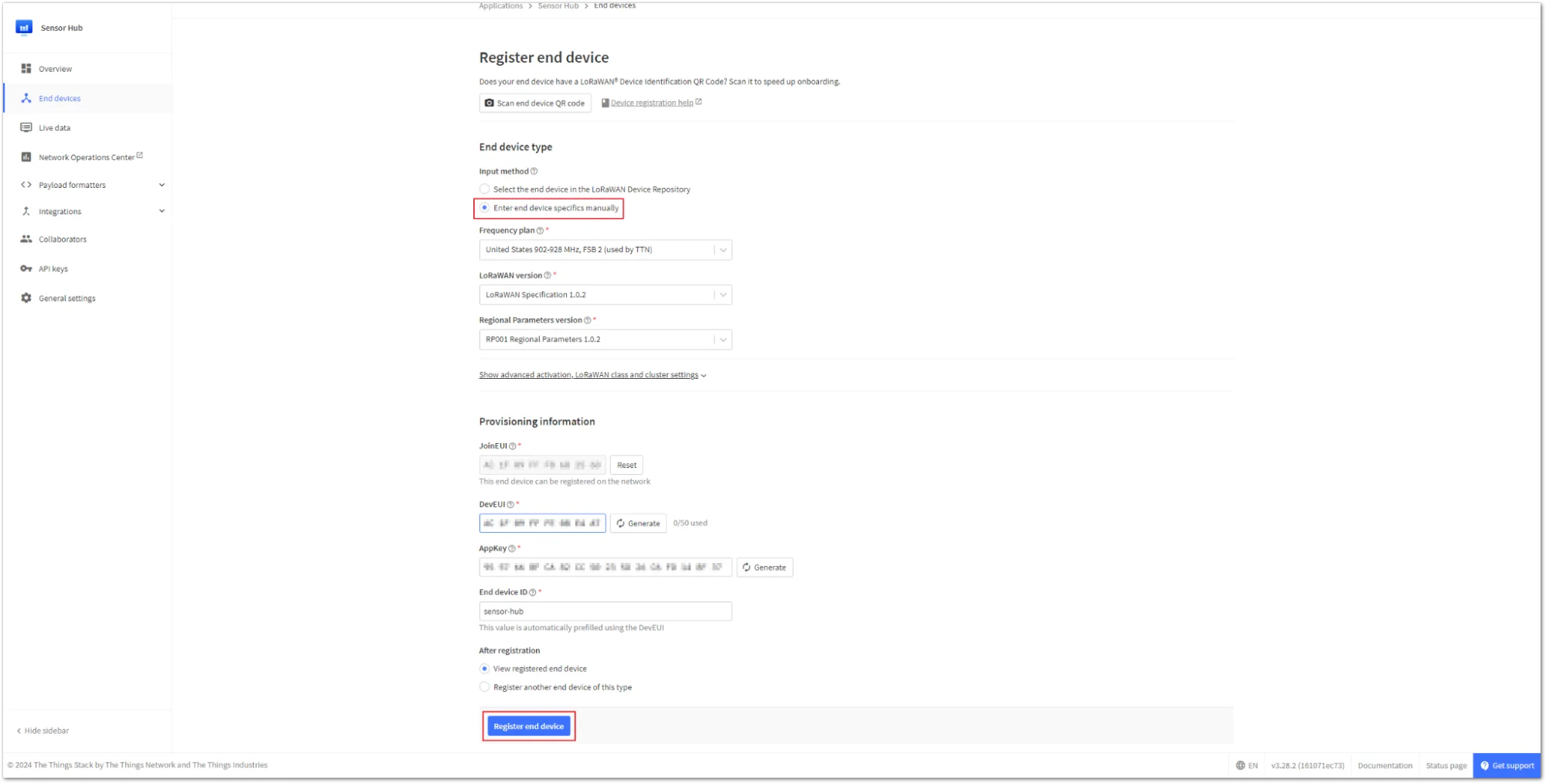

Figure 1: Fill in the Application ID field- Click on the +Register end device button to add a new end device to the application.
Figure 1: End device parameters- JoinEUI, DevEUI, and AppKey can be automatically generated by clicking Generate on the TTN web page. These parameters are customizable as well.
- After completing the settings, return to the WisToolBox app, and click JOIN NETWORK to send the end device network join request.

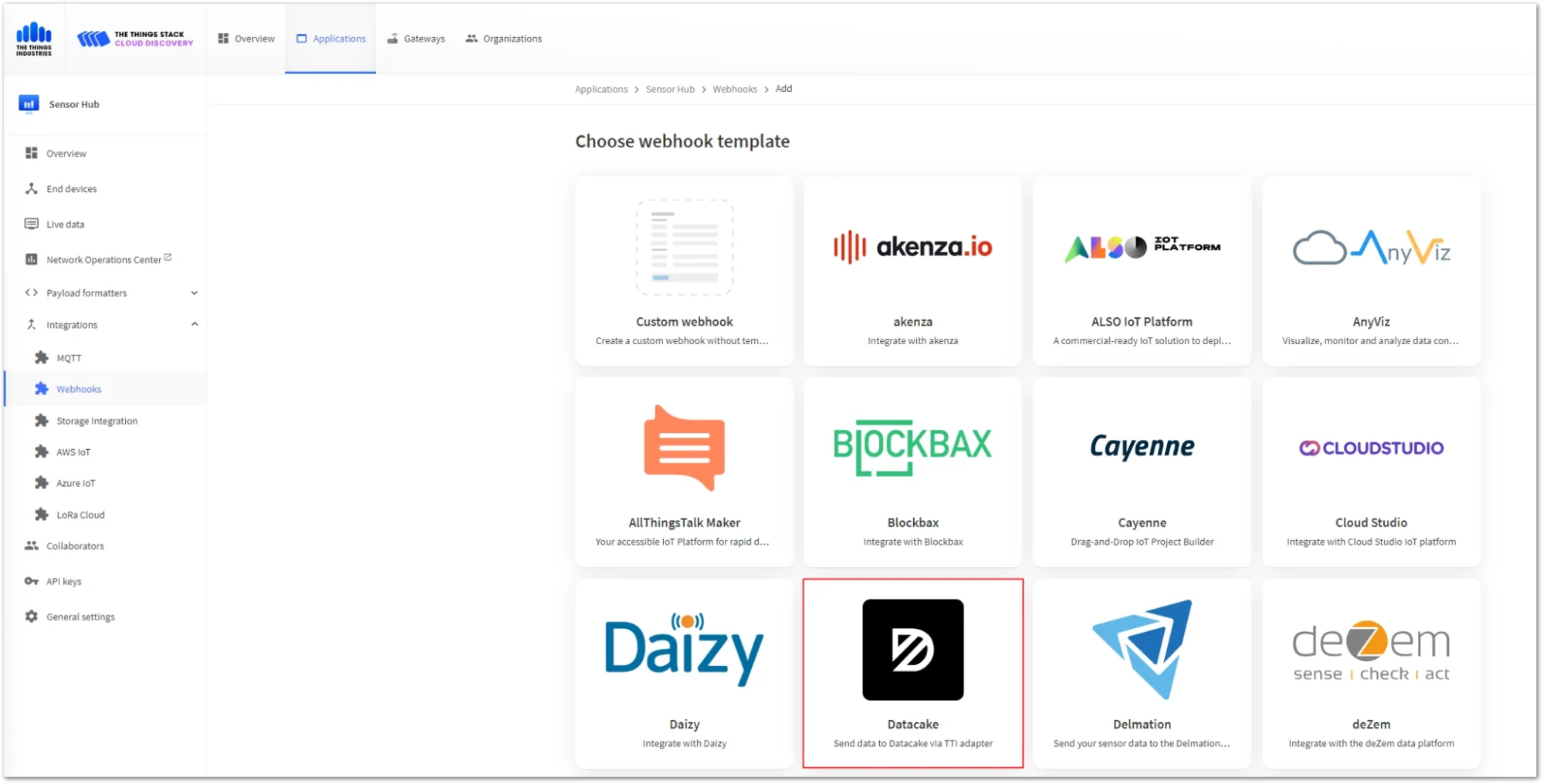

Create Datacake Integration- In the TTN console, navigate to Integrations on the sidebar, proceed to the Webhooks section, and then click +Add webhooks to set up an integration.

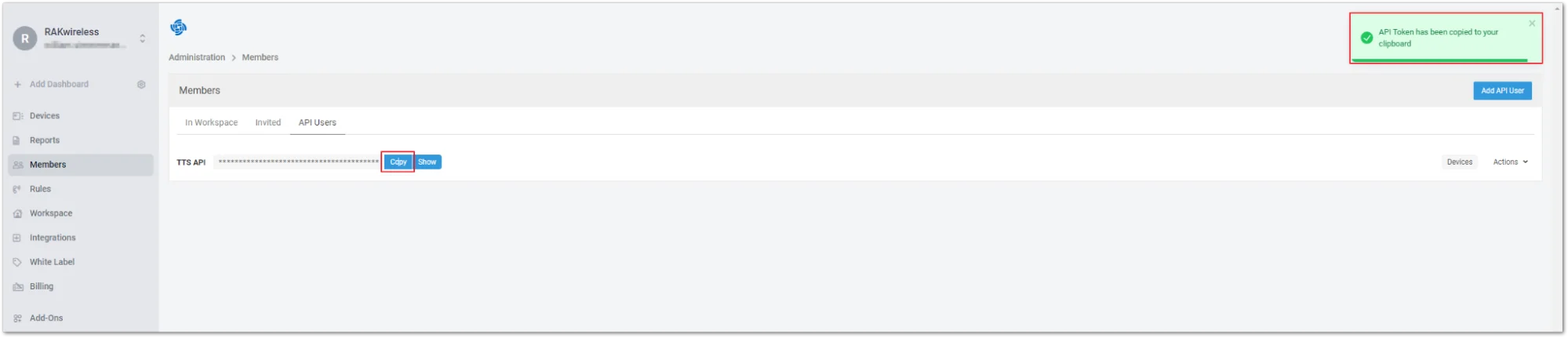

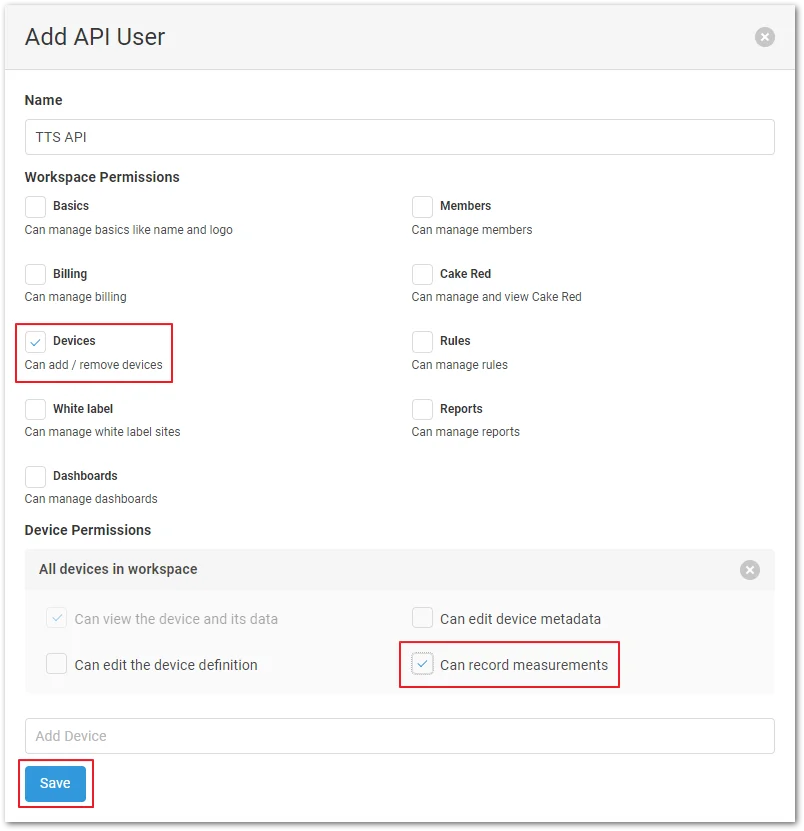

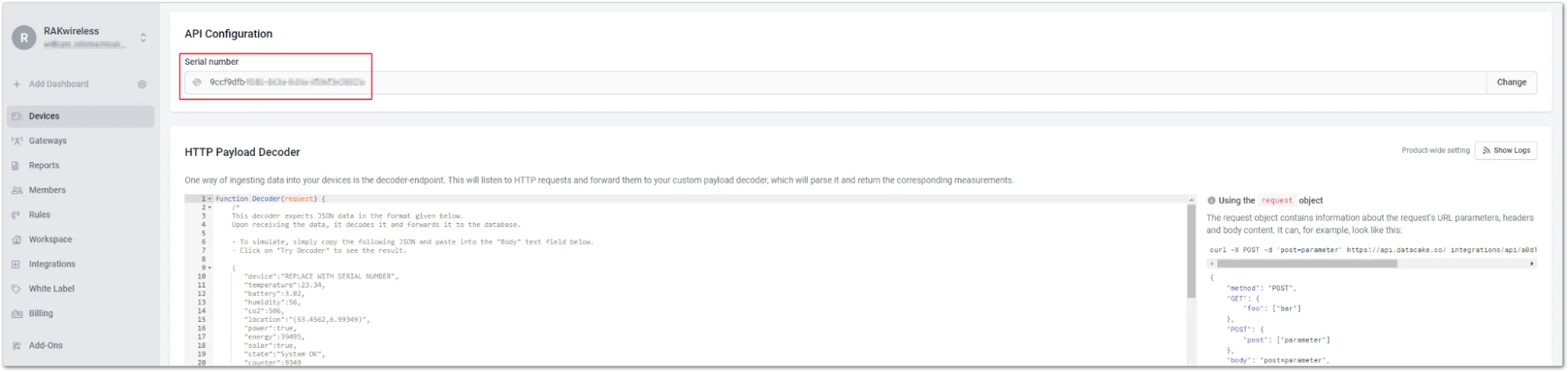

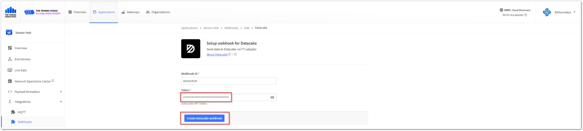

Figure 1: Select the Datacake template- Generate an API key on Datacake to enable webhook authentication. To get started, register a Datacake account, and then log in.
Figure 1: Datacake IoT platform main page- Navigate to the Datacake workspace. Select Members on the sidebar, switch to the API Users tab, then click the Add API User button.

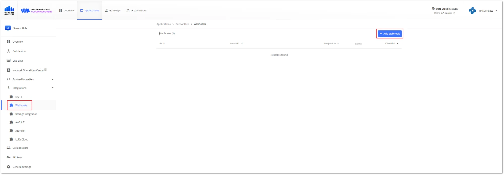

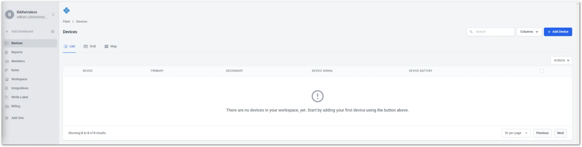

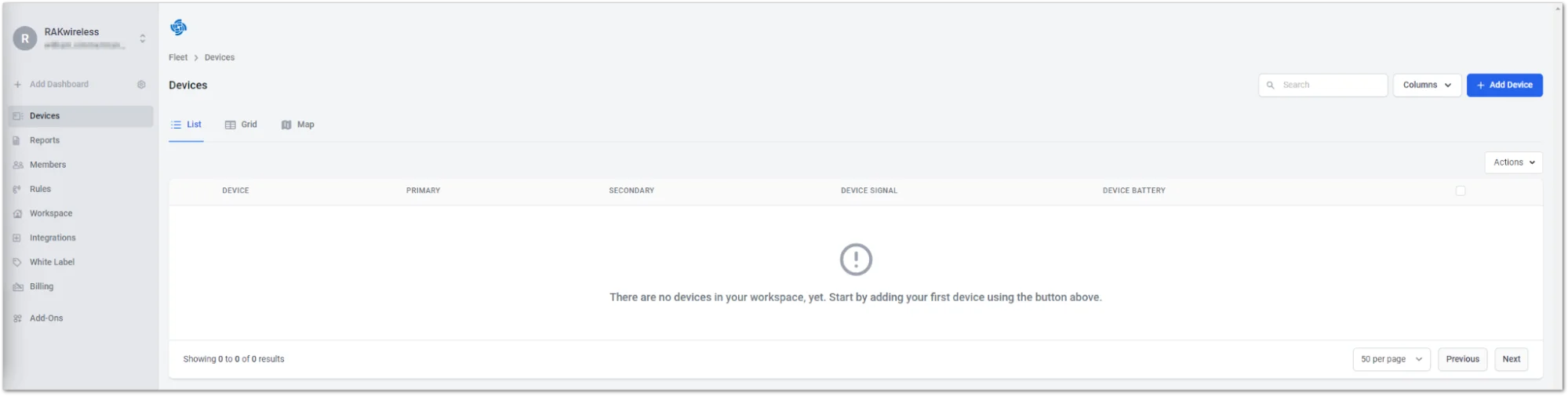

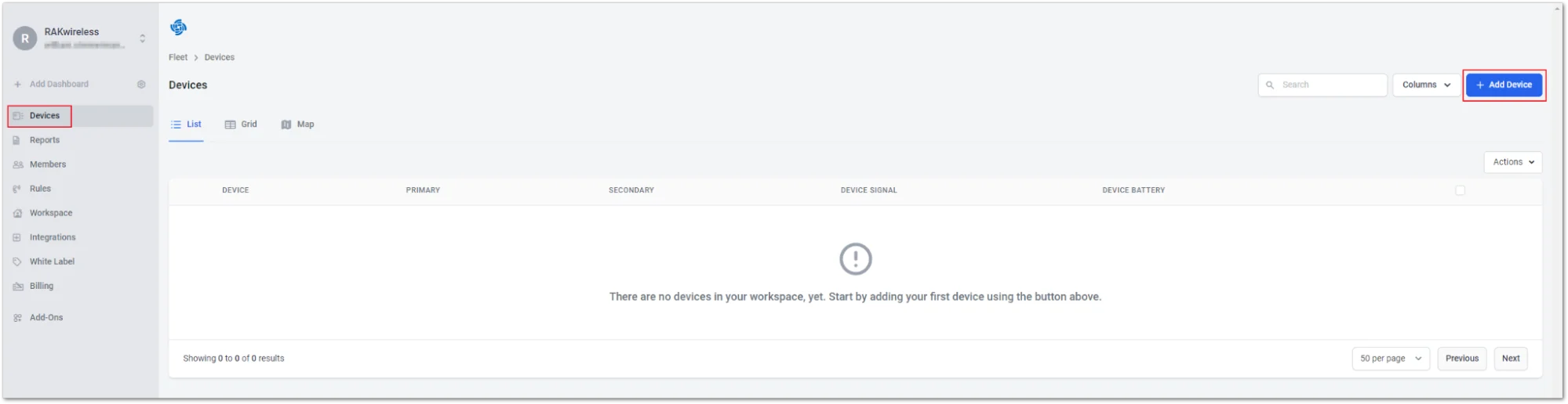

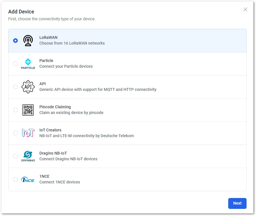

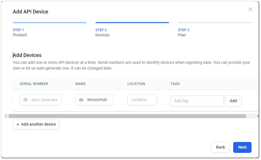

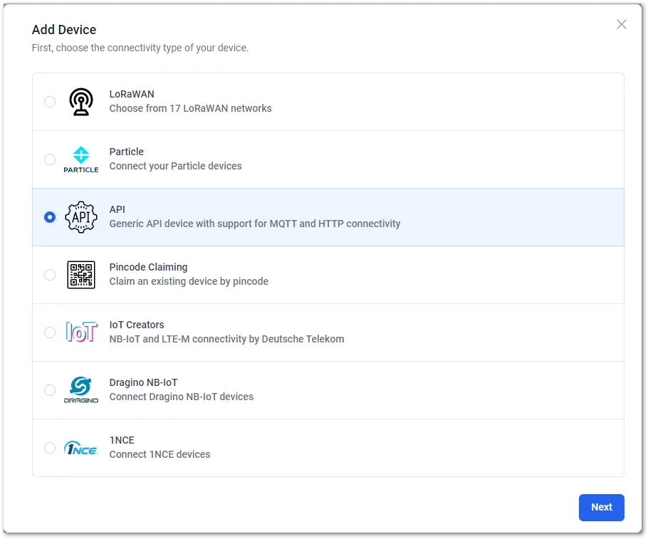

Figure 1: Create the Datacake Webhook- To add a new device, select Devices in the sidebar and click the +Add Device button.

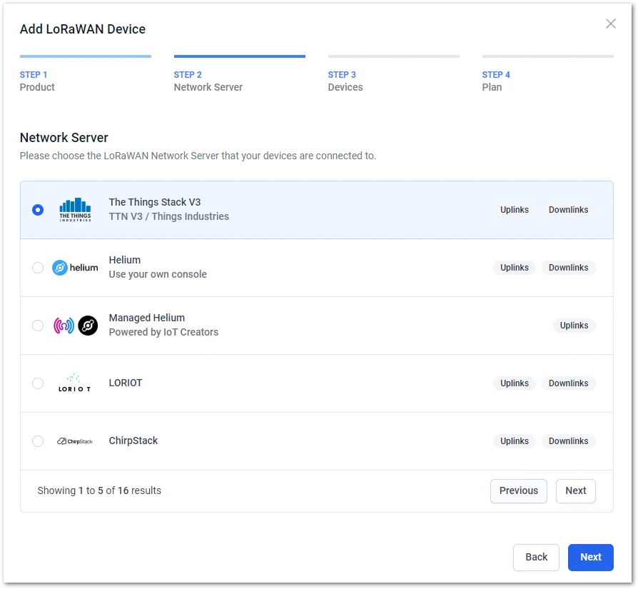

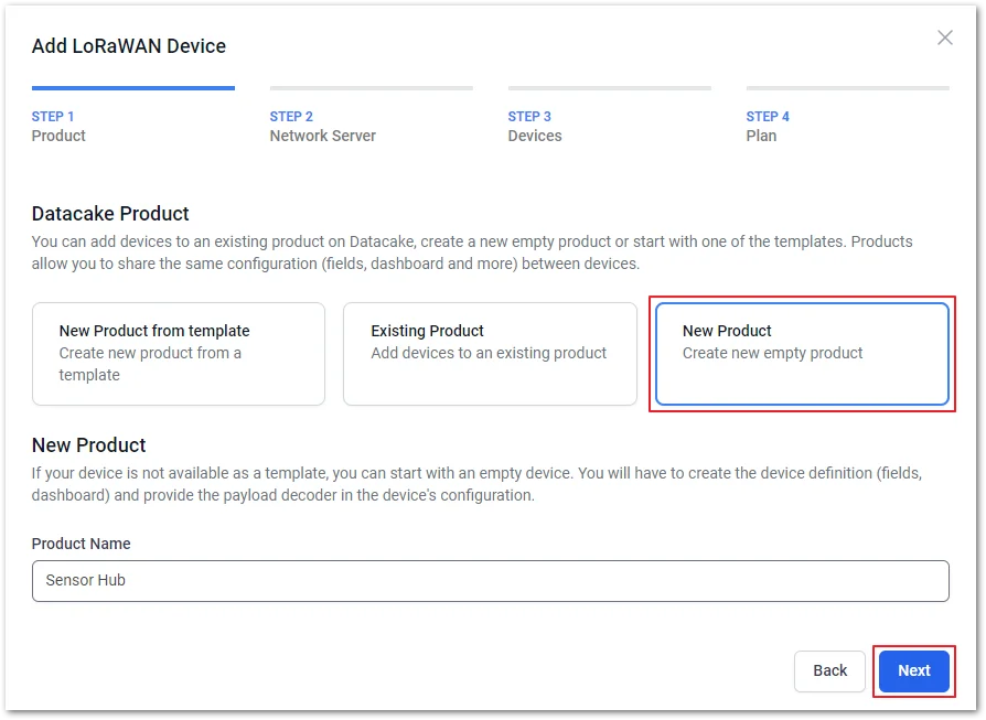

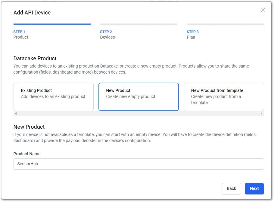

Figure 1: Add a device- Choose LoRaWAN from the options and click Next to proceed.

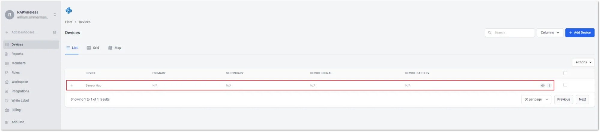

Figure 1: Select LoRaWAN- As the Sensor Hub is a new device, there is no pre-existing template. Create a template by clicking New Product, enter the Product Name, and click Next to proceed.

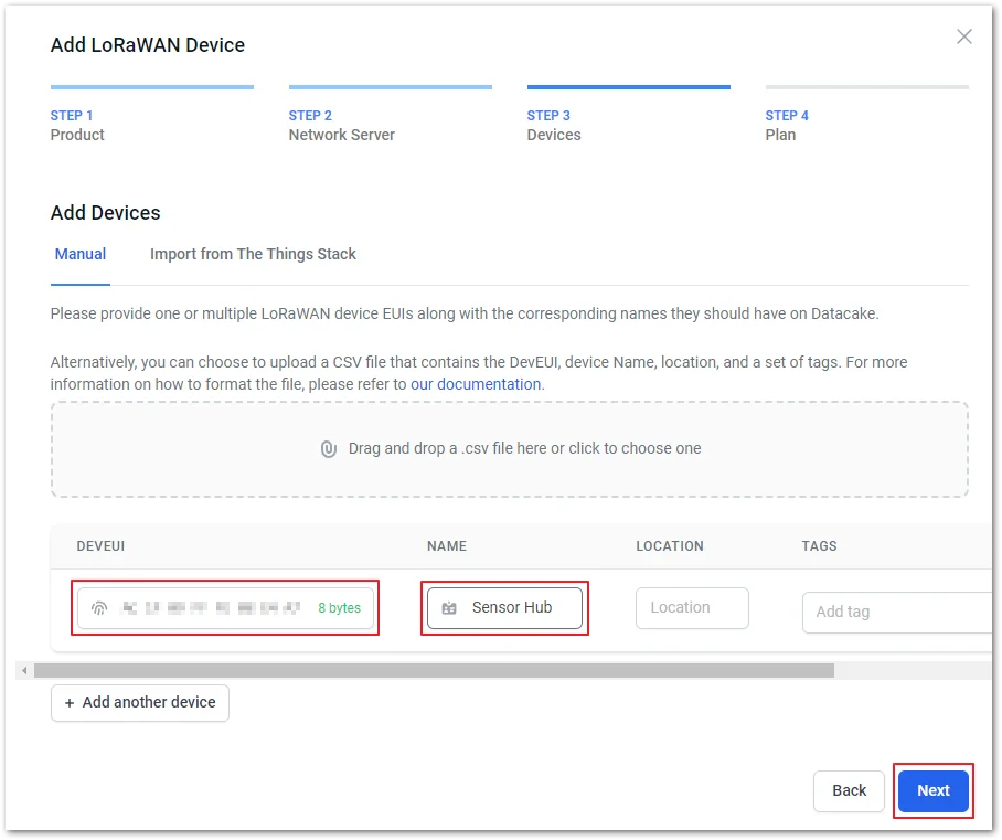

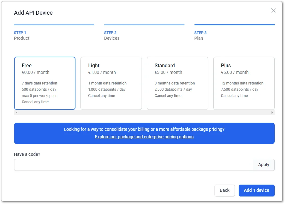

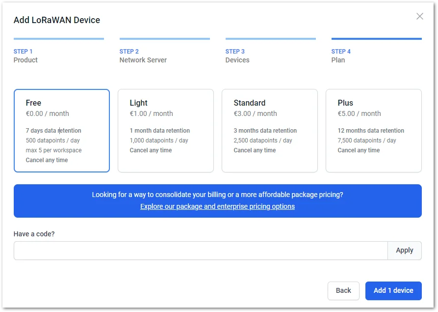

Figure 1: Add DEVEUI and Name- In STEP 4 Plan, select the preferred subscription plan, and click Add 1 device to add the device. For this example, choose Free.

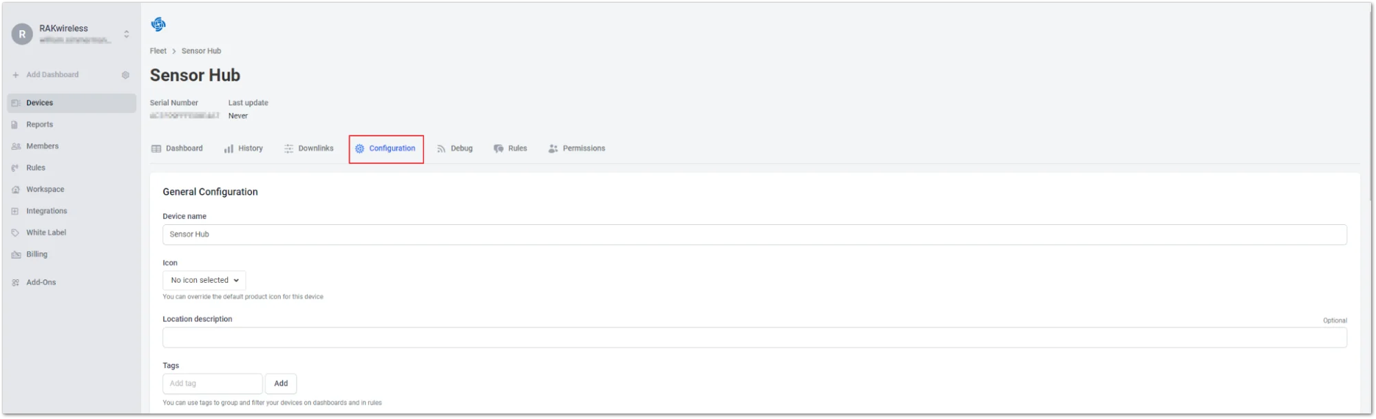

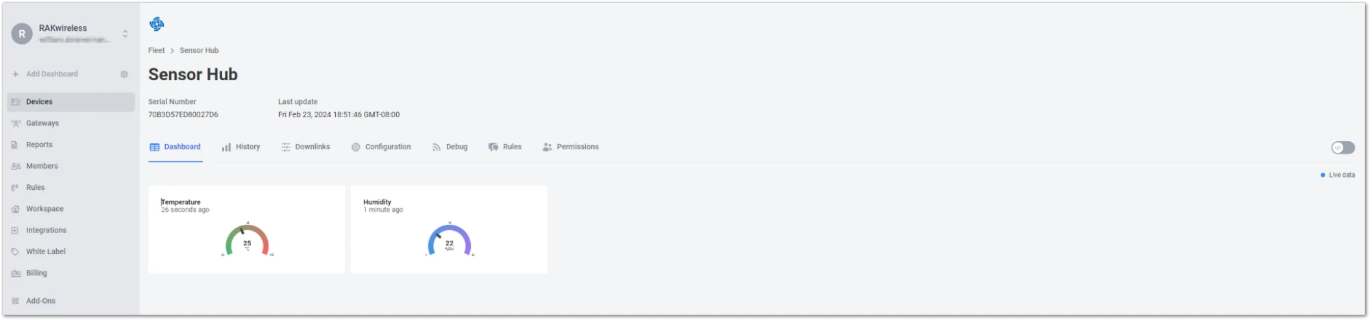

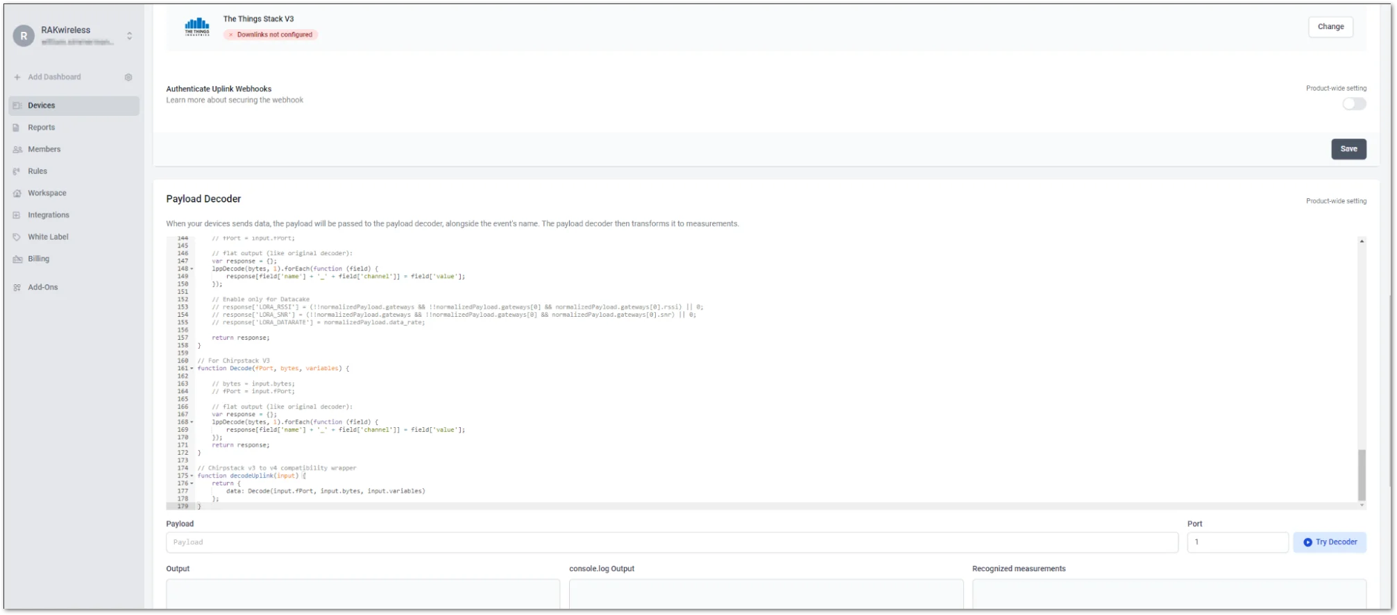

Figure 1: Registered DeviceCreate a Payload Decoder
Figure 1: Configuration tab
Figure 1: Decoder codeClick to view the code

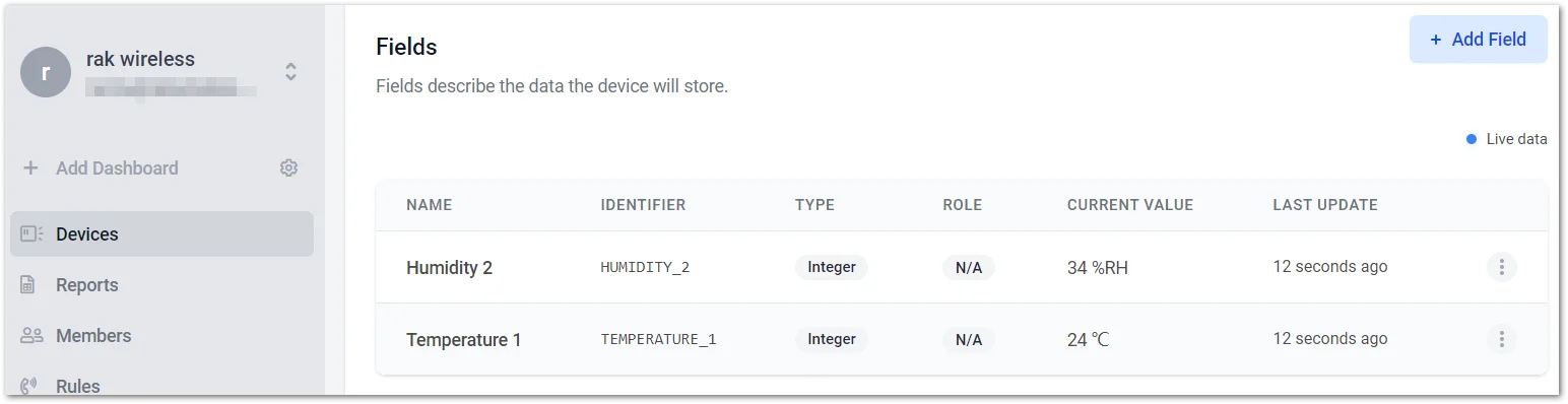

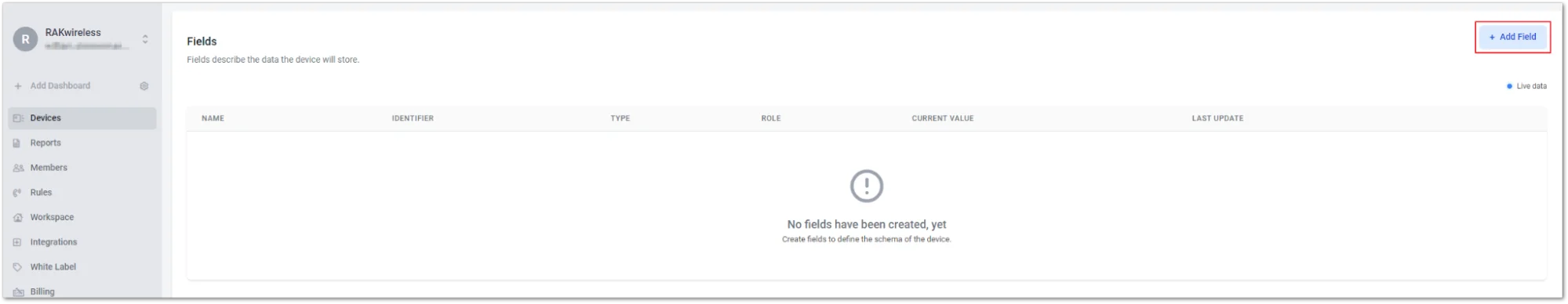

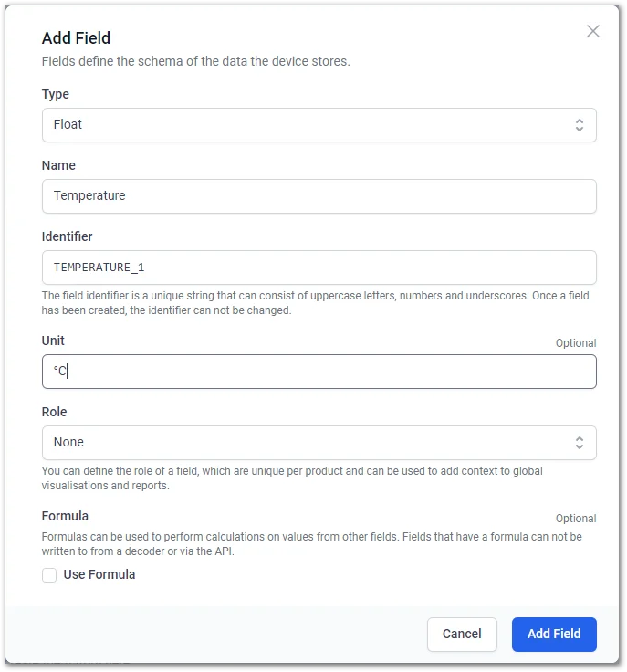

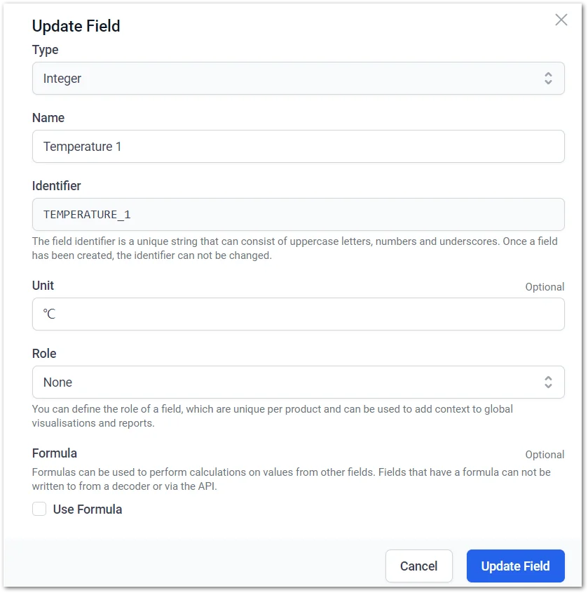

- Scroll down until you find the Fields section at the bottom part of the page, then click the +Add Field button
Figure 1: Add Field- Fill out the fields, as shown in Figure 37, to configure the stored data in the device.
Figure 1: Configuration fields- Enter an appropriate name in the Name field.
- When an uplink is received, refresh the page and the CURRENT VALUE field will be updated.
- When completed, it will look the same, as shown in Figure 38.

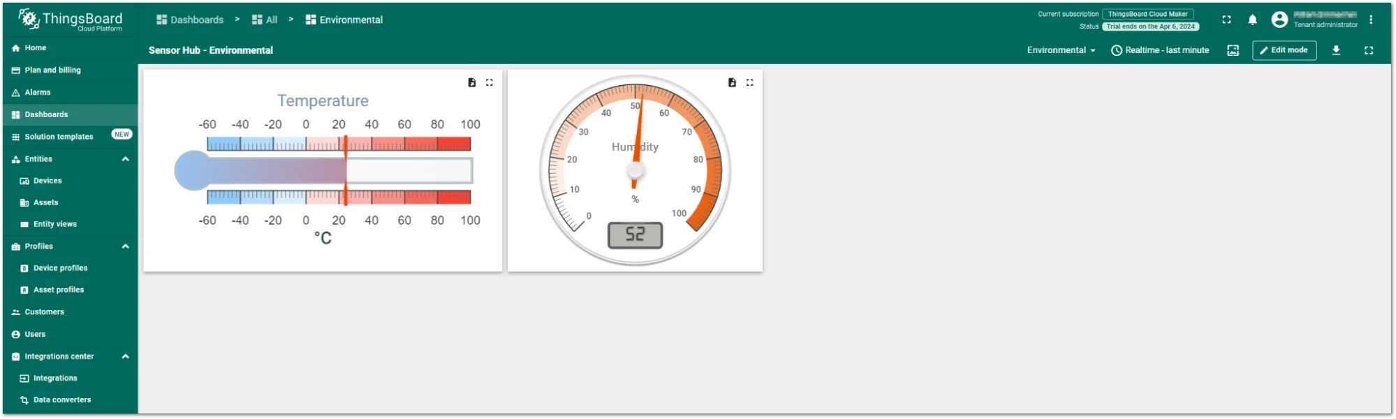

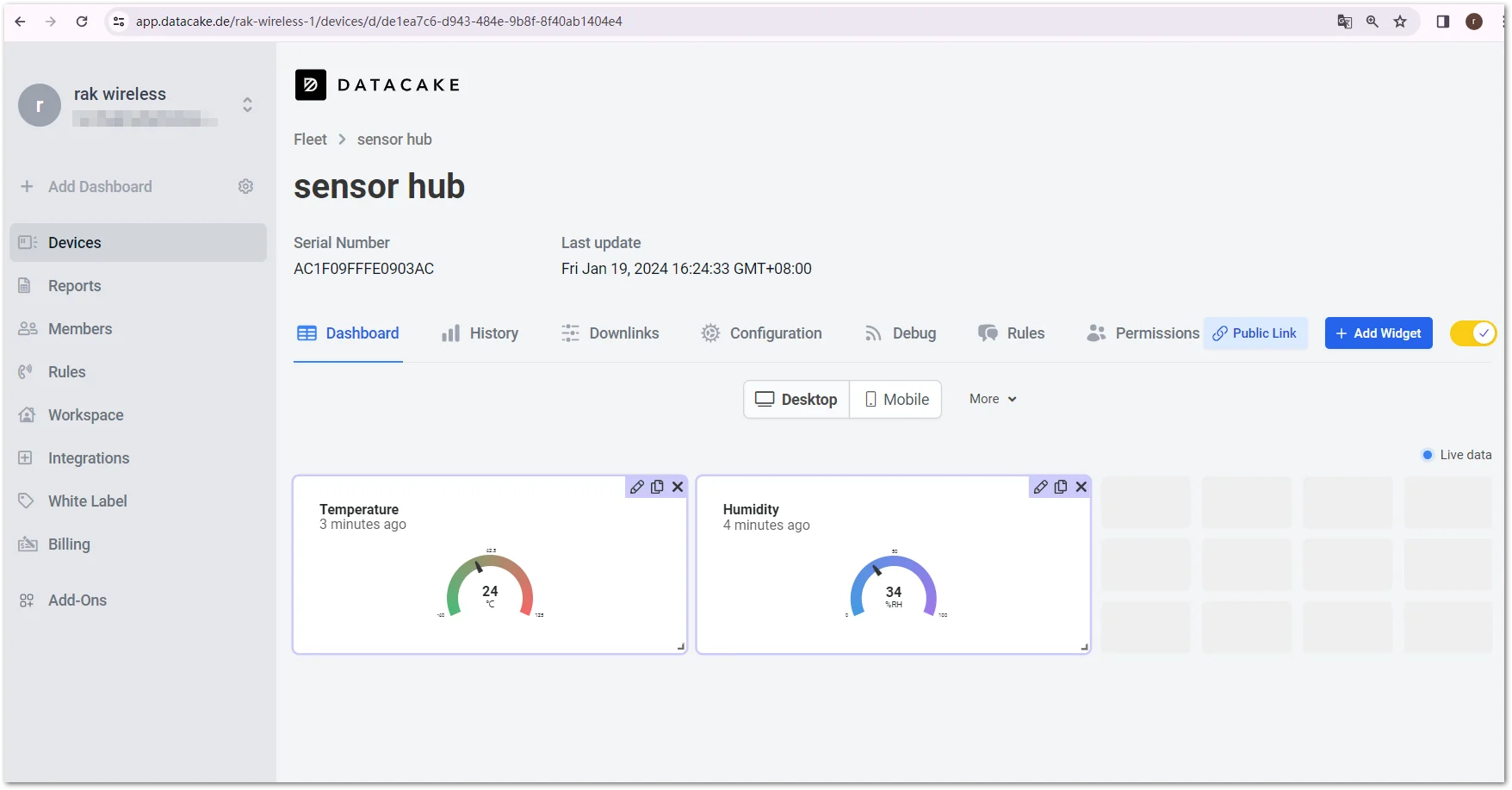

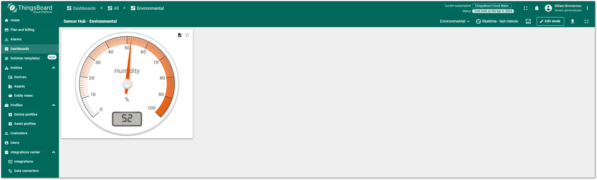

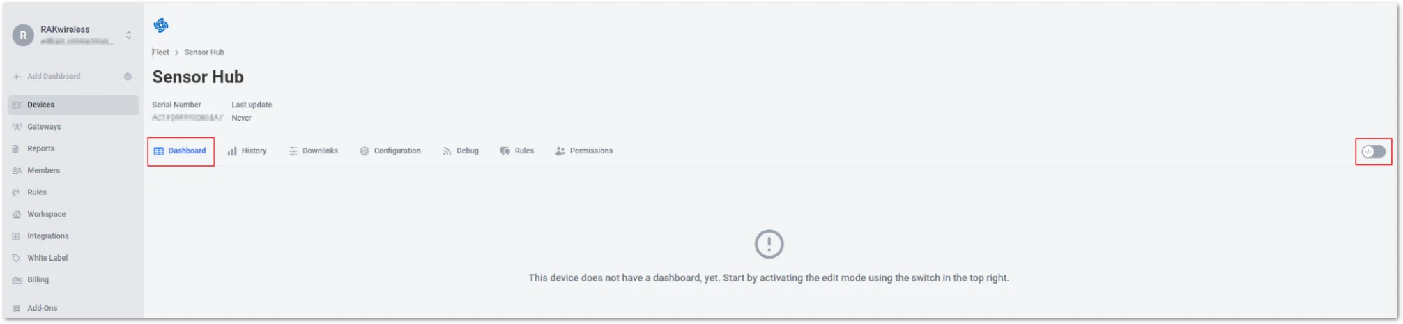

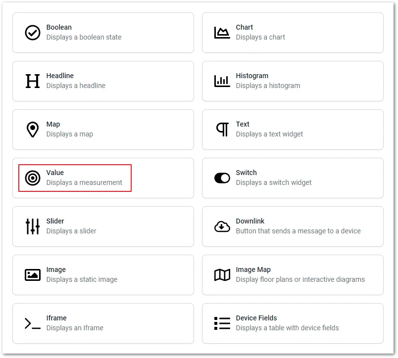

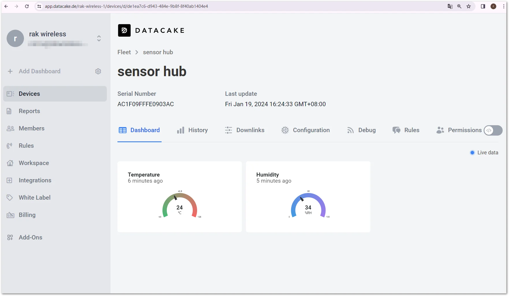

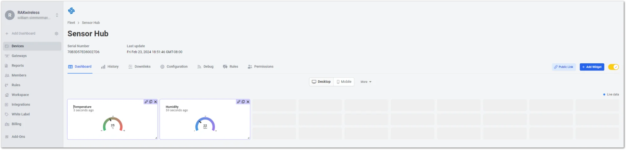

Figure 1: Successfully added fields- To create a dashboard, click the edit mode switch on the Dashboard tab of the device on Datacake.

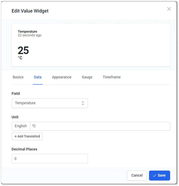

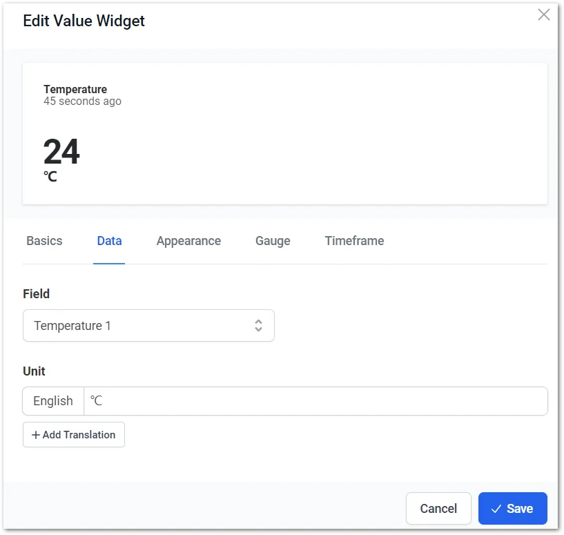

- In the Title field under the Basics tab, name the widget as Temperature.
Figure 1: Name the widget- Under the Data tab, click the Field tab dropdown arrow, select Temperature, and set the unit to °C.

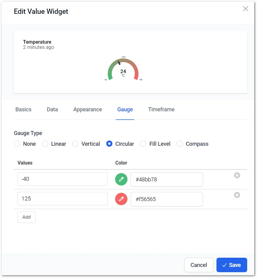

Figure 1: Set the unit- Under the Gauge tab, select the gauge type and color, set the range of values for the widget, and then click Save.

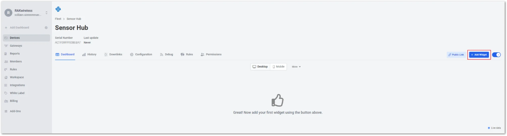

Figure 1: Set the widget type- To add another widget, ensure the edit mode switch is ON, then click the +Add Widget button again.
Figure 1: Added Widget- After adding the widgets, turn off the edit mode switch to save the edits.

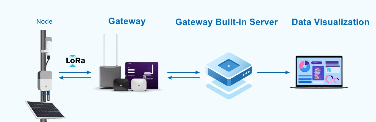

Figure 1: Save the editsBuilt-In Network Server Setup

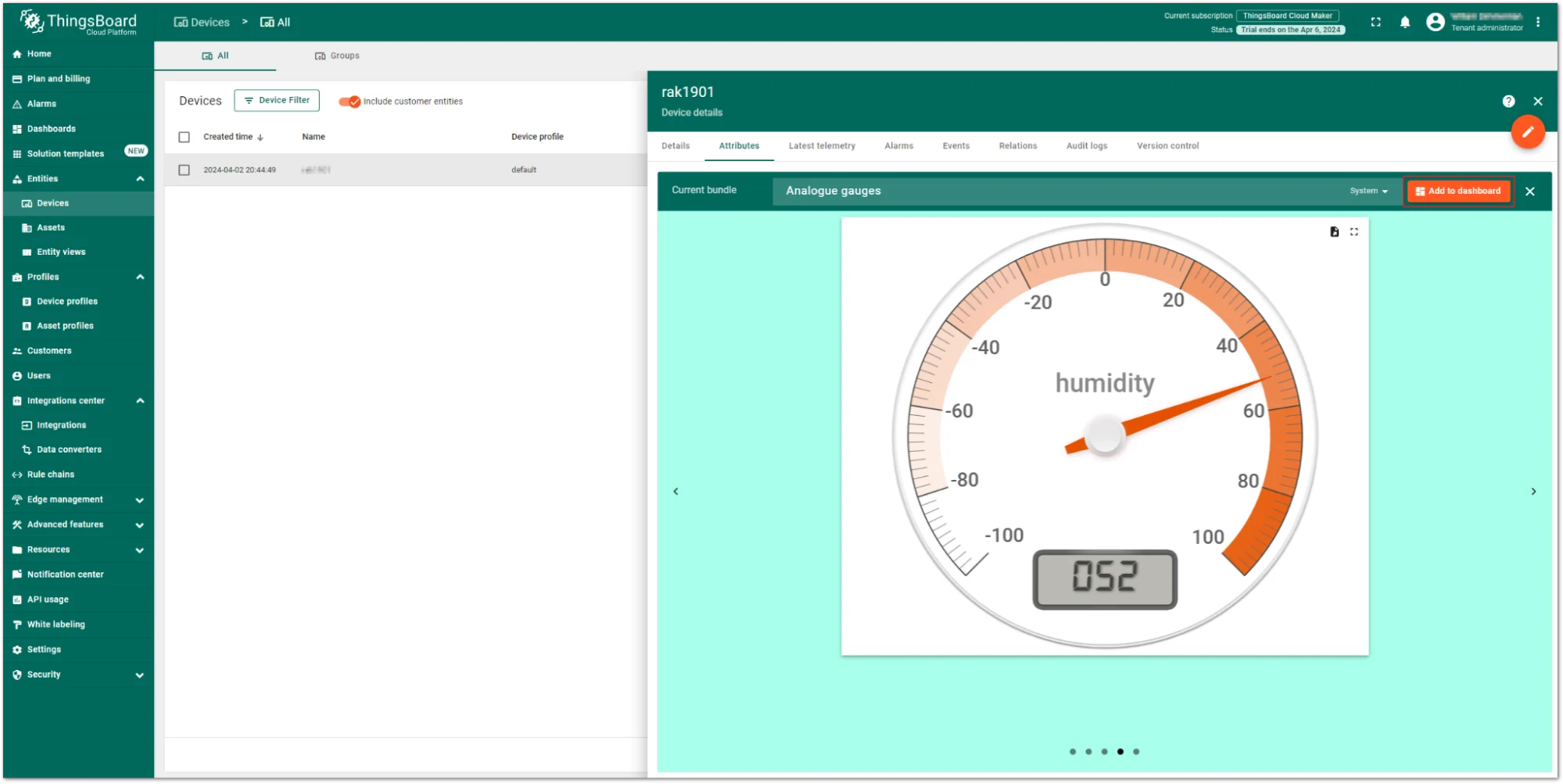

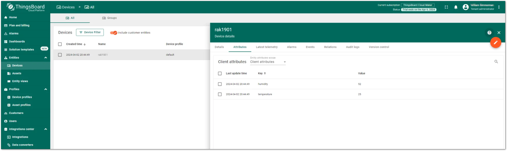

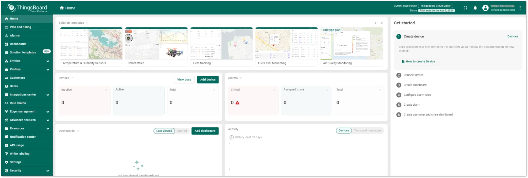

Figure 1: Gateway Built-In NS application scenarioConfigure the ThingsBoard

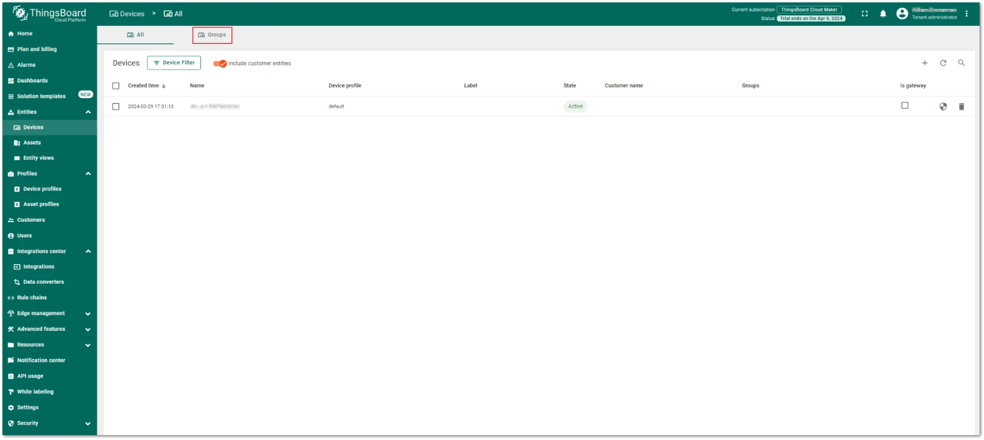

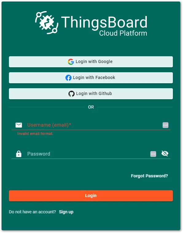

- Log in to ThingsBoard. If you don't have an account yet, create one before proceeding.

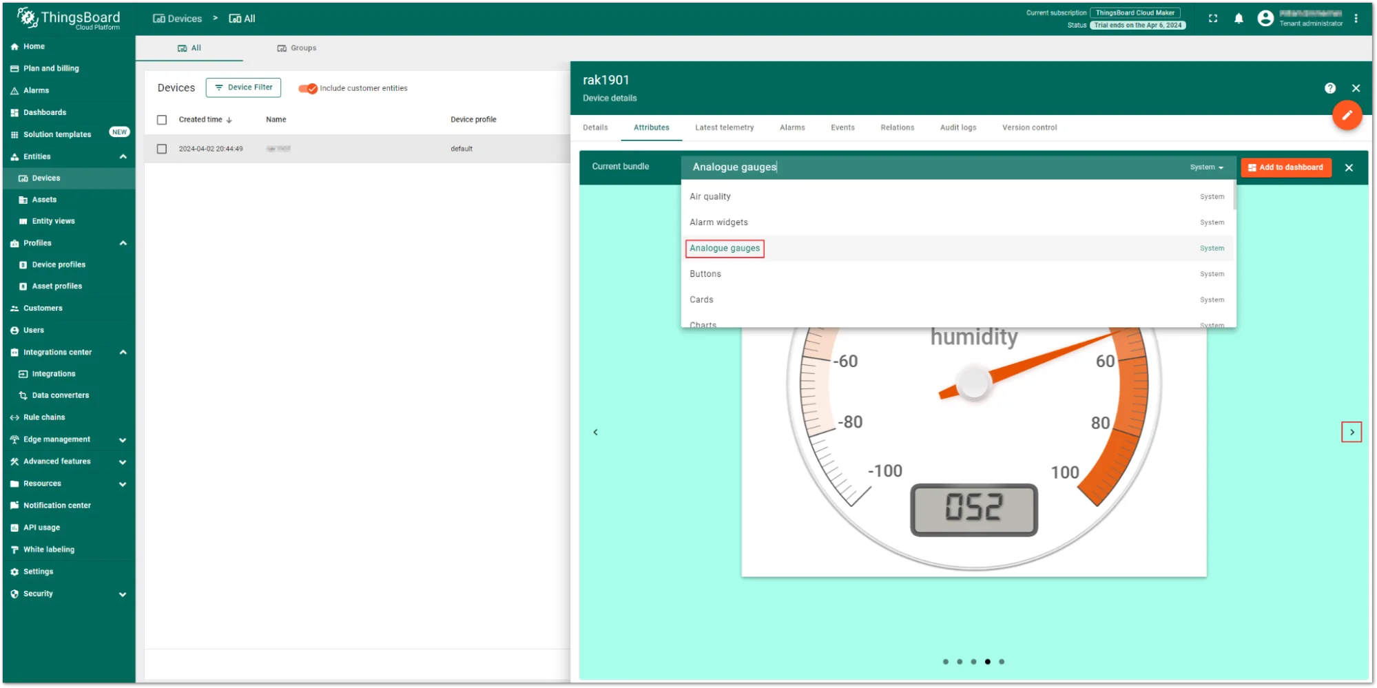

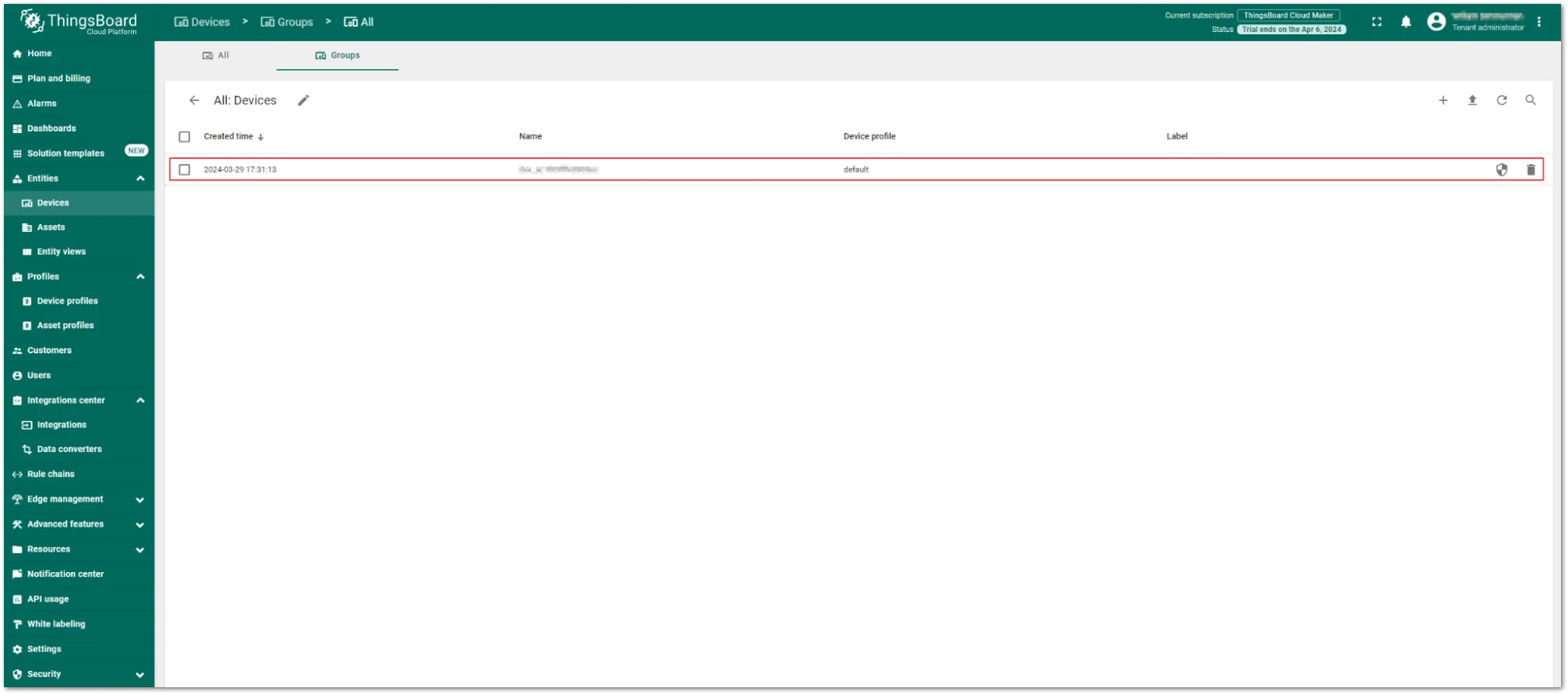

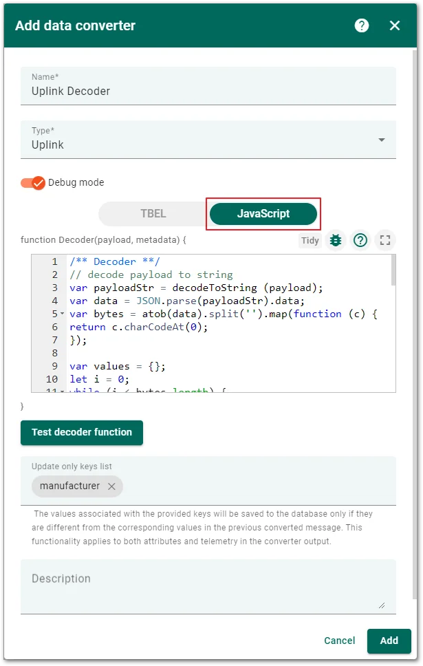

Figure 1: ThingsBoard homepage- Navigate to the Integration center > Data converters in the left navigation tree to create a data converter for the uplink.
Figure 1: Create a data converter- Click the Add Data Converter icon and choose the Create new converter option.
Figure 1: Create a data converter- Enter the name of the decoder in the Name field (for example, Uplink decoder), leave the Type field as Uplink, and select the JavaScript option.
Figure 1: Add the decoder code- Edit the decoder code by copying the following code into the edit box. Click Add to include the uplink decoder.
/** Decoder **/
//decode payload to string
var payloadStr = decodeToString (payload);
var data = JSON.parse ( payloadStr ).data;
var bytes = atob (data).split('').map(function (c) {
return c.charCodeAt (0);
var values = {};
let i = 0;
while ( i < bytes.length ) {
var channelId = (bytes[ i ] << 8) | bytes[ i + 1];
var value;
switch ( channelId ) {
case 0x0167:
value = (bytes[ i + 2] << 8) | bytes[ i + 3];
values.temperature = value / 10.0;
i += 4;
case 0x0268:
value = bytes[ i + 2];
values.humidity = value;
i += 3;
default:

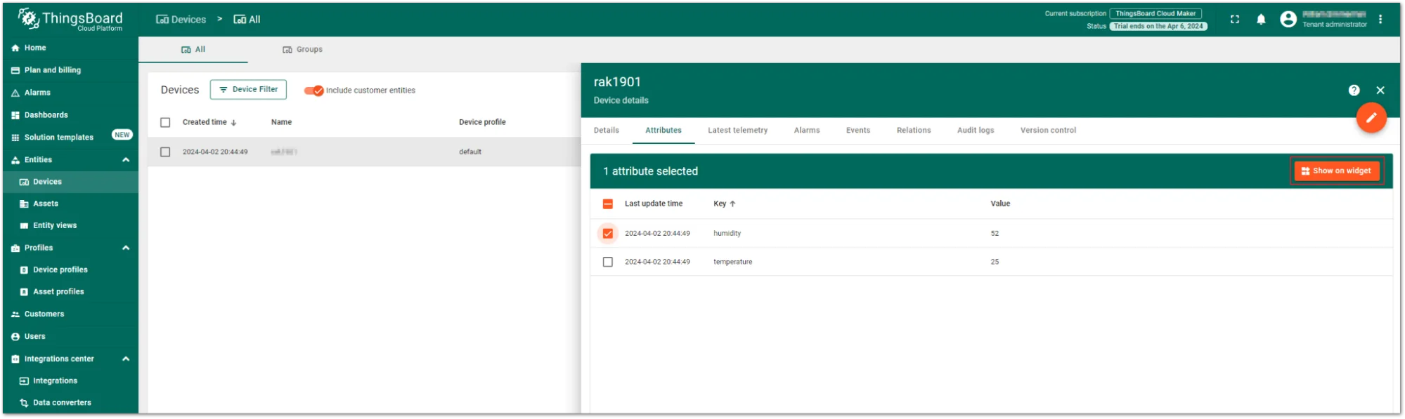

var deviceName = ' rak1901 ';
var result = {
deviceName : deviceName ,
attributes: {
integrationName : metadata[' integrationName '],
temperature: values.temperature ,
humidity: values.humidity ,
/** Helper functions **/
function decodeToString (payload) {
return String.fromCharCode.apply (String, payload);
return result;

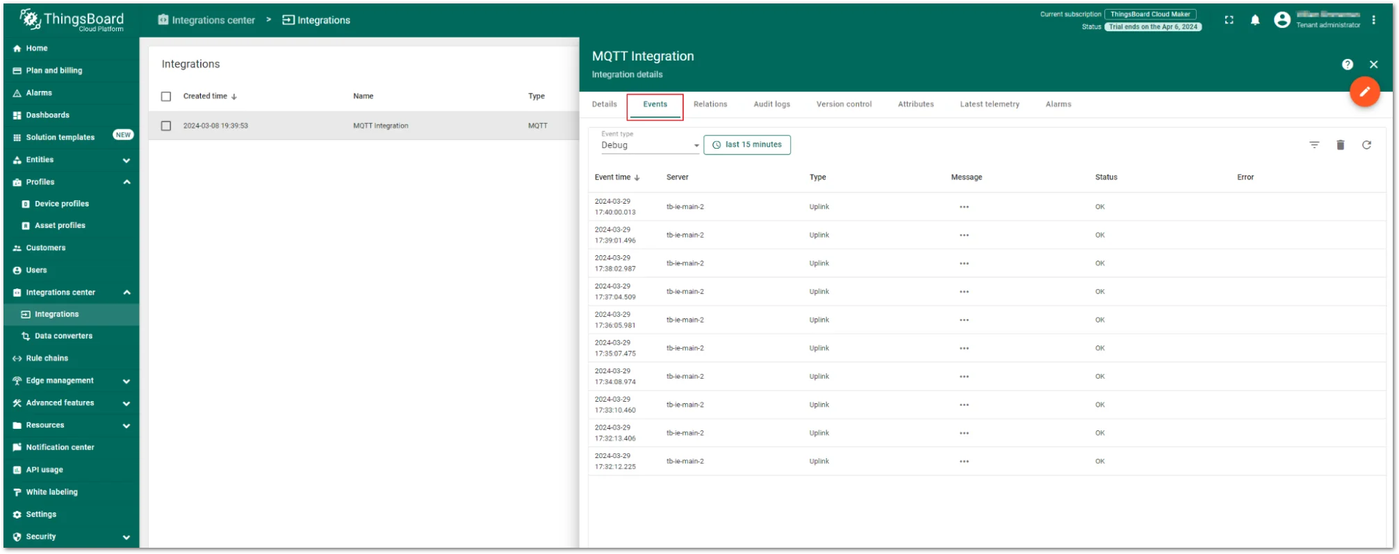

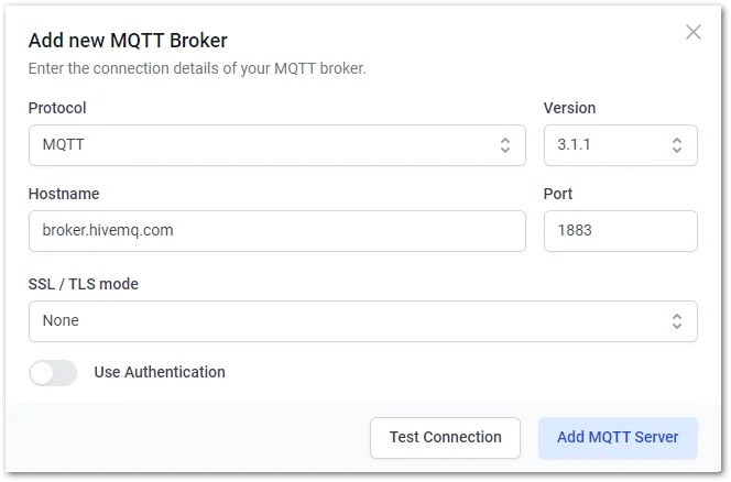

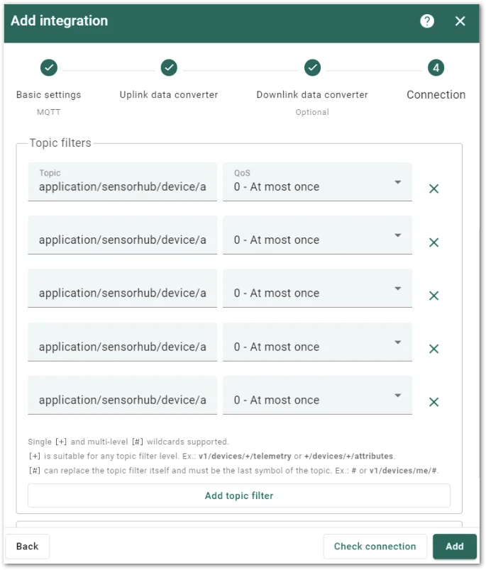

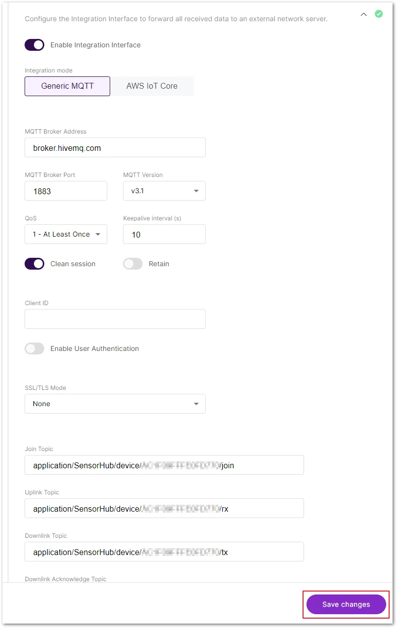

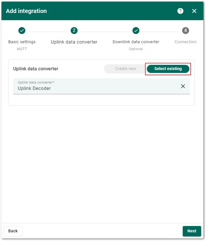

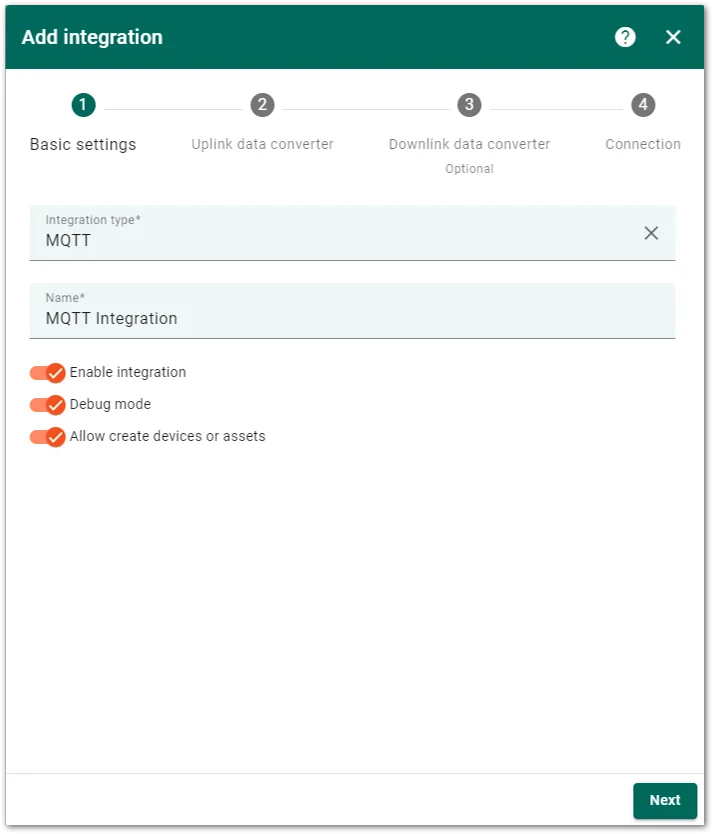

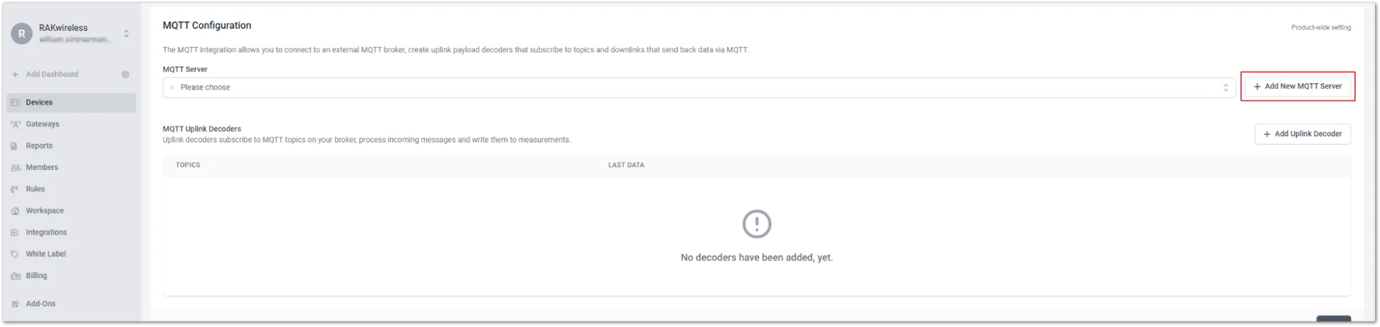

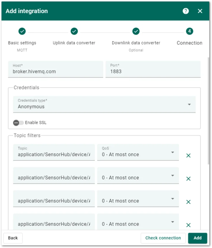

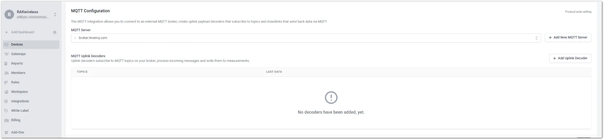

- Navigate to the Integration Center > Integrations menu and click the Add Integration icon to add the MQTT integration.
Figure 1: Add the MQTT integration- Enter the name of the integration (for example, MQTT Integration) in the Name field and select MQTT in the Type drop-down menu. Click Next to continue.
Figure 1: Fill in the integration name- In the Uplink data converter options, click Select existing to choose the previously created decoder (Uplink Decoder), then click Next.
Figure 1: Select the created decoder-
In the Downlink data converter interface, no configuration is necessary and just click Skip to bypass this setup.
Enter the address
Figure 1: Configure the connection optionsapplication/{{application_name}}/device/{{device_EUI}}/join
application/{{application_name}}/device/{{device_EUI}}/rx
application/{{application_name}}/device/{{device_EUI}}/tx
application/{{application_name}}/device/{{device_EUI}}/ack
application/{{application_name}}/device/{{device_EUI}}/status
- Modify the parameter values corresponding to the topics based on the actual application created and the device used. After configuring the details, click the Add button to save and complete the settings.
Figure 1: Configure and add the subscription topicsConfigure the Gateway
Figure 1: WisGate OS Web Management Platform- After successfully logging in, navigate to the LoRa® menu in the left navigation tree and set the Work mode of the gateway to the Built-in network server.
Figure 1: Applications tab- Configure the following information: Application name, Application description, and Application Type.
Figure 1: Configure the Application-
Unified Application key: Choose this option if all devices will use the same application key. Once selected, a field for the application key appears, where you can manually type in an application key or click the Autogenerate button to generate one.
After enabling the Auto Add Device option, configure the Application EUI option. The value needs to be consistent with the node value. Once you have verified the application EUI and key, the device will be added automatically to the application.
Figure 1: End devices tab- Click the Add end device button. In the End device information interface, fill in the following information:
- Class: Select Class A for device's operating mode.
- LoRaWAN MAC Version: The protocol version (v1.0.3) of the end device.
- After completing, click Add end devices to proceed to the next step.
Figure 1: Add new end devices- In the Adding end devices interface, enter the device EUI in the End Device EUI (Main) field and select the Add to End Devices list button. Then click Add end devices to complete adding the end device.
- If the EUI is incorrect, the device will be displayed in the End devices with an error section.
Figure 1: Add the device to the device list- Click the Add button to confirm adding the device.
Figure 1: End Device CreatedConnect Sensor Hub to the Built-In Network Server
For specific configuration on how to connect Sensor Hub to the server, refer to SensorHub Network Configuration > LoRaWAN Application Scenario.
Once completed, the device will join the network. As shown in Figure 68, the end device SensorHub has successfully connected to the gateway's built-in server.
Figure 1: End device SensorHub has been connectedConfigure the MQTT Integration
- Navigate to the LoRa® > Configuration > Integration Interface Parameters section.
- Toggle the Enable Integration Interface option and select Generic MQTT as the Integration mode.
broker.hivemq.com, then click Save changes. -
Figure 1: Automatically created decoder device- Click the device, navigate to the Attributes tab to view the node data.
Figure 1: Node data- To visualize the data, simply select the values you wish to display, then click the Show on widget button.
Figure 1: Data visualization- On the next page, select the desired widget for the data from the Current bundle drop-down menu. In this example, choose Analogue gauges as it has the humidity widget, then click Add to dashboard.
Figure 1: Choose an appropriate visualization chart
Figure 1: Selecting a widget- By default, there is no dashboard in the profile, so you need to select Create new dashboard and enter a name for the dashboard in the new dashboard title field.
- In this guide, name the dashboard SensorHub_Environmental.
Figure 1: Enter the dashboard name- After setting the dashboard name, click the Add button to add more widgets. Alternatively, check the Open dashboard option to automatically open the created dashboard after adding the widget.
If the Open dashboard option is not selected, you can still easily view the added widgets via Dashboard groups > All > [Group Name].
Figure 1: Dashboard created- You can visualize other data from the device following the same steps as above. The only difference is that when adding the widget, instead of Create a new dashboard, click Select existing dashboard.
Figure 1: Adding widgetsNB-IoT/LTE CAT-M1 Application
In the Network Server and Visualization Configuration section, the server has been set as a public MQTT broker: broker.hivemq.com. You can also choose other brokers or servers, such as AWS IoT Core (optional), according to the actual usage scenario.
Figure 1: NB-IoT/LTE CAT-M1 Application ScenarioVisualize Data Through Datacake
Add Sensor Hub to Datacake
- After logging in to your account, navigate to the Devices tab and click +Add Device to proceed with adding the Sensor Hub end device.
Figure 1: Add the end device, SensorHub- Select the API option and click Next to proceed.
Figure 1: Add devices- Select the preferred subscription plan, then click Add 1 device. For this example, choose Free.
Figure 1: Configure the external MQTT Broker- Fill in the relevant information based on the actual server used, then click Test Connection to verify whether Datacake can successfully connect to the MQTT Broker.
Figure 1: Configure the relevant parameters- After successfully adding the MQTT server, click on +Add Uplink Decoder to add a decoder.

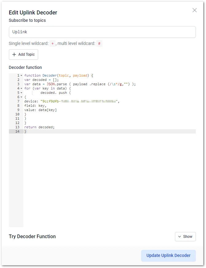

Figure 1: Add MQTT Server- A new window will appear, and fill in the fields according to your project.
var decoded = [];
var data = JSON.parse(payload.replace(/\s*/g,""));
for (var key in data) {
decoded.push(
device: "7d9afdfb-97ea-4de1-ab15-36d7e69629e6",
field: key,
value: data[key]
return decoded;
In the above code, make sure that the parameter serial_number (device: 7d9afdfb-97ea-4de1-ab15-36d7e69629e6) matches the serial number saved locally earlier.
- In the Fields option, click +Add Field to show the monitoring values of the devices. Each device can create a certain number of fields, also known as a data point.
Figure 1: Add Field- Set the necessary parameters of the Field. For Fields with multiple data points, add them one by one. Once done, click Add Field.
Figure 1: Added sensor monitoring values- Follow Steps 10-11 to add other monitoring parameters.

- On the device details page, navigate to the Dashboard tab, then toggle on the edit mode switch.
- Click on the +Add Widget button to add a widget for visualizing data.
Figure 1: Open the edit mode- Choose what type of widgets you want to display. For this example, select Value to visualize temperature monitoring values.
Figure 1: Select and add widgets for visualizing data- Go to the Data tab and choose the data you want to visualize from the available Field options. For this example, select Temperature and set the unit of the field to °C.
Figure 1: Select the visualization data field- After configuring the widget, click Save. You should now see the successfully created temperature widget on the dashboard interface.
Figure 1: Successfully created temperature widget-
To add more parameter widgets, click the +Add Widget button again with the edit mode toggle switch ON, then repeat Steps 2-5.
Once done with the dashboard configuration, turn off the edit mode switch to save the settings.
Figure 1: Environmental Monitoring data visualization
