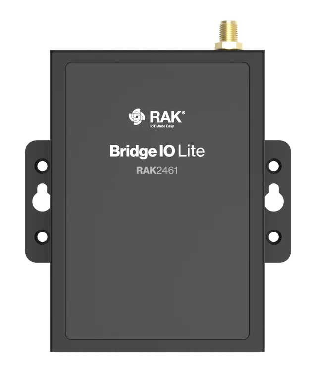

RAK2461 Remote Configuration via LoRaWAN Downlink
Supported WisNode Bridge devices can be configured remotely through LoRaWAN® downlink commands. This guide describes the common command format, channel-specific payload definitions, and how to send remote configuration commands through a LoRaWAN Network Server. The available channel types and configurable parameters vary by device. Refer to the documentation for your device to determine which interfaces and channels are supported.
Supported Devices
This remote configuration protocol is supported by the following WisNode Bridge devices. Available channel types depend on the device model and variant.
| Device | DI | DO | Modbus |
| RAK2461 RS485-DIx4-DOx1 | ✓ | ✓ | ✓ |
| RAK2461 RS485-DOx4 | — | ✓ | ✓ |
| RAK2470 WisNode Bridge Serial Prime | — | — | ✓ |
