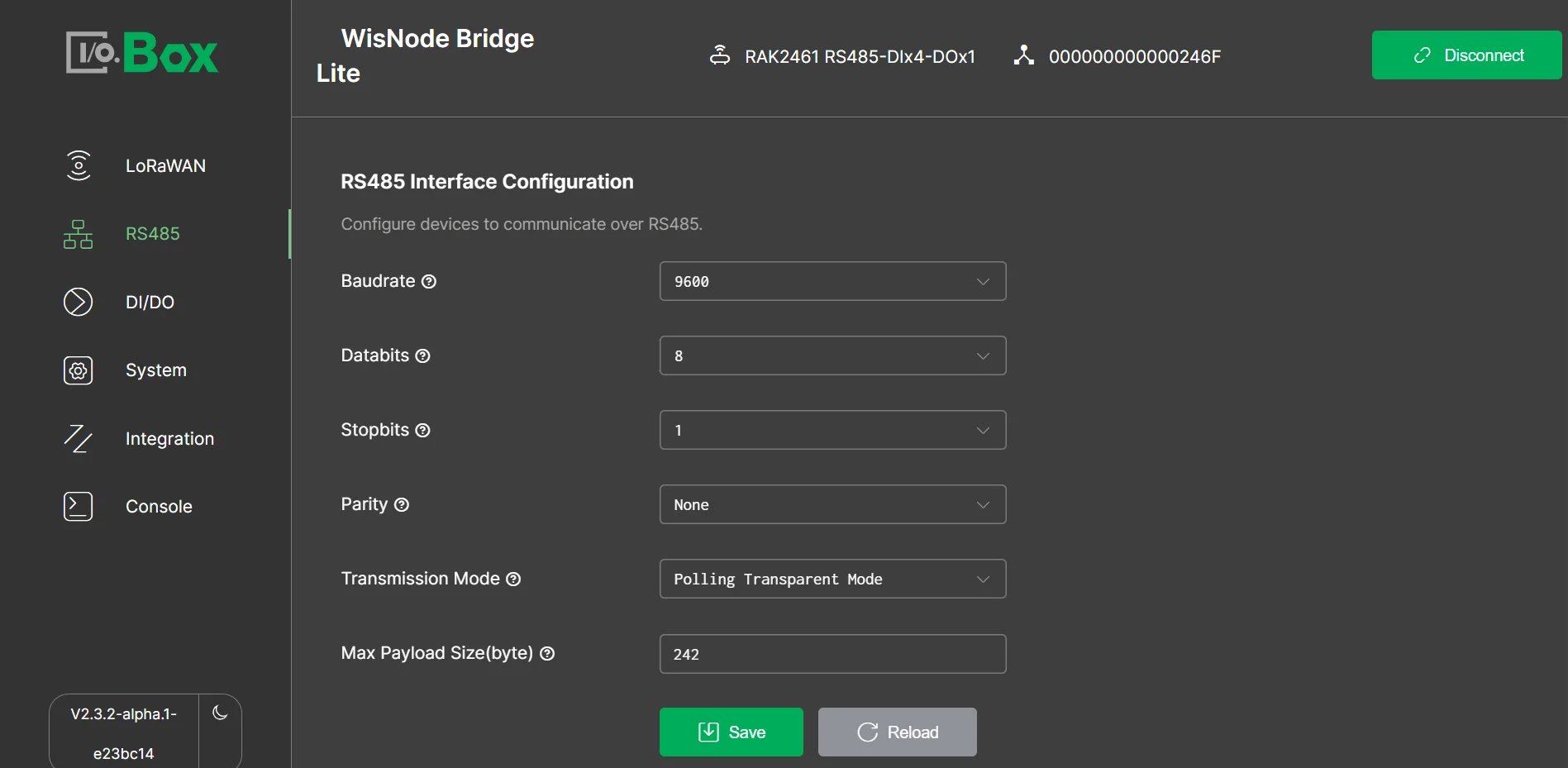

- In IO.Box, go to RS485.
- Configure the RS485 communication parameters to match the connected device.
- Set Transmission Mode to Polling Transparent Mode.
Figure 1: Polling TransparentNOTEThe Max Payload Size is determined automatically according to the configured LoRaWAN region and DataRate.

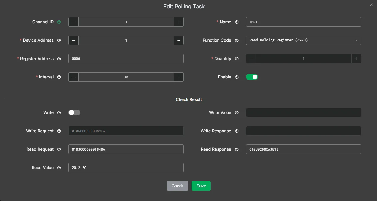

- Create the required Modbus Polling Tasks according to the RS485 device specification.
Figure 1: Polling Task - Use Check to validate communication with the connected device.
- Save the polling task when the returned data is correct.

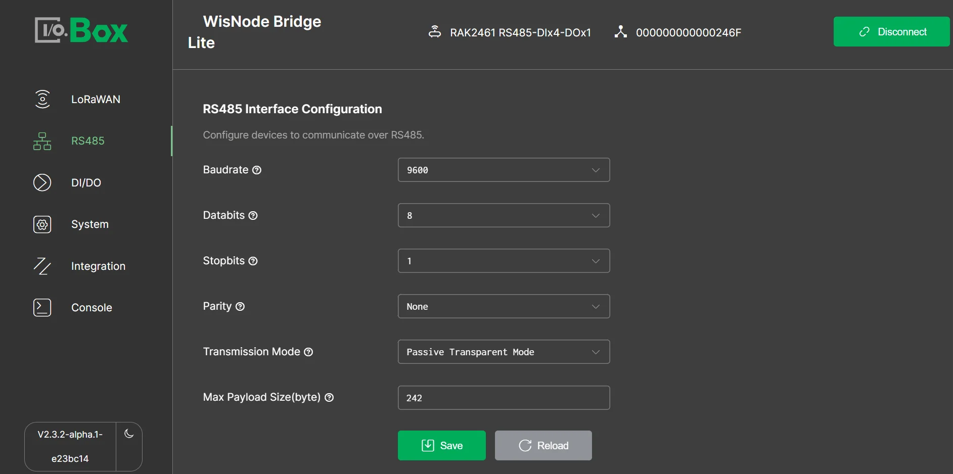

- Set Transmission Mode to Passive Transparent Mode.
Figure 1: Passive TransparentNOTEThe Max Payload Size is determined automatically according to the configured LoRaWAN region and DataRate.
