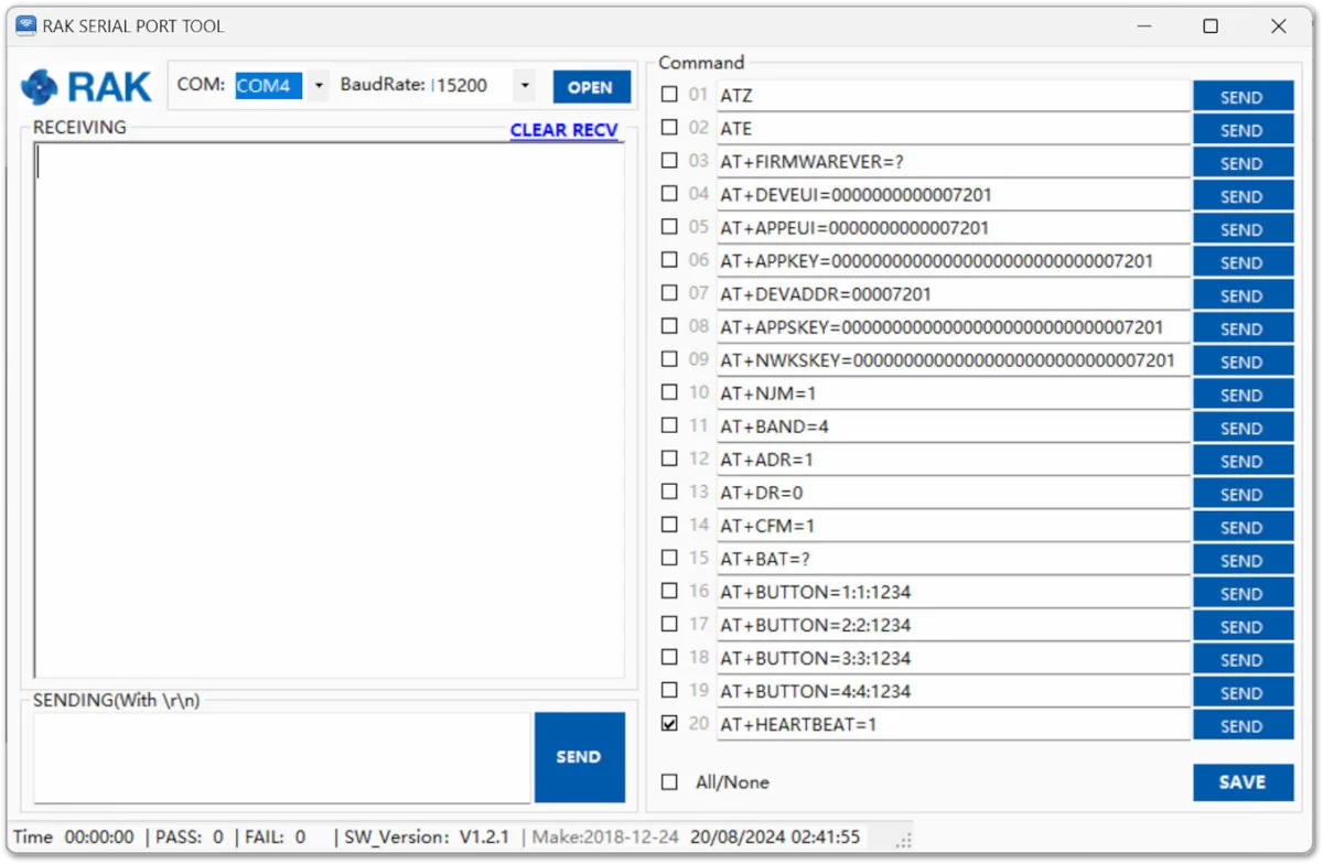

For you to be able to interface with the RAK7201V2 WisNode Button 4K with your Windows machine, you need to download the RAK Serial Port Tool.
- Connect your RAK7201V2 WisNode Button 4K to your Windows machine using the provided Micro USB cable.
Figure 1: RAK7201V2 WisNode Button 4k to laptop connection- Open the RAK Serial Port Tool.

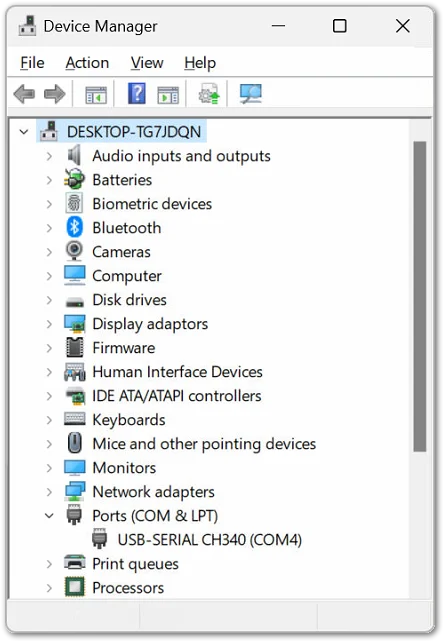

Figure 1: RAK Serial Port Tool- To choose the correct COM Port number for your device, go to your Device Manager by pressing the Windows key + R and type devmgmt.msc. You can also search for the Device Manager in the Start menu.
- Once opened, look for Ports (COM & LPT) and find the name USB-SERIAL CH340. The COM Port Number differs, and in this guide, it is COM4.

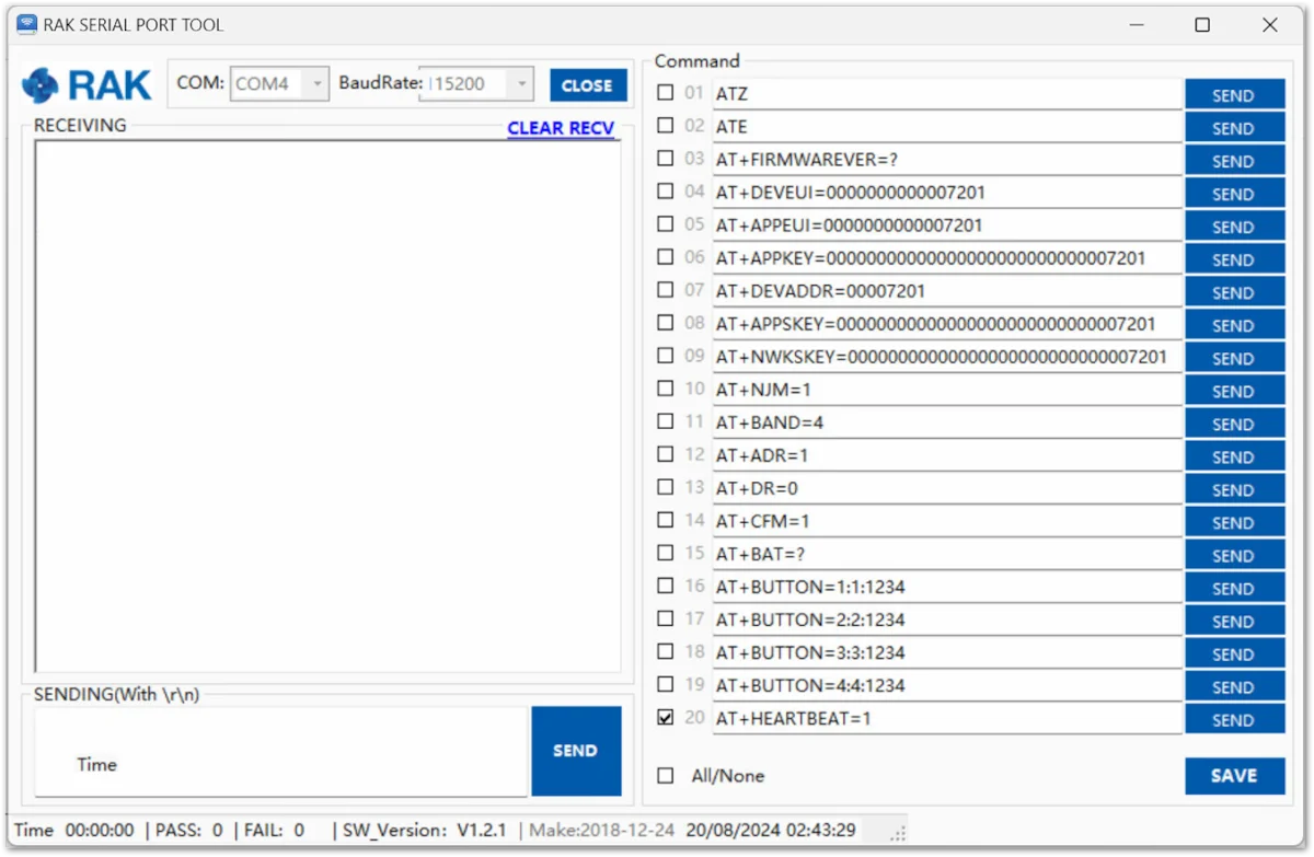

Figure 1: Device Manager- Choose the correct COM port number from the device manager and the correct baud rate, then click Open. The default baud rate of the WisNode Button 4K is 115200 bps.

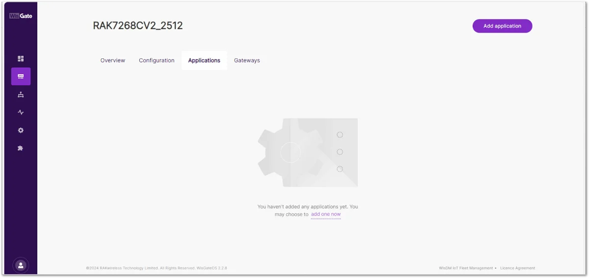

- Login into the gateway via the Web UI and select the Application tab in the LoRa menu.

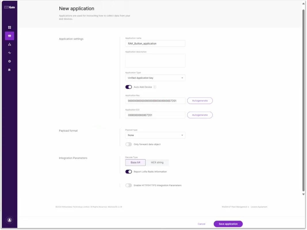

Figure 1: Application menu in the web UI of the gateway- Click the Add application button and fill out the Application name. Select Unified Application key as Application Type and use the Autogenerate button to generate an Application Key and Application EUI.

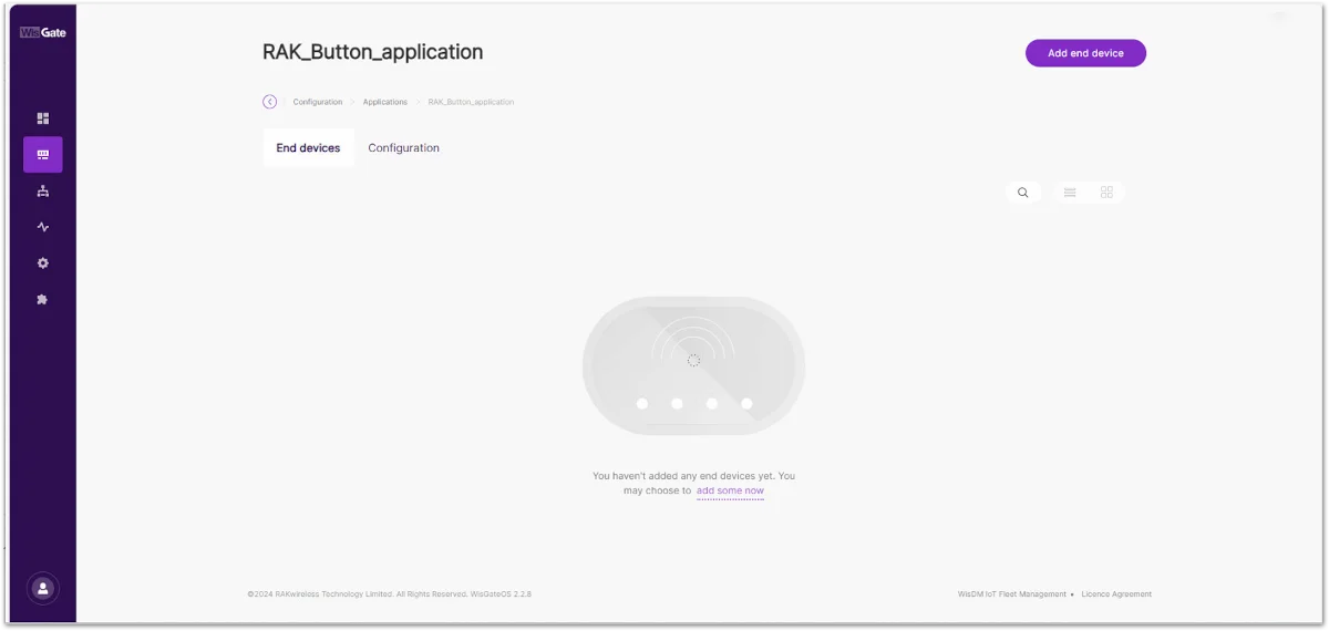

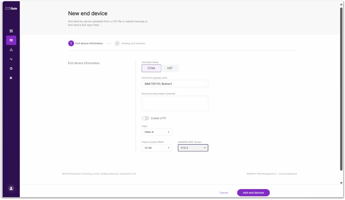

- In the created application, click on the End device tab and then the Add end device button.
Figure 1: Application edit- Fill out the End device name and the LoRaWAN MAC Version (V1.0.3 is the correct one for RAK7201V2). Click on the Add end devices.

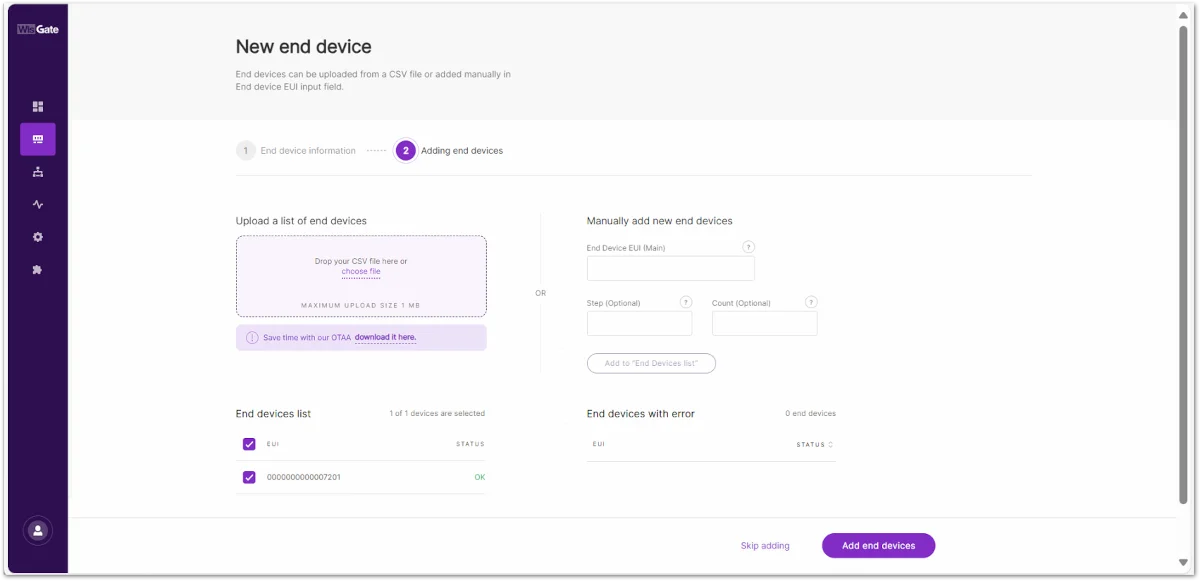

Figure 1: Adding the device- Input the End Device EUI of your device and then click Add to "End Devices list".

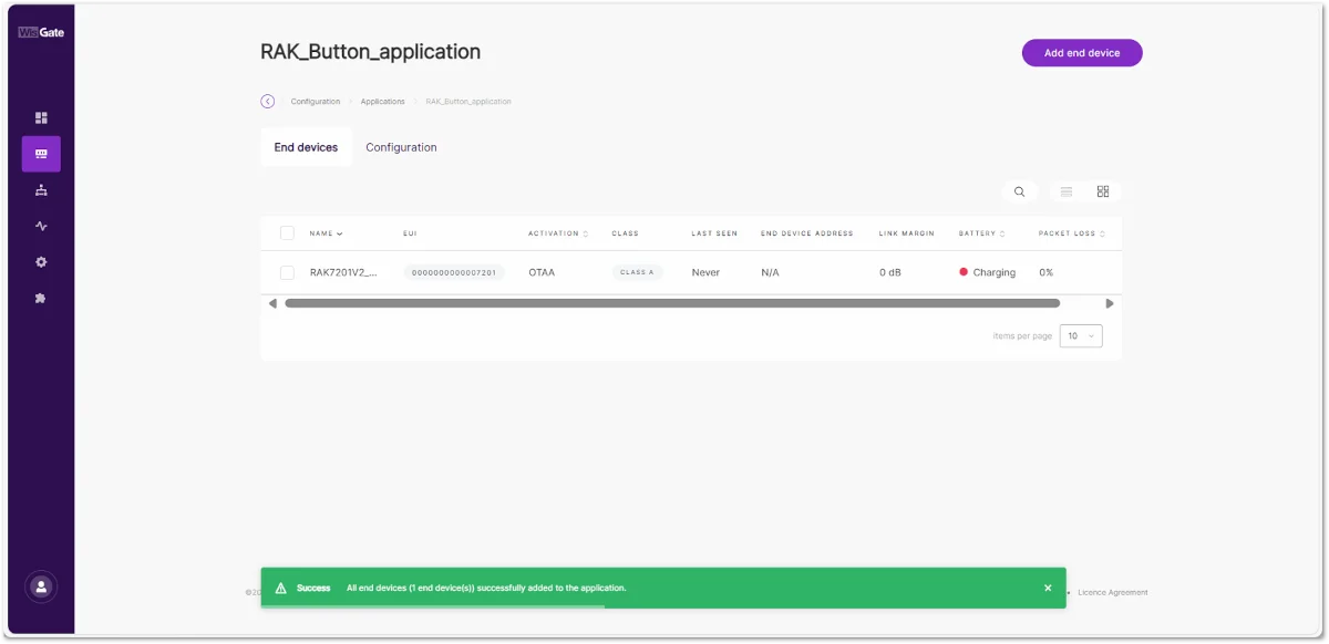

Figure 1: Configuring the device's setings- You will see the device in the End devices list and the Add end devices button will allow you to register your end device in the application.
Figure 1: The device is registeredConfiguring the Button in OTAA Mode

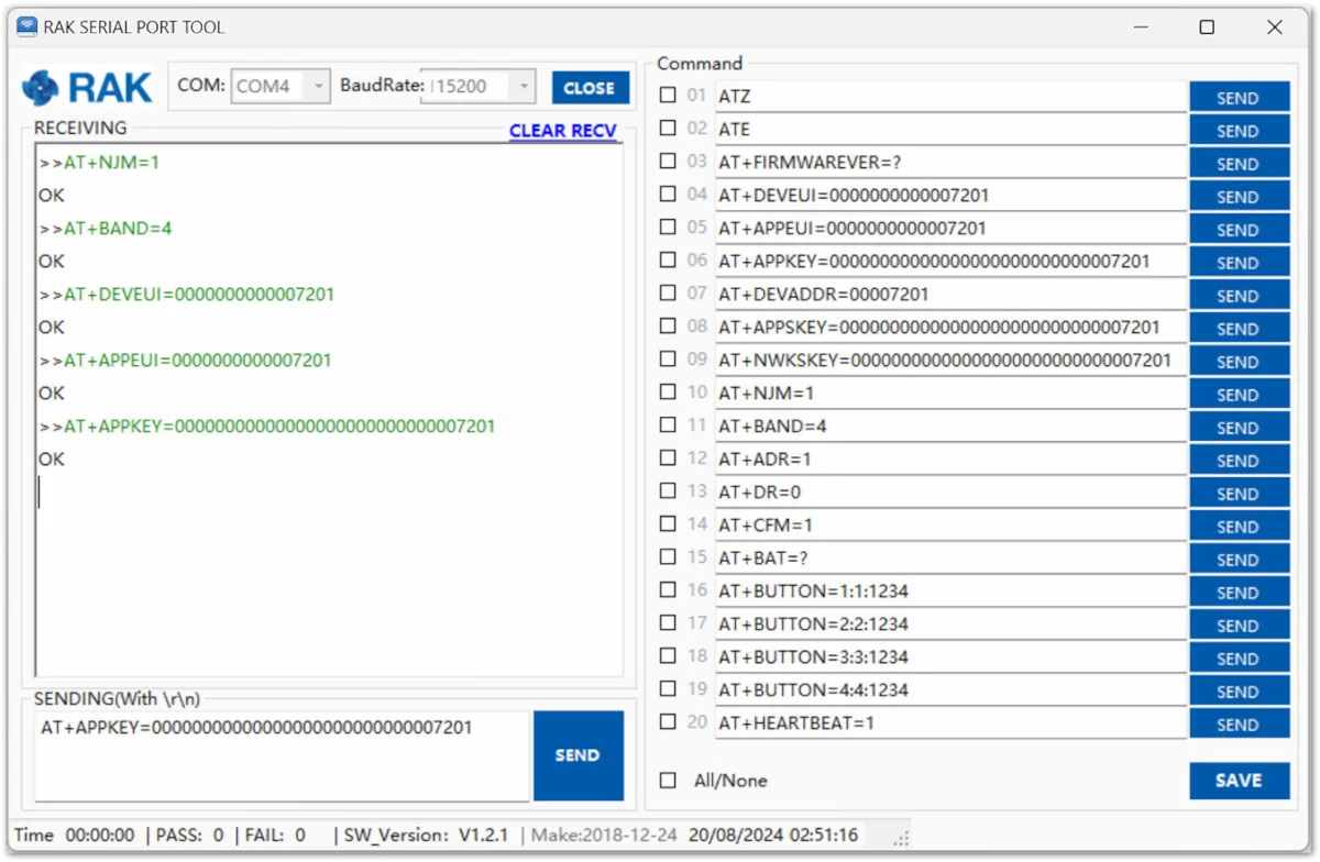

- To manage to connect the Button to the Built-In Server in the gateway, a configuration with the correct parameters is needed. Using the AT commands and the RAK Serial Port Tool, the following parameters must be set:
- Join Mode (OTAA)
AT+NJM=1
- Region (EU868 for this example)
AT+BAND=2
- Device EUI (on the sticker at the back of the device)
AT+DEVEUI=ac1f09fffexxxxxx
- Application EUI (from the application configuration created previously in the gateway)
AT+APPEUI=bf3112d69fxxxxxx
- Application Key (from the application configuration created previously in the gateway)
AT+APPKEY=ea980d6f2e42772550c66ec265xxxxxx

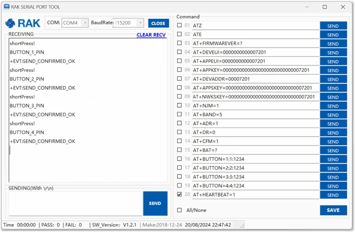

Figure 1: Configuring RAK7201V2 in OTAA modeThe Keys and EUIs shown here are just examples, use the ones generated by your system or corresponding to your device.

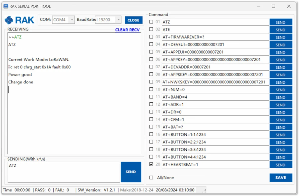

- To connect to the LoRaWAN Network after the configuration, the device must be restarted. The restart command is as follows:
ATZ

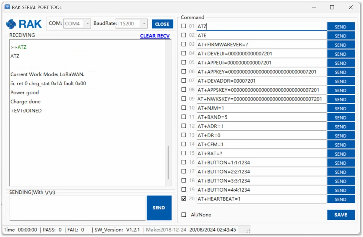

- After the restart, you need to issue
AT+JOINto join the LoRaWAN network. If all the settings are configured correctly, an+EVT:JOINEDmessage will be displayed in the RAK Serial Port Tool.

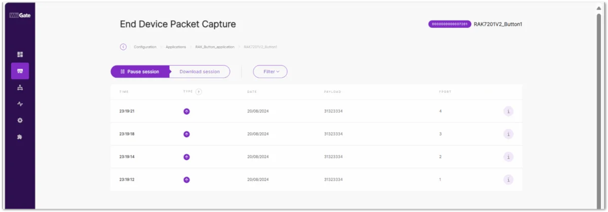

Figure 1: The device has restarted and connected to the LoRaWAN Network- After the successful connection, the data obtained from pressing the buttons will be transmitted to the application server of the gateway.
Figure 1: Successful operation of the buttons- The received data from RAK7201V2 can be seen in the web UI of the gateway under Application > Device > Live Device Data.

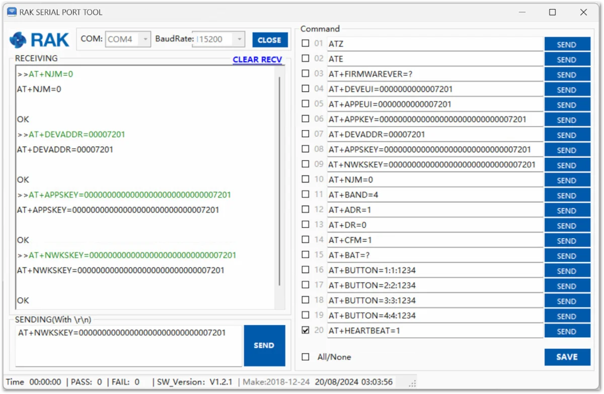

Figure 1: Changing the activation method- To set the RAK7201V2 in ABP work mode, the following AT commands must be executed in the RAK Serial Port Tool:
- Join mode (ABP)
AT+NJM=0
- Device Address (from the device configuration created previously in the gateway)
AT+DEVADDR=00000001
- Application Session Key (from the device configuration created previously in the gateway)
AT+APPSKEY=bfb959106b004e5a32d8dde9fexxxxxx
- Network Session Key (from the device configuration created previously in the gateway)
AT+NWKSKEY=0a8139122e9e9011c049bcc575xxxxxx
Figure 1: Configure the RAK7201V2 in ABP modeThe Keys and EUIs shown are just examples. Use the ones generated by your system or corresponding to your device.
ATZ
- After the restart, the device will be ready to send the information through the LoRaWAN Network.

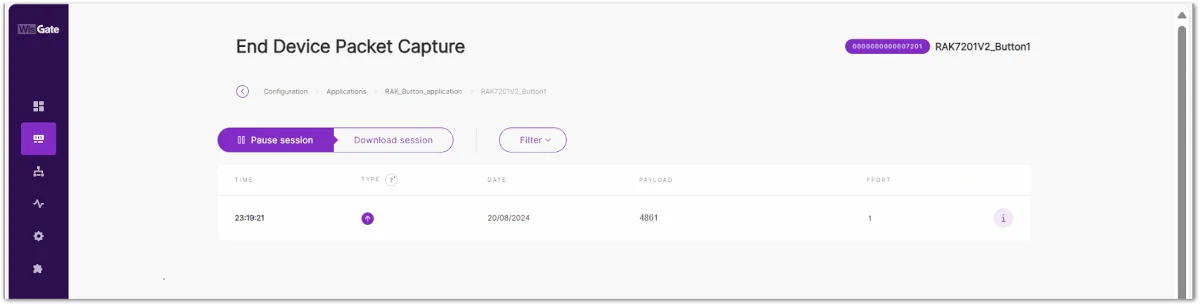

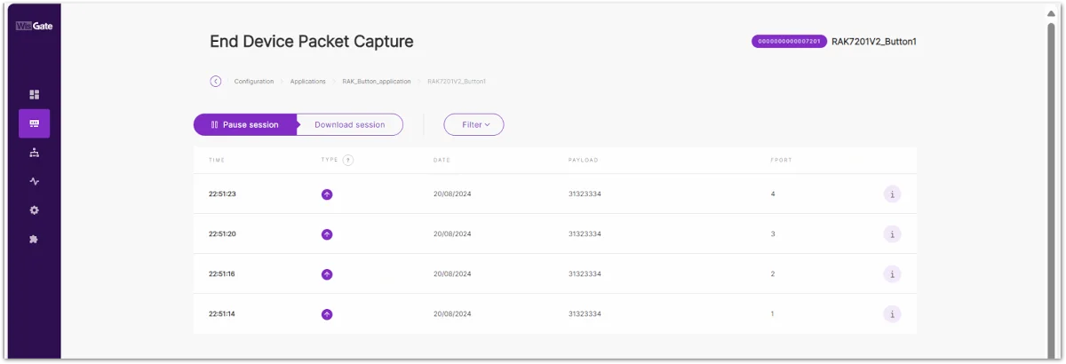

Figure 1: Configure the RAK7201V2 in ABP modeThere is no Join procedure in ABP mode. To be sure that the Button can send data, you need to press the buttons and see if you have uplinks in the Live Device Data field of the device in the gateway.
- To test the ABP mode, press the buttons of the device.
Figure 1: Testing the ABP mode- The received data from RAK7201V2 can be seen in the web UI of the gateway under Application > Device > Live Device Data.
Figure 1: Received dataCustomize the Data Sent

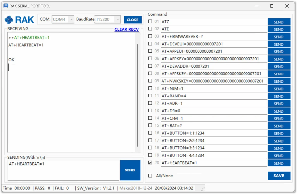

The device can send a HeartBeat packet according to the configured HeartBeat interval. The AT command for configuring the HeartBeat interval is as follows:
AT+HEARTBEAT=<interval>
Where:
- The interval range is 0-120 (in hours), 0 to turn off the function.
Example:
Set the HeartBeat to one hour using the command:
AT+HEARTBEAT=1
