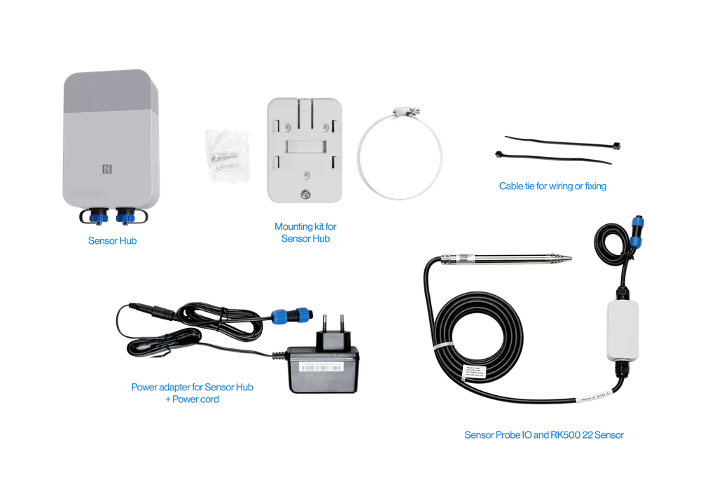

Figure 1: Soil pH Solution Package InclusionHardware Tools
- Soil pH Monitoring Solution
- Solar Battery Lite for Sensor Hub (optional)
- Additional accessories: Probe Cable, Probe Splitter, power supply, and others (quantities and types may vary depending on use case)
- An Android or iOS mobile device with Bluetooth and NFC

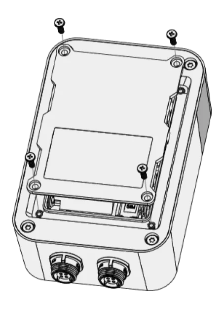

SIM Card Installation
If you're using NB-IoT/LTE CAT-M, follow these steps to insert a SIM card. If you opt for the LoRaWAN wireless communication mode, skip this section, as a SIM card is not required.
- Remove the back cover by unscrewing the four (4) screws with a cross screwdriver.
Figure 1: Remove the back cover- Insert the SIM card into the groove, then gently push it into the card slot.

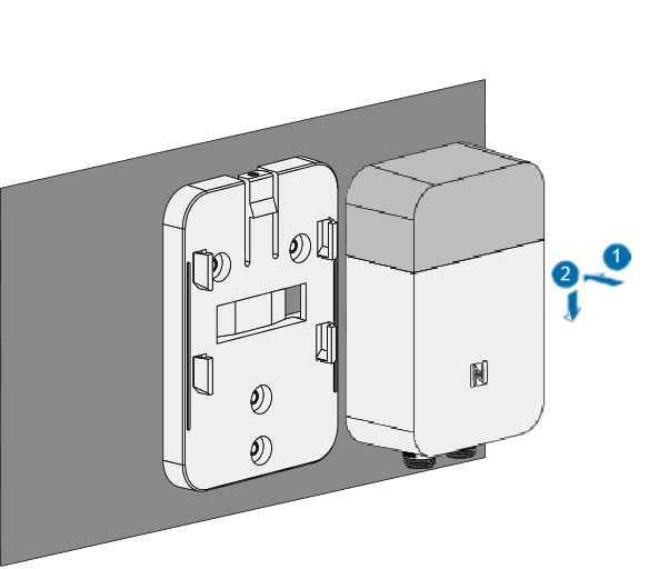

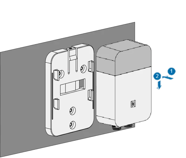

Wall Mounting
- Drill holes using a 5 mm in the wall, then insert the screw anchors into the holes.
- Secure the mounting bracket to the wall by using self-tapping screws.
- Align the device's hanging tab with the slots on the bracket, and then insert the tab into the slots. Pull the device downwards until it snaps into place.
Figure 1: Align the device with the hanging tabsPole Mounting

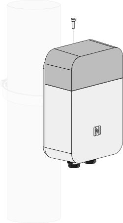

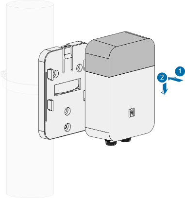

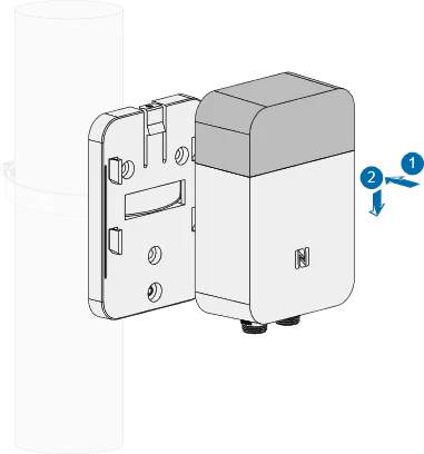

- Secure the mounting bracket to the pole using a steel strap.
Mount the bracket on a pole with a 50-80 mm diameter. For larger poles, use a bigger steel strap. The standard kit does not include a larger steel strap. Purchase separately if needed.
- Align the hanging tab of the device with the slots on the bracket, then insert the tab into the slots. Gently pull the device downwards until it securely snaps in place.
Figure 1: Device installation- Insert a security screw at the top to fasten the device and the bracket together.

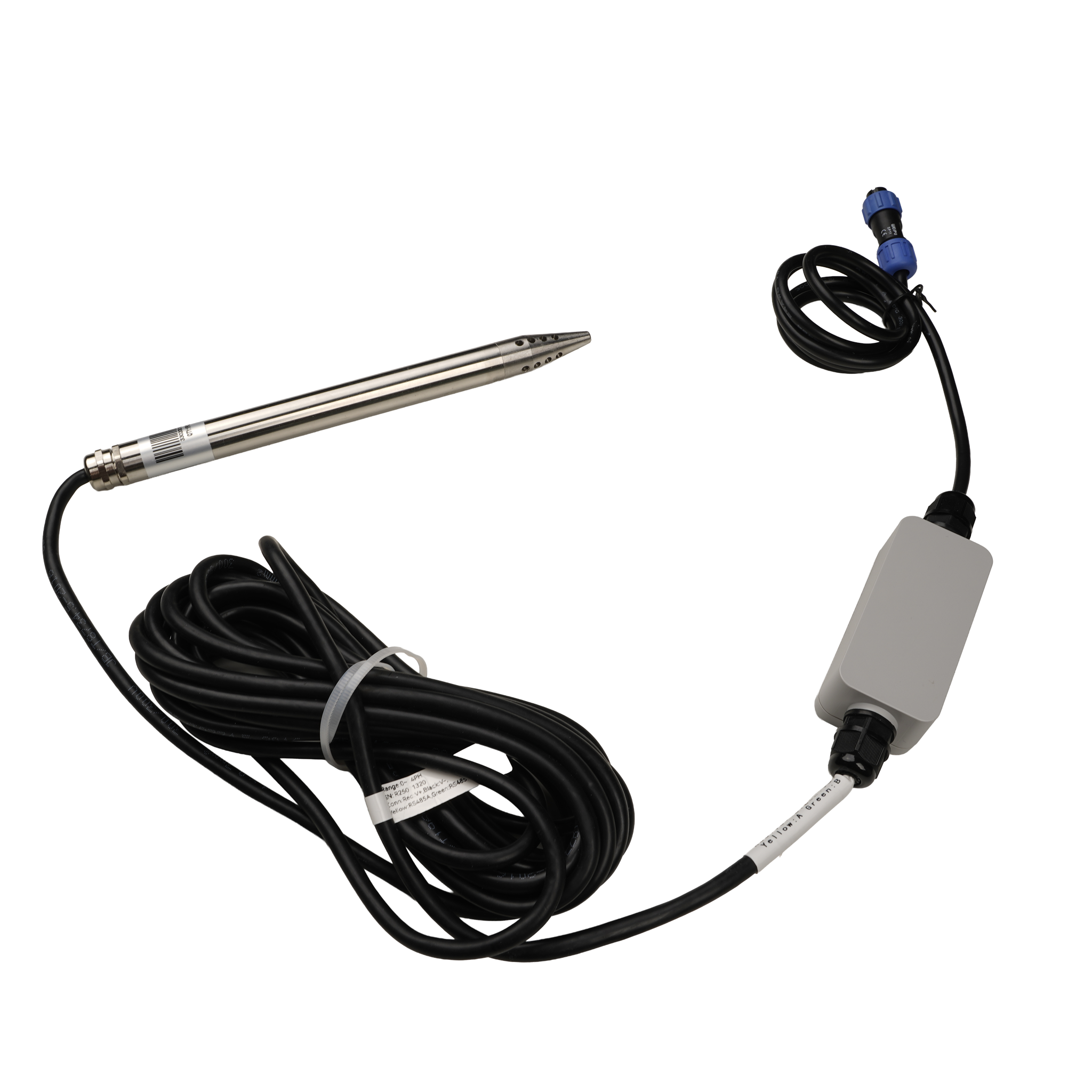

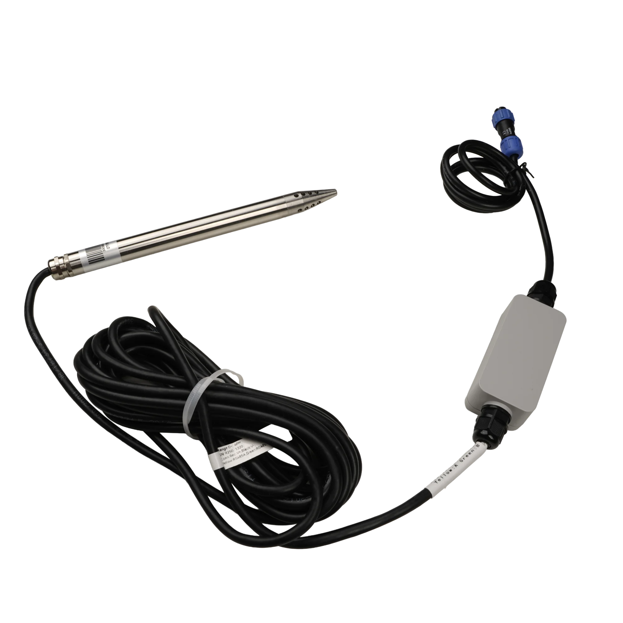

Sensor Probe IO + Soil pH Sensor Installation
The soil pH sensor comes pre-assembled with the Sensor Probe IO by default at the factory. Therefore, no extra assembly is needed.

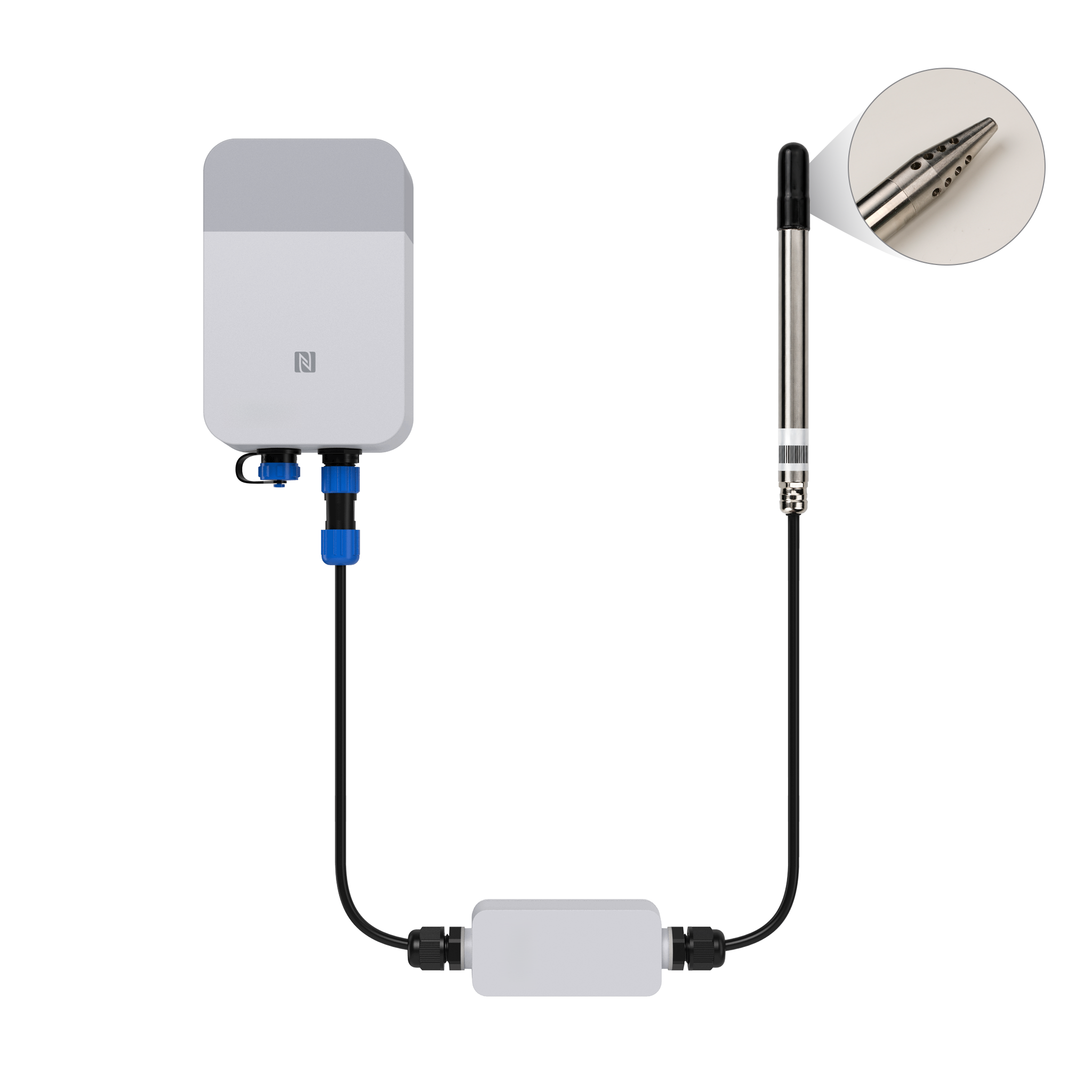

Figure 1: Soil pH SensorSensor Hub + Sensor Probe IO + Soil pH Sensor Installation
- Connect the Sensor Probe IO to the Sensor Hub using the SP11 connector.
- Align the white dot mark on the Sensor Probe IO SP11 connector plug with the white dot mark on the Sensor Hub SP11 connector socket, and push the plug firmly into the socket.
- Once connected, tighten the locking nut to secure the SP11 connector. The Sensor Probe IO can be linked to any Sensor Hub SP11 connector port. Refer to your use case and connect to the appropriate port as shown in Figure 11.
Figure 1: Connect the Sensor Probe IO
Figure 1: Installation completePower Supply Setup

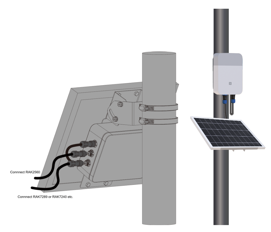

RAK9154 Solar Battery Installation
- Secure the mounting bracket on the pole with two steel straps.
- Attach the mounting plate to the RAK9154 with two (2) M3 screws.
- Install the RAK9154 to the back of the solar panel with four (4) screws and nuts.
- Connect the cable of the solar panel to the PV input connector of RAK9154. Install two (2) M6 screws into the mounting plate with a clearance of about 3 mm.
- Suspend the solar panel on the mounting bracket, adjust its angle and direction, and then tighten the two (2) M6 screws along with the remaining two (2) screws.
- Connect the Sensor Hub to the RAK9154. Use a cable to link the remaining connection port of the Sensor Hub to the lithium battery Output 1 SP11 connection port of RAK9154.
When connecting to the RAK9154, ensure that the Sensor Hub is connected to the Output 1 connection port.
Figure 1: Connect the Sensor Hub and RAK9154- Once the connection is complete, the Sensor Hub is ready to be powered up.
