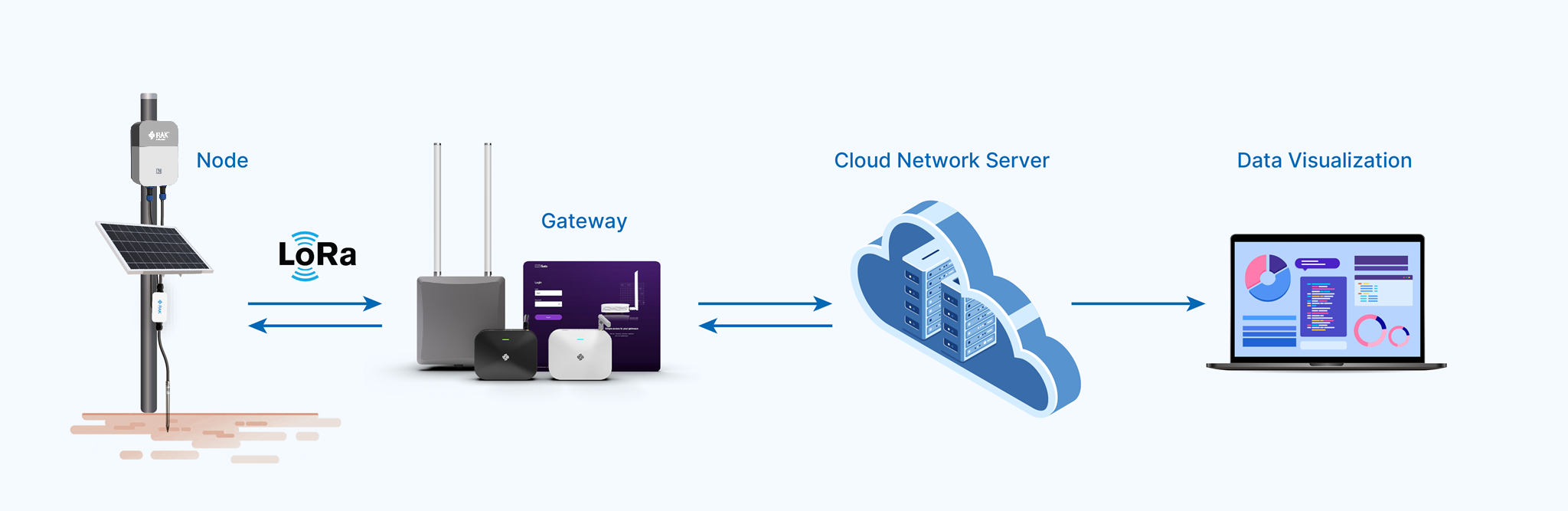

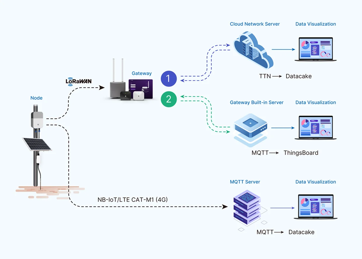

This section outlines the operational steps for connecting the device to the network server in both the LoRaWAN and NB-IoT application scenarios.
Figure 1: Application ScenariosLoRaWAN Application
Cloud Network Server Setup
The cloud network server deployment scenario involves connecting the gateway and devices to third-party cloud network servers. This server integrates visualization applications to manage real-time soil pH data.
This section provides instructions on creating a Datacake visualization application using the TTNv3 cloud network server.
Figure 1: Cloud network server deployment solutionConnect Gateway to TTN
For this example, you will use the TTNv3 cloud server and RAK7289 V2 WisGate Edge Lite 2 to demonstrate how to connect the RAK business gateway to a cloud server.

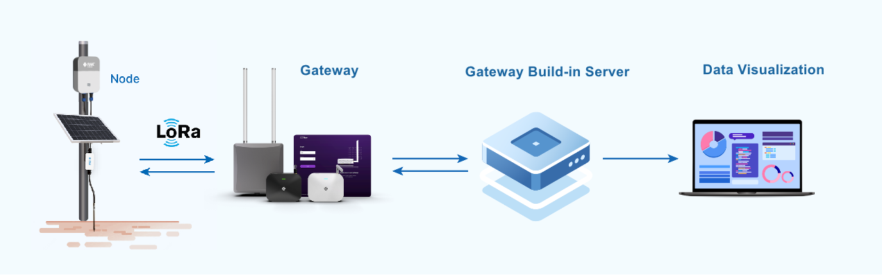

Built-In Network Server Setup
The RAK gateway comes with a built-in NS, which eliminates the need to deploy NS in the cloud or locally. This gateway is suitable for small-sized industrial application scenarios and offers various advantages such as cost savings, reduced R&D investment, high performance and low latency.
The built-in network server of the RAK gateway provides MQTT and HTTP integration that allows for post-processing data and implementing solutions based on the needs.
This section will use the public MQTT broker integration as an example to demonstrate how to use the built-in network server to create a visualization application on ThingsBoard.
Figure 1: Gateway built-in NS application scenarioConfigure the ThingsBoard

Connect the Sensor Hub to the Built-In Network Server
For specific configuration on how to connect SensorHub to the server, refer to SensorHub Network Configuration > LoRaWAN Application Scenario.
Once completed, the device will join the network. As shown in Figure 69, the end device SensorHub has successfully connected to the gateway's built-in server.
Configure the MQTT Integration
- Go to the LoRa > Configuration > Integration Interface Parameters section.
- Toggle the Enable Integration Interface option and select Generic MQTT as the Integration mode.
- In the MQTT Broker Address option, enter
broker.hivemq.comthen click Save changes. - After the device has joined and has been sending uplink data, check the uplink data in ThingsBoard > Integrations > Your Integration > Events.
Visualize Data Through ThingsBoard
- After creating the data converter, integrating, and obtaining some data in the Event tab, check the automatically created devices based on the decoder in the Entities > Devices > Groups tab.
- Click the group named All in the Device groups menu to automatically create a decoder device.
- Click the device and go to the Attributes tab, where you will see the node data.
- To visualize the data, simply select the values you wish to display, then click the Show on widget button.
- On the next page, select the desired widget for the data from the Current bundle drop-down menu. In this example, select Analog gauges as it has a humidity widget.
- After selecting the widget, click Add to dashboard to proceed.
- The Add widget to dashboard window will appear. By default, there is no dashboard in the profile, so you need to select Create new dashboard and enter a name for the dashboard in the new dashboard title field.
- In this guide, name the dashboard SensorHub_soil_pH.
- After setting the dashboard name, click the Add button to add more widgets. Alternatively, check the Open dashboard option to automatically open the created dashboard after adding the widget.
If the Open dashboard option is not selected, you can still easily view the added widgets via Dashboard groups > All > [Group Name].

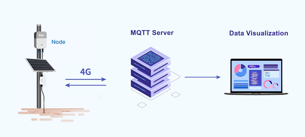

NB-IoT/LTE CAT-M1 Application
Connect Sensor Hub to MQTT Server
In the Network Server and Visualization Configuration section, the server has been set as a public MQTT broker: broker.hivemq.com. You can also choose other brokers or servers, such as AWS IoT Core (optional), according to the actual usage scenario.
Figure 1: NB-IoT/LTE CAT-M1 application scenarioVisualize Data Through Datacake
In this example, you will use Datacake as the visualization platform. Datacake is a versatile IoT platform designed to visualize data from nodes in a user-friendly manner.
