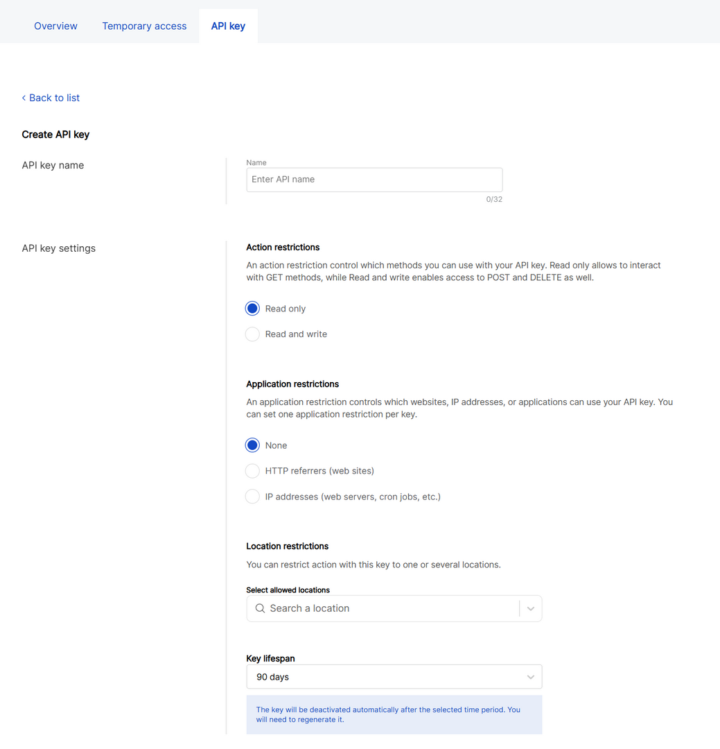

Create Your API Key
- From the left menu, navigate to Settings > API Key.
Figure 1: API overview- Click Create API Key in the top-right corner.
- Enter a name for the new key.
- Configure the key settings:
Figure 1: Configure the key-

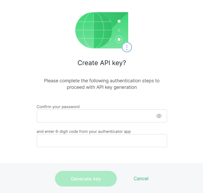

After configuring the settings, click Generate key.
Enter your WisDM account password and the 6-digit verification code (if enabled) from your authenticator app. Then, click Generate key again to confirm.

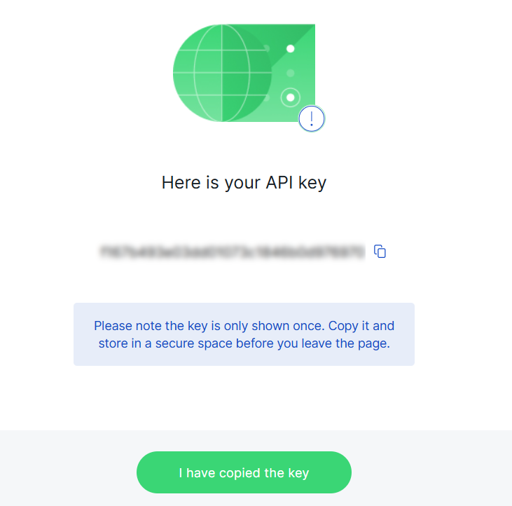

Figure 1: Confirm API key creation- Once generated, a pop-up window will display your new API key.
Figure 1: Copy and securely store your API keyThe API key is displayed only once. Copy and store it securely before leaving the page. Lost keys cannot be retrieved and must be regenerated.

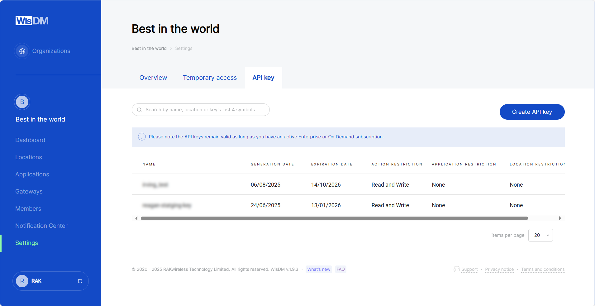

Manage API Keys

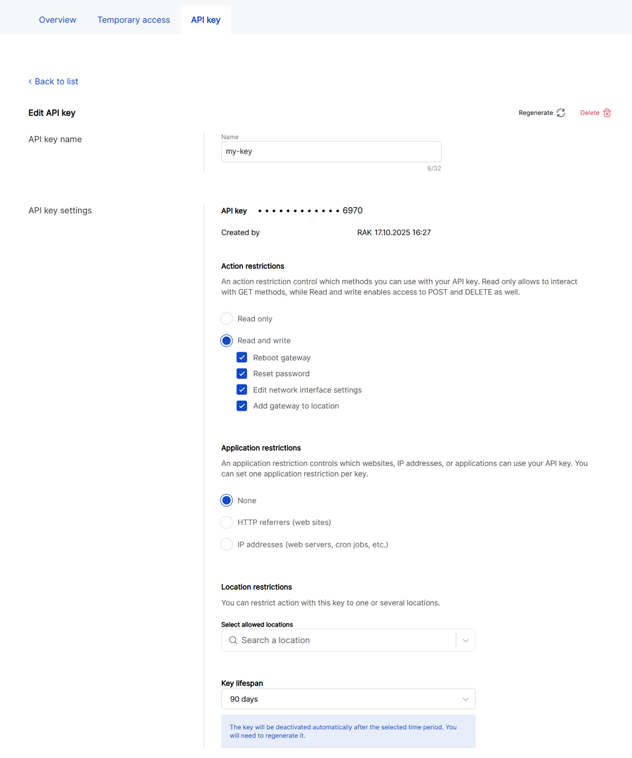

Once an API key has been created, you can view and manage it on the Settings > API Key page. Each key can be edited, regenerated, or deleted.
Edit an API Key
- From the key list, select the API key you want to modify.
- Update the name or modify permission settings as needed.
Figure 1: Update your API key- Click Save changes to apply updates.

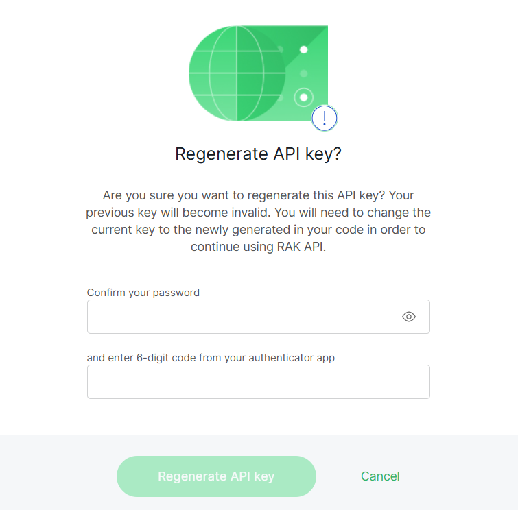

Regenerate a Key
Regenerate your API key when it expires or if you suspect it has been compromised. The new key will replace the old one while retaining all previous configurations.
Click the Regenerate icon
in the top-right corner, enter your credentials, and then click Regenerate API key to confirm.

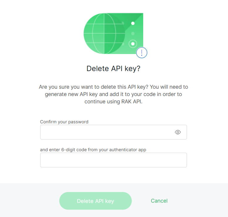

Figure 1: Regenerate a KeyDelete a Key
Delete an API key when it is no longer needed or has been replaced by a new one. Once deleted, all systems using this key will immediately lose API access.
Click the Delete icon
in the top-right corner. Confirm your action, and then click Delete API Key to permanently remove it.
Figure 1: Delete a KeyDeleting a key cannot be undone. Any integration using this key will immediately lose access to the WisDM API.
