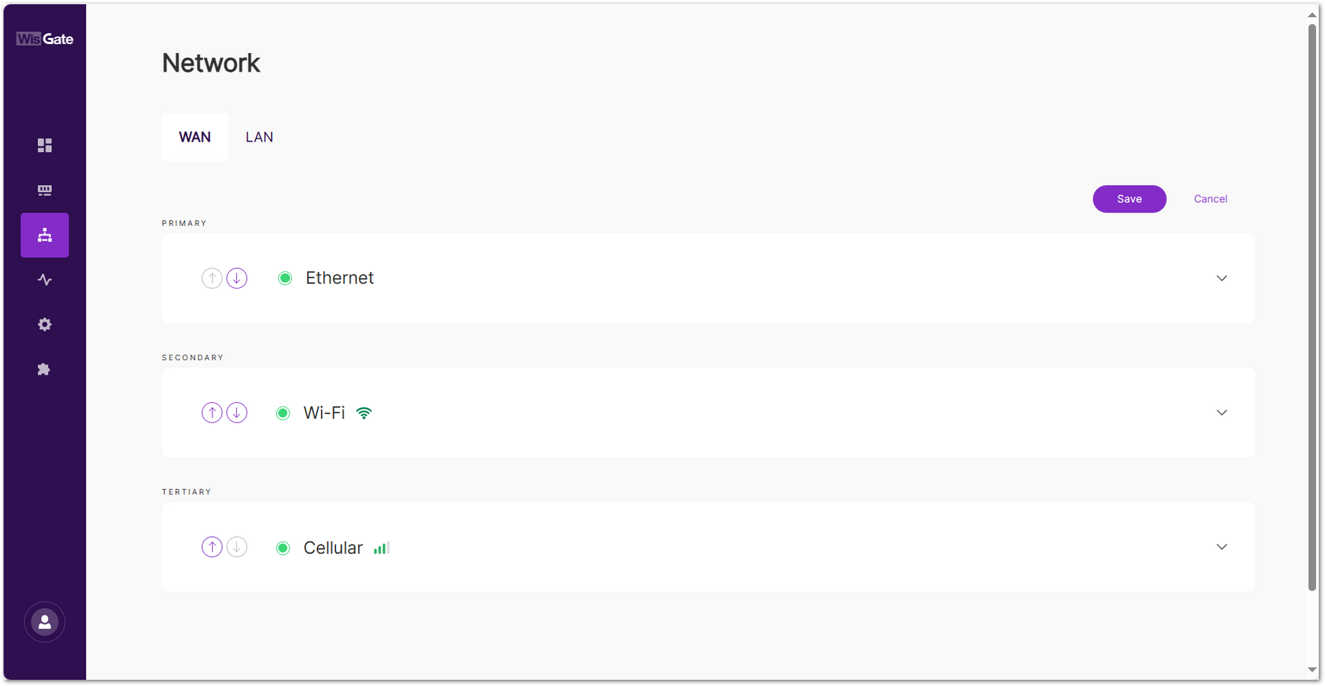

In the WAN menu, you can configure each network interface on the gateway and manage the priority among multiple WAN connections. The status of each interface is indicated by a red/green light next to the interface name, showing whether the interface is available or not.
The list of WAN interfaces displayed may vary depending on your gateway’s hardware specifications.
Figure 1: WAN tabChange Priority
In a Multi-Network setup, managing WAN interface priorities ensures that the gateway seamlessly switches between available networks based on their priority, enabling continuous connectivity even in the event of network failures.
You can adjust the priority of each WAN interface to control the preferred network connection. Follow the steps below to modify the interface priority:
- Click the Change Priority button.
- Use the arrows (
) next to each interface name to change its priority.
Figure 1: Editing WAN interface priority- The upward arrow increases the priority, making that network the preferred one.
- The downward arrow decreases the priority, making it a secondary or backup network.
- Click Save.

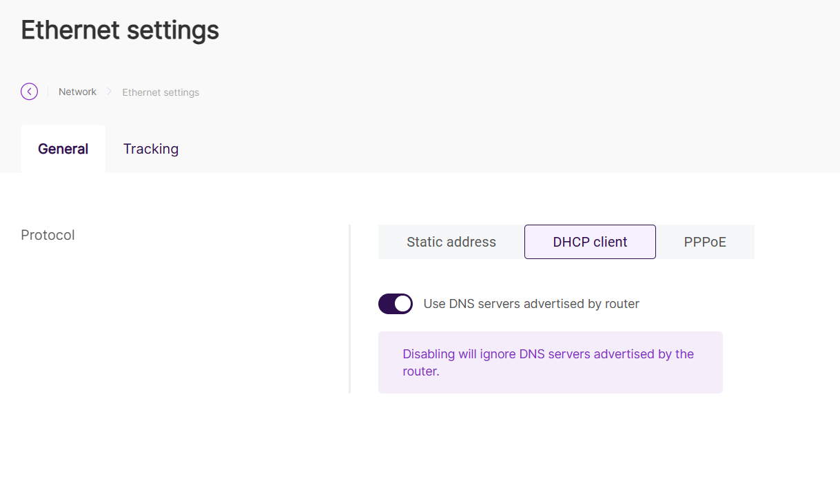

Configure basic Ethernet settings, including static IP, DHCP, and PPPoE.
Figure 1: Ethernet settings General tab- Static address: Configure a static address for the gateway.
- IPv4 Address: The static IPv4 address for the gateway.
- IPv4 Netmask: The netmask for the gateway.
- IPv4 Router: The IPv4 router address.
- DNS Server: Custom DNS server address.
- DHCP client: Use the router's DHCP server to assign an IP address.
- Use DNS servers advertised by router: Enable this to assign DNS from the router.
- DNS Server: Add custom DNS addresses.
- PPPoE: Set Point-to-Point Protocol over Ethernet (PPPoE), with PAP/CHAP Username and Password provided by the internet provider.

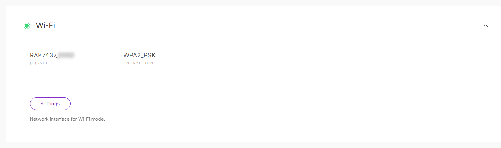

Wi-Fi
Expand the interface details by clicking on the interface name or the arrow to the left of it (
Figure 1: Wi-FiInterface Information
Displays information about the connected Wi-Fi interface.
- Protocol Type: Specifies the protocol type.
- IP Address: The IP address assigned to the gateway.
- Netmask: The netmask assigned to the gateway.
- Connection time: The duration the gateway has been connected to the Wi-Fi interface.
- Channel: The operating frequency used by the Wi-Fi network.
- (E)SSID: The SSID of the Wi-Fi network.
- BSSID: The MAC address of the Wi-Fi access point or router.
- Bitrate: The bitrate of the Wi-Fi network.
- DNS: DNS server addresses.

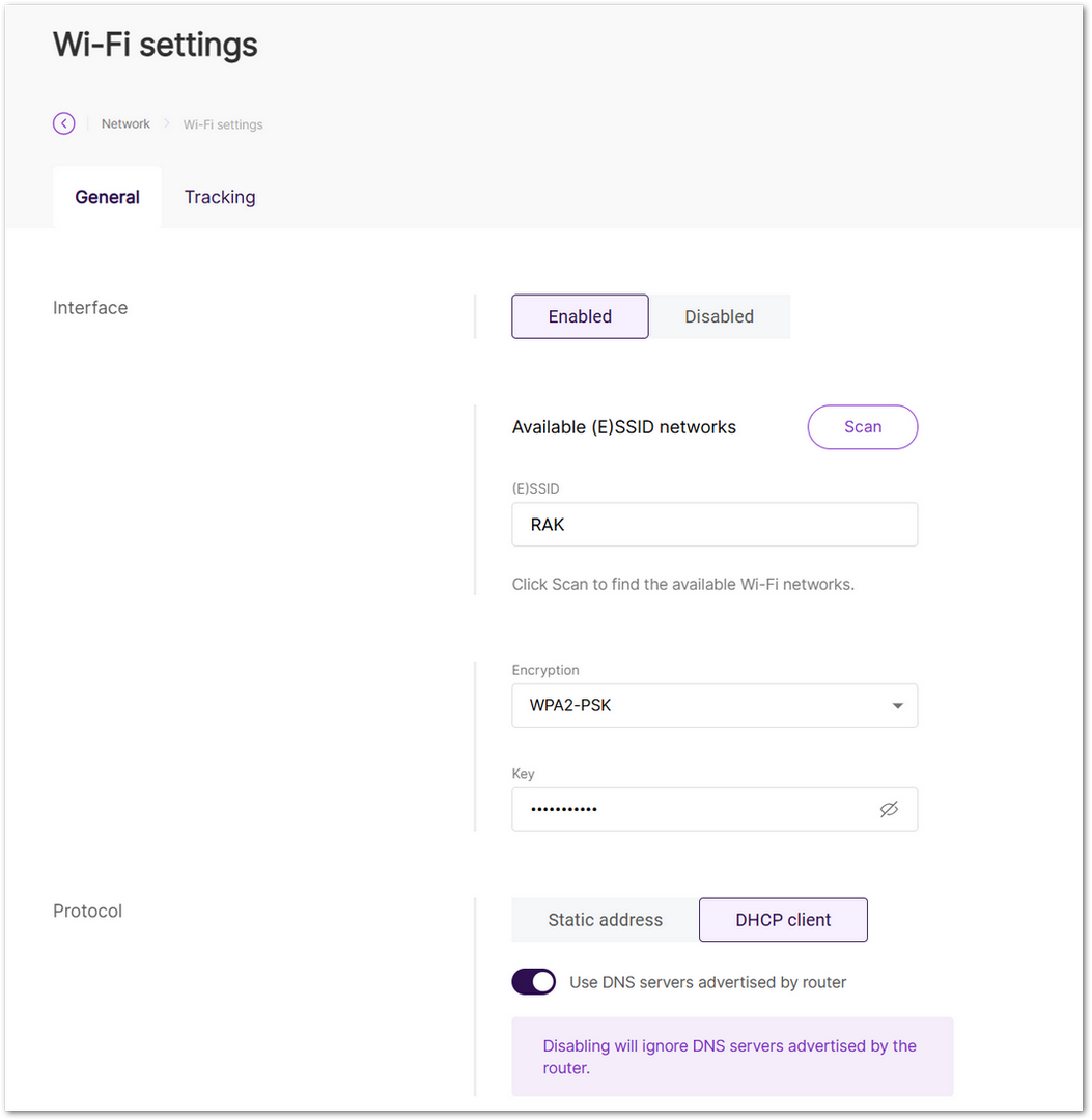

General
Set up Wi-Fi interface configuration, including addressing, SSID, security, and related network options.
Figure 1: Wi-Fi settings General tab- Enabled/Disabled: Enable or disable the Wi-Fi interface.
- Available (E)SSID networks: Scan for available Wi-Fi networks and select one, or manually enter the details.
- (E)SSID: Extended Service Set Identifier.
- Encryption: Select the type of encryption used by the network and enter the password. Options include No Encryption, WPA-PSK, WPA2-PSK, and WPA-PSK/WPA2-PSK Mixed Mode (recommended).
- IPv4 Address: The desired static IPv4 address.
- IPv4 Netmask: The netmask.
- DNS Server: Custom DNS address.
- DHCP client: Use the router's DHCP server to assign an IP.
- Use DNS servers advertised by router: Enable to assign DNS from the router or specify a custom DNS.

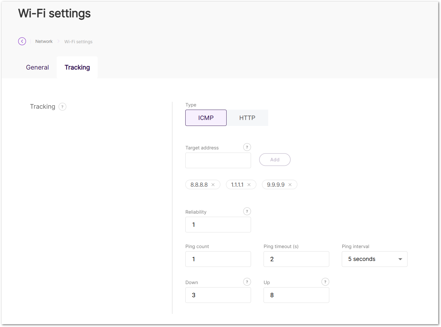

Tracking
Monitor the health of the Wi-Fi interface by performing periodic ping tests. If the interface becomes unstable (fails too many pings), it will failover to another interface.
- Type: Select the method for link tracking.
- ICMP: Sends ping packets to test connectivity at the IP level.
- HTTP: Sends HTTP GET requests to confirm service availability at the application level.
- Target address
- For ICMP: Supports IP addresses and domain names.
- For HTTP: Supports domain names, full URLs, or IP addresses.
- The Target address supports a single input of up to 100 characters.
- Reliability: Define the minimum number of IP addresses that need to respond to confirm a successful ping.
- Ping count: The number of pings to send.
- Ping timeout (s): The time allowed for each ping.
- Ping interval: The interval between pings.
- Down: The number of consecutive ping failures required to confirm that the interface is down.
- Up: The number of consecutive ping successes required to confirm that the interface is up.

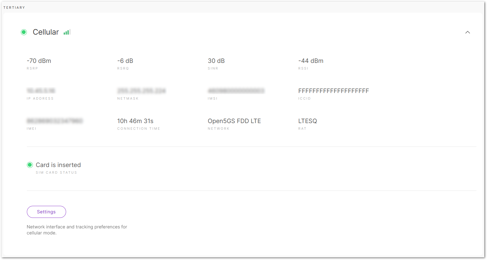

Cellular
Figure 1: CellularInterface Information
Displays information for the connected cellular interface.
- RSRP: Reference Signal Received Power. Indicates the strength of the received LTE reference signal.
- RSRQ: Reference Signal Received Quality. Reflects signal quality by considering interference and signal strength.
- SINR: Signal-to-Interference-and-Noise Ratio. Measures signal quality relative to background noise.
- RSSI: Received Signal Strength Indicator. Represents the total received signal power, including interference and noise.
- IP Address: The IP assigned to the gateway.
- IMSI: International Mobile Subscriber Identity.
- ICCID: Integrated Circuit Card Identifier.
- IMEI: International Mobile Equipment Identity.
- Connection time: The duration the gateway has been connected to the interface.
- Network: The cellular network standard.
- RAT: Radio Access Technology. Indicates the wireless technology in use.
- SIM Card Status: The status of the SIM card.

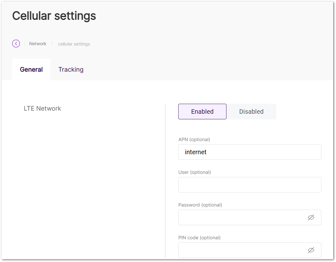

General
The purpose of the General settings is to configure the cellular connection (APN, username, password, PIN) to ensure the gateway can properly connect to the cellular network.
Figure 1: Cellular settings General tab- Enabled/Disabled: Enable or disable the cellular interface.
- APN (optional): The Access Point Name for the connection.
- User (optional): Username for authentication (leave empty if not required).
- Password (optional): Password for authentication (leave empty if not required).
- PIN code (optional): The SIM card's PIN code (leave empty if not required).

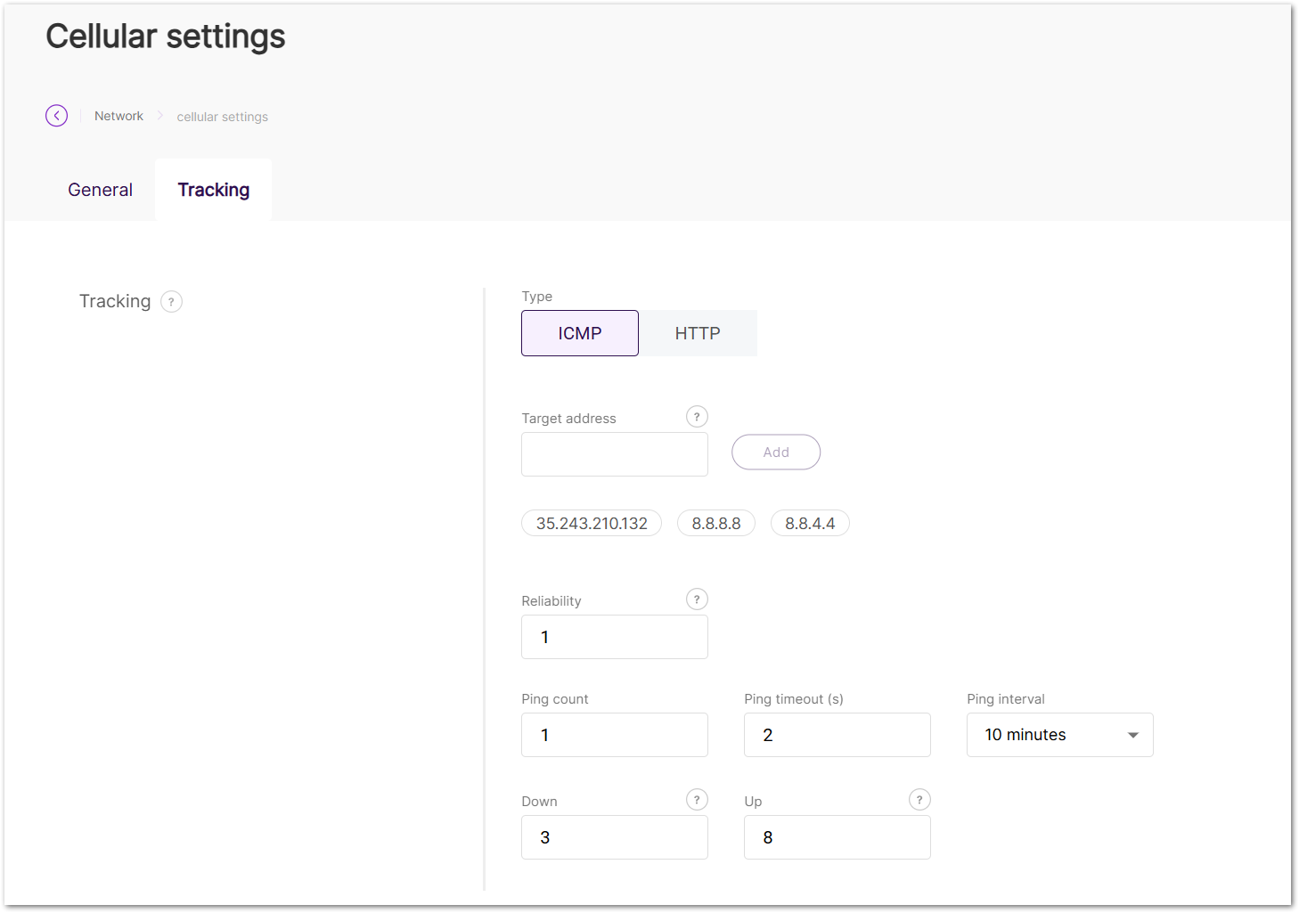

Tracking
The Tracking settings ensure the gateway maintains stable connectivity by regularly testing the cellular network. If the network becomes unreliable (fails pings consecutively), the gateway will automatically switch to another available interface, ensuring continuous service.
- Target address

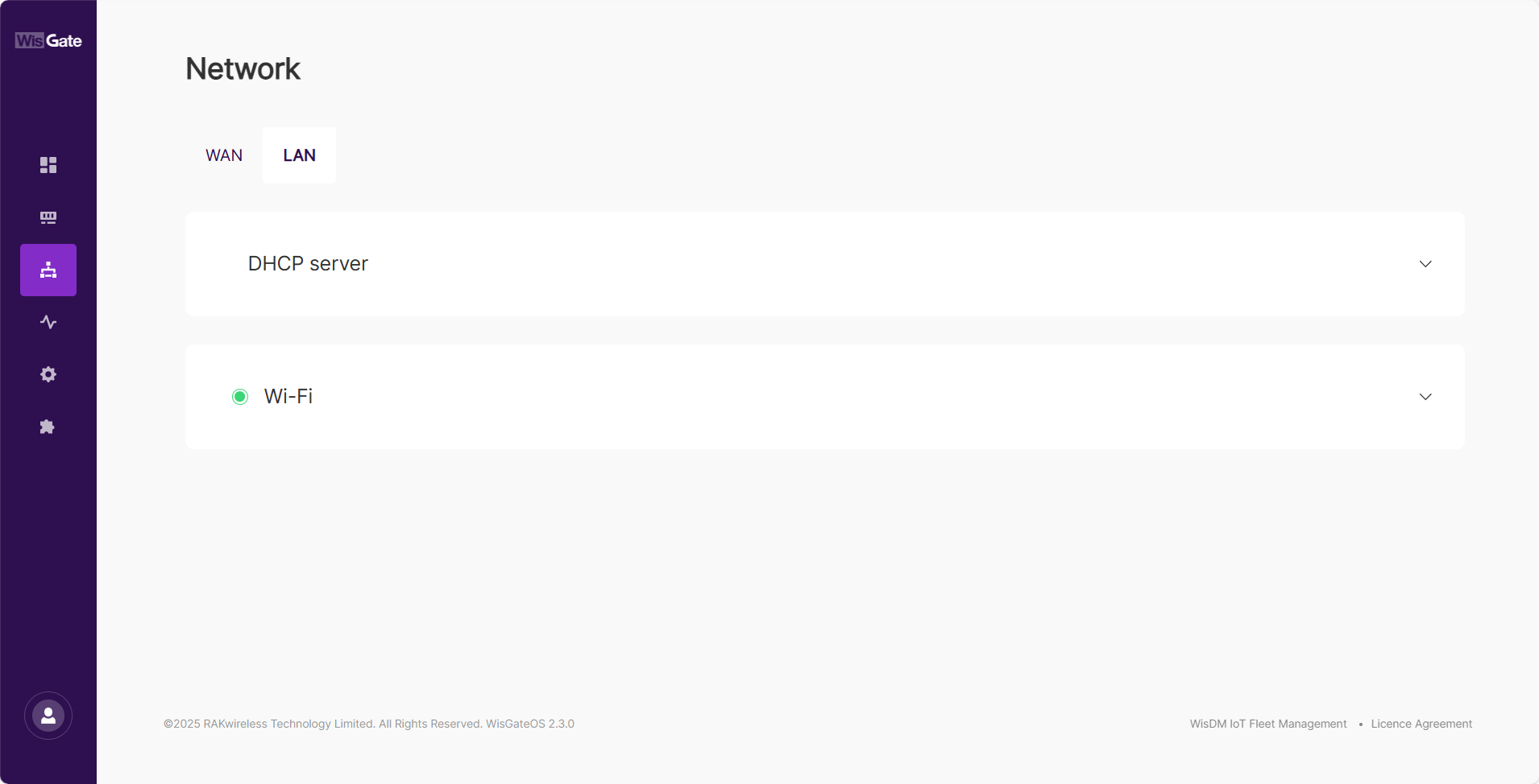

LAN
In the LAN tab, you can view and configure the settings for your Local Area Network (LAN) interfaces. The status of each interface is indicated by a red/green light, showing whether the interface is enabled or disabled.
Figure 1: LAN tabDHCP Server
The DHCP Server section allows you to configure the gateway's LAN IP settings. By default, the gateway has a preconfigured DHCP server that assigns IP addresses to connected devices. You can modify these settings as needed. Expand the interface details by clicking on the interface name or the arrow to the left of it (

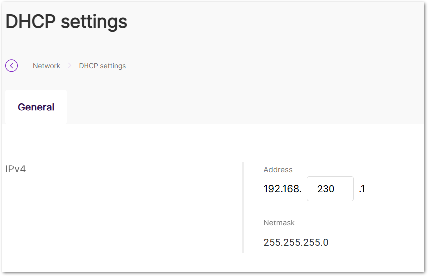

Settings: Set the network interface preferences for DHCP server.
Figure 1: DHCP Settings- Address: The IPv4 address of the LAN DHCP server.
- Netmask: The subnet mask for the DHCP server.
Wi-Fi
Manage the settings for the Wi-Fi LAN interface in this section. The Wi-Fi interface allows the gateway to create a wireless access point (AP) for local devices to connect. Expand the interface details by clicking on the interface name or the arrow to the left of it (
Figure 1: Wi-Fi-

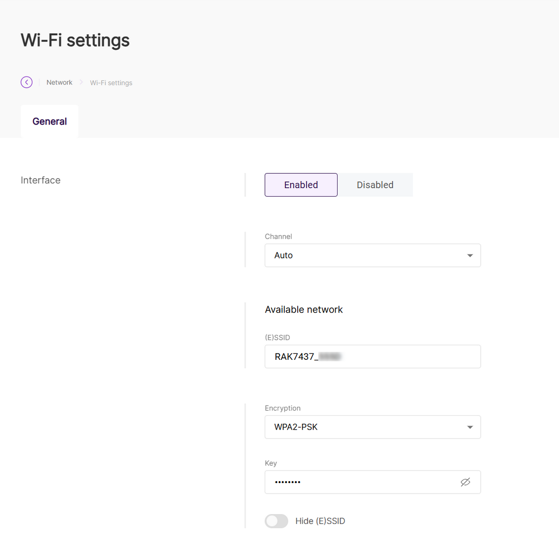

Settings: Set the network interface and tracking preferences for Wi-Fi mode.
Figure 1: Wi-Fi settings- Enabled/Disabled: Enable or disable the Wi-Fi LAN interface.
- Channel: Set the Wi-Fi channel. The default is Auto, which allows the gateway to automatically choose the optimal channel.
- (E)SSID: The SSID for the wireless AP.
- Encryption: Select the encryption type for the Wi-Fi AP. Available options include:
- No Encryption
- WPA-PSK
- WPA2-PSK
- WPA-PSK/WPA2-PSK Mixed Mode
- Key: Set the Wi-Fi hotspot password.
- Hidden: Option to hide the SSID, making the AP invisible to devices scanning for networks.
By default, the Wi-Fi Access Point (AP) is enabled and operates as an open network (without password protection) on all WisGate Edge and WisGate Soho gateways.
For security reasons, disabling the Wi-Fi AP or securing it with a strong password is strongly recommended after completing the initial gateway configuration to prevent unauthorized access.
