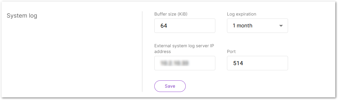

Configure the System Log
The System Log settings allow management of log storage and forwarding logs to an external server for monitoring, troubleshooting, and long-term analysis.
Figure 1: Configure the System Log-
Navigate to Settings > General settings.
Set Log Buffer Size: Enter the maximum log buffer size (
in KiB) in the Buffer size (KiB) field (e.g., 64 KiB).
Choose Log Retention Period: Select a duration from the Log expiration dropdown:
- 14 days
- 1 month
- 3 months
- 6 months
- 12 months
Configure External Log Storage (Optional):
- Enter the External system log server IP address if remote log storage is required.
- Specify the Port number used by the external log server.
Click Save to apply changes.

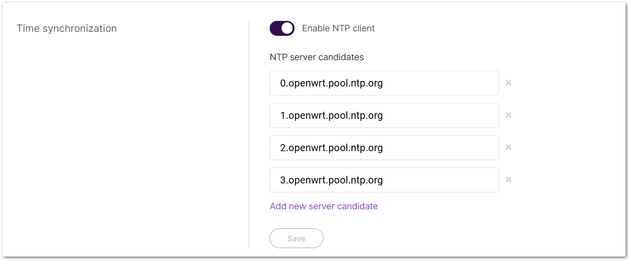

Time Synchronization
The gateway supports Network Time Protocol (NTP) to maintain accurate system time.
Figure 1: Time synchronization- Navigate to Settings > General settings.
- Toggle Enable NTP client to activate time synchronization.
- Configure NTP servers in the NTP server candidates list:
- Click Add new server candidate to add an NTP server (e.g.,
pool.ntp.org). - To remove an NTP server, click the × button next to it.
- Click Save to apply the settings.

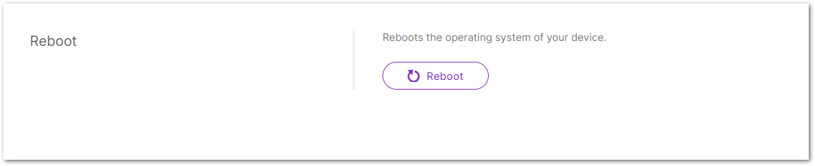

Reboot the Gateway
This option restarts the gateway. All unsaved changes will be lost during the reboot.
Figure 1: Reboot the Gateway- Navigate to Settings > General settings.
- Click the Reboot button.
- In the confirmation dialog, click Confirm to restart the gateway.

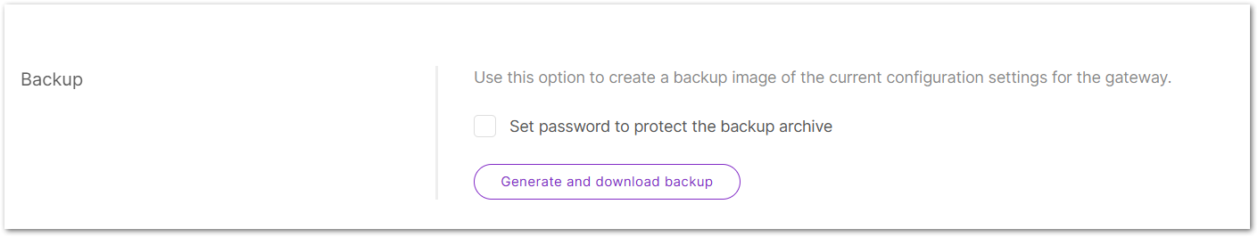

Backup
Creating a backup of the current gateway configuration allows restoration when necessary. For added security, the backup file can be encrypted with a password.
Figure 1: Backup configuration- Navigate to Settings > Backup and Restore.
- (Optional) Enable Backup Encryption:
- Check the Set password to protect the backup archive box.
- Enter a secure password to encrypt the backup file.
- Click Generate and download backup to create and download the backup archive.
- Store the backup file in a secure location for future use.

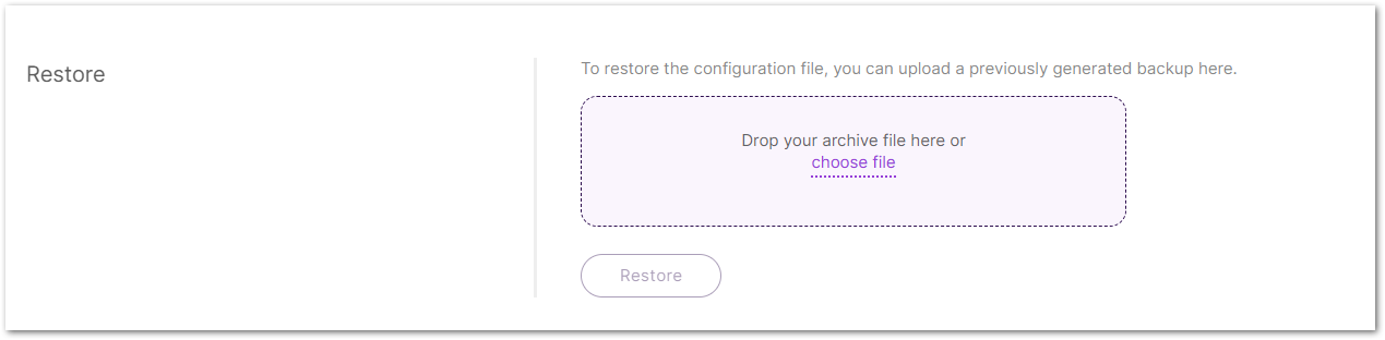

Restore
Restoring a backup reverts the gateway settings to the state saved in the selected archive.
Figure 1: Restore configurationRestoring a backup will overwrite the current settings. Make sure the correct file is used.
- Click choose file or drag and drop the backup archive into the designated upload area.
- After the file is loaded, click the Restore button.
- When prompted for a password:
- Encrypted backup: Enter the correct password, then click Restore again.
- Plain backup: A password dialog still appears, but no password is required. Simply click Restore again.
- Wait for the process to complete. The gateway will automatically reboot.

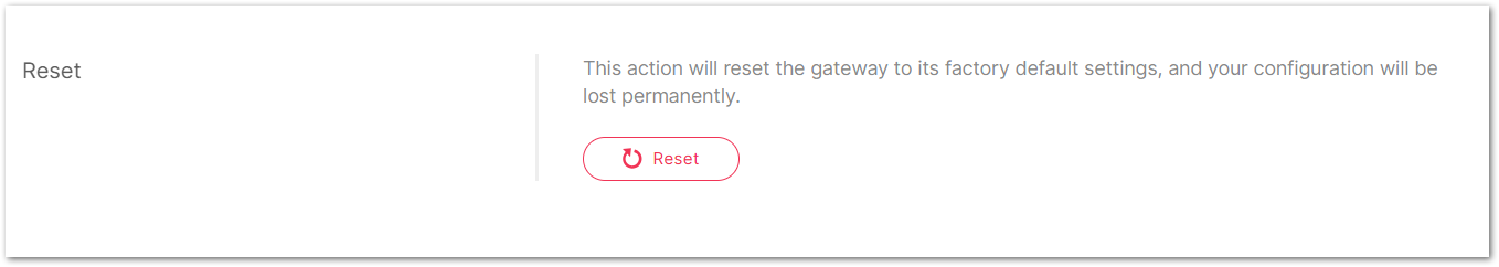

Reset to Factory Defaults
Resets the gateway to its original factory settings, permanently erasing all configurations.
Figure 1: Reset to factory defaultsThis action is irreversible. Ensure you have a backup before proceeding.
- Click the Reset button.
- In the confirmation dialog, click Reset to reset the gateway.
- Wait for the gateway to reboot with factory default settings.

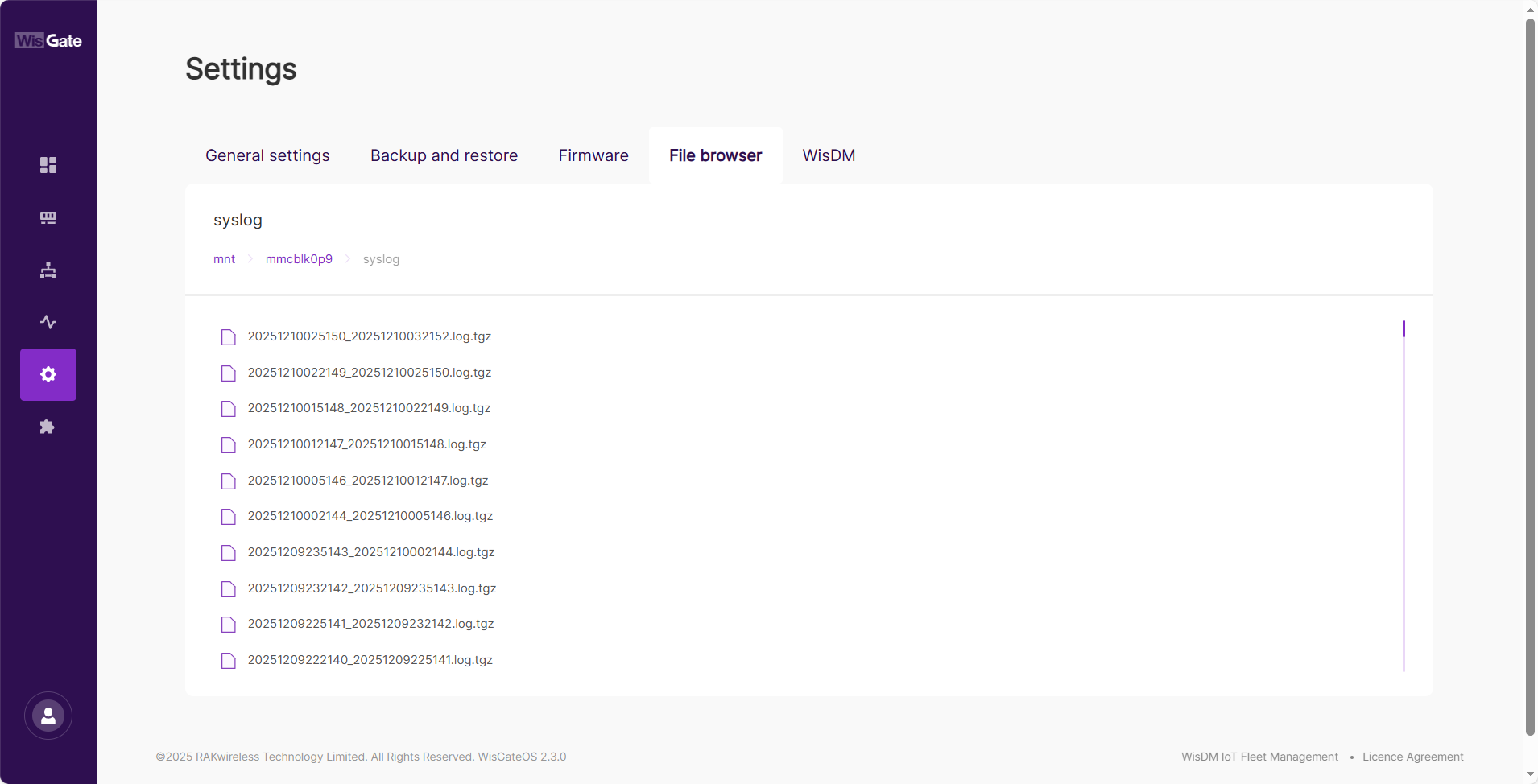

File Browser
The File Browser allows you to access the gateway’s file system directly through the Web UI, making it easy to view or download files. It provides access to system log files, firmware images, configuration data, and other stored resources.
Figure 1: File browser tab- Navigate to Settings > File Browser > mnt > mmcblk0p9.
- Select the target folder, enter it, then click and download the file.
