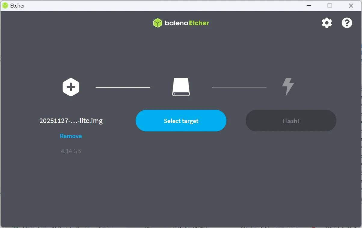

Figure 1: Launch balenaEtcher - In balenaEtcher, click Flash from file and select the downloaded firmware file (it should end with
.zip).

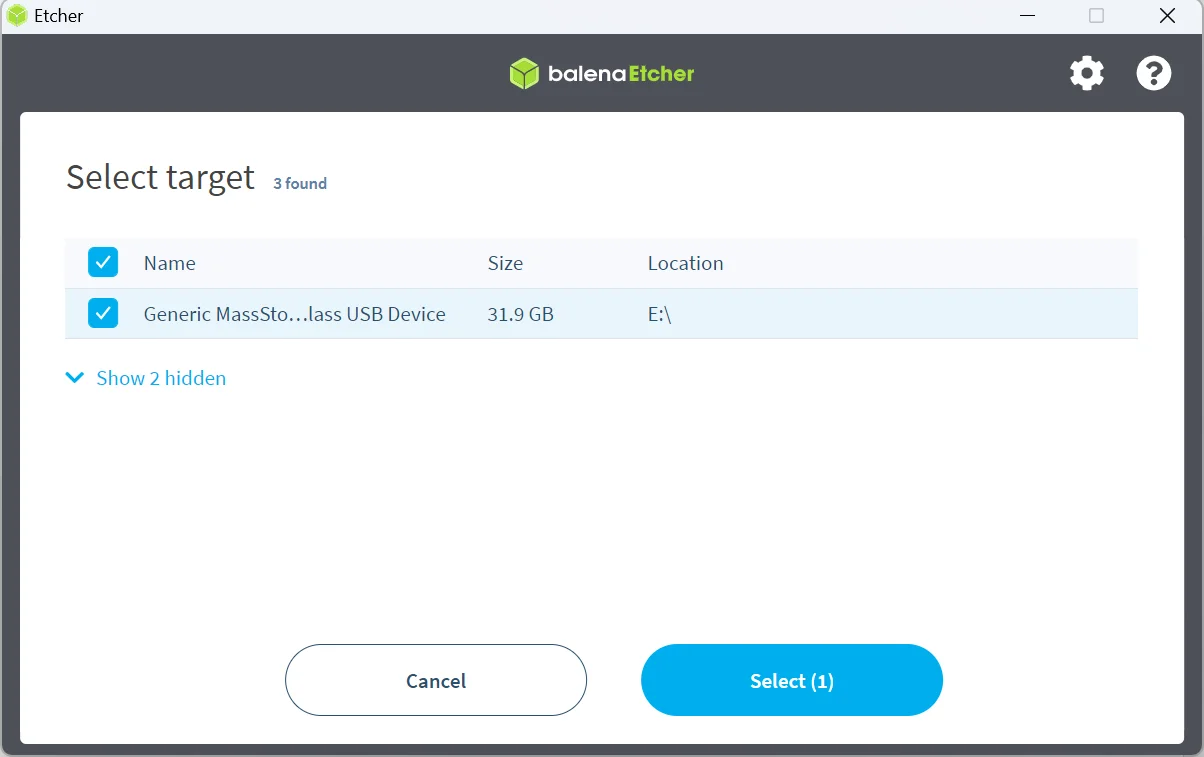

Figure 1: Upload firmware file - Click Select Target and choose the SD card as the target device to write the firmware.
Figure 1: Select SD card - Click Select to confirm the target selection.

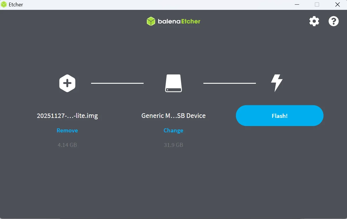

Figure 1: Confirm selection - Click Flash! to begin the firmware flashing process. Wait until the flashing process is completed.
NOTE
This may take several minutes depending on the size of the firmware file.

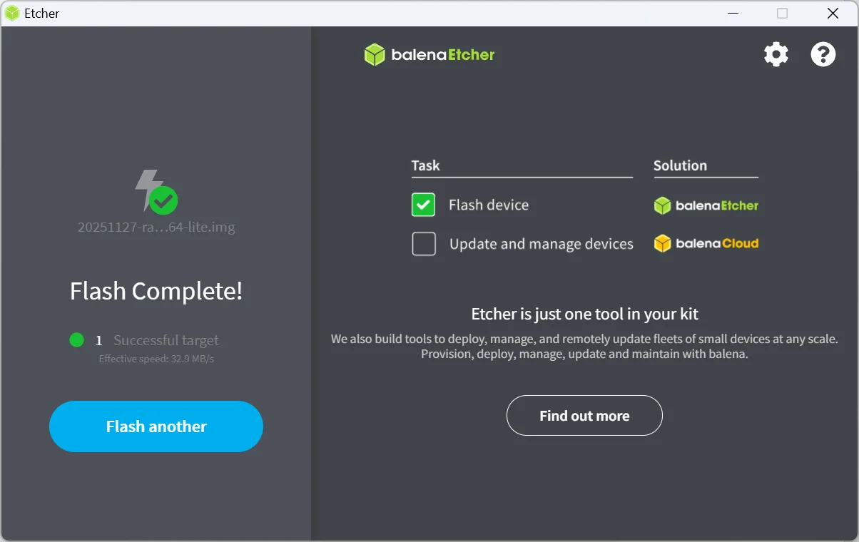

Figure 1: Flash the Firmware - Once the flashing process is complete, safely eject the SD card from the reader. Insert the SD card back into the Pad.
Figure 1: Flash Completed - Power on the WisMesh Pad. The device boots with the newly flashed firmware.
