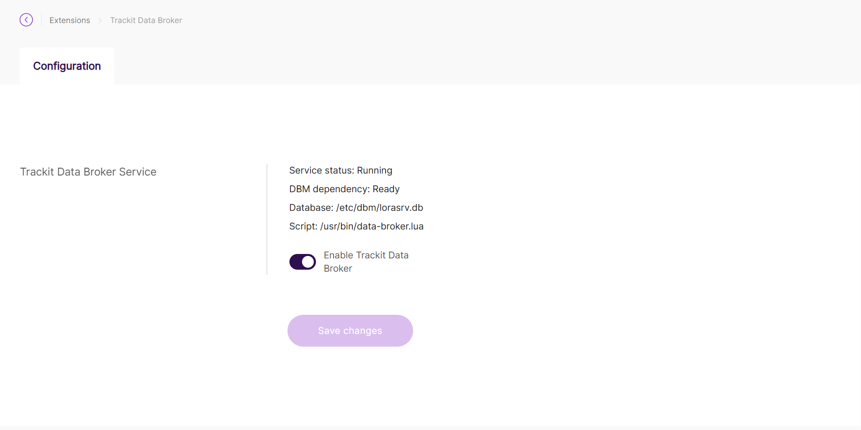

Configure the TrackIT Data Broker Extension
Install and enable the extension before adding the gateway to TrackIT.
- To access the TrackIT Data Broker extension, click Launch.
Figure 1: Extensions tab- On the configuration page, turn on Enable TrackIT Data Broker and confirm the following statuses:
- Service status is
Running. - DBM dependency is
Ready.
Figure 1: Configuration page- Click Save changes to apply the updated service status.
The Save changes button becomes available only after the switch setting is changed.
The configuration page displays the current TrackIT Data Broker service status and related system information.
| Field | Description |
| Service status | Shows whether the TrackIT Data Broker service is running. If the status is Stopped or Not Running, the forwarding service is not active. |
| DBM dependency | Shows whether the database management dependency is ready. Ready indicates that the Data Broker can access the Built-in Network Server database. |
| Database | Displays the path to the local LoRaWAN database used by the Data Broker. |
| Script | Displays the path to the TrackIT Data Broker forwarding script. |
| Enable TrackIT Data Broker | Enables or disables the TrackIT Data Broker service. |
NOTE
- When Service status is
Running, DBM dependency isReady, and Enable TrackIT Data Broker is enabled, the service is operating normally. - Disabling the TrackIT Data Broker service stops data forwarding to TrackIT. The gateway can still receive LoRaWAN packets from WisNode Tag, but the data will not be forwarded to the TrackIT platform.
